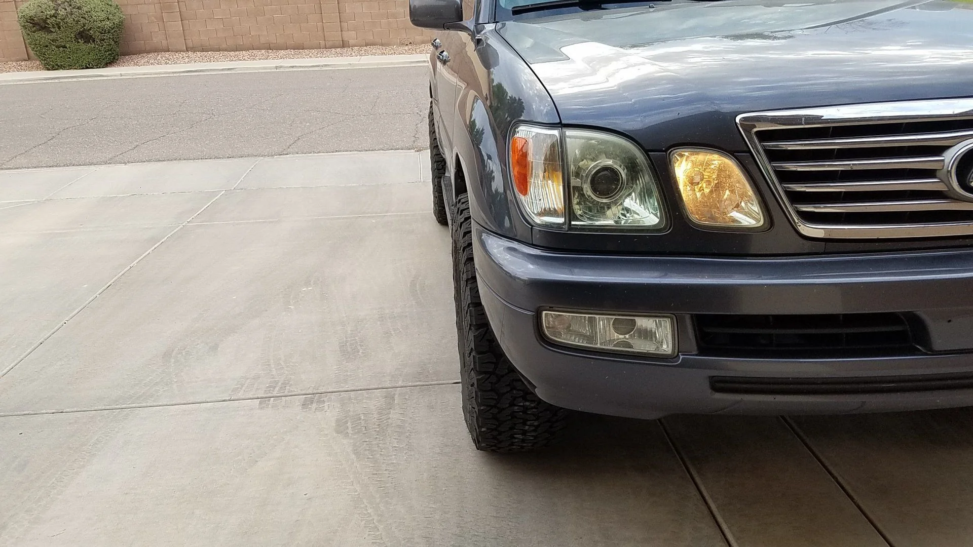

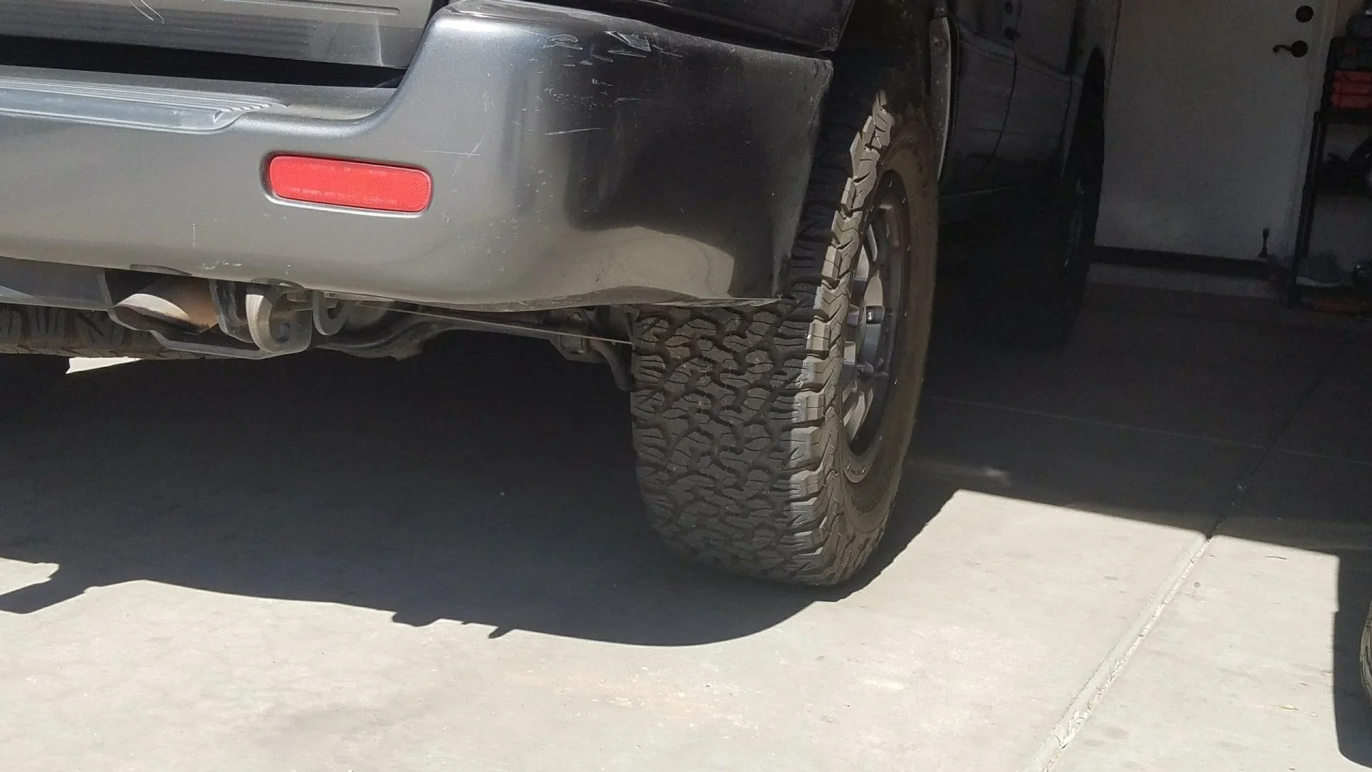

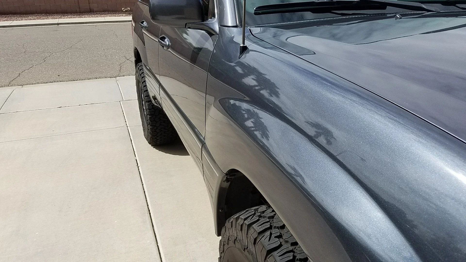

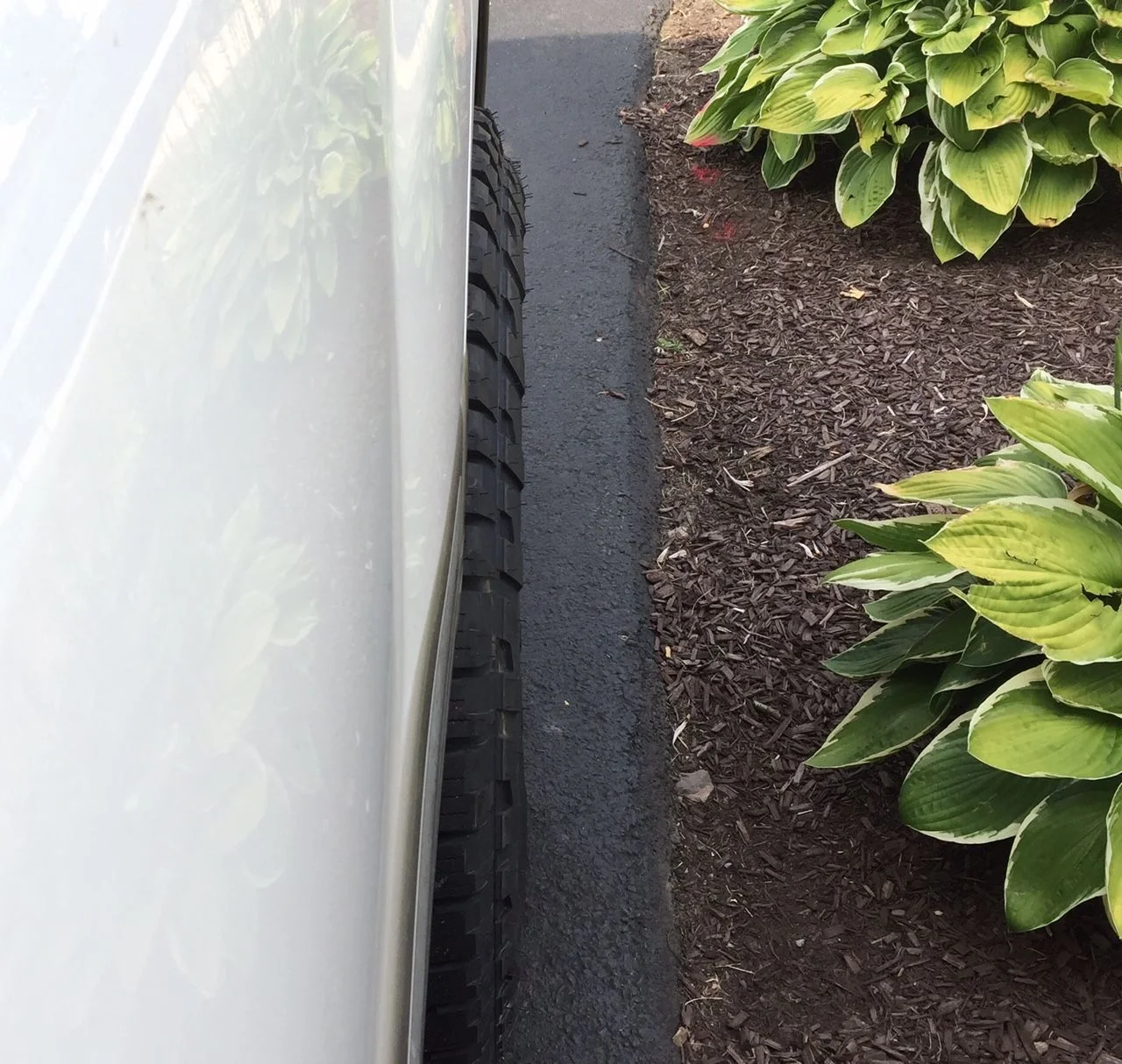

I have 1.25 BORA spacers and Falken ATW3s in 285/70-17s.

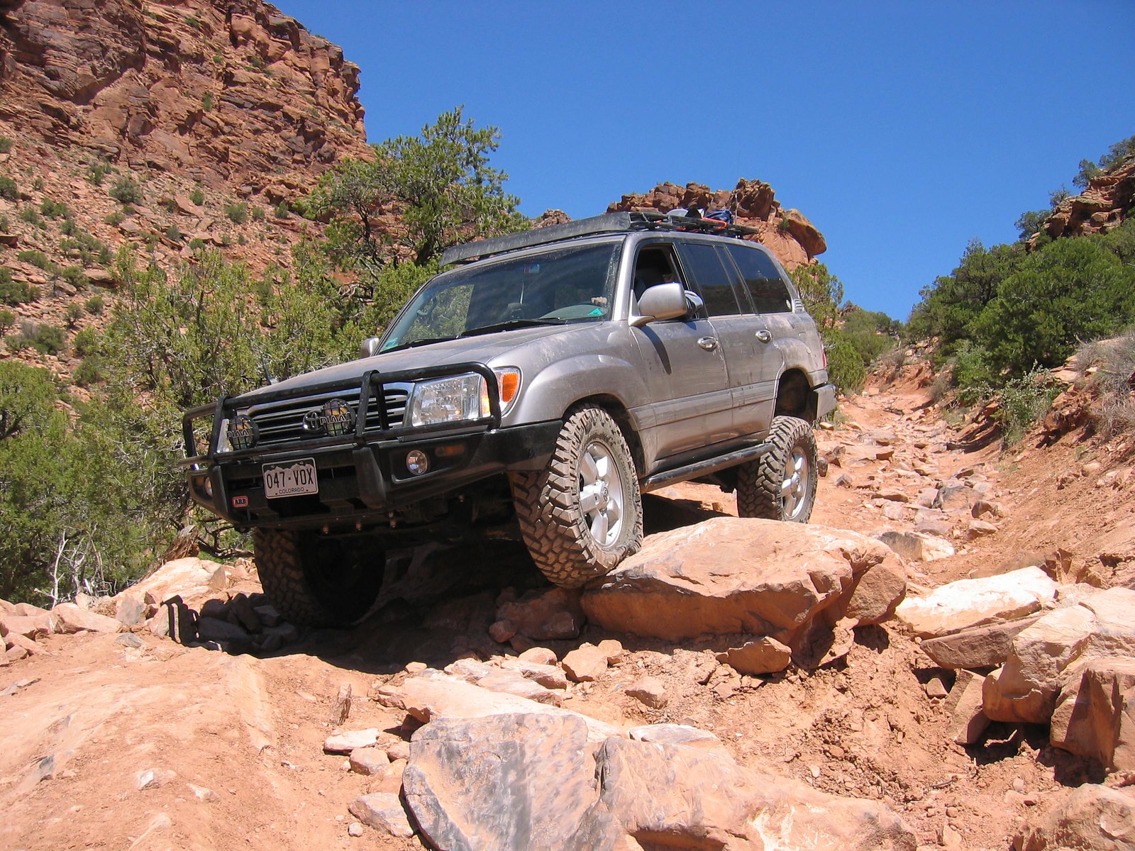

You asked about 1.25... I'll pass this along for info sake... I was running 2 inch spacers (as seen in this pic) and after a few months I heard a rattle. I decided to take them off and inspect to find I only had 3 lugs left on one of the front passenger side spacers! I haven't ventured to get the one replaced and so I haven't put them back on since.

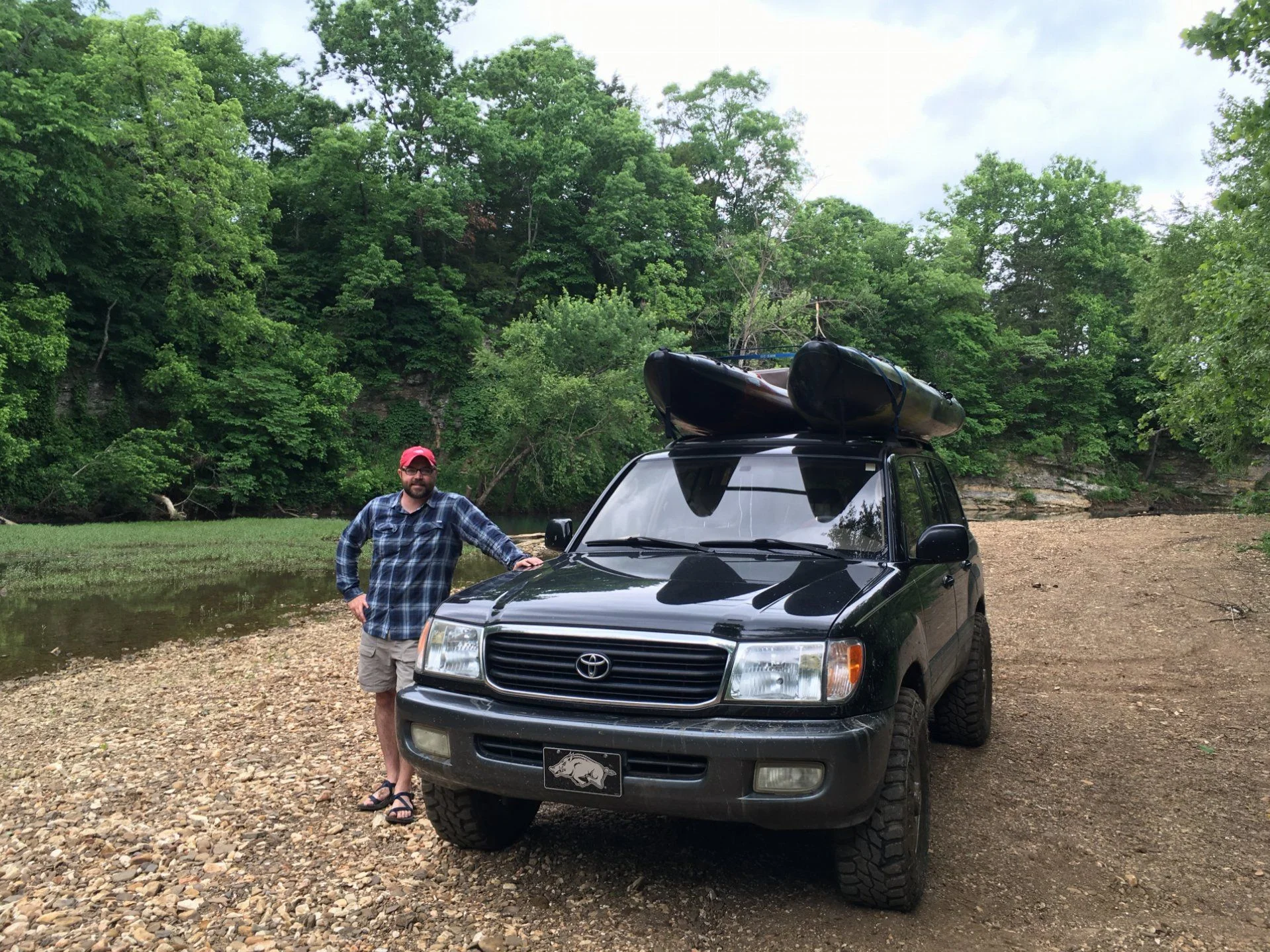

305/65 with 1.25 Slee spacers
