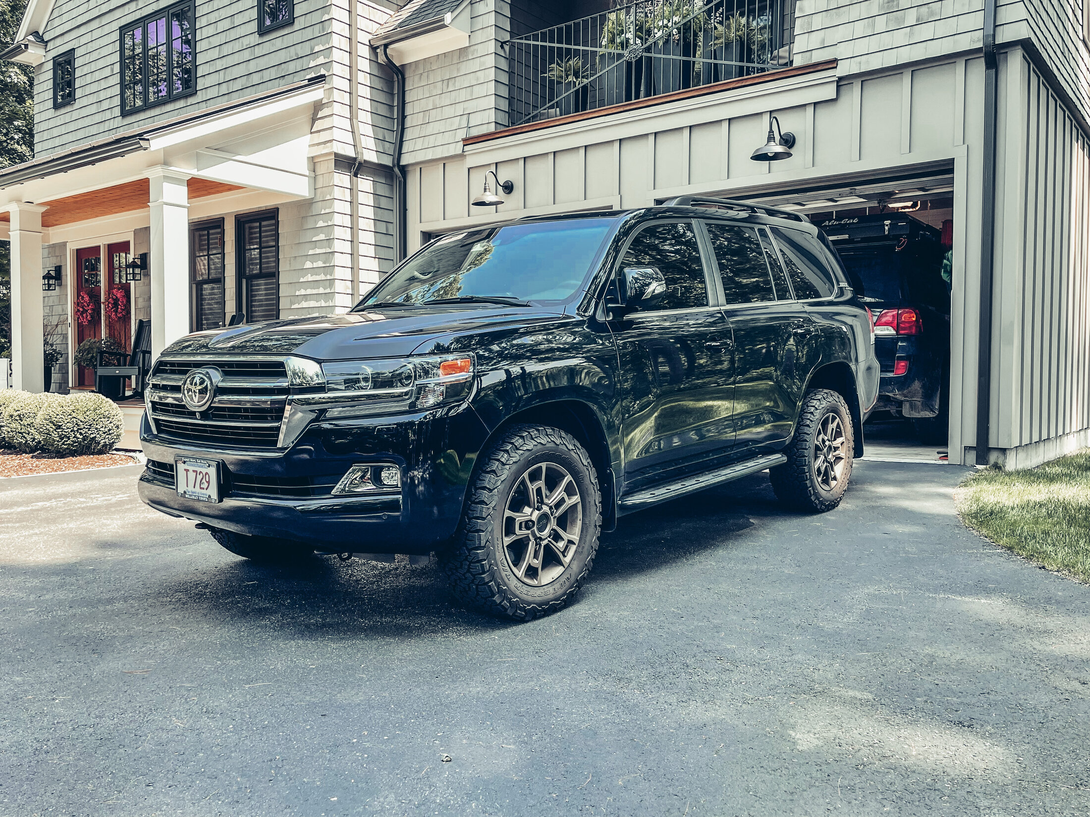

OK your right, here's the pics (spacers installed after suspension ( 1-1/2 inch Eibach) upgrade, but before other mods.

275/70/18 with factory spec wheels and 1.25 in spacers
285/70 would sit a bit better I think…
Sorry, 2016+ photos would be more relevant. Here are a few of factory sized tires with 1.25 in spacers.
Again, bigger tires would look that much more aggressive… happy to take some more specific photos if it would be helpful
Or maybe a 305/65R18 ;)
