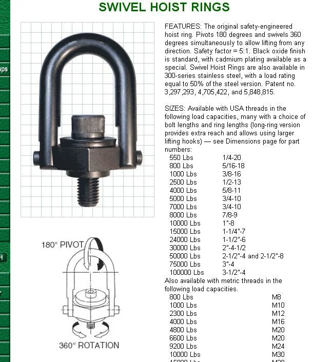

Not quite the answer you want.....but I have avoided the weld in/d-ring approach and opted for a swivel hoist ring. You get a ring pivot of 180 degrees and a complete 360 rotation. Here is a picture of the product I purchased.

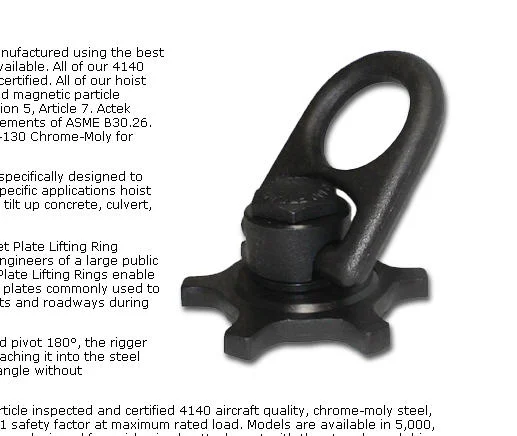

Another approach would be to weld in a street plate lifting ring, similar rotation capability. The second photo shows that application.
