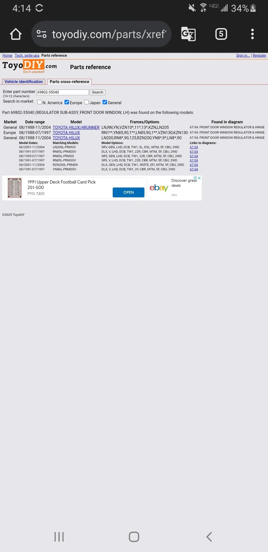

here is a page from Toyodiy.com.
i thought this was going to be a bigger cross.
are you in AK or CR?
I would honestly think these would cross with the 4Runner / surf as well. pretty certain they actually use the same short doors. part number can change based on plug or pigtail length.
but body wise these bodies are the same from 88-05/6. should also match 90-95 4runner.
dig around on the wedsite.

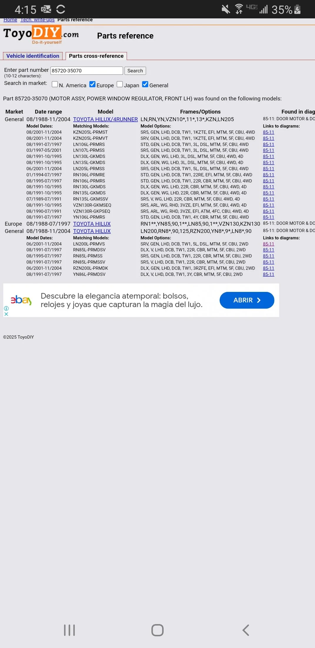

That site is gonna come in ridiculously handy.
We are in Costa Rica where the Hilux is. I would think that they would make then as easily interchangeable as possible. My biggest issue is finding any decent supplier at all. I don't really care if I need to hack the plug end off and hard wire em (this thing has already been hacked in several ways by the PO anyway.

Everything I am seeing shows that they are not interchangeable with the Surf/4Runner. The places that I d find new Toyota Motors for the windows they want like $300-$450. The regulator is pretty easy to come by.
the 4Runner numbers are crossing back to double cabs.
imo it would be worth a look, if you can find one.
