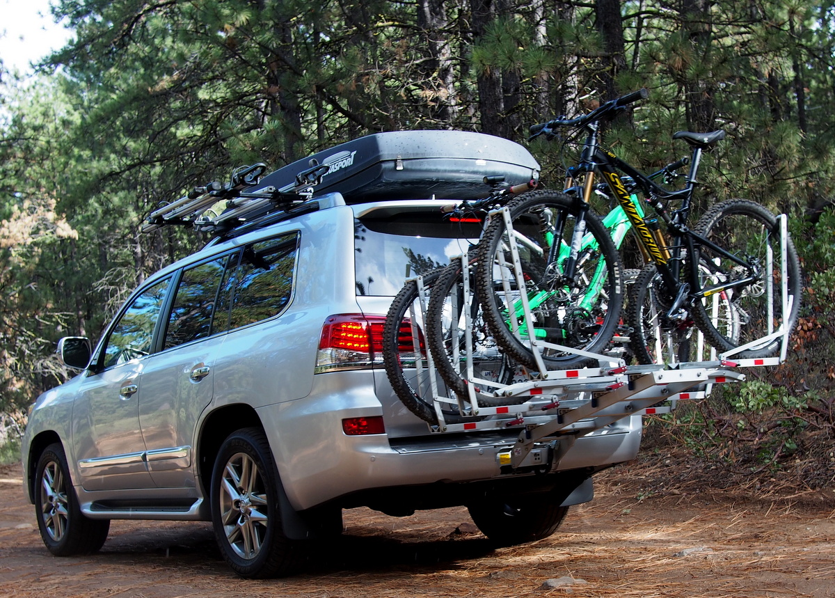

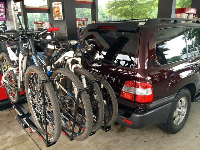

I've been pleased with the 1UP racks. They do come in tandem bike widths. I can open the lift gate if I only use the forward slot for kids bikes. The system is modular and so you can add as many racks/steps as you think your hitch can handle.

For some reason I can not stand the "Vertical racks" to many shuttle scratch up frustrations at downieville, mammoth and Whistler, they usually say "Come on is just I is a downhill bike" and in my head "Yes, but I want to make the scratches myself, not because you dumma^^ rack and sloppy attention."

I've had Thule, Yakima... roof and receiver. I think 1UpUSA is in a class of its own. It's like the Land Cruiser of bike racks.

@Patineto - you're exactly right. One of the trays got bumped in a parking lot. The impact bent a single bolt - it was replaced and the rack is new again. And yeah - no worries about the bikes. In that shot, there's roughly $22,000 worth of bikes on that rack. It's a common joke with mountain bikers - that we carry bikes worth more than our vehicles. Well, I drive a damn nice vehicle (a Land Cruiser!) and STILL have more $$$ hanging on the rack!
Many times or at least the first time they will send you the spare parts as a courtesy, you gotta love that kind of commitment to service..

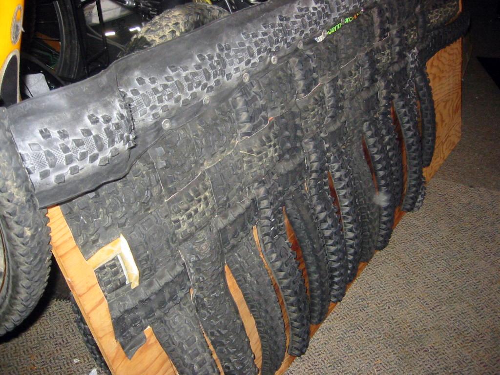

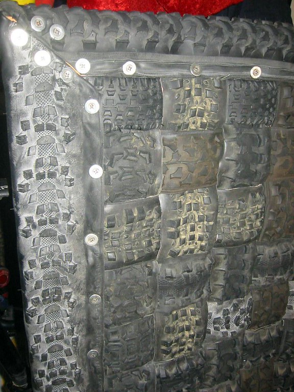

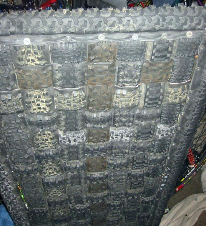

You win the internet today! I have GOT to make/have one of those. It's killing me - thinking of all the tires I've just tossed the trash... and that I could've made one of those. It starts today... the collecting/saving part. Dear club mates...
Thanks you..
A Tip...
That "Carpet" is what I think of Road bikes, Put them to sleep.. ;-)
But ask all your friends at bike shops to save you tires, only the thin strand kevlar tires will work, the thick cheppo road bikes are to stiff to get bend flat...
This one was made with Mountainbike tires, way, WAY to much grip.
Exposed wood screws, but I used mostly staples for this one too.
