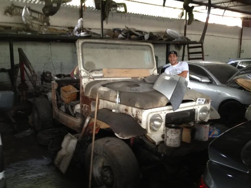

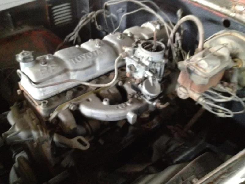

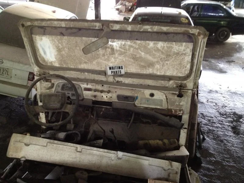

I'm new here, soon i'll be restoring my fj45 from 1980.
this pick up was on my dad's farm since 20 years lol, so she was a little bit rusty, but anyhow... It has some work now:
1) New 2F motor.
2) Chassis restauration.
Right now she's on a work shop waiting for the new parts to arrive, I'm thinking on the color, and the accesories I'll put on it, another issue that was on my mind is, the isolation of the cabin.
If any of you want to help with any idea, will be great!!
PD: Sory for the bad english, I'm from Venezuela!
Here, some pictures!:popcorn:
