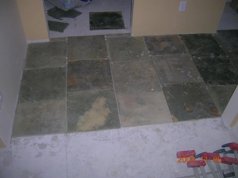

Here are pics of some slate I've been setting. I may get to grouting it this weekend. Got the slate from a a guy on a community message board for a great price - canceled job. It's not very square though, so it's something of a bitch to get good lines. That's ok - I'm going for "rustic" :hillbilly:
The first ones are where the wooodburner is going.
Here are some by the door from the patio and the hall to the garage.

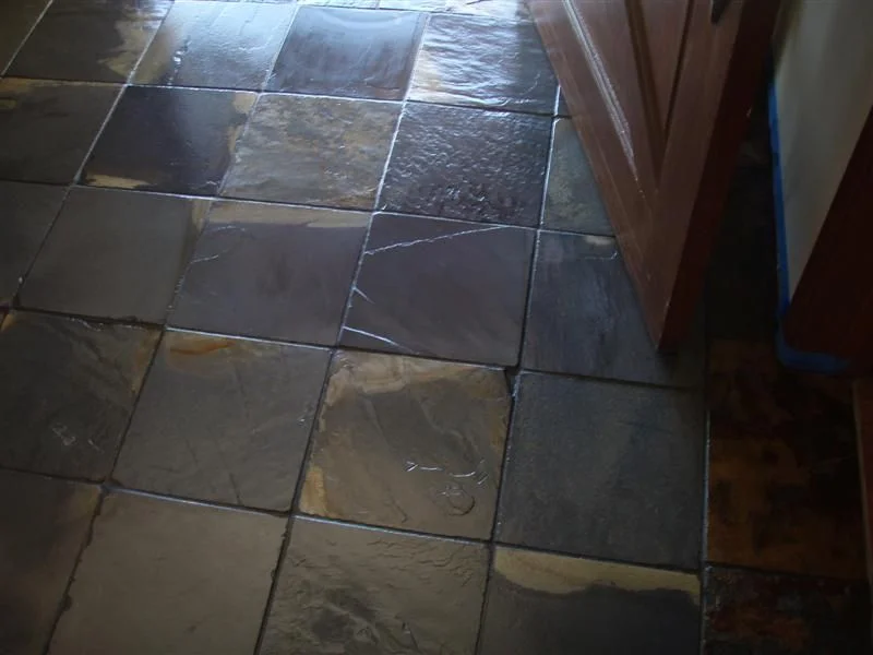

Here are some pics of the Glaze stuff..
It's interior, so shouldn't see much temp variation - what's the issue with that? I did put down a shear membrane at the hearth & door because the tile crosses a concrete expansion gap & the slab/foundation interface. Hope it's enough.
Do you know if that glaze come in a "semi-gloss"? I like the look to a point - don't want it to shiny!

Dont know what kind of temps you are going to be dealing with but you might also want to use some Glaze-N-Seal for that wet look and protection...
It like varnish to wood.... it really brings the beauty out of that stone.....
The more rustic the better...

the only thing laying any natural stone is that you have to be super careful that's there a smooth transition from tile to tile or you'll be tripping and see shadows, it's takes a lot of time, just like using a grout bag will, but in the end it can really be impressive.
Yea, I think slate is worse then most others in that respect - I took a good bit of time to try and lay tiles of similar thickness next to each other. And built up thin tiles with extra mortar. By no means perfect, but not to bad.
exactly, I've done a couple and that's how I did it, just more time consuming but a nicer finished product.

Yes, haystax is correct.. any grout bag and lowes or homedepot would do....
As for shiny.. I believe they have the satin finish and the glossy finish....
Believe me....once you see the glossy come out you will love it.... it fades just a tad but it comes out really nice at the end....
What I meant regarding temps.. is you are thinking of putting a gas or wood furnace.. I would check with the maf of the product.... I have never used it near a heat source as is always kind of hot down here..
Love to see how it all comes out once you glaze it...
I transition from ceramic tile to slate and have up to a 1/4" in some sections and I think that's what gives it more character....
