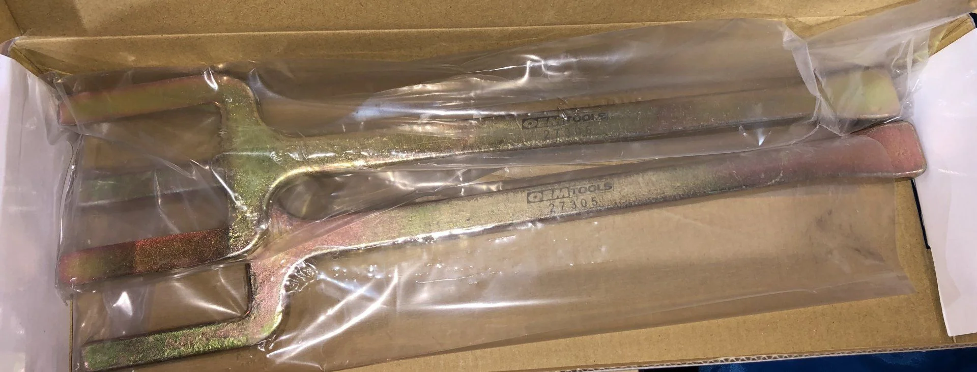

Also, when removing the CV axles I literally spent several hours on one side of the vehicle using every Pry bar known to man, and actual CV puller, and it was a nightmare. I scarred up the housing pretty severely on that side prying on it but finally got it out. For the other side I bought a CV axle popper kit made by OEM model number 27305 it comes with two different pieces I literally had the side out in less than 5 minutes!!!
Excellent tech post. Sometimes having the right tool for the job is the key! I'll have to pick a set up. @Taco2Cruiser has mentioned the bump stop collecting crap recently. Are you guys taking any corrective or preventative action, or is it just a clean it out and watch it situation?
Edit: ordered. Thanks!

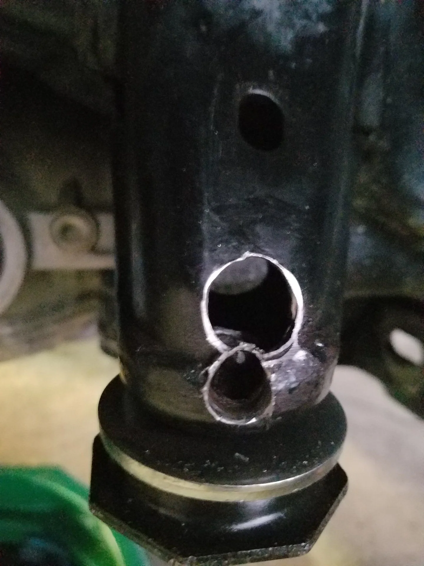

I'm contemplating enlarging the drain holes in the bump stops. Also I removed and slathered the bolts in anti-seize
Thanks for the heads up on that OEM CV Joint tool. I'm in need of installing the ECGS CV Axle Bushing in my 2nd Tacoma to eliminate a small vibe, and the hardest part of the job with the last one was removing the CV. I literally broke a crow bar before the last one decided to come loose.

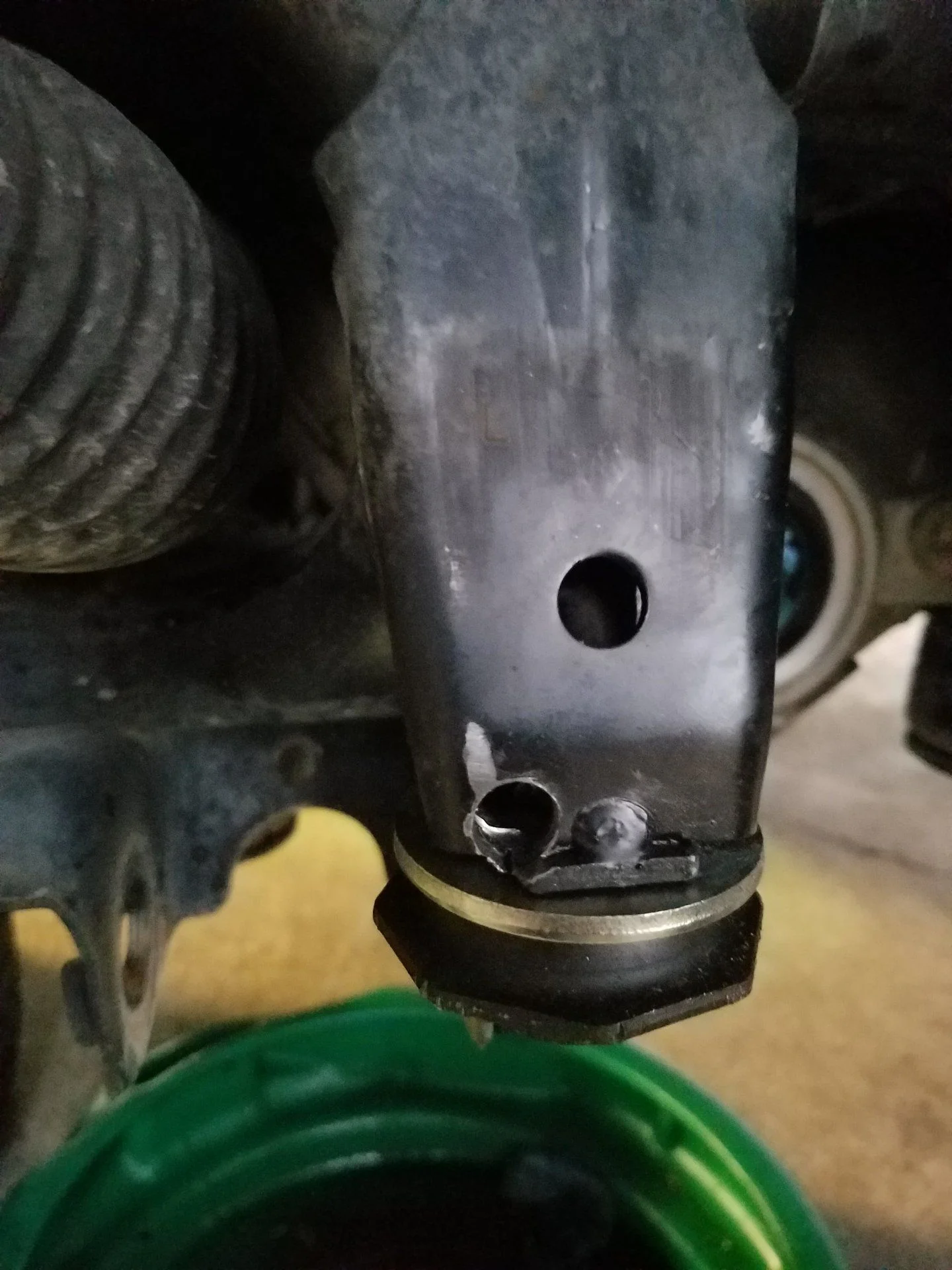

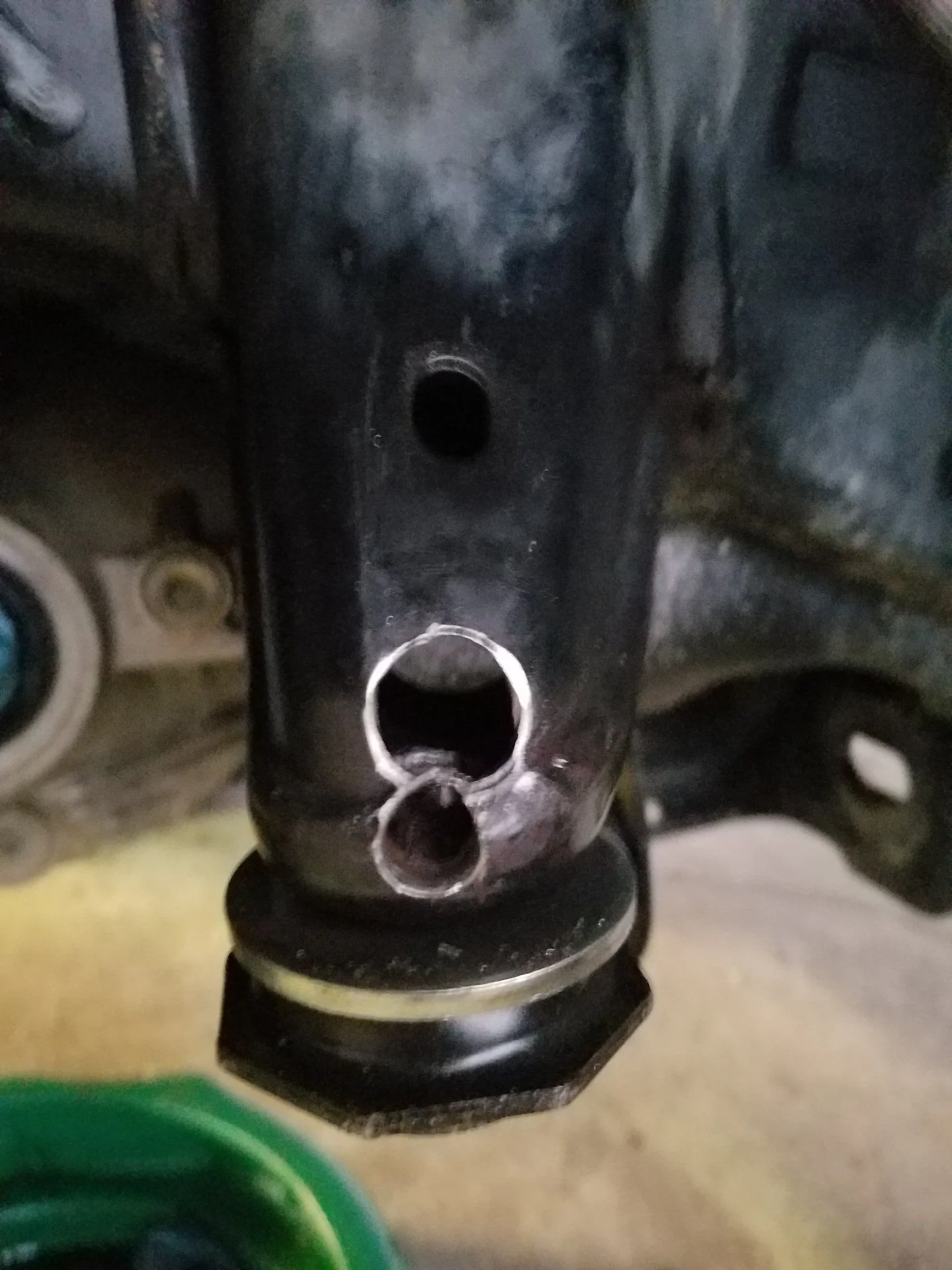

So upon further investigation it's worse than I thought... there really aren't any drain holes in the bump stops. there more like" fill holes"! So don't bother enlarging them because they're not low enough in the pocket of the bump stop to do any good... I just started two new holes as low as I possibly could .

I thought about doing something like that but I think no matter what , you're going to get debris in there ..so it must have a way to come out. The only thing I could come up with was to add drain holes because all the OEM drain holes are way higher than the bottom of the bracket ...so they're worthless.. adding drain holes at the bottom or redesigning the bracket is the only two options I can see...

So I ended up drilling some holes at the bottom of the bump stops and filling in the one that I had enlarged earlier
