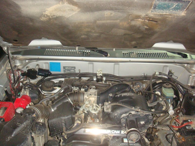

Here is a pic of my engine bay.. See the defferences from yours and mine....
I would like to be able to put a battery in that section but I dont know If i will be able... Let me know what you think...
FlFj80 i dunno what that red thing is on the left side of the rig.. but in my case and i'm guessing is the same thing with matty, there's nothing there so that's where you'll be able to put the extra battery.. in my case i didn't find any double battery system that i liked and so i used a double cycle battery.. from my understanding double battery systems are very complex and you need very specific parts for it work the way it is supposed.. but i'm no expert.. so let me know what you think 'bout the double cycle battery
Is the red thing on the left side a compressor? I agree with GAPC, It should be easy to move that around and put a second battery in there.
