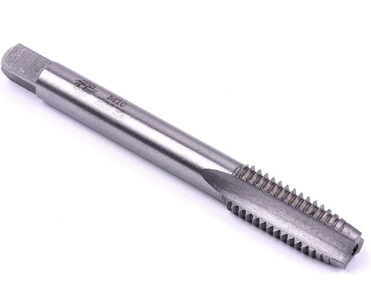

Can you re-tap it?
I can try? What would I need to do to re-tap it? I'm gonna report myself (sadly) to my dad when he gets home and we'll see what we can do on Monday. I've given up trying to force the bolt in to preserve the bolt.
An M10 tap. I don’t know what the thread pitch is. I assume M10x1.0.
Would I need to drill out the hole before the tap? Another concern is whether the tap would be able to fit in the space above the hole.
No, just put some oil on it and slowly turn it in. It will recut the threads and clean out the junk. Space might be a problem.
