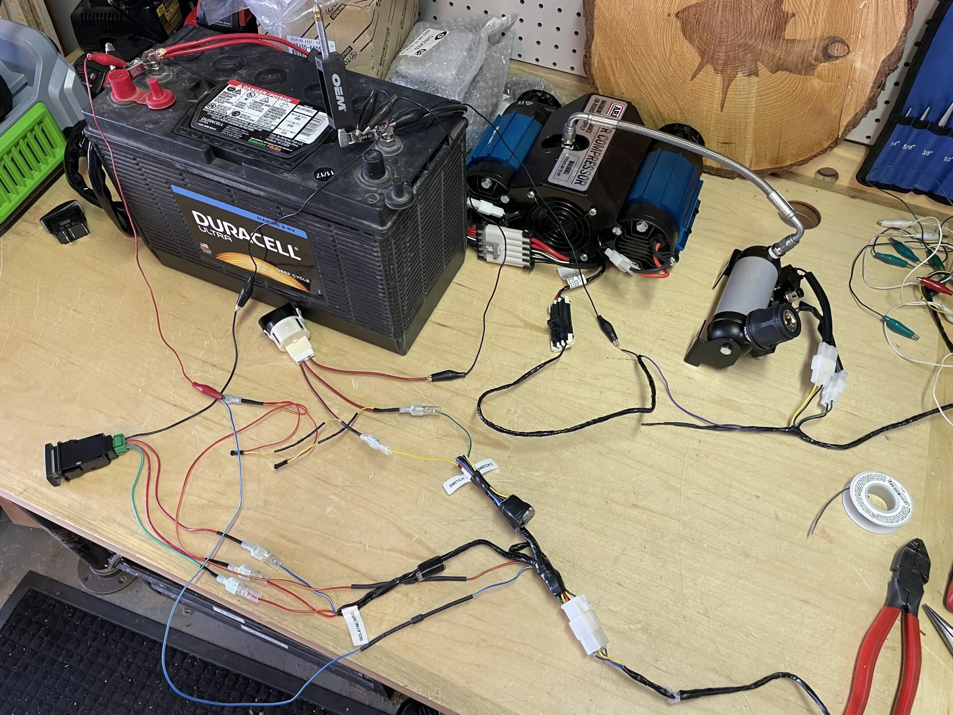

And, just for your entertainment - the rat's nest of my working test setup. Yep, that's painter's tape - don't judge:

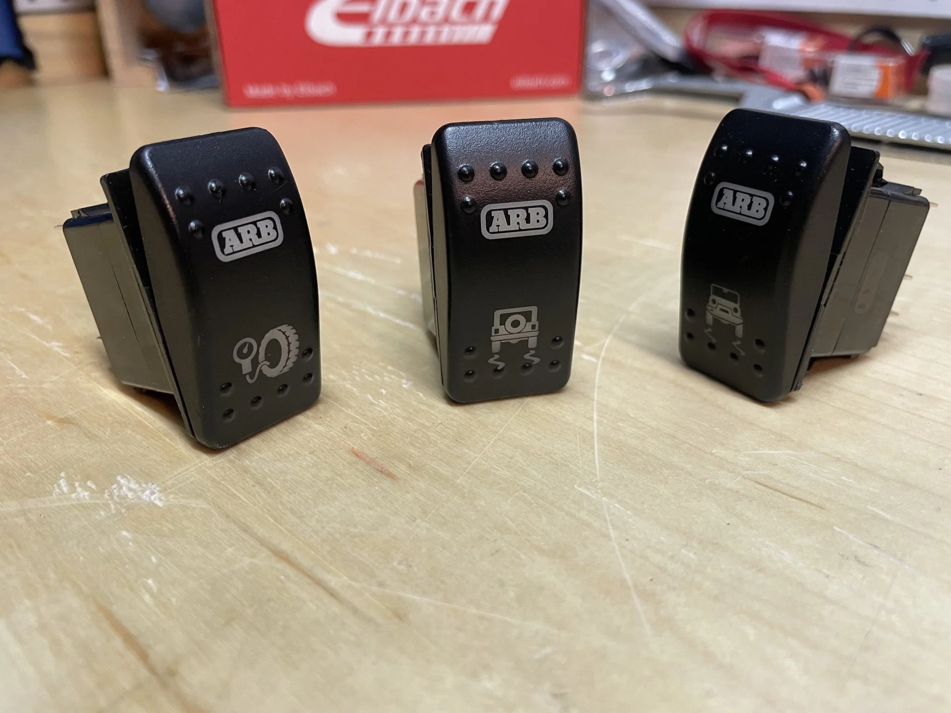

Now to get this all prettied up and run in the truck, and throw those three ugly ARB locker rocker switches in the lake.

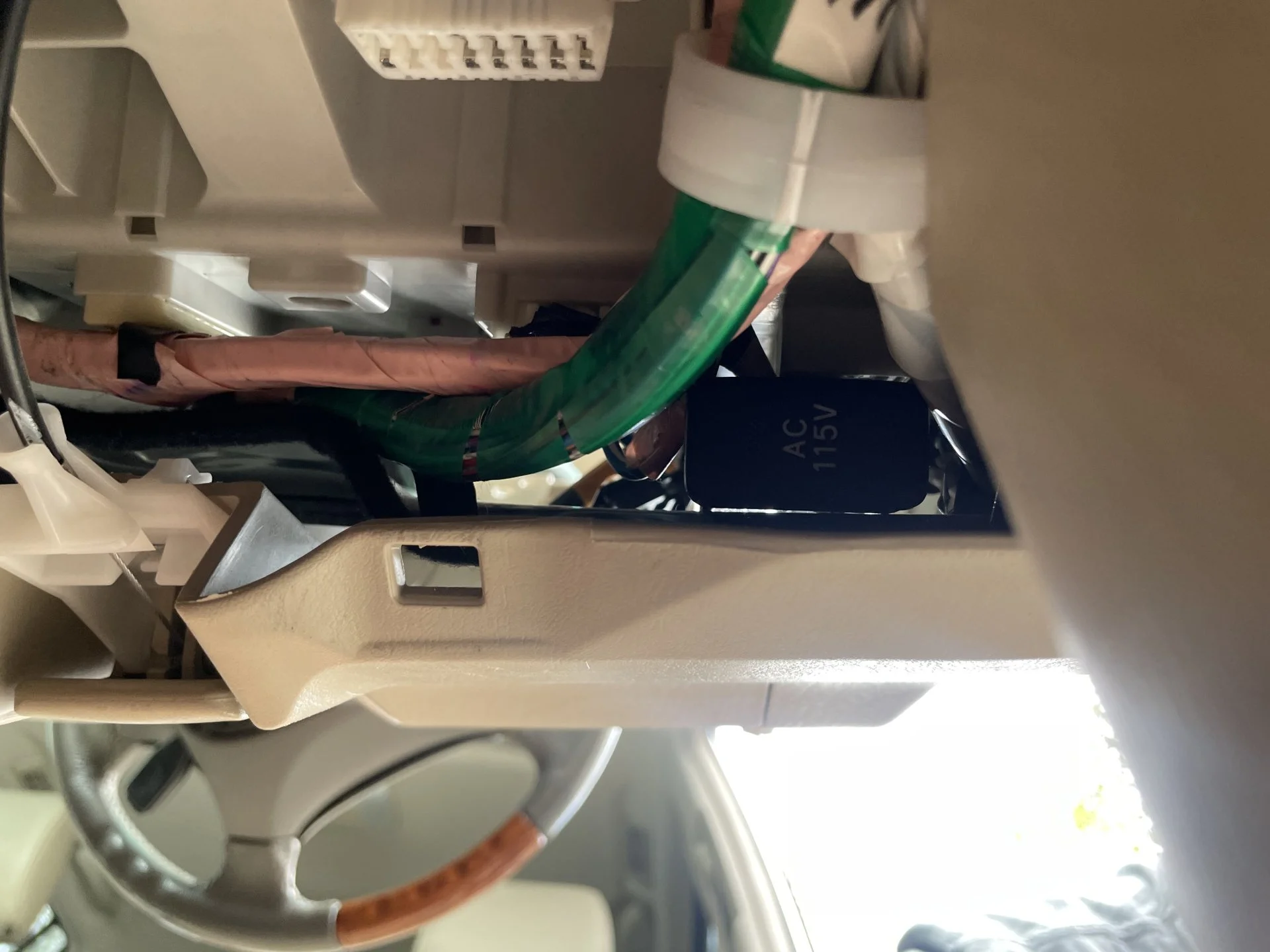

Finally got this finished up. I used this OEM-style switch to replace the ARB compressor isolation switch, which really provides a nice, finished factory look to the entire setup. It comes in various LED colors to match your lighting scheme. I didn’t wire up the dash illumination power, because I don’t need the switch lit whenever dash light are on. I placed it in the slot where the AC 115V inverter switch used to live, because I don’t ever use that switch. I tucked the inverter switch down behind the dash panel, and can activate it by reaching under the panel if it’s ever needed.

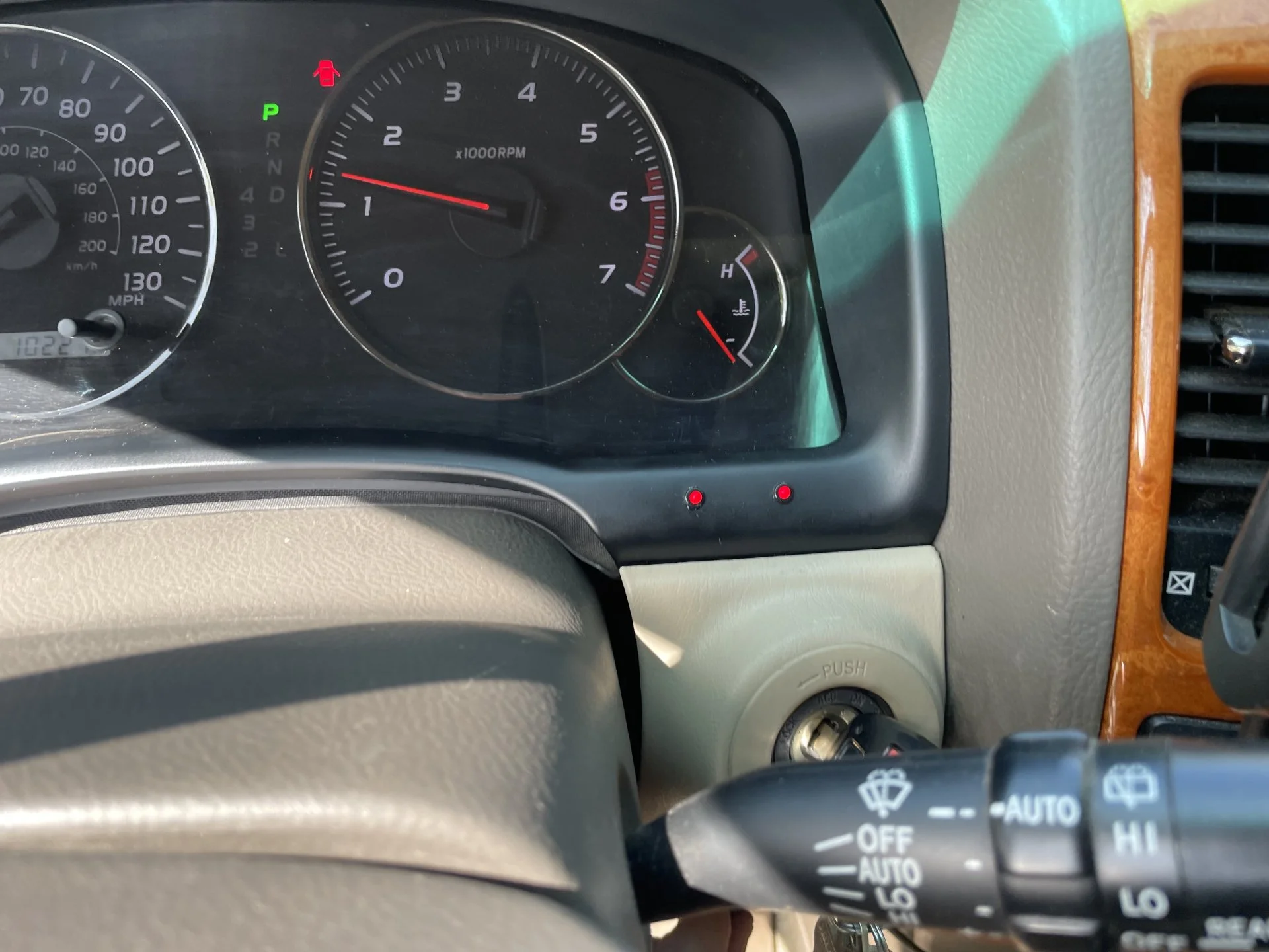

I drilled a couple holes in the dash cluster bezel and glued in the two locker LED indicator lights. I wanted it to be in a visible location, yet they’re small enough to be fairly unobtrusive.
