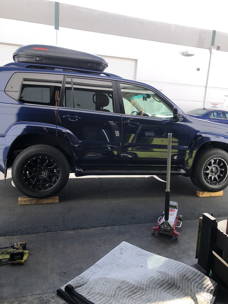

Dropped off for the alignment!

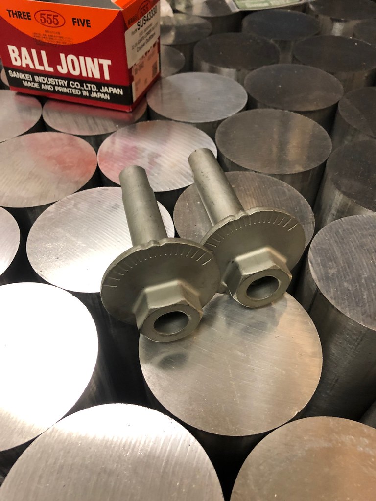

555 Senkie lower control arm ball joint

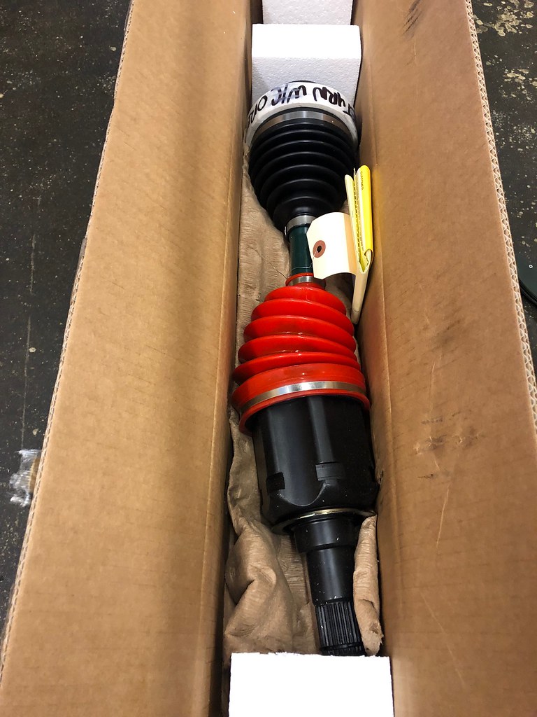

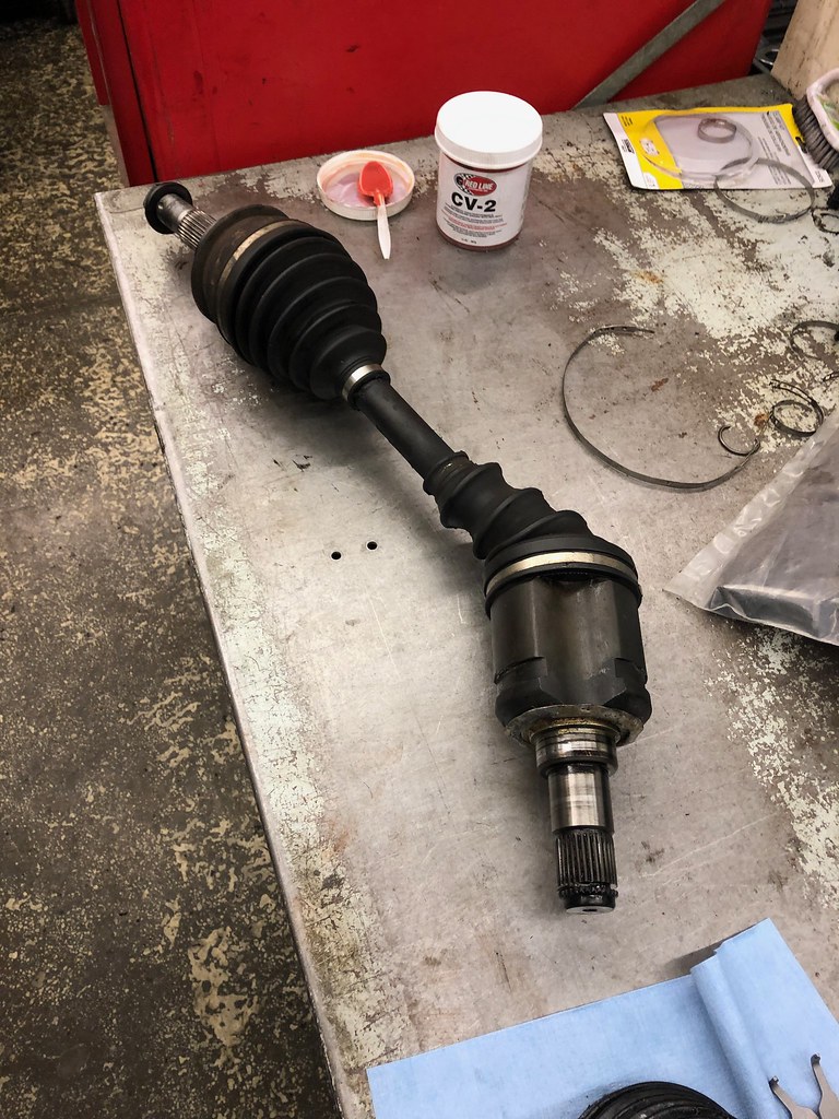

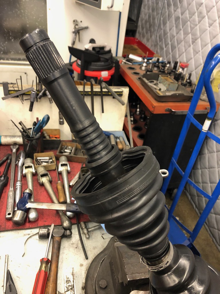

cvj high angle cv axles 9808TR

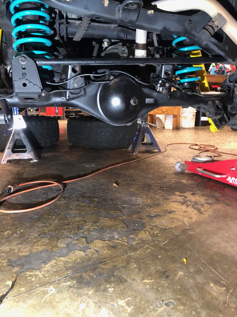

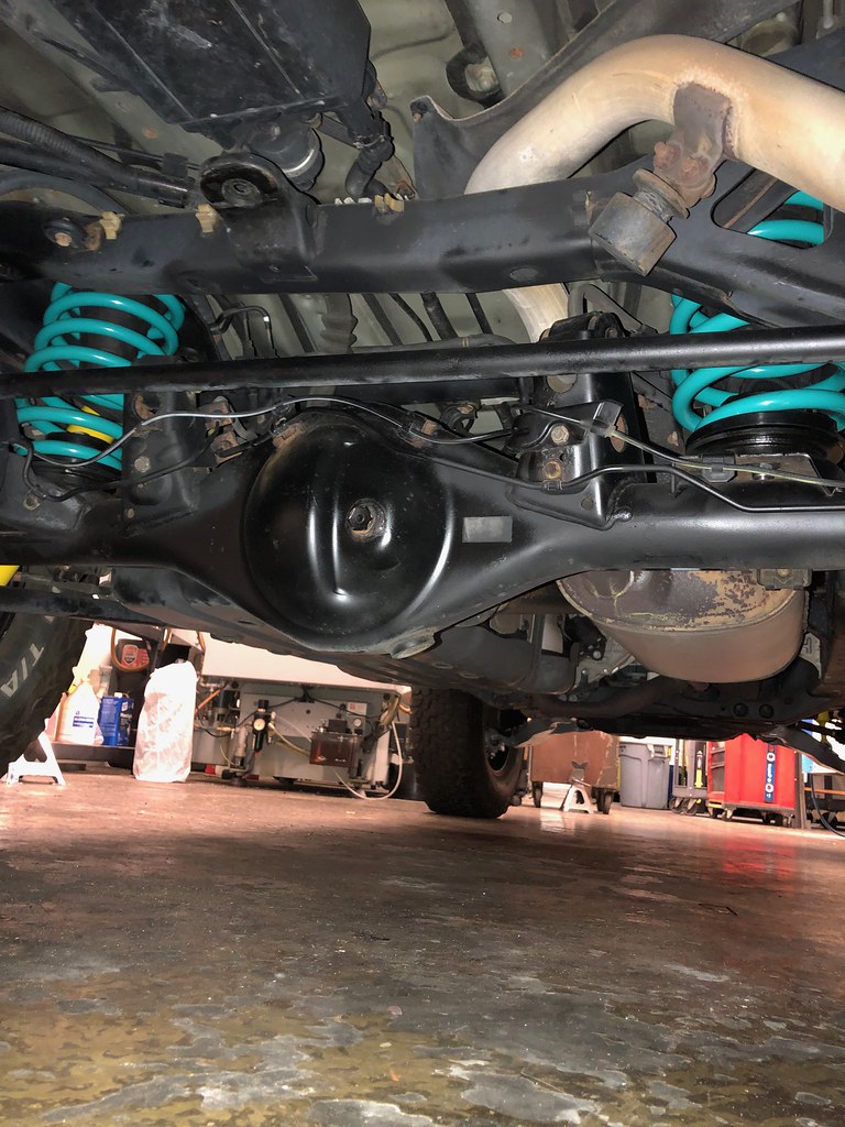

Rear

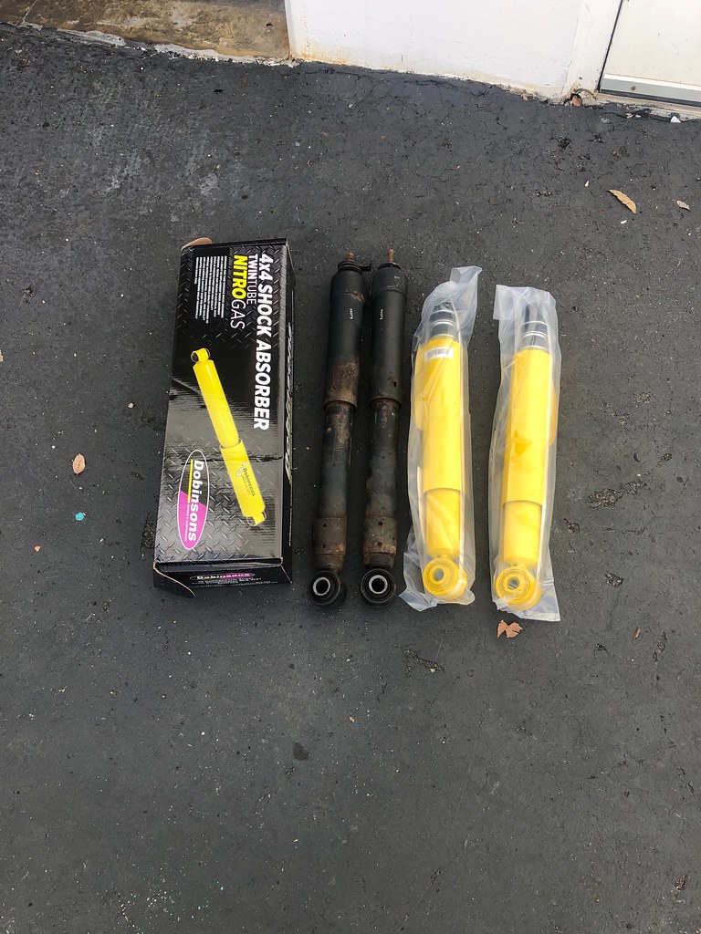

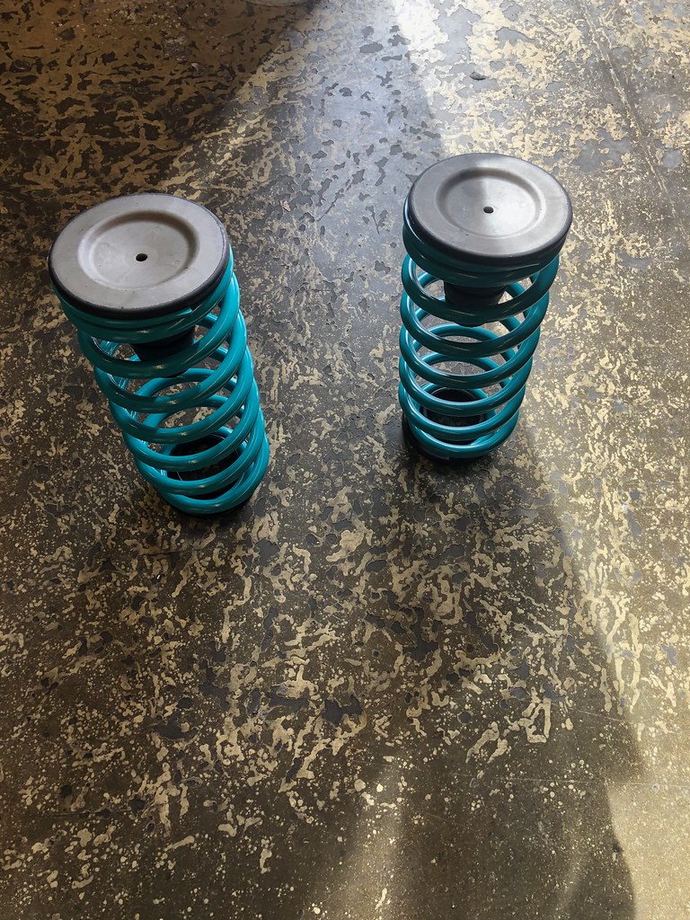

dobinsons springs
Dobinsons shocks

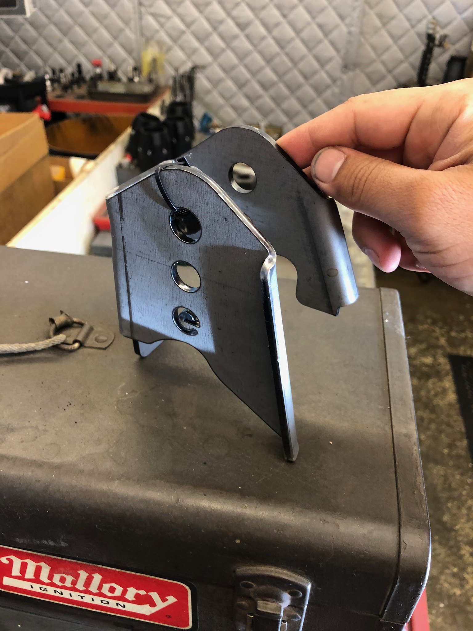

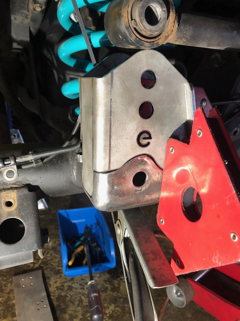

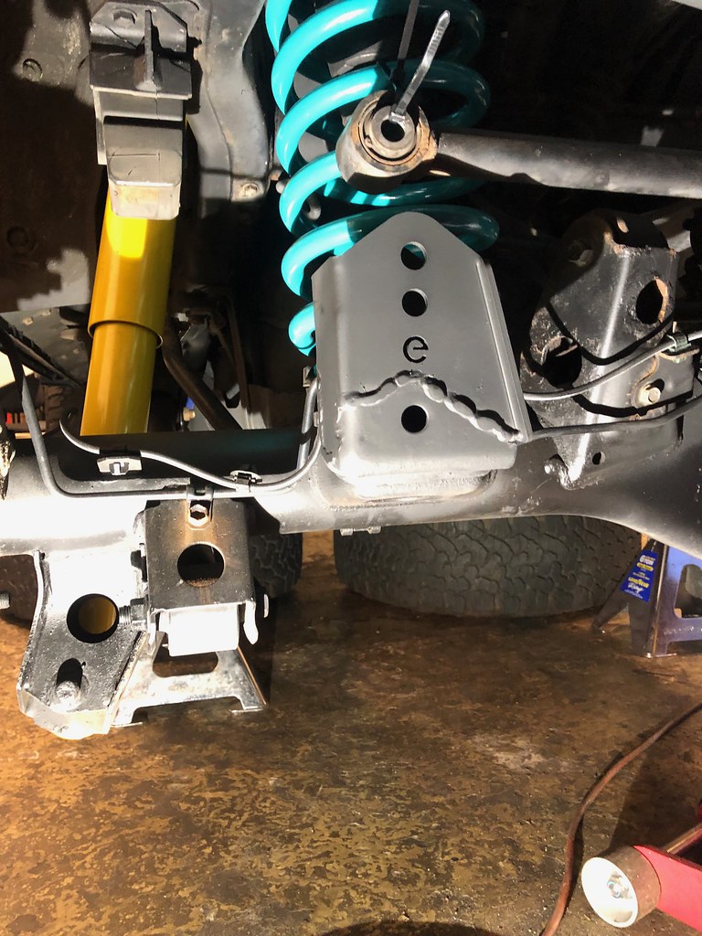

Eim Keith Panhard relocation bracket welded on.
All the 4 link mounts loosened and torqued at the new ride height

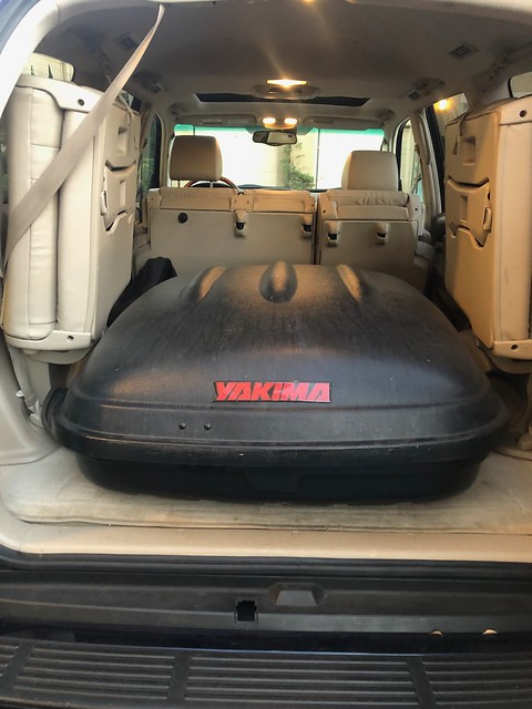

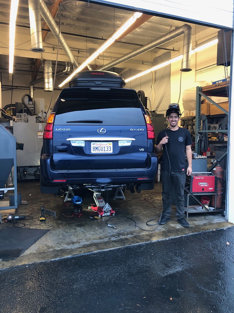

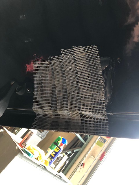

first mod. my friend Bryan hooked me with a Yakima rocketbox. it had a crack in it and a snapped key in the tumbler.
IMG_1337 by ALEXANDER RENGIFO, on Flickr
fixed the crack
IMG_1451 by ALEXANDER RENGIFO, on Flickr
mounted
IMG_1453 by ALEXANDER RENGIFO, on Flickr

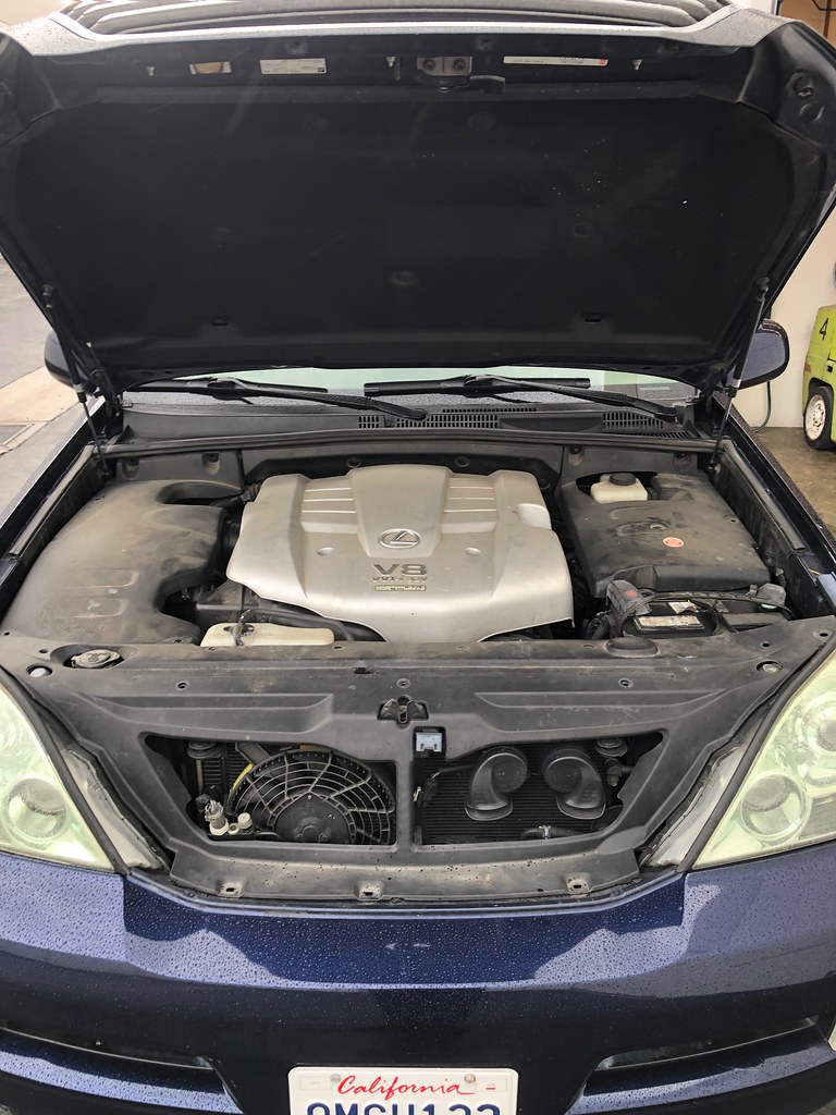

dirty engine bay
IMG_1454 by ALEXANDER RENGIFO, on Flickr
after
IMG_1459 by ALEXANDER RENGIFO, on Flickr

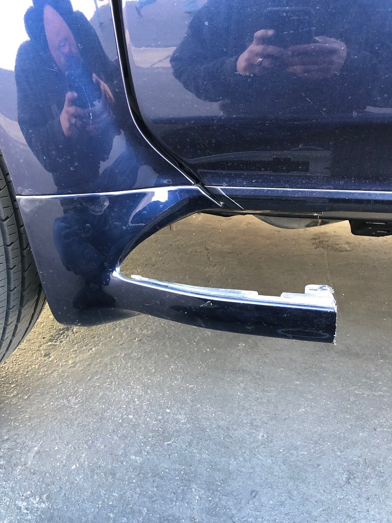

removed the running boards
IMG_1476 by ALEXANDER RENGIFO, on Flickr

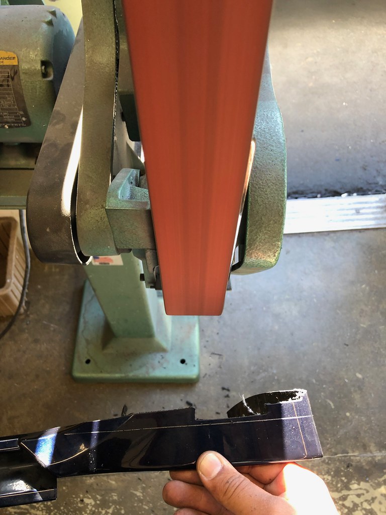

chopped the front corner off to a more manageable size
IMG_1638 by ALEXANDER RENGIFO, on Flickr
and scribed a line into it.
IMG_1641 by ALEXANDER RENGIFO, on Flickr
sanding up to that scribe line for a perfectly straight edge
IMG_1644 by ALEXANDER RENGIFO, on Flickr
done

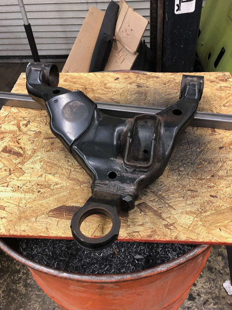

I started with the passenger control arm.
IMG_1669 by ALEXANDER RENGIFO, on Flickr
the 2 cam bolts where completely seized so i had to use a small sawzall to extract them.
this took hours of fighting to figure out what the correct tool to use.
IMG_1686 by ALEXANDER RENGIFO, on Flickr

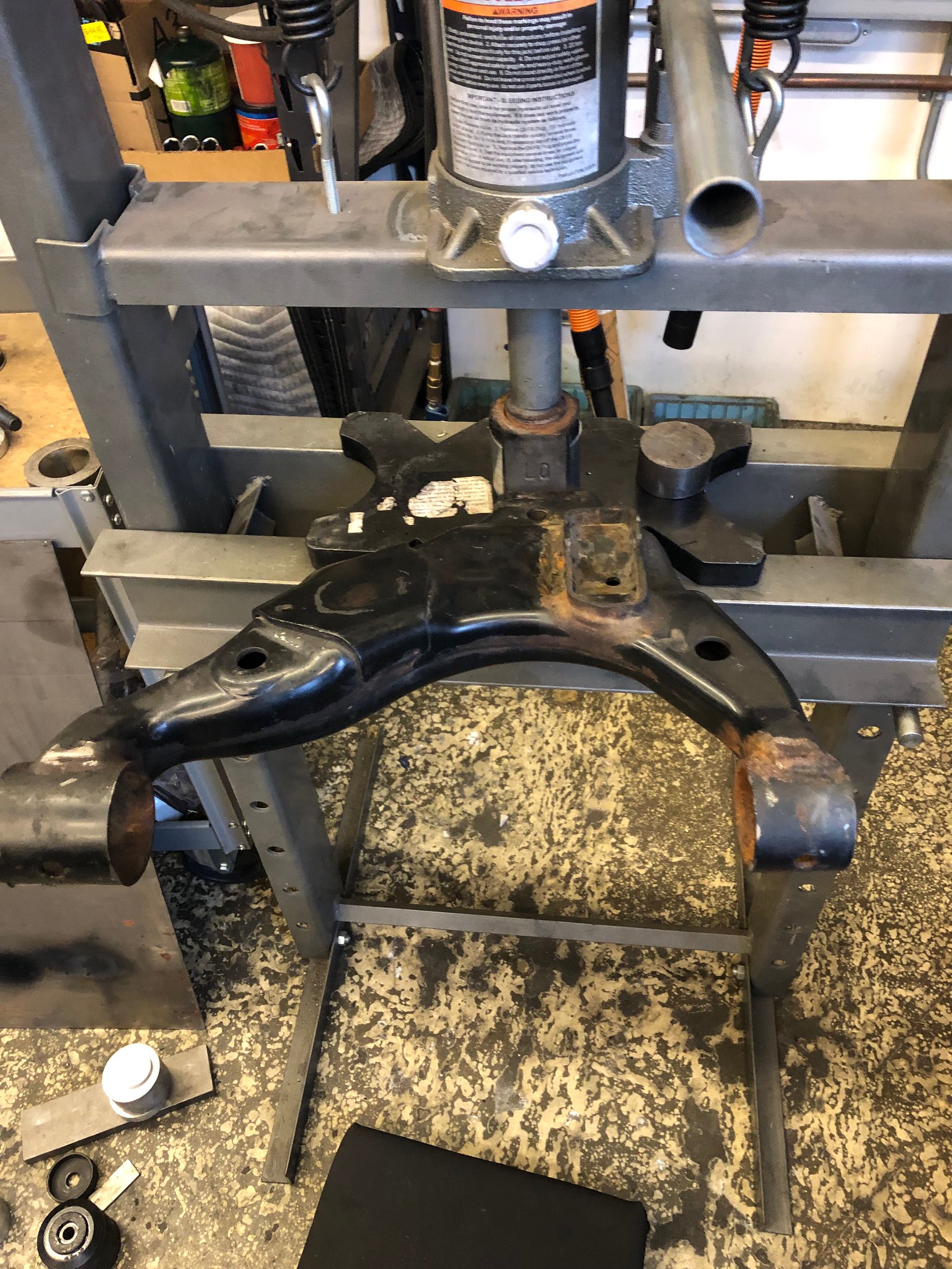

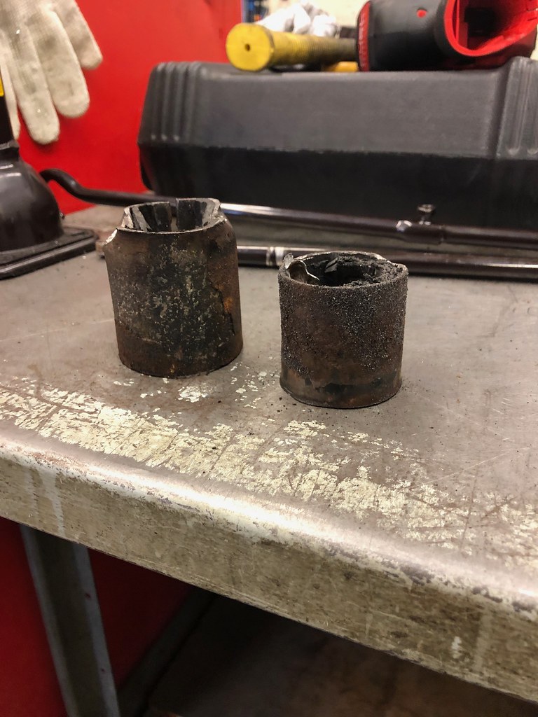

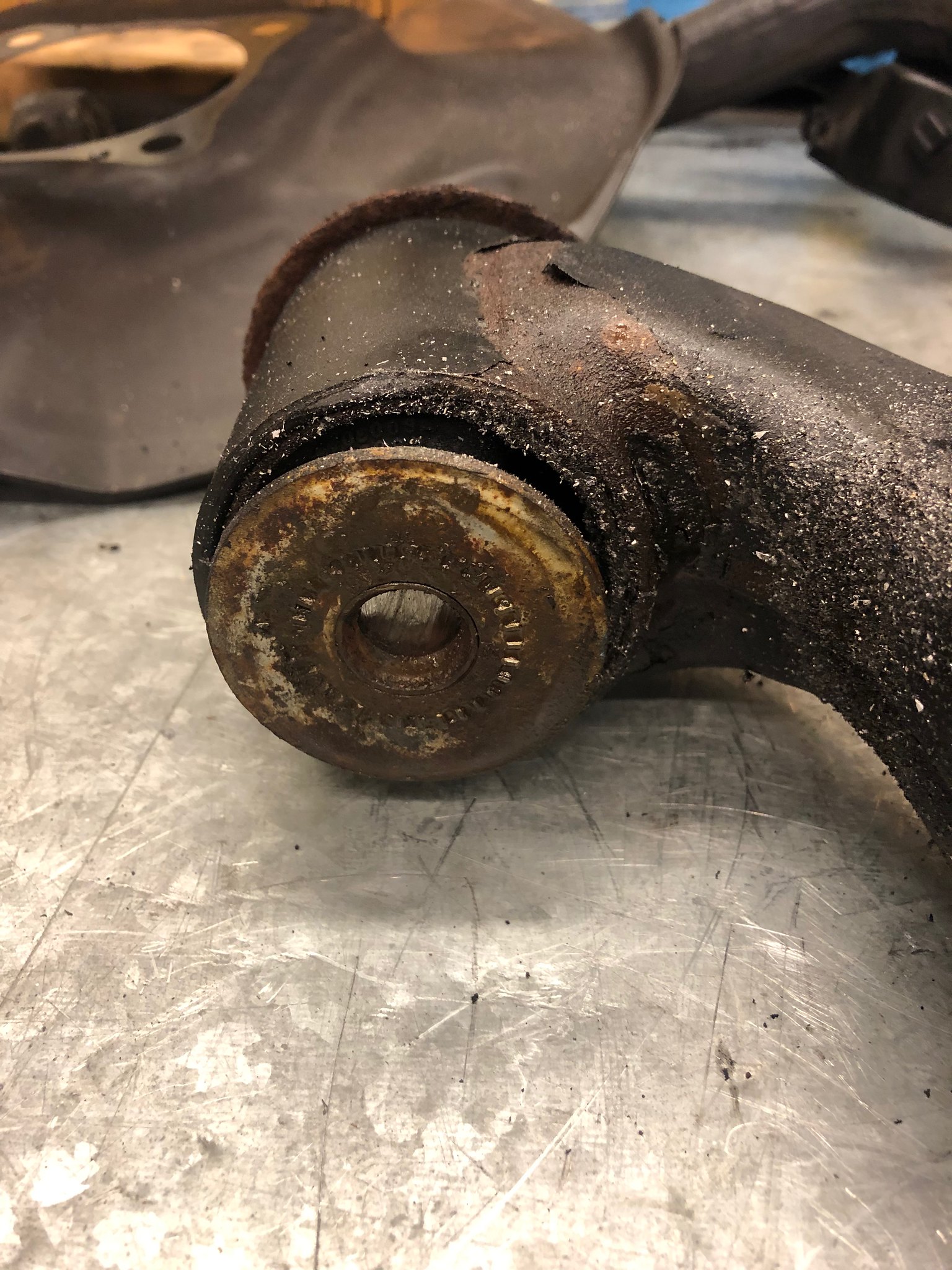

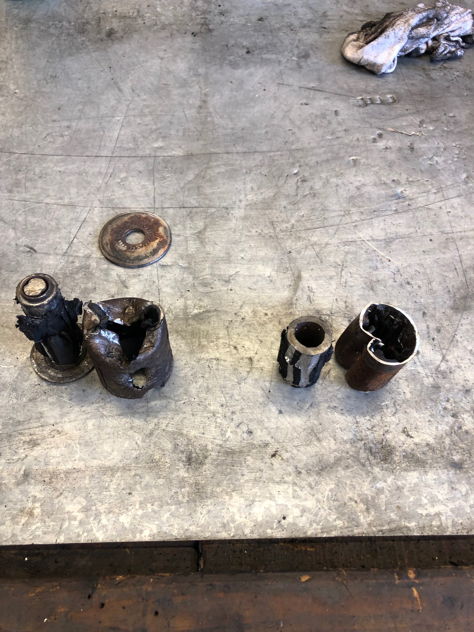

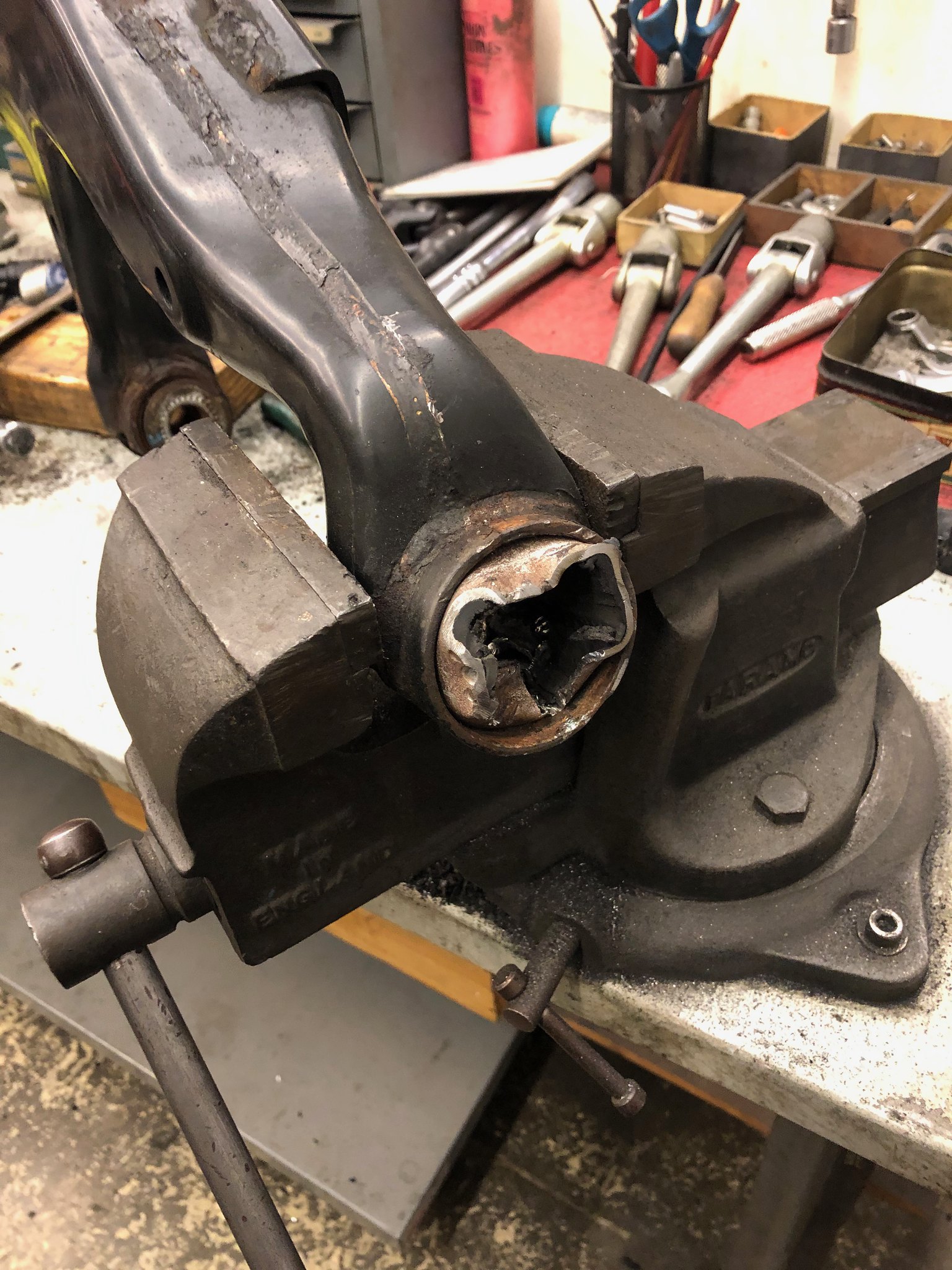

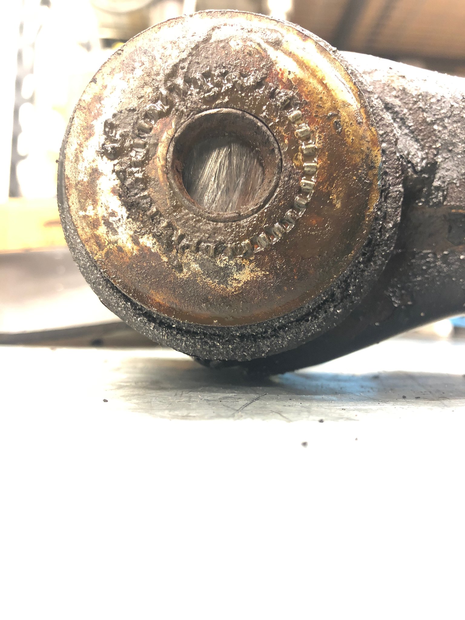

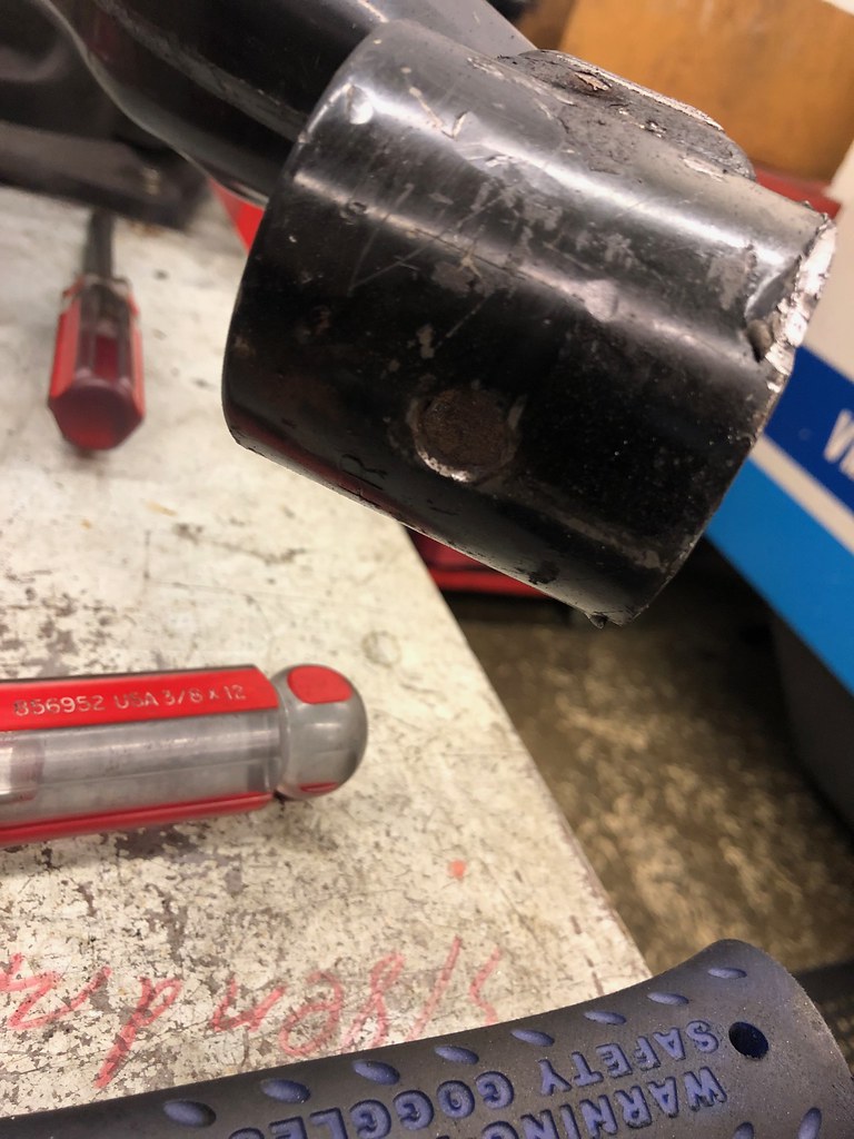

then the next fight was to remove the bushings. omg one of the most difficult projects i have taken on. i can build an engine with less effort compared to this.
first approach was the botte jack method and propane torch.
this just started to bend the control arm open.
IMG_1704 by ALEXANDER RENGIFO, on Flickr

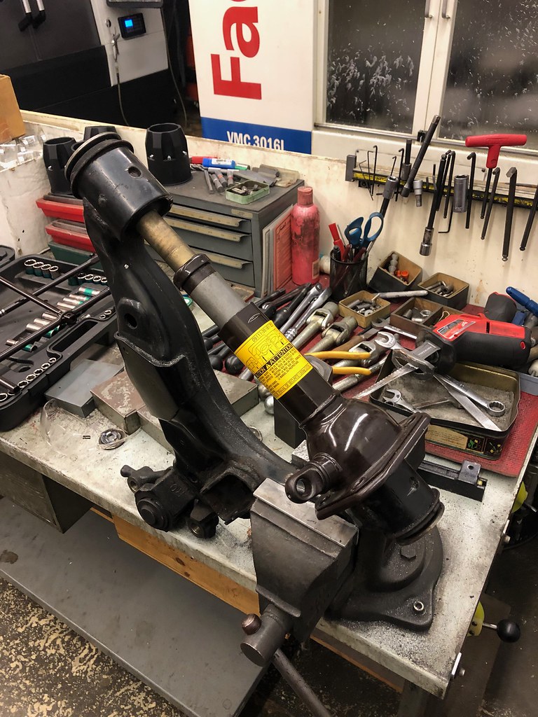

then i tried this tool and it bent the rod!!!! the biggest problem is there isnt a big enough shoulder on the control arm to support an extraction tool.
IMG_1703 by ALEXANDER RENGIFO, on Flickr
some more you tube searching led me to a bearing splitter tool.
harbor freight ftw
IMG_1711 by ALEXANDER RENGIFO, on Flickr
that didnt work either it just started to dig into the steel of the arm.
IMG_1714 by ALEXANDER RENGIFO, on Flickr
IMG_1726 by ALEXANDER RENGIFO, on Flickr
12 hours later i had 2 bushings out.
i ended up hammering them out with a punch and a sledge hammer.

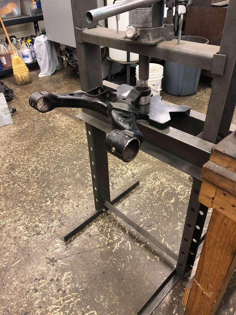

next up.

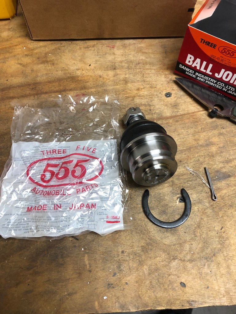

pressing out the ball joints. this went much easier as there is plenty of shoulder to support a tool.
IMG_1729 by ALEXANDER RENGIFO, on Flickr

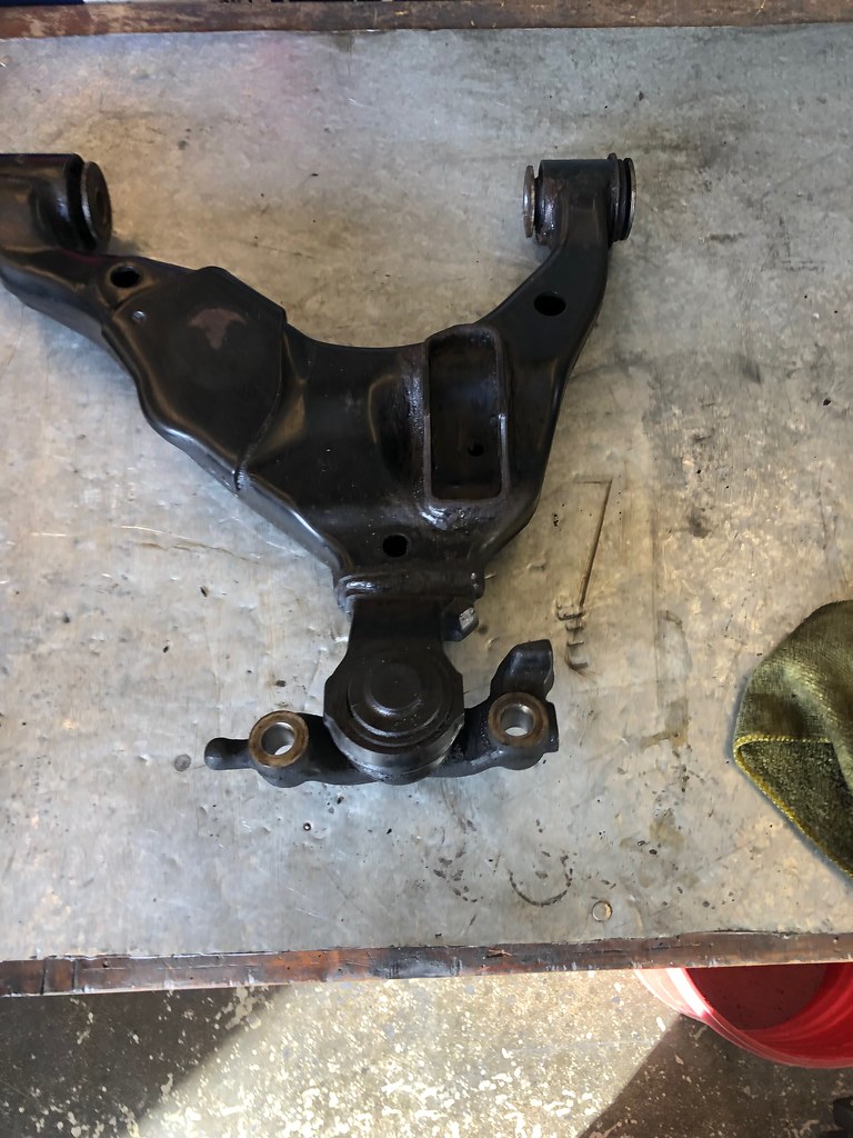

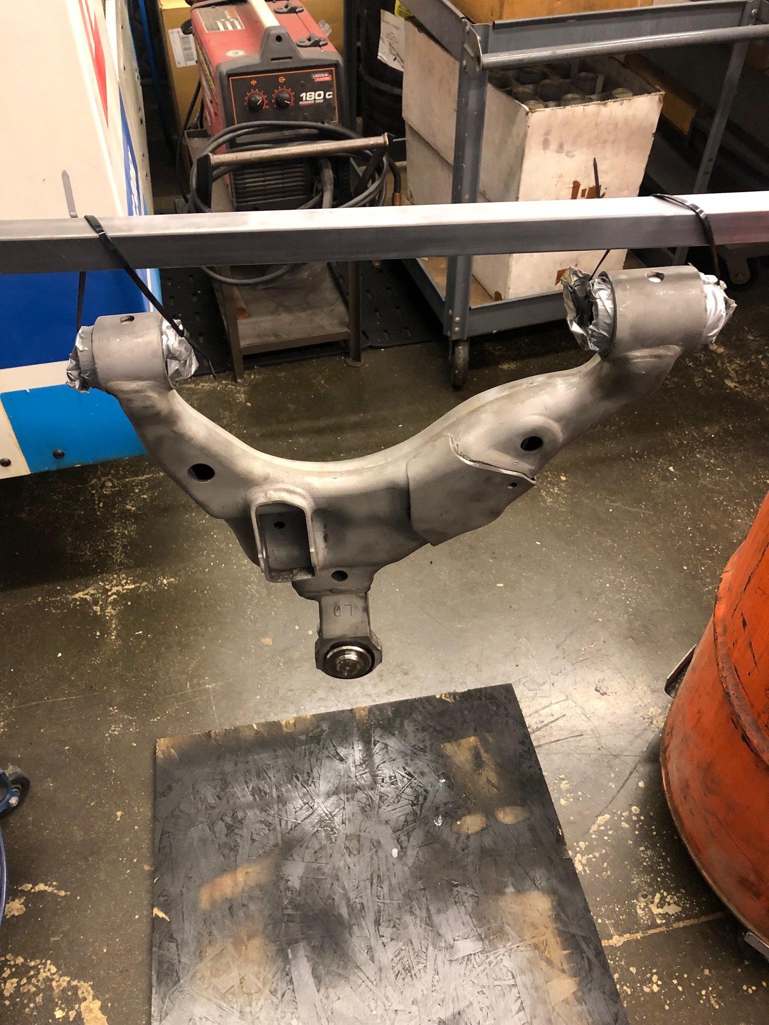

all bushings and ball joints pressed out.
IMG_1730 by ALEXANDER RENGIFO, on Flickr
new hardware since i cut mine all apart trying to extract these.
IMG_1732 by ALEXANDER RENGIFO, on Flickr

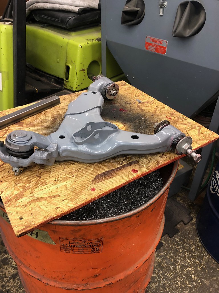

sand blasted, painted, ball joint pressed in, bushings pressed in, new hardware.
i felt a huge sigh of relief once i got to this point. then remembered i still have to do the other side !!!!!

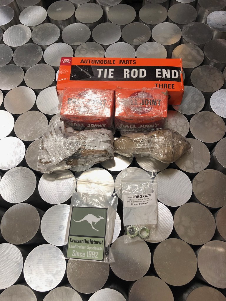

i bought a bunch of parts from cruiser outfitters.

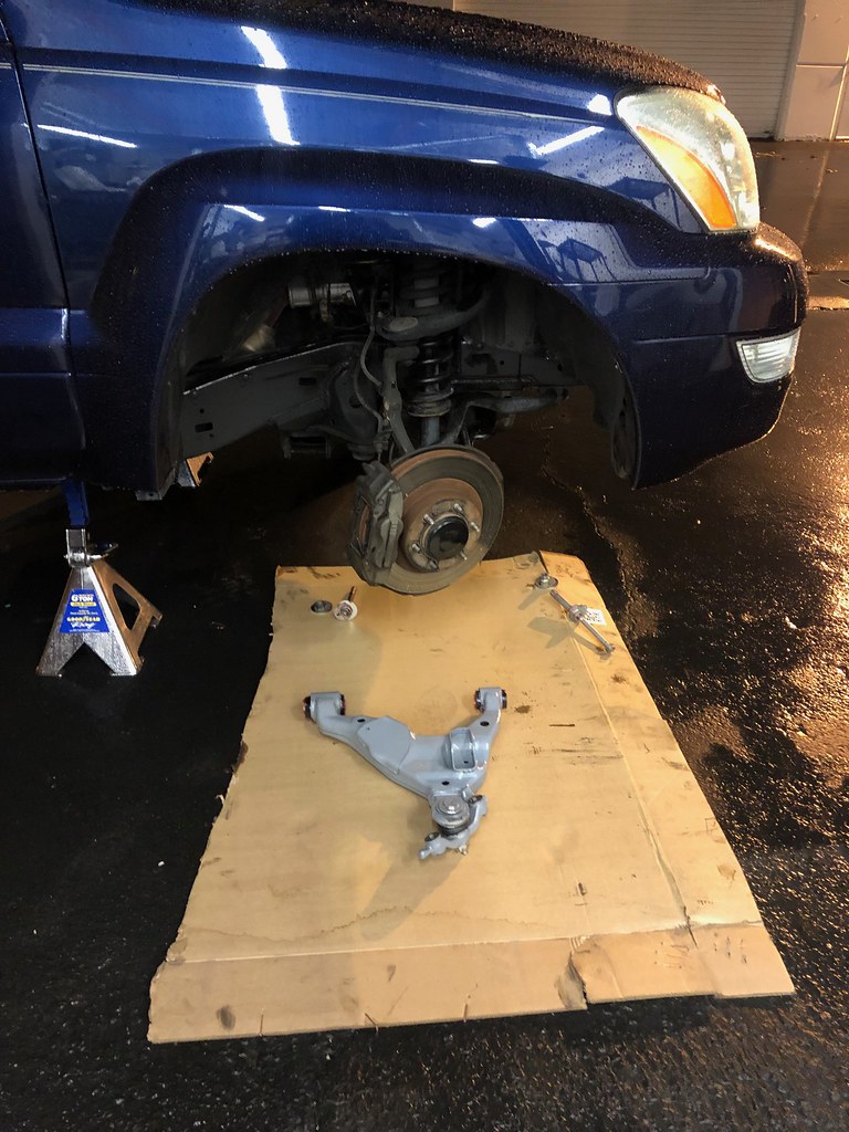

installing the control arm in the rain.
IMG_1735 by ALEXANDER RENGIFO, on Flickr
one down one to go.

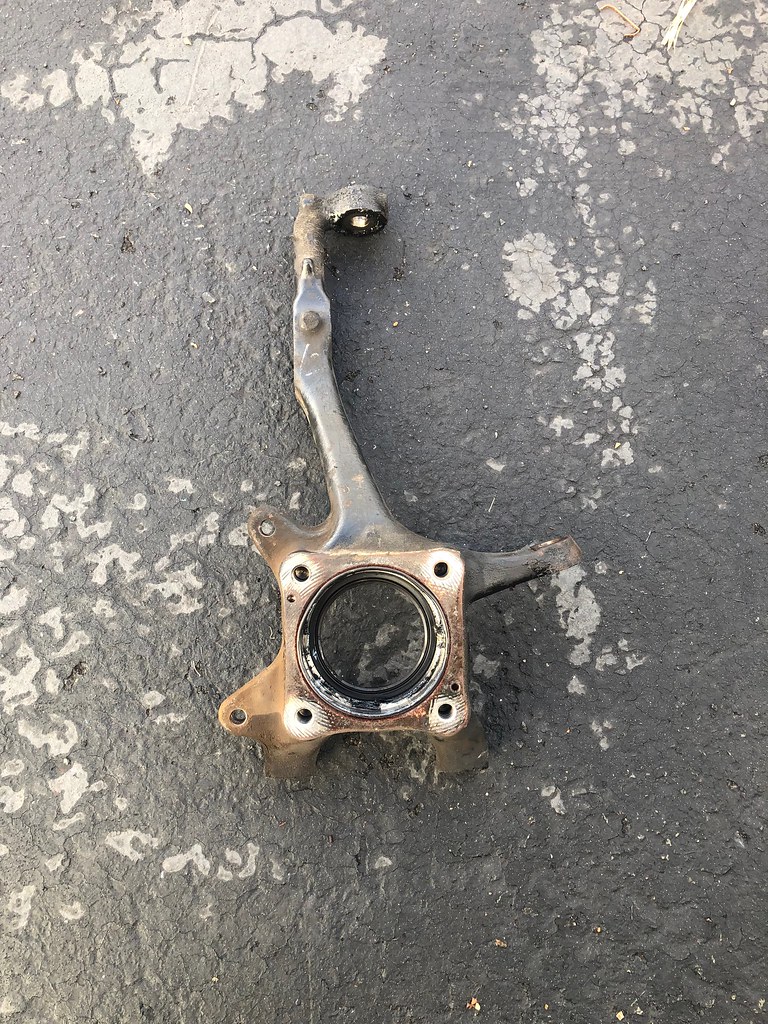

passenger spindle.
super dirty.
IMG_1802 by ALEXANDER RENGIFO, on Flickr
bearing out
IMG_1804 by ALEXANDER RENGIFO, on Flickr

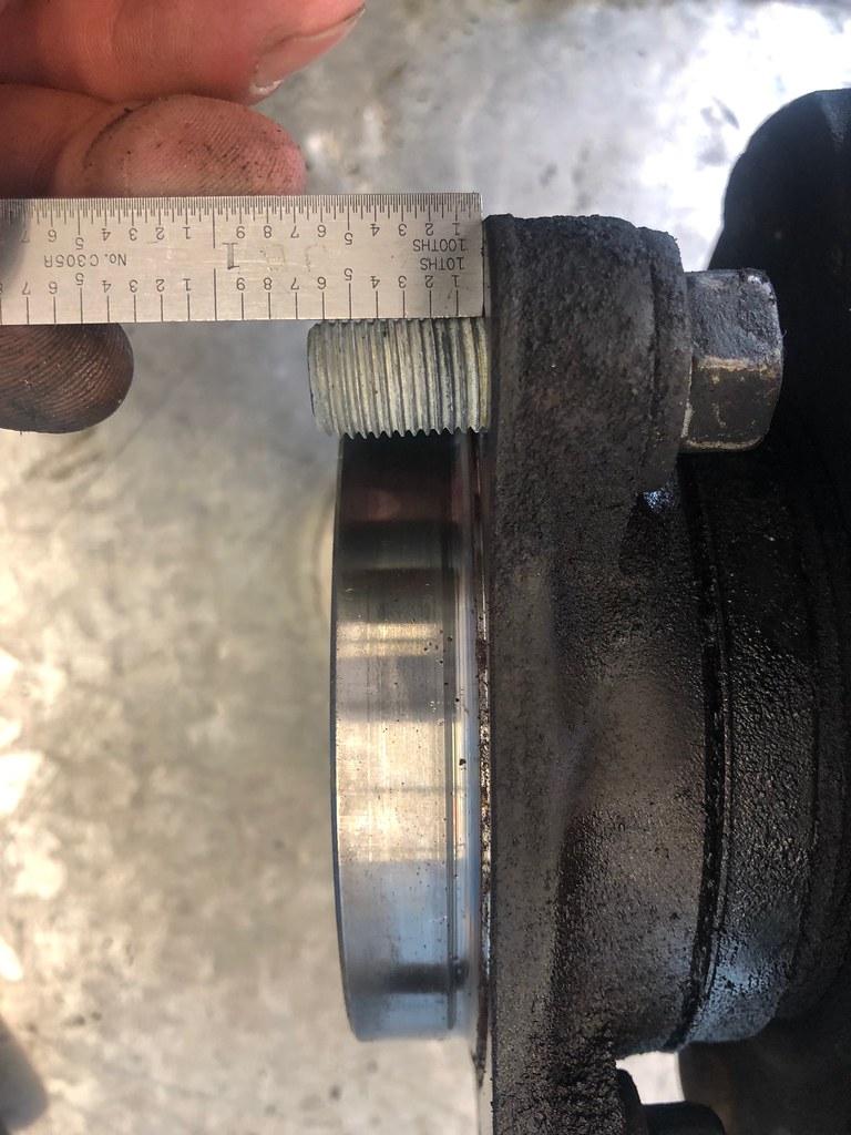

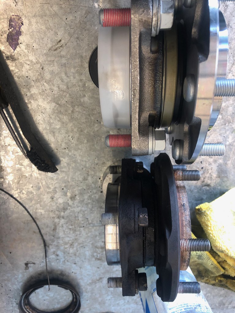

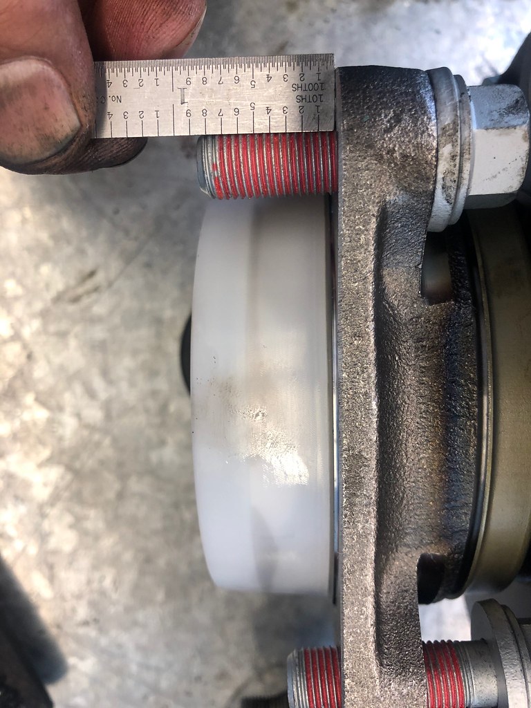

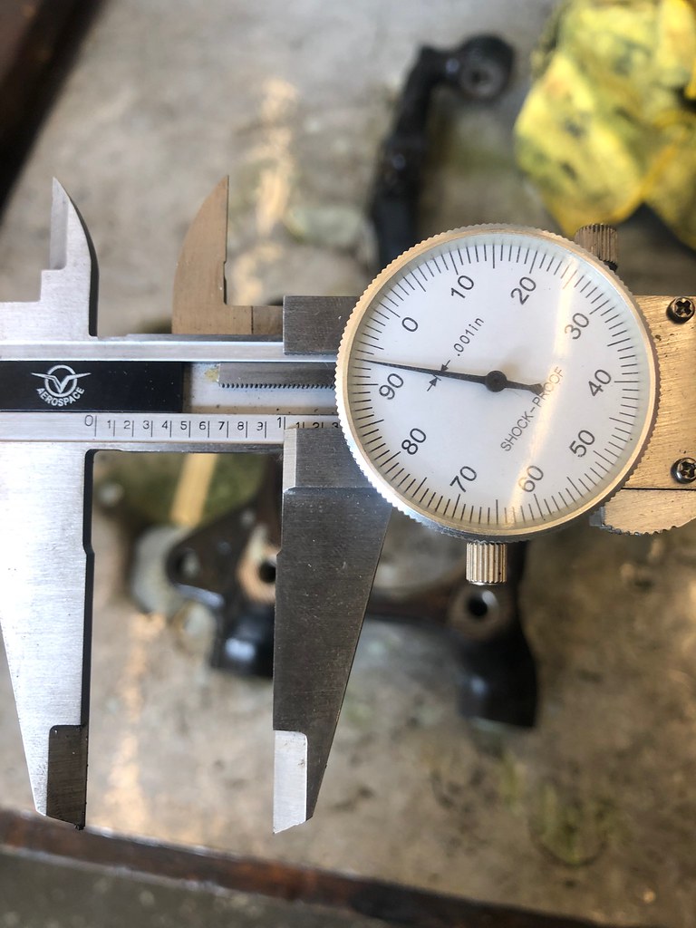

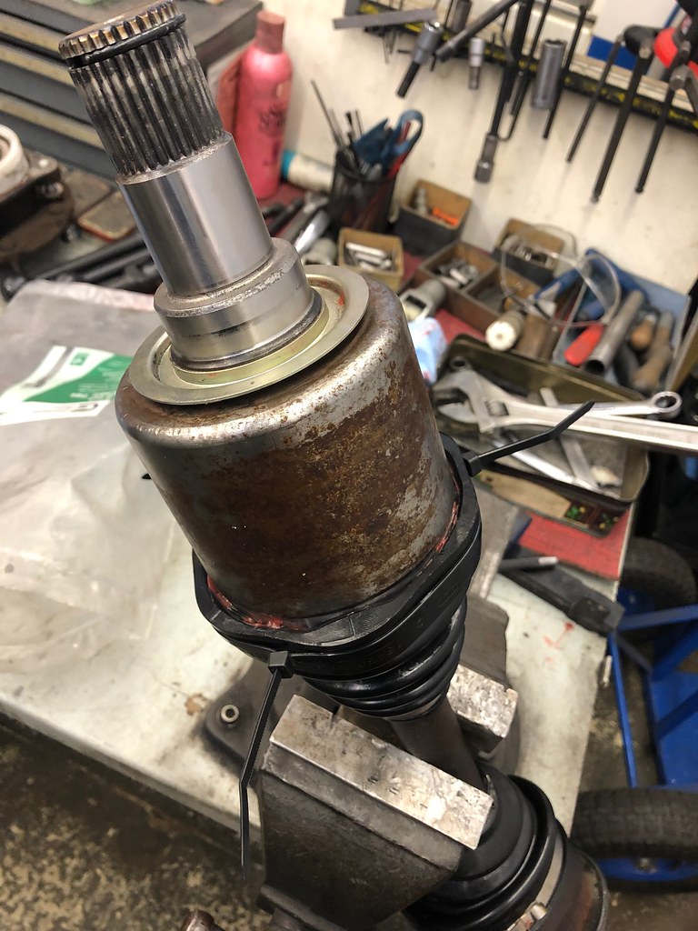

thread length
IMG_1805 by ALEXANDER RENGIFO, on Flickr
thread length on doorman hubs
IMG_1807 by ALEXANDER RENGIFO, on Flickr
IMG_1808 by ALEXANDER RENGIFO, on Flickr
hole depth
IMG_1810 by ALEXANDER RENGIFO, on Flickr

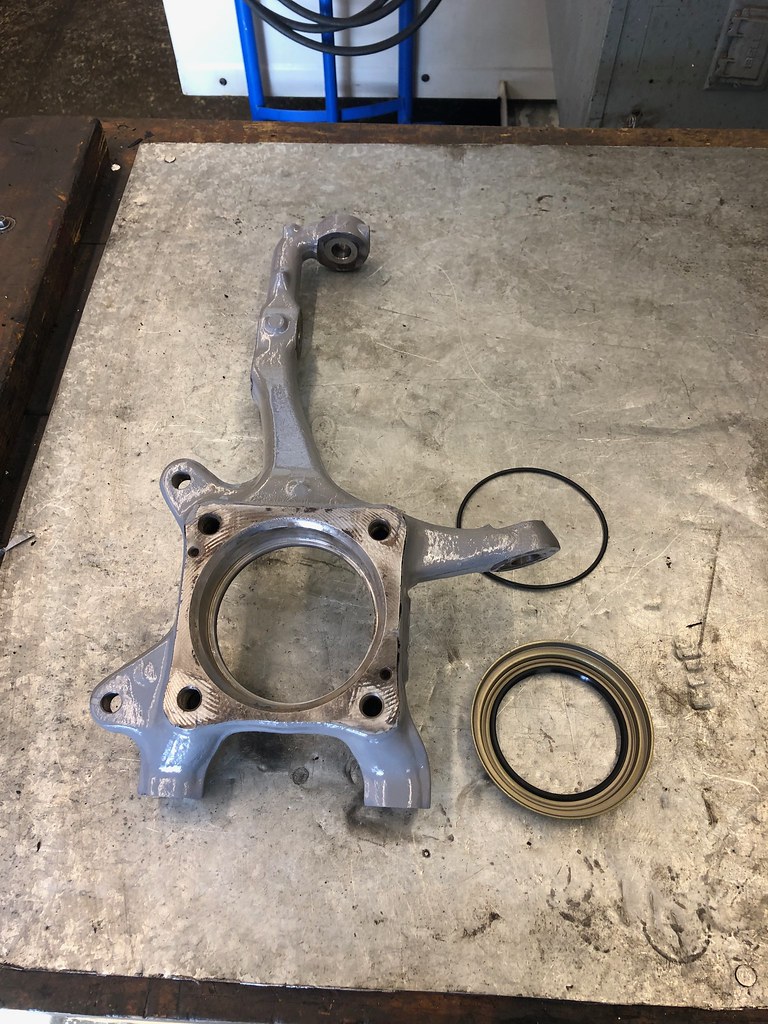

ready for the spindle
IMG_1817 by ALEXANDER RENGIFO, on Flickr
cleaned sand blasted masked painted
IMG_1818 by ALEXANDER RENGIFO, on Flickr

what did you use for cleaning the engine bay? Mine isn’t super dirty, but it’s not nearly as pristine as yours.
I need to replace the bushings in mine (or get new LCAs), and from my limited research, this seems to be the case for a lot of folks. This was the main video I watched, and he even had to cut his out cause the bottle jack method wasn’t working. Basically I haven’t found a story of someone who had an easy time replacing the bushings.
I come from the world of race cars and sports cars so I wanted a polyurethane bushing for the control arm. If you are okay with fresh rubber I would just eat the cost and get Toyota control arms. Not the total chaos or the aftermarket ones.
Such a pain the ass.
I used simple green for the first coat
And this for the second coat

more parts arriving
eim keith pan hard relocation bracket

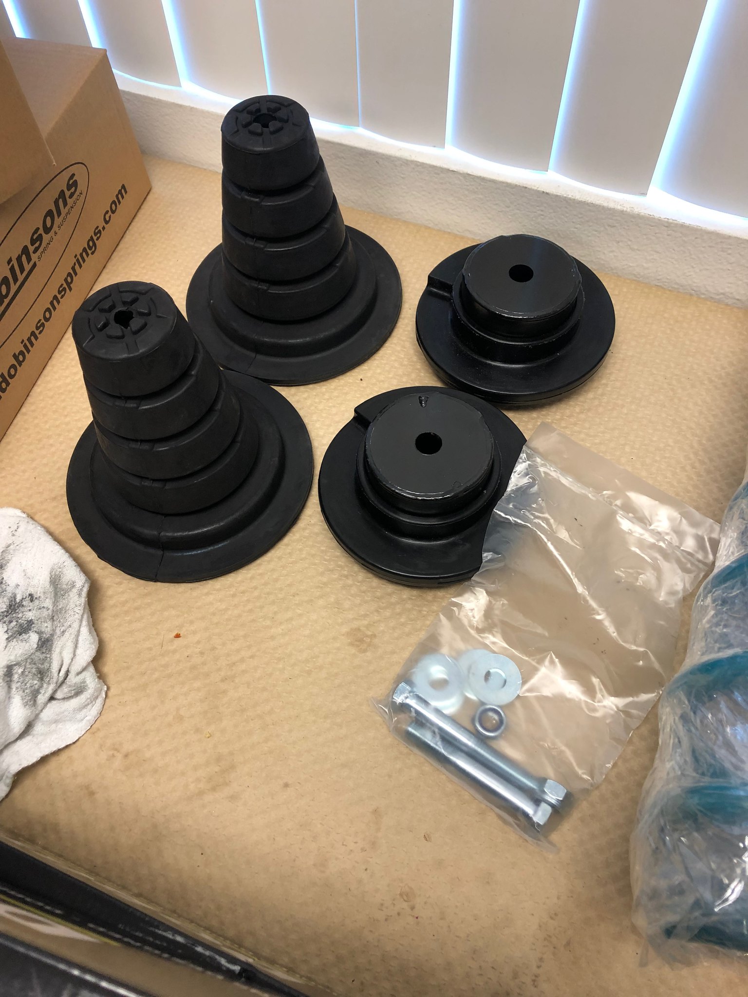

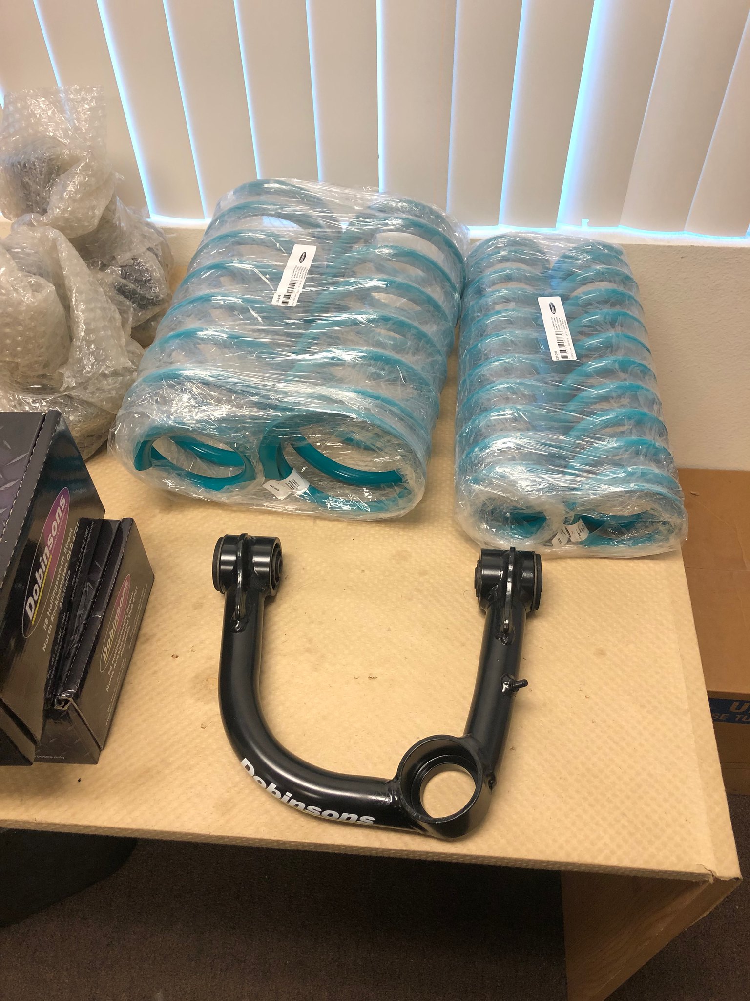

spring conversion kit from dobinsons. and upper coil bump stops
IMG_1889 by ALEXANDER RENGIFO, on Flickr

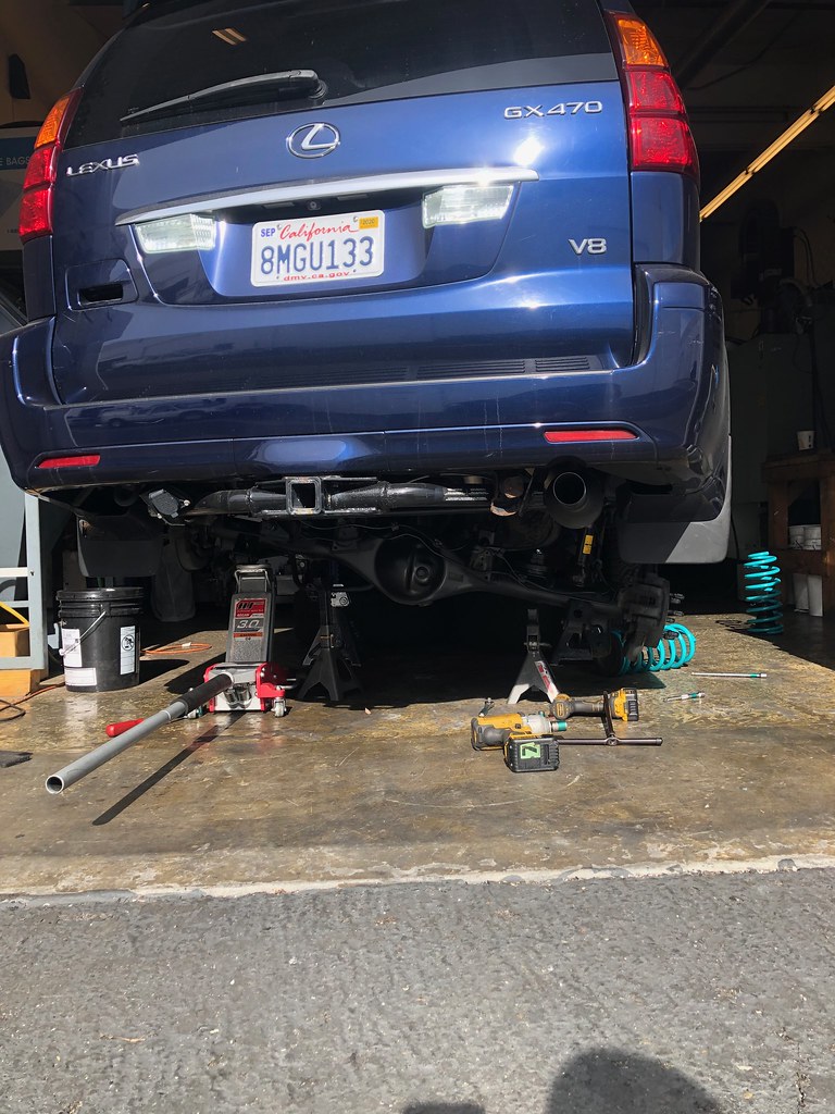

i had the lexus taken apart so i had to take my other car to pick up tires. I could pick up one in the passenger seat and one in the trunk.
IMG_1898 by ALEXANDER RENGIFO, on Flickr
IMG_1899 by ALEXANDER RENGIFO, on Flickr

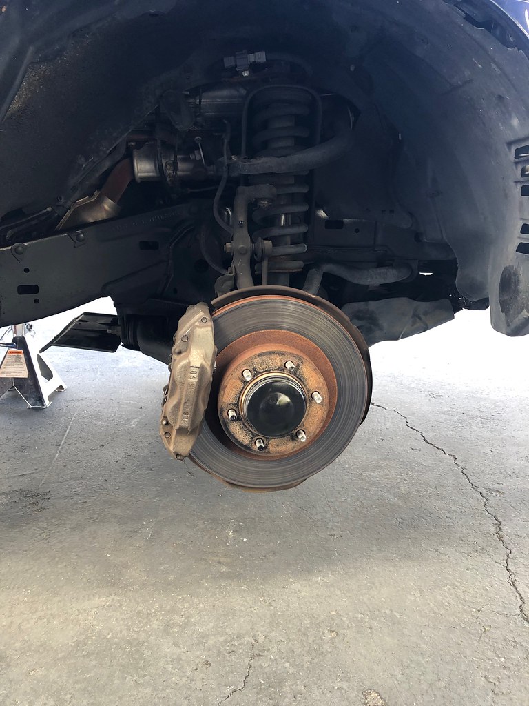

got started rebuilding the driver side control

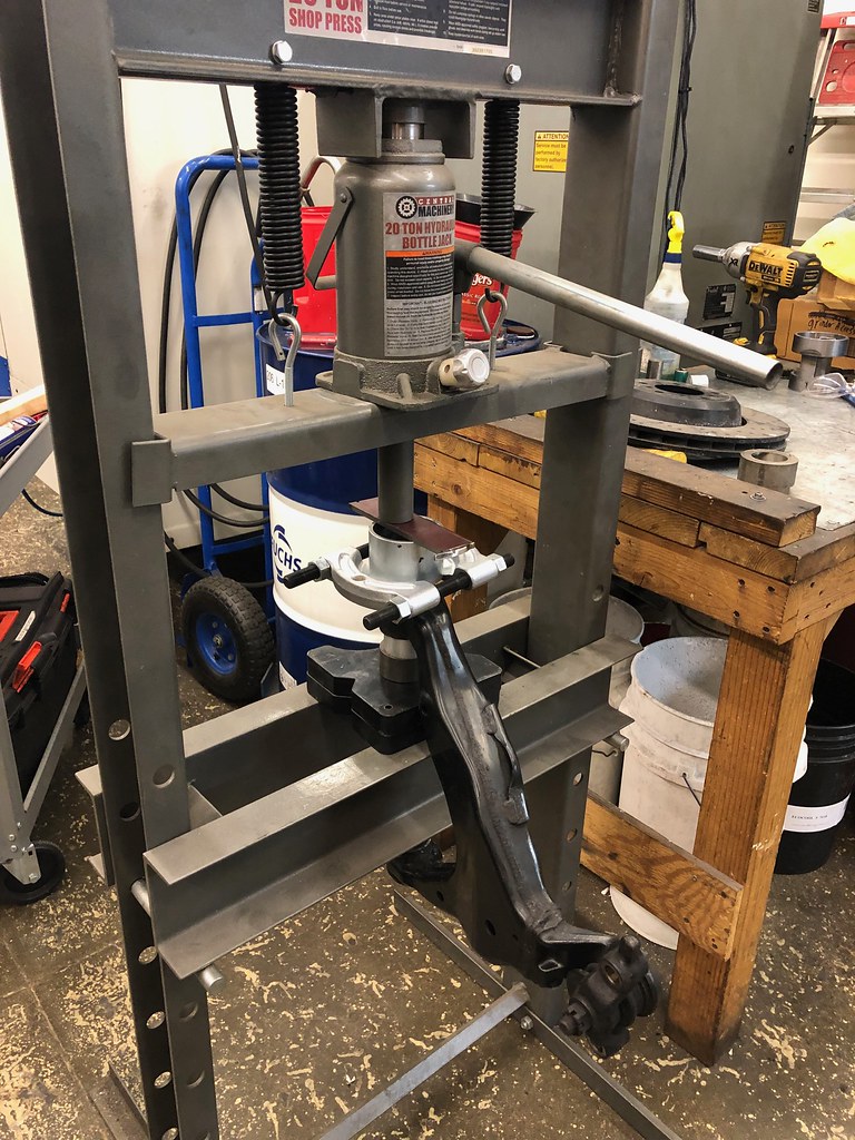

IMG_1927 by ALEXANDER RENGIFO, on Flickr
sand blasted control arm

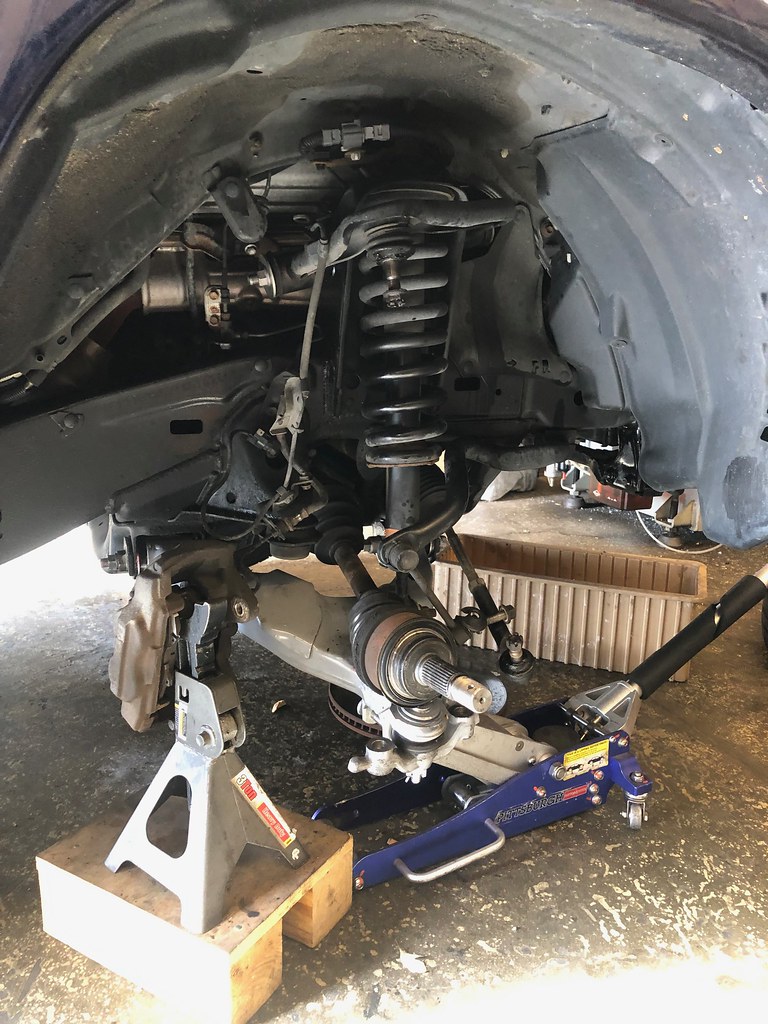

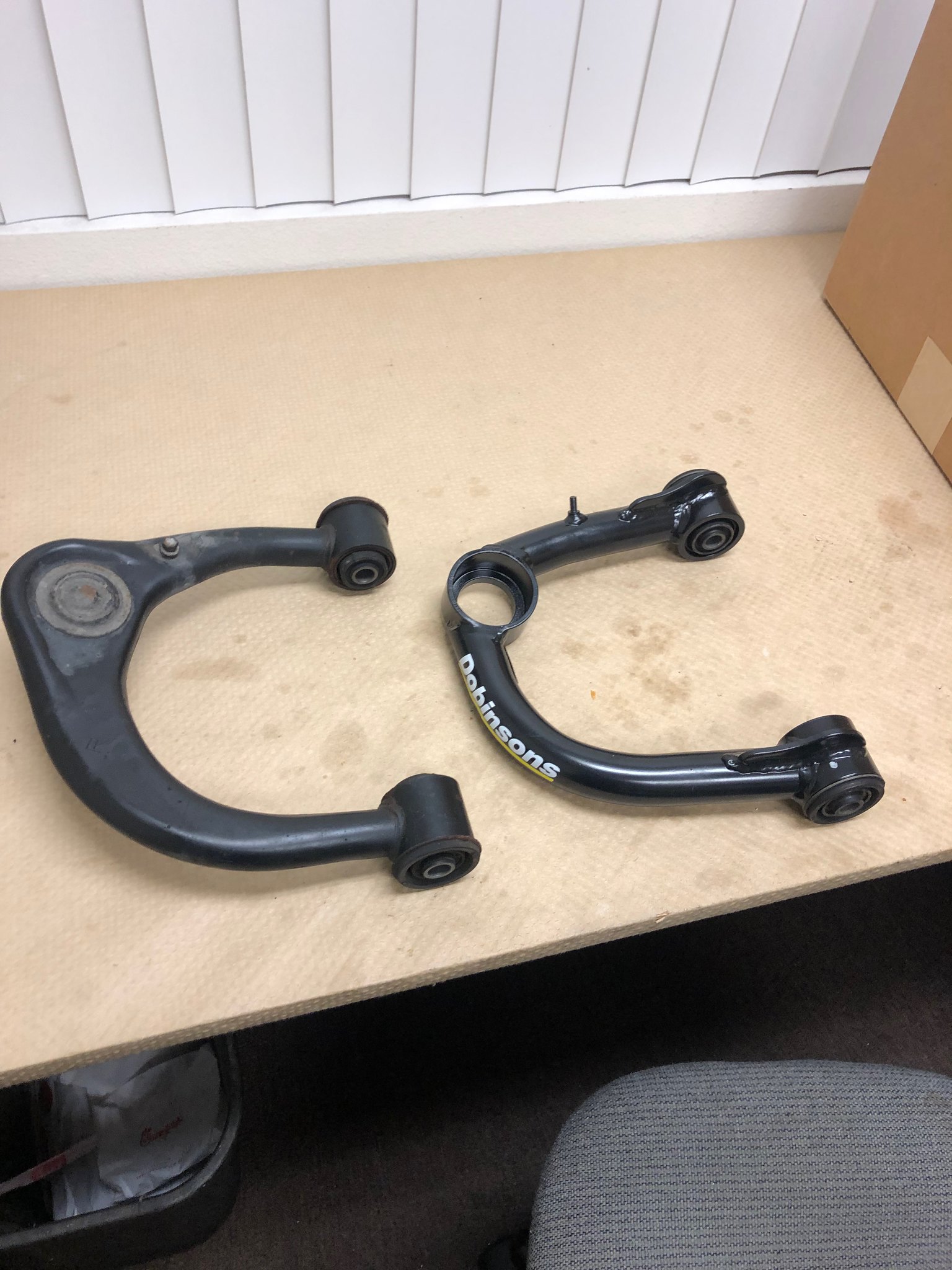

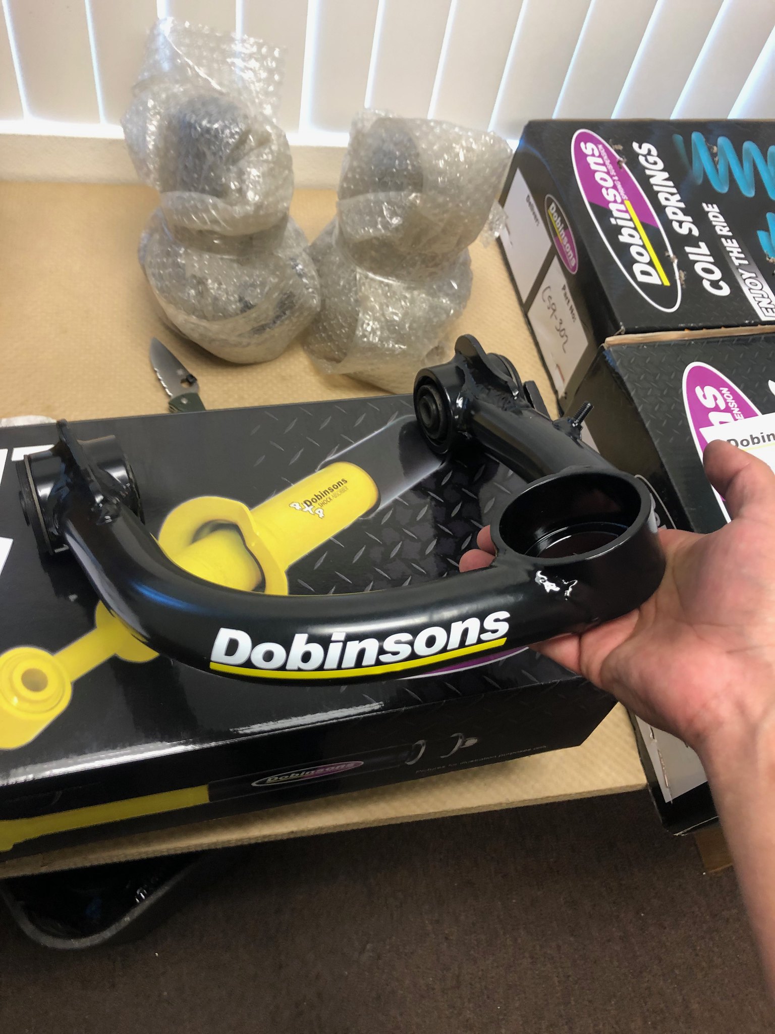

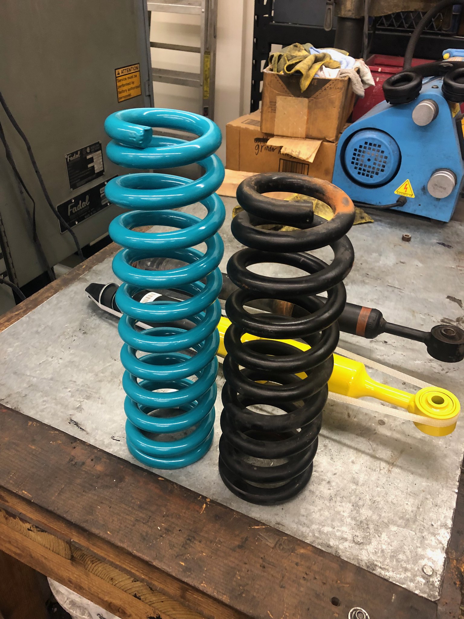

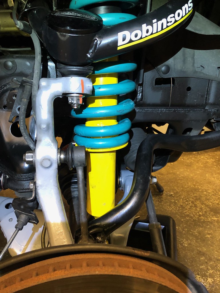

comparing the old upper control arms with the dobinsons
IMG_1930 by ALEXANDER RENGIFO, on Flickr

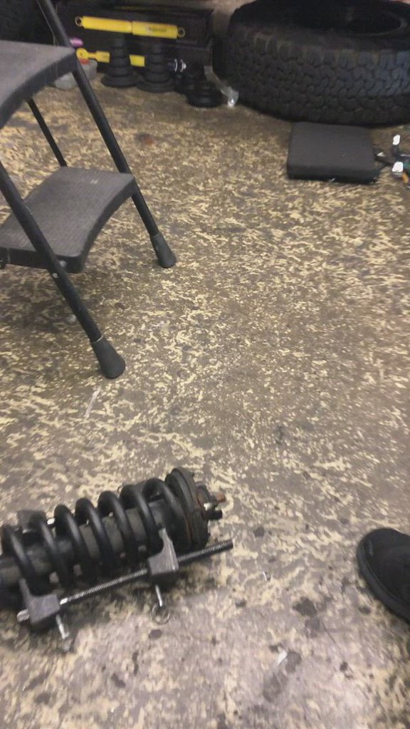

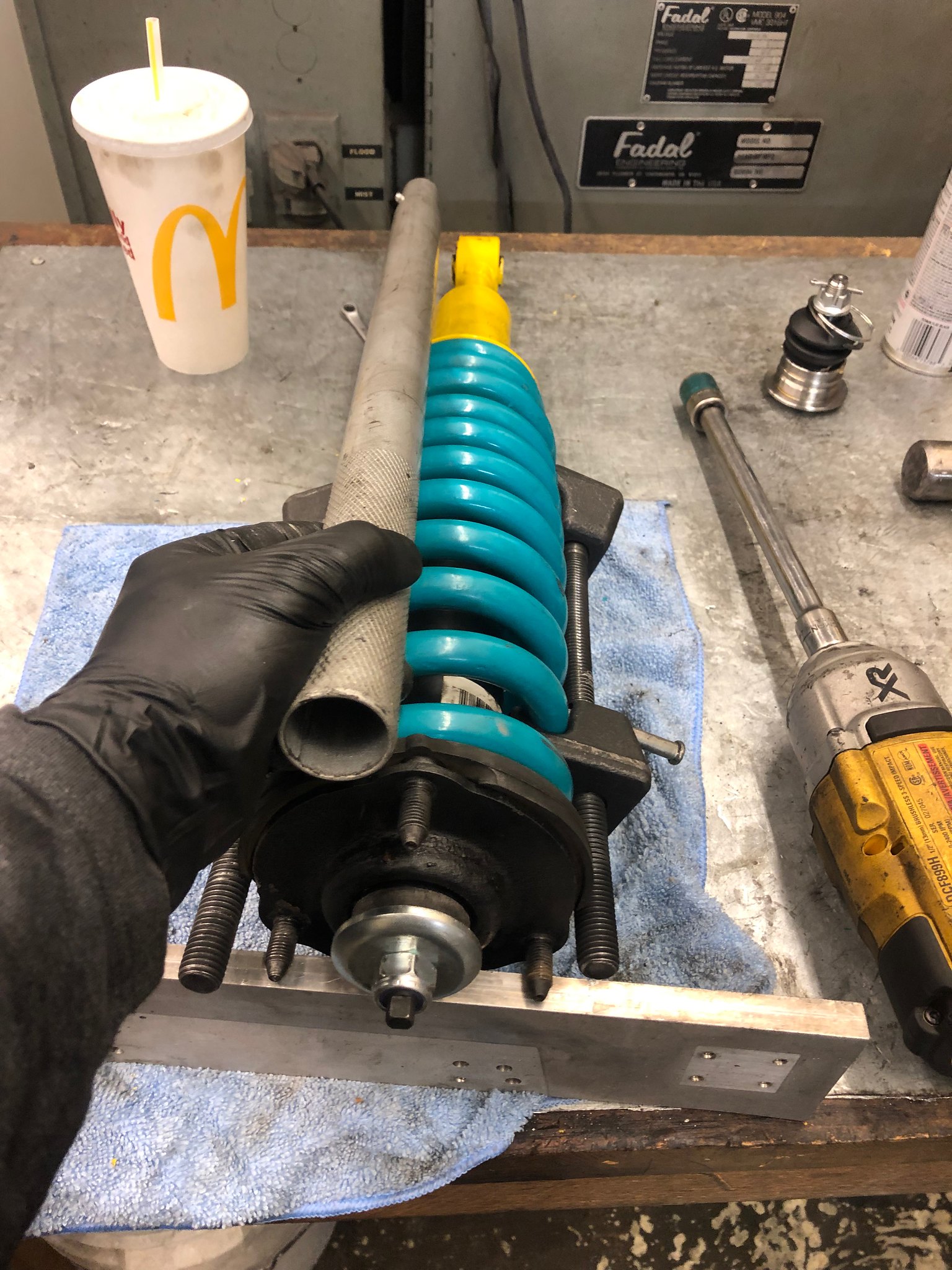

compressing the springs.

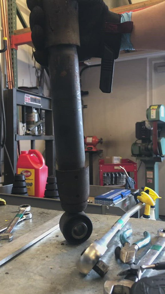

little video clip removing the strut nut
IMG_1944 by ALEXANDER RENGIFO, on Flickr

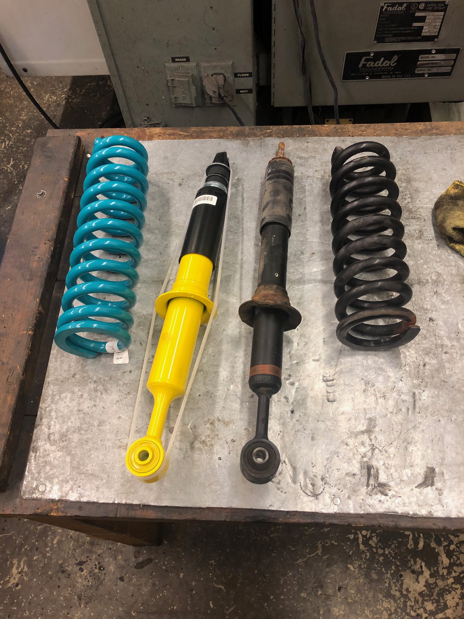

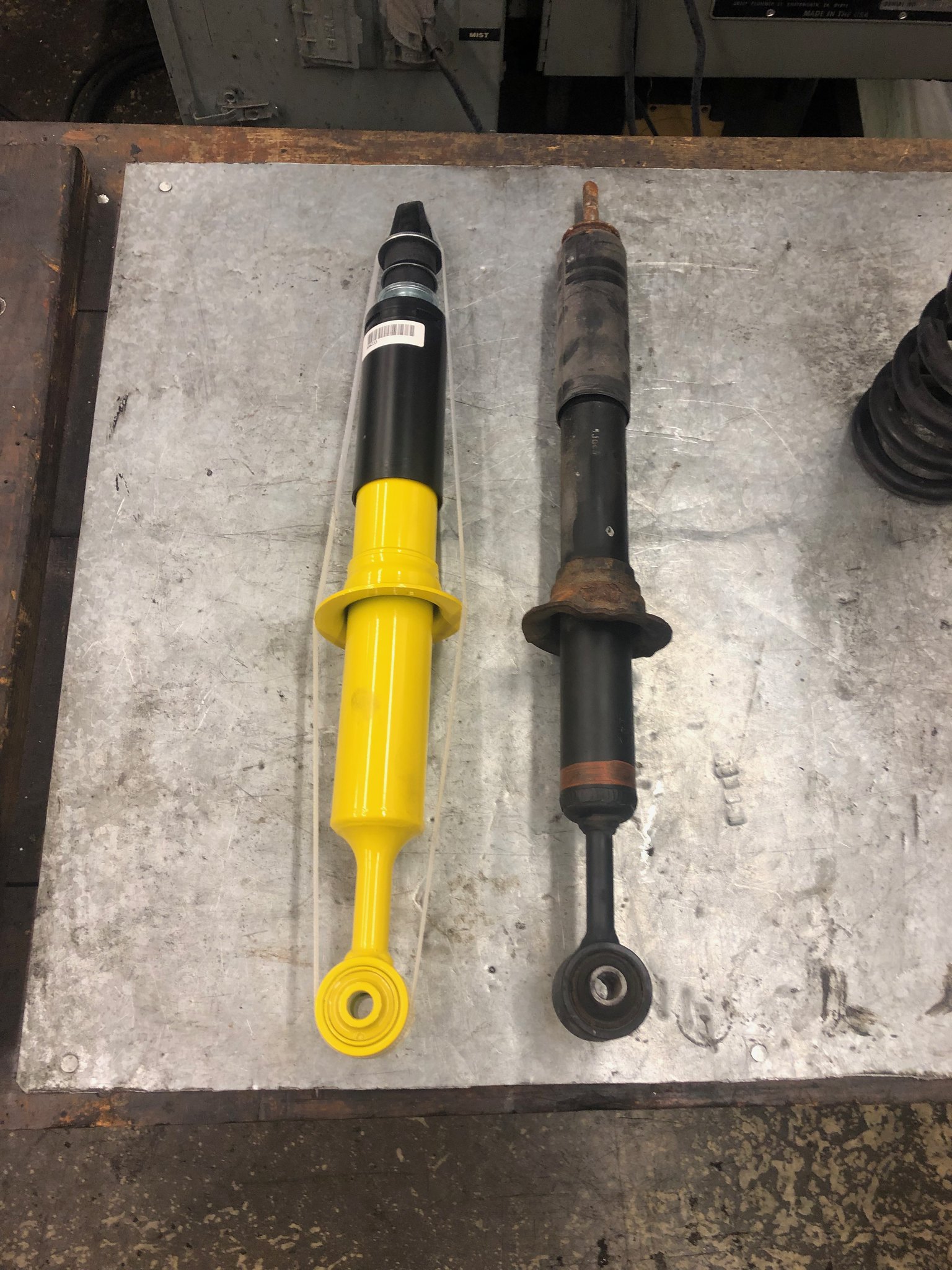

old vs new
IMG_1945 by ALEXANDER RENGIFO, on Flickr
old vs new
IMG_1948 by ALEXANDER RENGIFO, on Flickr
3inch lift
IMG_1949 by ALEXANDER RENGIFO, on Flickr

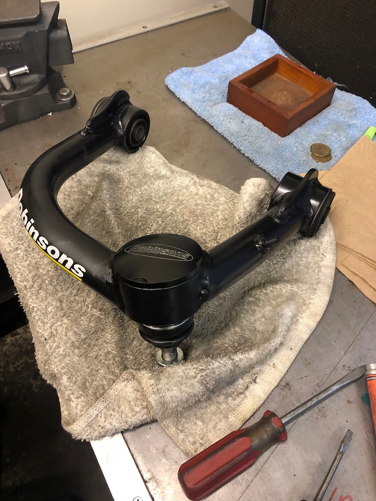

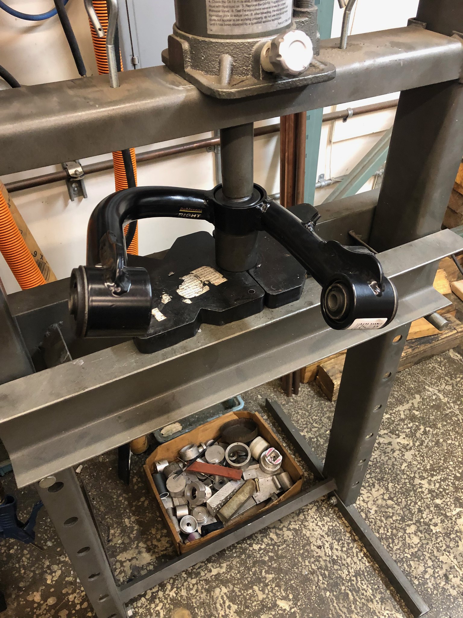

pressing in ball joints in the dobinsons control arms
IMG_1951 by ALEXANDER RENGIFO, on Flickr

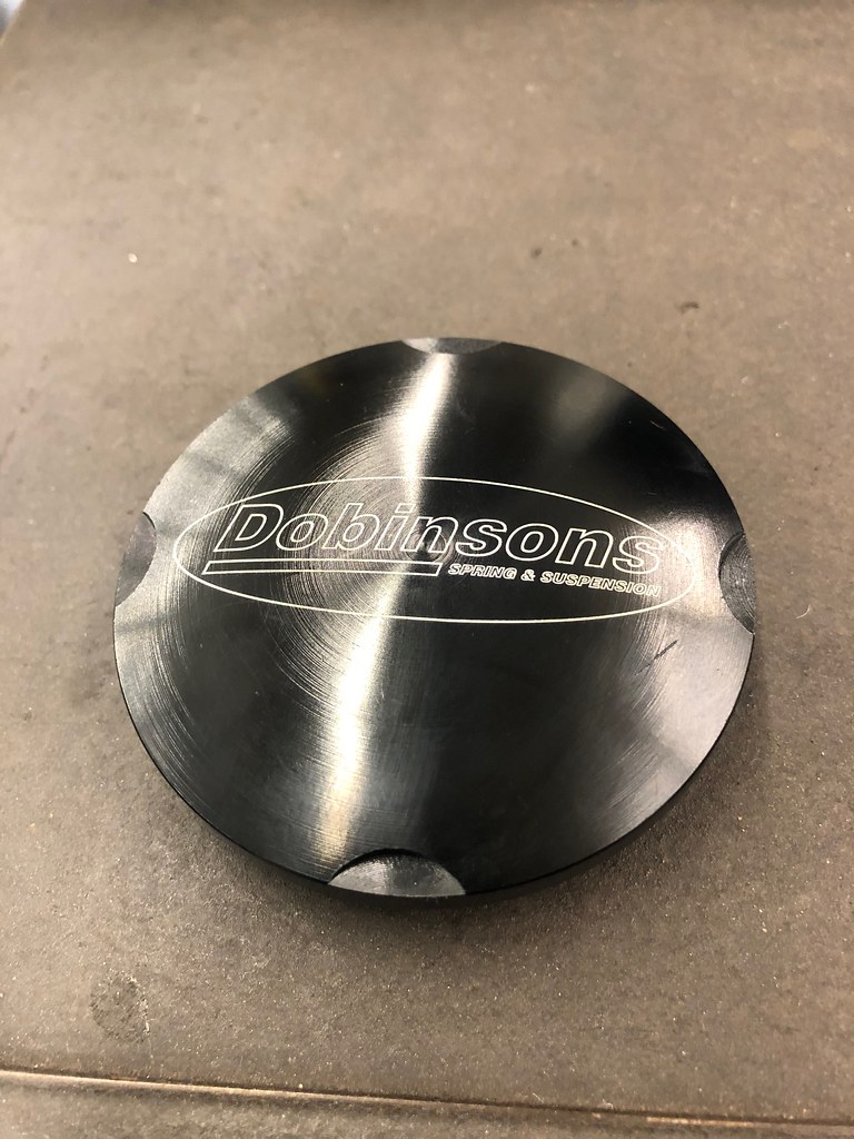

impressed with the machining on the dobinsons cap
IMG_1973 by ALEXANDER RENGIFO, on Flickr
ball joint installed and cap installed

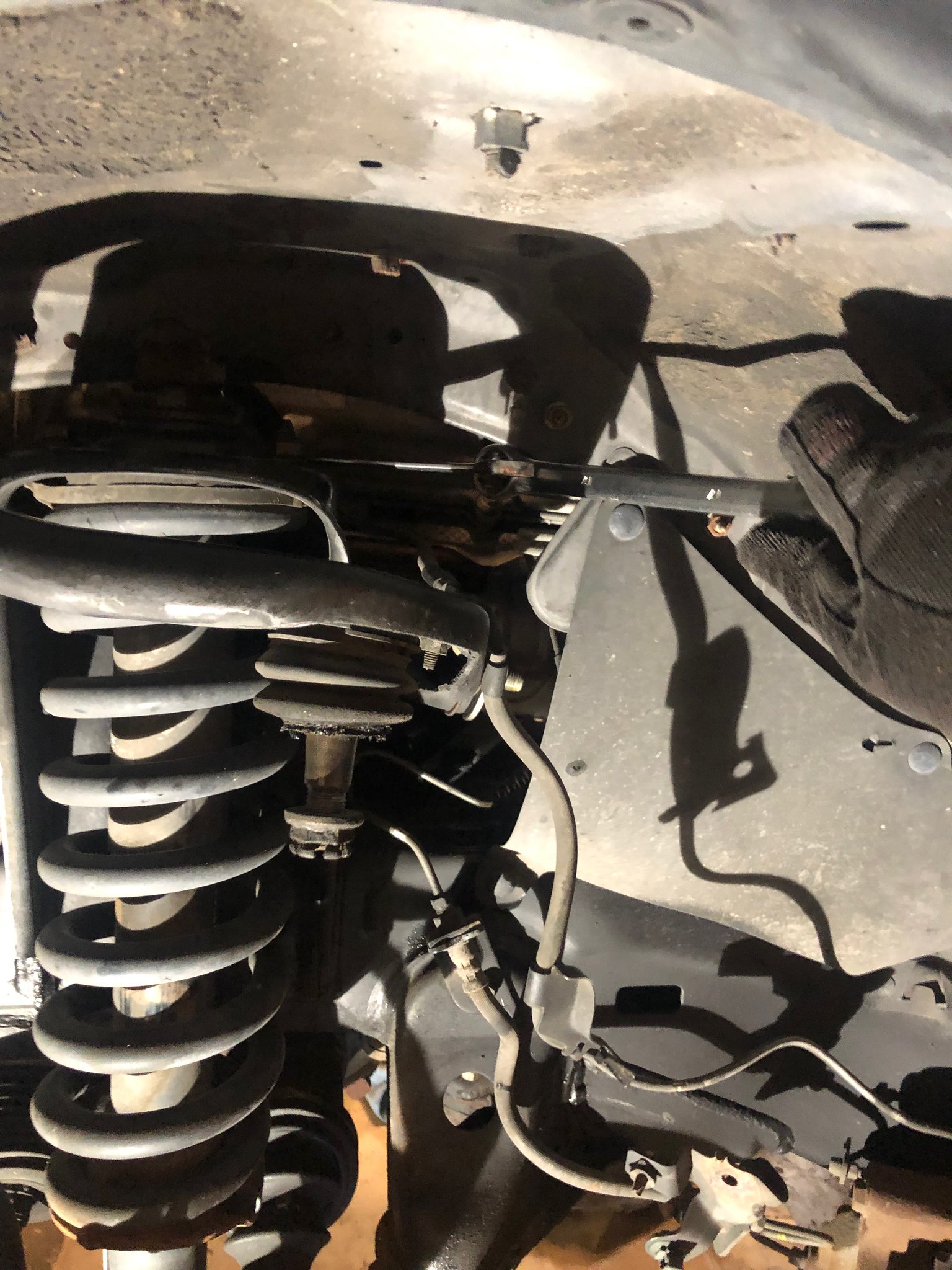

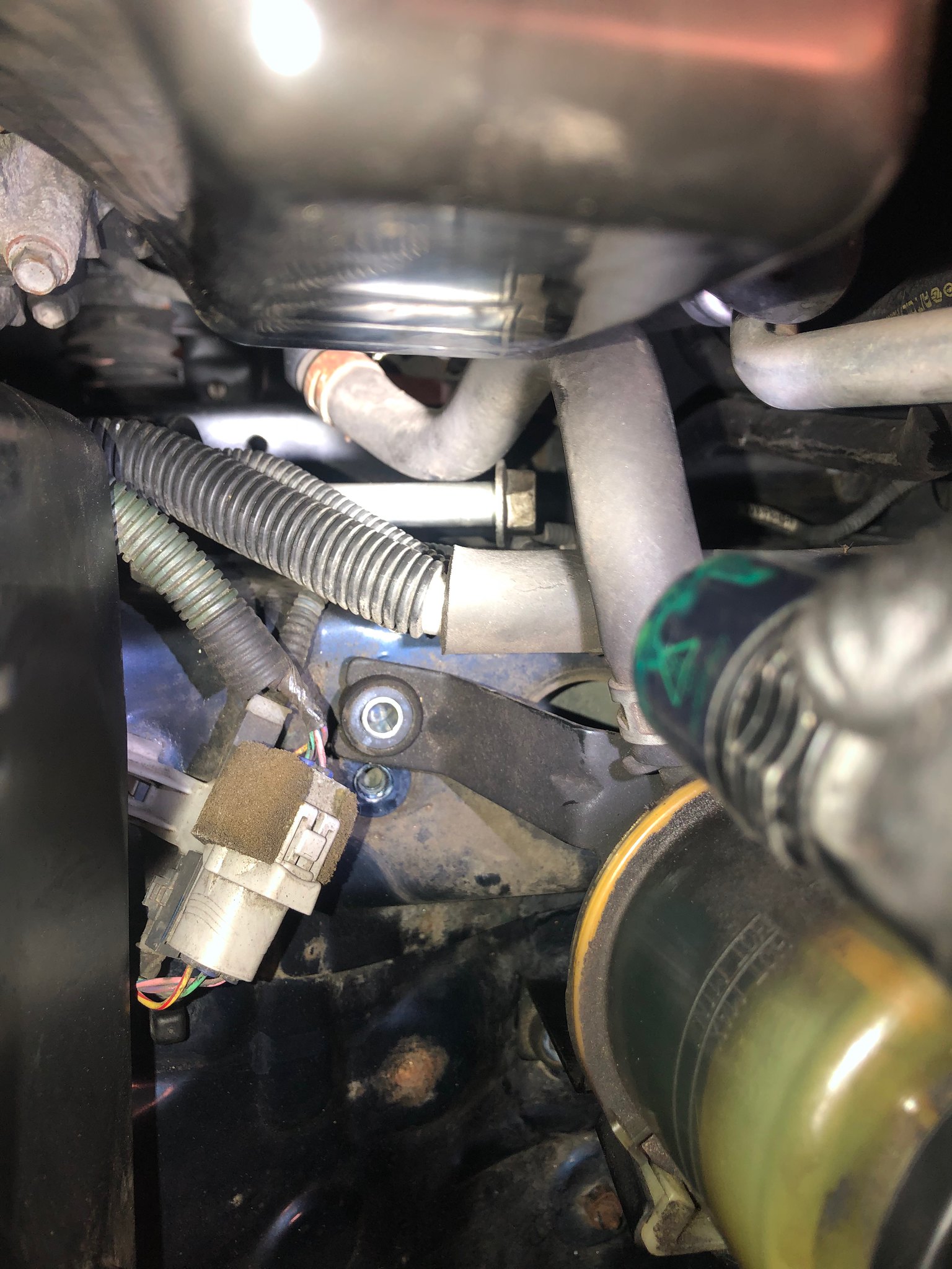

if you remove the power steering reservoir you can extract the long upper control arm bolt. you dont have to bend sheet metal like the tacoma
driver side you can remove the battery to get the bolt out.

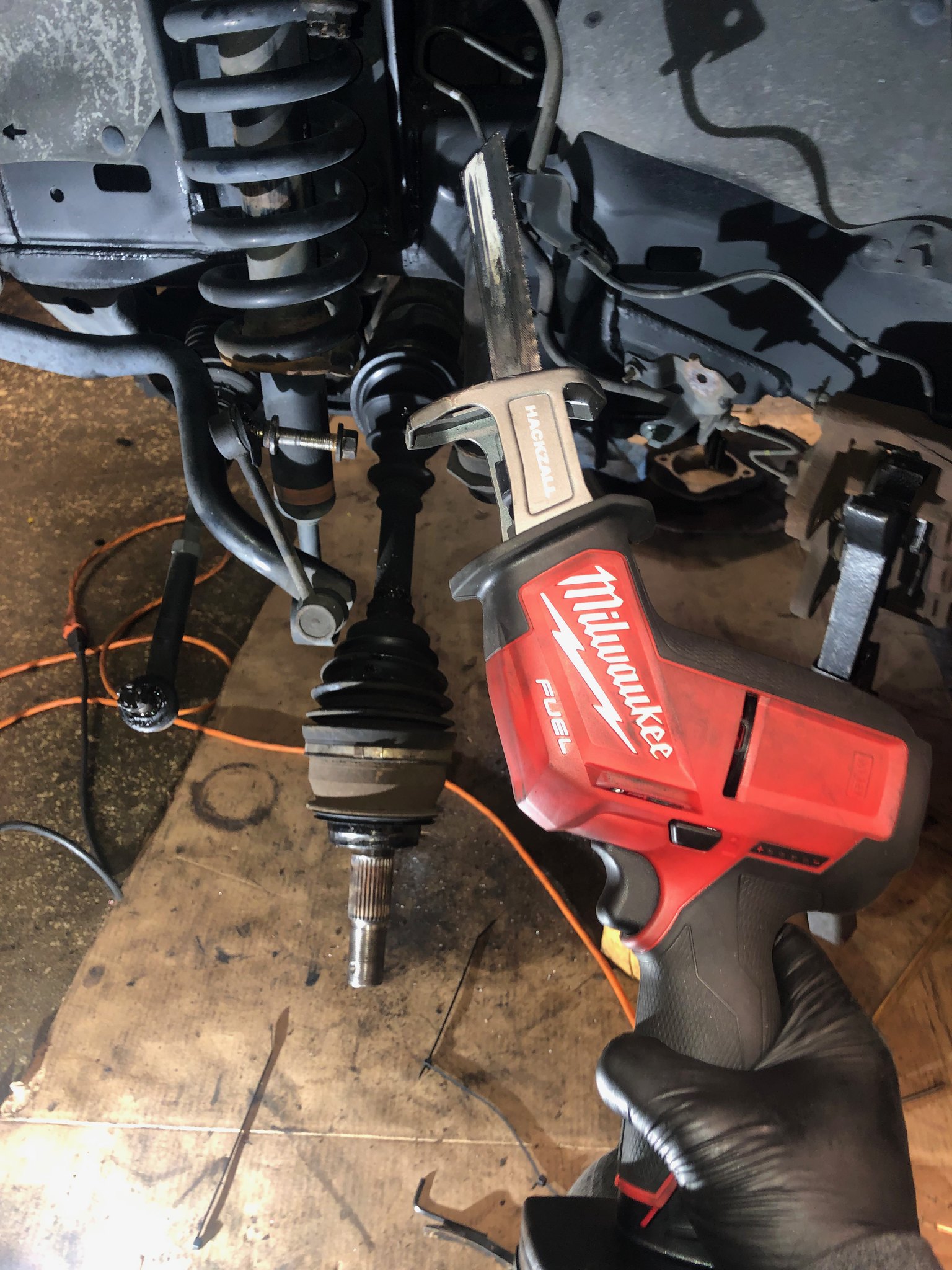

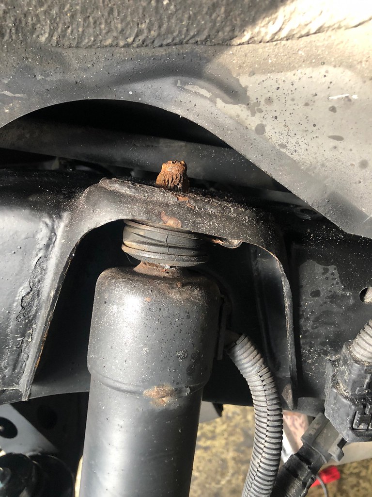

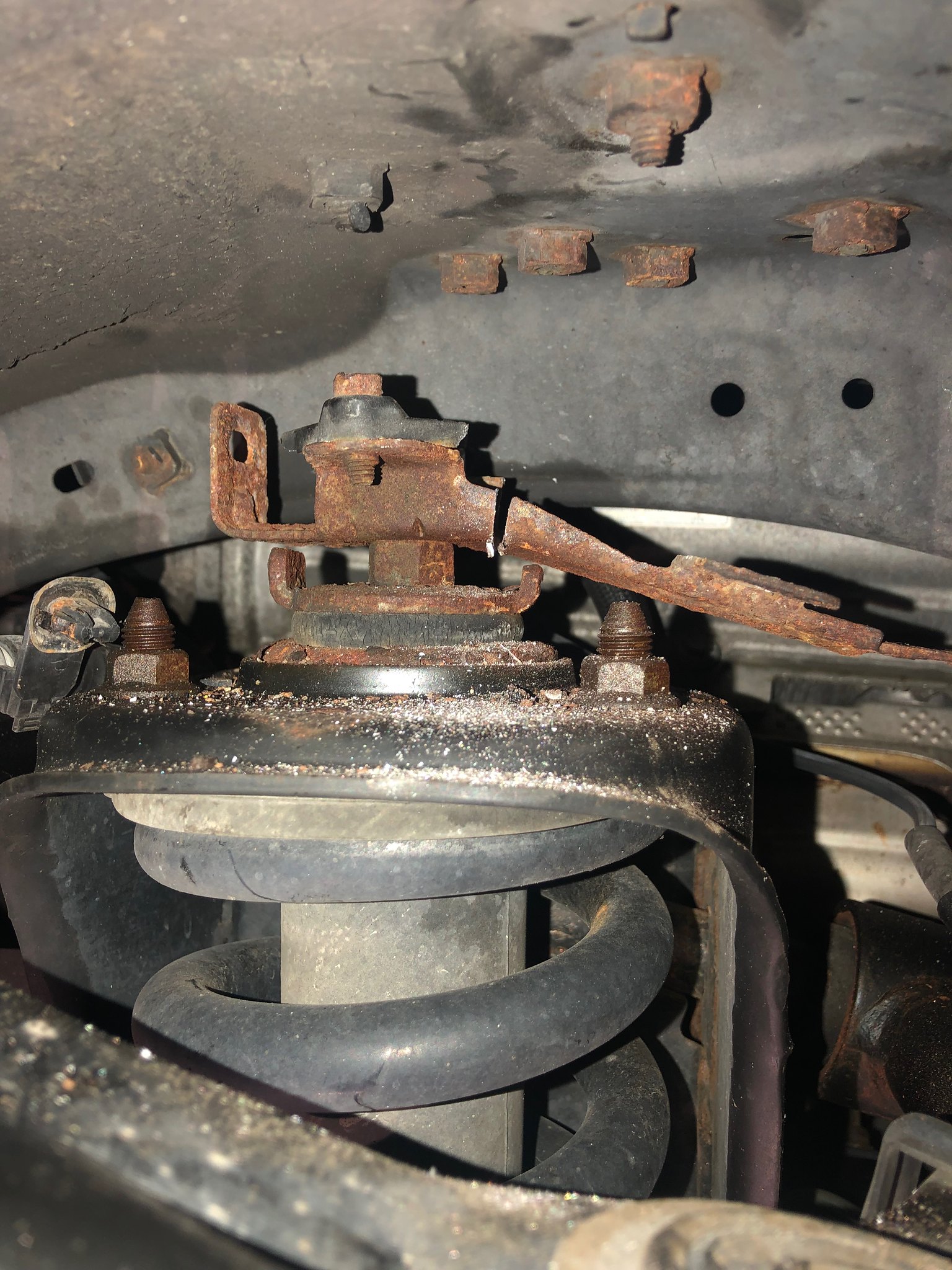

all of the parts above the strut were super rusty there are tiny allen heads bolts to remove these parts.
out comes the sawzall again.
IMG_1964 by ALEXANDER RENGIFO, on Flickr
if i didnt have this tool. i could not have done this job
IMG_1965 by ALEXANDER RENGIFO, on Flickr

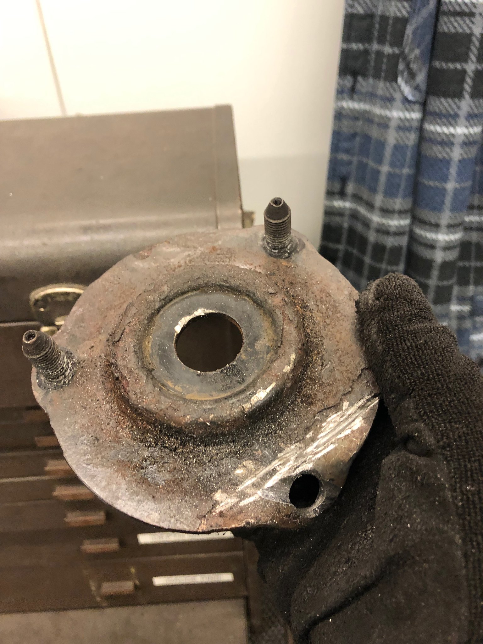

with the top cut off my next challenge was this back nut.
in this picture im using two wrenches for leverage. still no luck
IMG_1966 by ALEXANDER RENGIFO, on Flickr
it ended up stripping the splines out of the top hat.
i had to compress the spring. release the strut, and then i could
get to the top hat.
another battle won.

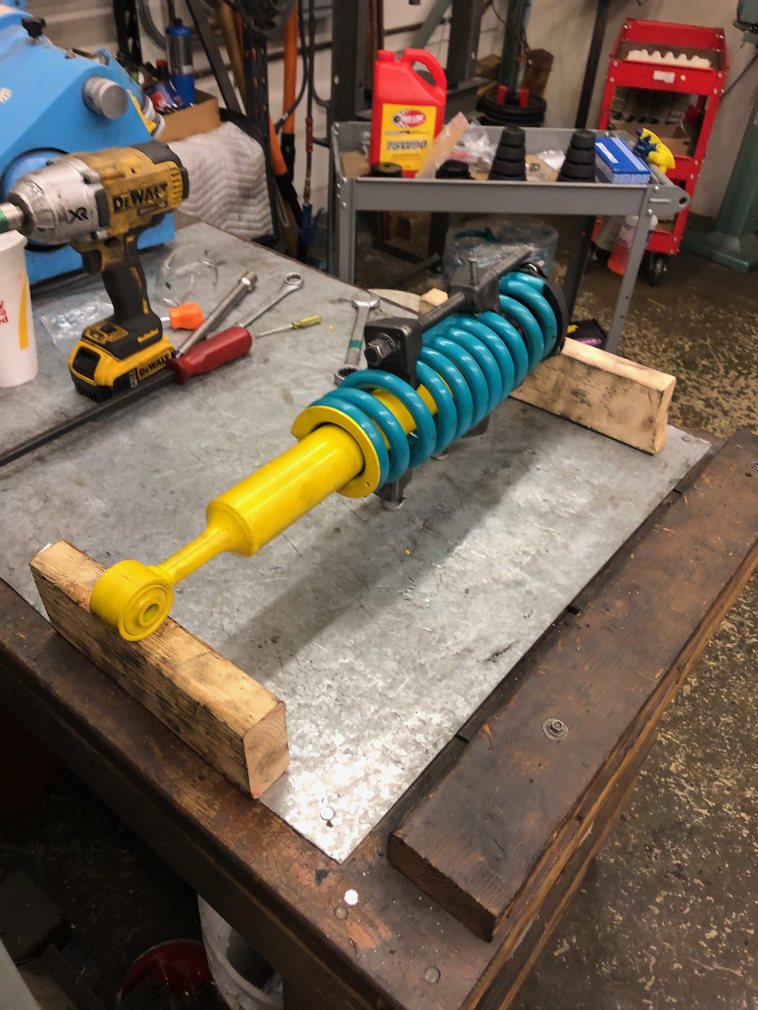

i made a big mistake in clocking the front struts!
i took the passenger assembly apart 4 times until i got it right.
please pay attention if you are going to do this your self.
i tried to re use my old top hats.
and reassemble them on the new parts.
i had several problems.
first was the clocking of the strut assembly, spring, top hat and all of those parts fitting into the 3 holes in the frame at the top
and the lower shock mount in the lower control arm.
second problem was the clocking of all of this in relation to the sway bar.
my other problem was my spring compressor barely fit in between the coils. i had to hammer it in and hammer it out each time i used the tool.
first attempt i tried to just eyeball the alignment. went to install it and it was a few degrees away from fitting. with the spring rate in these springs i could not rotate the strut assemble enough to get it fit in the lower control arm clevis.
second attempt
i tried using a plate of aluminum to push on 2 studs. and the yellow part of the shock resting on the work bench.
IMG_1960 by ALEXANDER RENGIFO, on Flickr

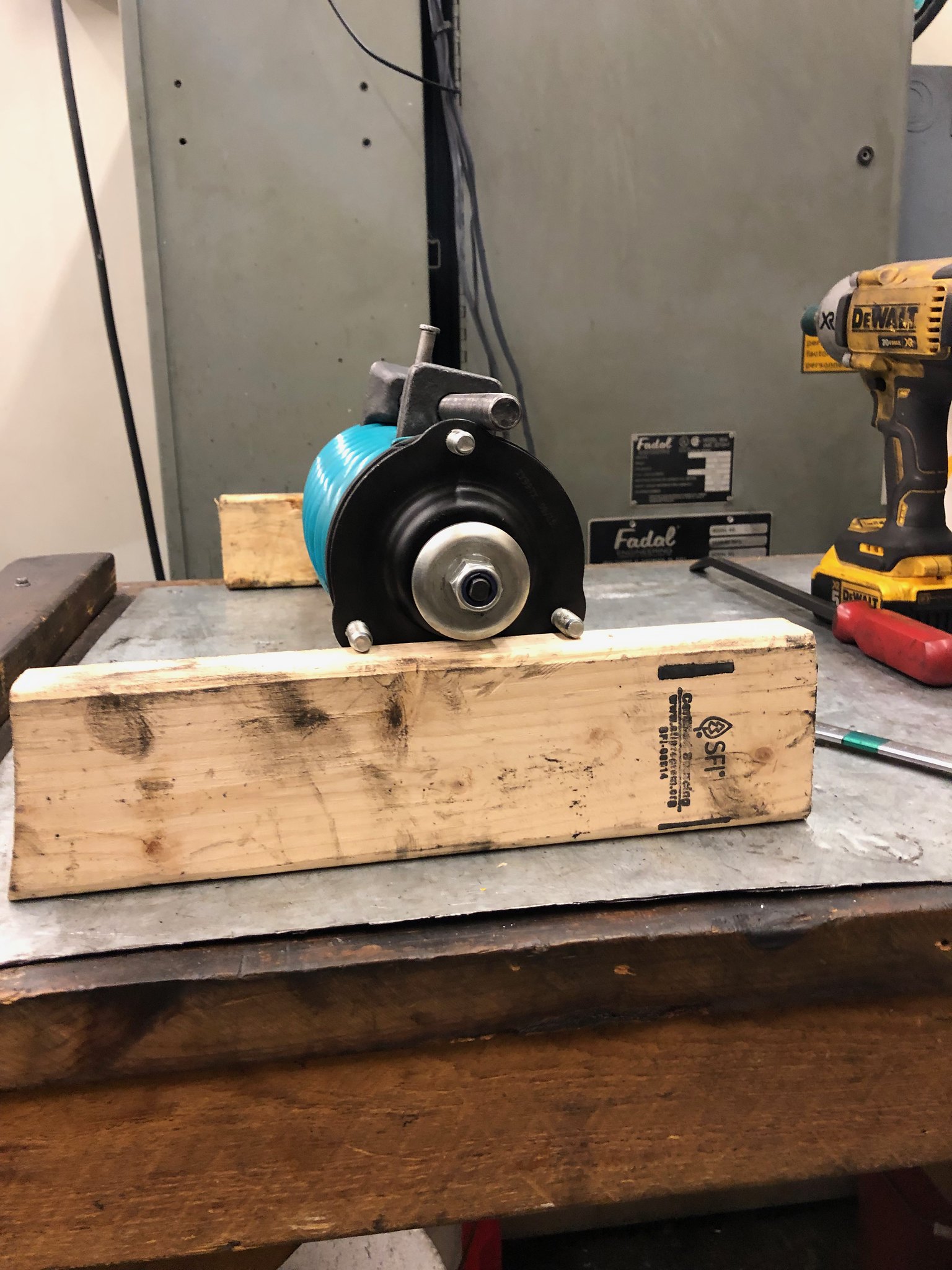

that didn't work
third attempt
so i used two 2x4's one aligned the studs on and the other end of the shock.
IMG_1991 by ALEXANDER RENGIFO, on Flickr
IMG_1992 by ALEXANDER RENGIFO, on Flickr
then i noticed it was still not right
it was to close to the sway bar.
IMG_1994 by ALEXANDER RENGIFO, on Flickr
then i found a picture of the factory service manual
it shows the pigtail facing the firewall
crap! take it out again and re clock the top hat
IMG_1969 by ALEXANDER RENGIFO, on Flickr
4th attempt
took it all apart rotated the strut around so its away from the sway bar put it back in.
IMG_2359 by ALEXANDER RENGIFO, on Flickr
driver side control arm all prepped and ready to be installed
IMG_1978 by ALEXANDER RENGIFO, on Flickr

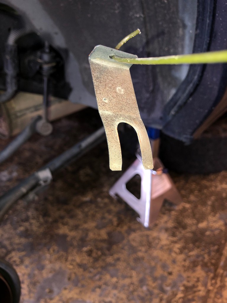

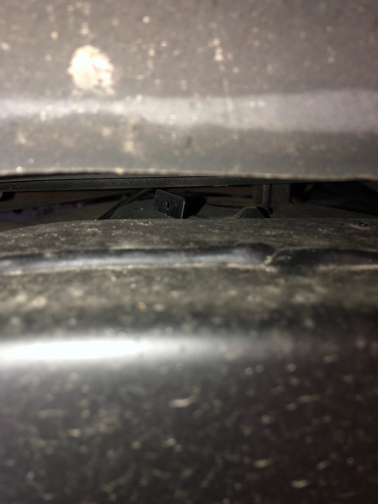

made a hook tool out of a coat hanger to pull the rear airbag clips
IMG_1998 by ALEXANDER RENGIFO, on Flickr
you have a tiny amount of room to fit a tool between the frame and body. the clip we are trying to remove is in the center of this picture. a 90 degree tab
the tab has a hole in it.
IMG_1999 by ALEXANDER RENGIFO, on Flickr
hook tool inserted
IMG_2001 by ALEXANDER RENGIFO, on Flickr
success
IMG_2004 by ALEXANDER RENGIFO, on Flickr
new components for the rear coil conversion ready to go
IMG_2005 by ALEXANDER RENGIFO, on Flickr

short video clip compressing the rear shock by hand
IMG_2029 by ALEXANDER RENGIFO, on Flickr
old vs new
IMG_2031 by ALEXANDER RENGIFO, on Flickr
new upper bump stop
rear coils
and lower bolt on spring perch
this bolts onto the rear axle
dobinsons coil conversion parts
dobinsons spring
toyota factory bump stop
IMG_2033 by ALEXANDER RENGIFO, on Flickr

eim keith panhard relocation bracket
IMG_2038 by ALEXANDER RENGIFO, on Flickr
the fitment was really good
IMG_2039 by ALEXANDER RENGIFO, on Flickr
i taught myself how to weld. started practicing in 2018. now im comfortable enough to weld on my vehicle. Im proud of that accomplishment.
IMG_2046 by ALEXANDER RENGIFO, on Flickr
i bought some welding magnets a few months ago.
IMG_2052 by ALEXANDER RENGIFO, on Flickr
IMG_2056 by ALEXANDER RENGIFO, on Flickr
another trick i saw somewhere online
i used a ratchet strap to move the axle inline to get the panhard bar to aligned with hole.( hadnt installed the bracket yet in this picture)
IMG_2043 by ALEXANDER RENGIFO, on Flickr
frame on jack stands
rear axle at full droop
pan hard bar bracket welded on
look at how parallel the panhard is mounted in the upper hole location
IMG_2058 by ALEXANDER RENGIFO, on Flickr

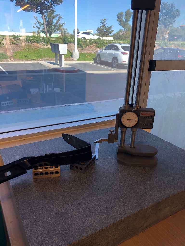

Show of hands: who else here has used a granite surface plate to mark and score their running boards for trimming:
Nice precision job there!
next mistake i made.
i stripped the thread on the passenger sway bar end link.
i thought i could at least test drive with the passenger side disconnected.
boy was i wrong and an expensive mistake.
the bar itself ripped the cv boot on the axle
IMG_2311 by ALEXANDER RENGIFO, on Flickr
i ordered new inner high angle cv boots from dobinsons and factory inner boots from toyota
IMG_2312 by ALEXANDER RENGIFO, on Flickr
IMG_2316 by ALEXANDER RENGIFO, on Flickr
part number.
inner cv boots
IMG_2314 by ALEXANDER RENGIFO, on Flickr
coming from race cars this is the good stuff for cv
redline cv2 grease
IMG_2320 by ALEXANDER RENGIFO, on Flickr
did the inner boot stretch mod. you cut a ring out of your old boots and install that before the snap ring
now the boot does not ride so closely between the ridges
IMG_2321 by ALEXANDER RENGIFO, on Flickr

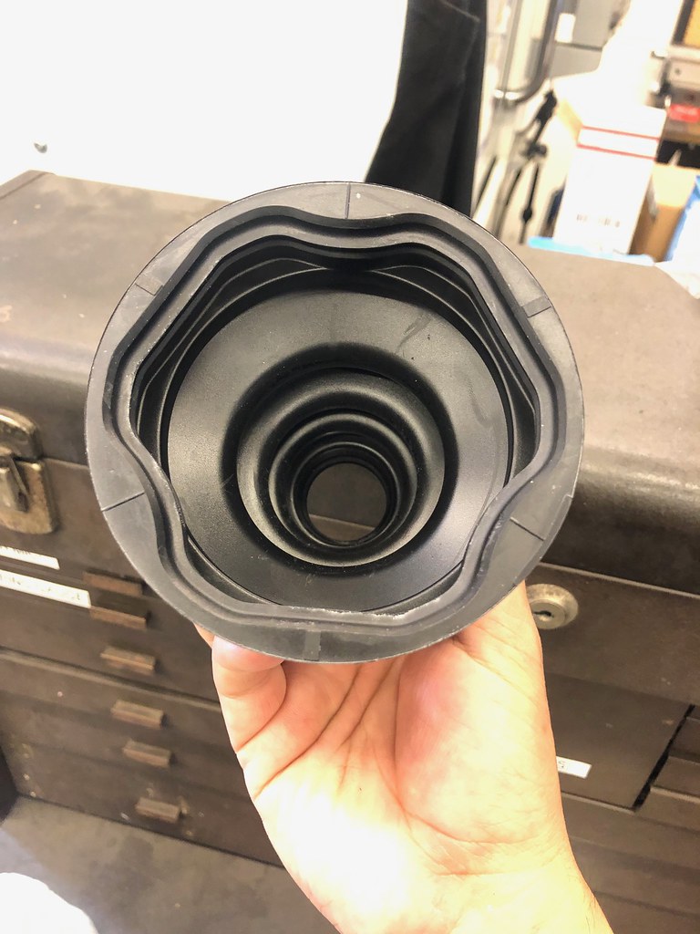

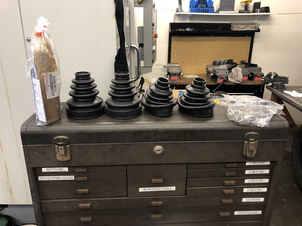

here was my problem.
my passenger axle was an aftermarket one.
notice the round shape of the joint
the toyota boot has a special unique shape
IMG_2324 by ALEXANDER RENGIFO, on Flickr
this is the special shape on the driver side inner cv joint
IMG_2325 by ALEXANDER RENGIFO, on Flickr

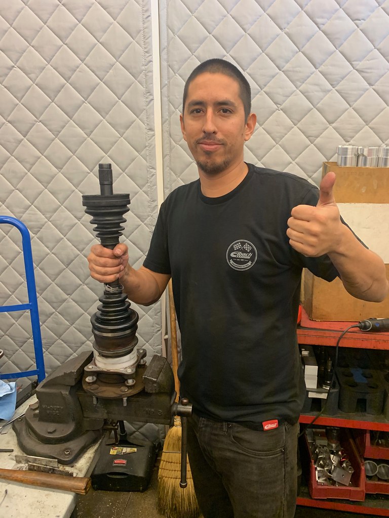

my friend bryan and I were fighting trying to stretch the toyota boot over the round axle.
no luck.
fail
IMG_2329 by ALEXANDER RENGIFO, on Flickr
one trick is you can bolt a wheel bearing in a vice and then insert the splines of the cv and you can work on it much easier
a picture of me before knowing the boot wouldnt fit
IMG_2350 by ALEXANDER RENGIFO, on Flickr
got the driver side axle rebuilt and will be using this as a spare
(this is picture is before rebuilding it)
IMG_2370 by ALEXANDER RENGIFO, on Flickr
super messy job
IMG_2371 by ALEXANDER RENGIFO, on Flickr

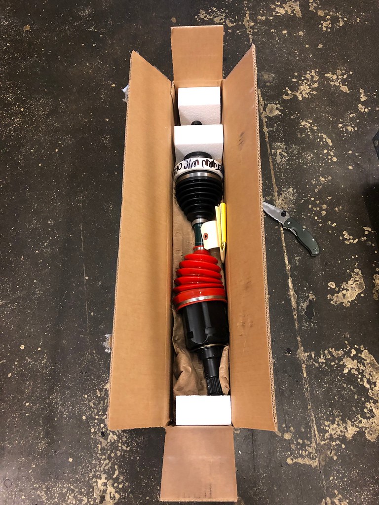

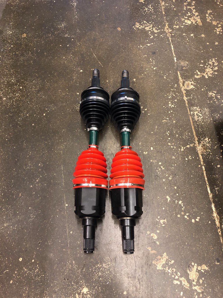

i tried to order a spare round shape cv boot with no luck.
so i did the next logical approach.
order badass axles
i ordered some CVJ 9808 TR axles with the upgraded high angle silicone inner boots and the oem toyota outer boots
they arrived quickly
they are located in denver colorado
Open M-F 9-5pm:
4101 Brighton Blvd.
Denver, CO
80216
Phones M-F 9-5pm:
Toll Free: 1-800-292-2953(AXLE)
Local: 303-297-2448
FAX: 303-297-0650
another parts run in the bmw e30
IMG_2460 by ALEXANDER RENGIFO, on Flickr
IMG_2462 by ALEXANDER RENGIFO, on Flickr
IMG_2461 by ALEXANDER RENGIFO, on Flickr
this was expensive because i could not return the passenger axle as a core and i wanted to rebuild the factory toyota axle and keep that one as a spare
but **** it. now the front end is very strong

I installed that panhard correction bracket a few months back.
I was amazed at how much of a difference that little thing made!
I highly recommend it to anyone who doesn't have one and is lifted.
