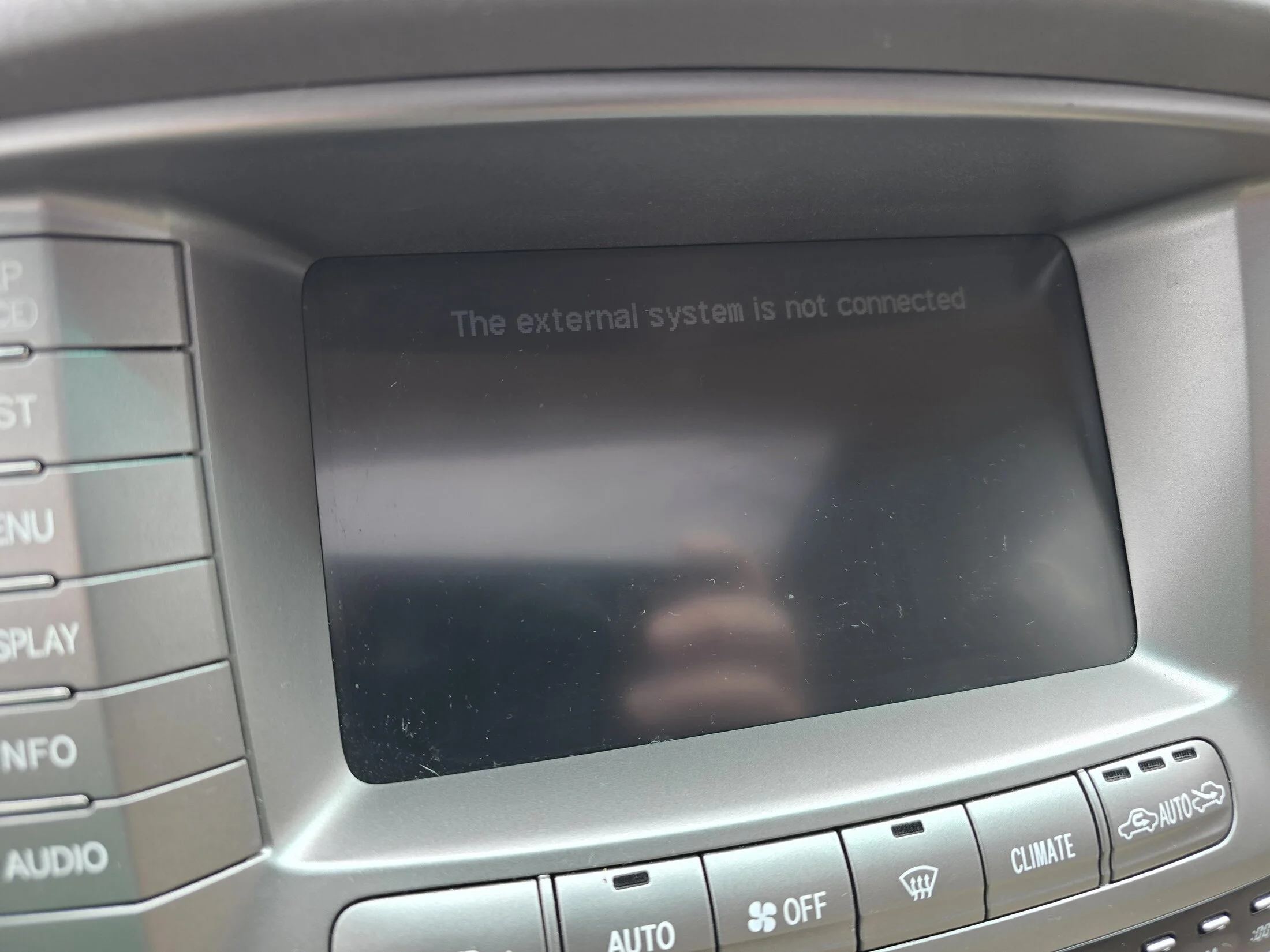

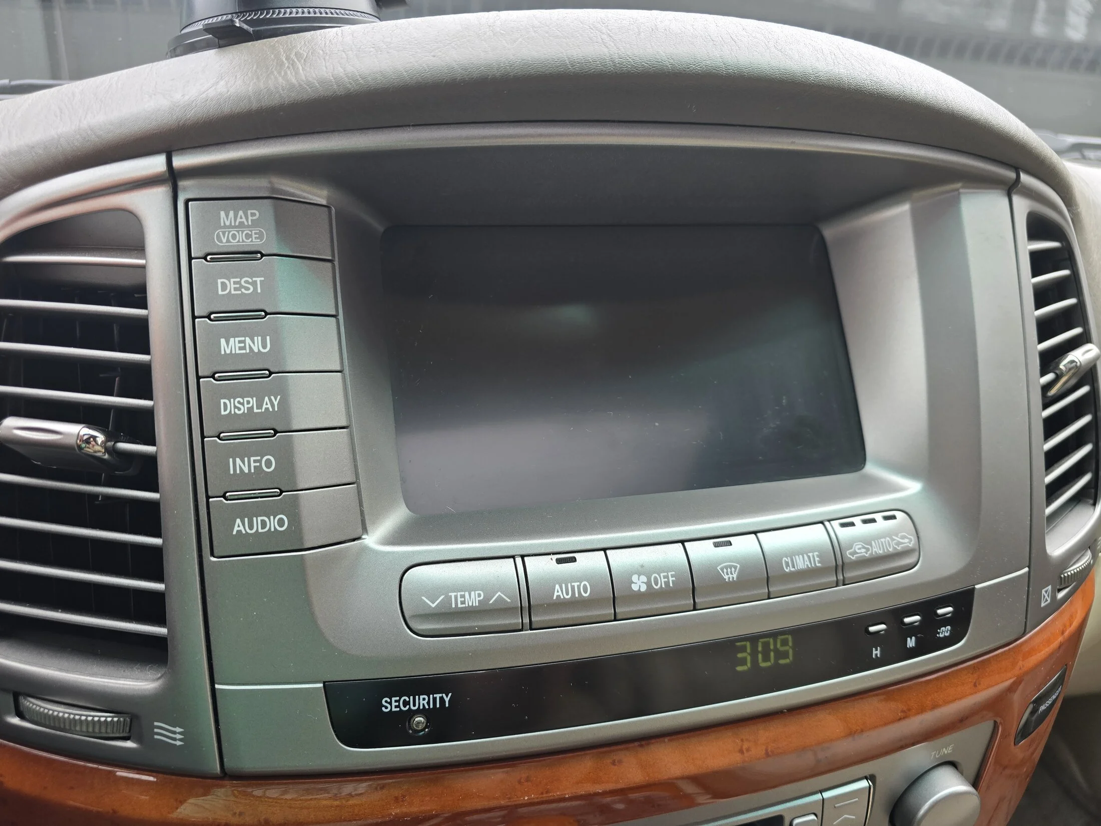

I'm a long time lurker, first time poster. I recently bought a 2004 LX470, and the nav/hvac system is filled with gremlins. When you first start it, the screen doesn't generally work and when you press the MAP button, it says "The external system is not connected." If you press the climate button, you get "Check the connection of the air conditioner."
The first thing I'm going to do is take it out of the dash and clean & check the connections. Maybe over the last 20+ years something became loose. I do not have any mods to it (that I can see anyways), no bluetooth, nothing deleted.

Replace all your fuses first. I had the same problem, replacing fuses solved it. If that doesn't work then replacing the head unit may help. Sourcing parts for a nav delete is expensive/difficult and time consuming as parts are discontinued. As far as the jerryb harness, with time/dedication/money, you can make your own; he posted all the documentation. I'm making a few of them and may give a few away with time if they work, but don't hold your breath.

I put together that it was expensive and very time consuming, that's why I'm thinking if I cant get what's there to work, I'll just replace it with an OEM one from ebay. Thanks for the advice on the fuses! I'll look at that today.

You can also check "Original Car Audio". Not sure of the web site, might be cd4car.com. You can purchase one of their refurbished units and send yours in for core credit and get a 6 month warranty on their unit. I believe for about $400 they will repair yours and provide the same warranty.
