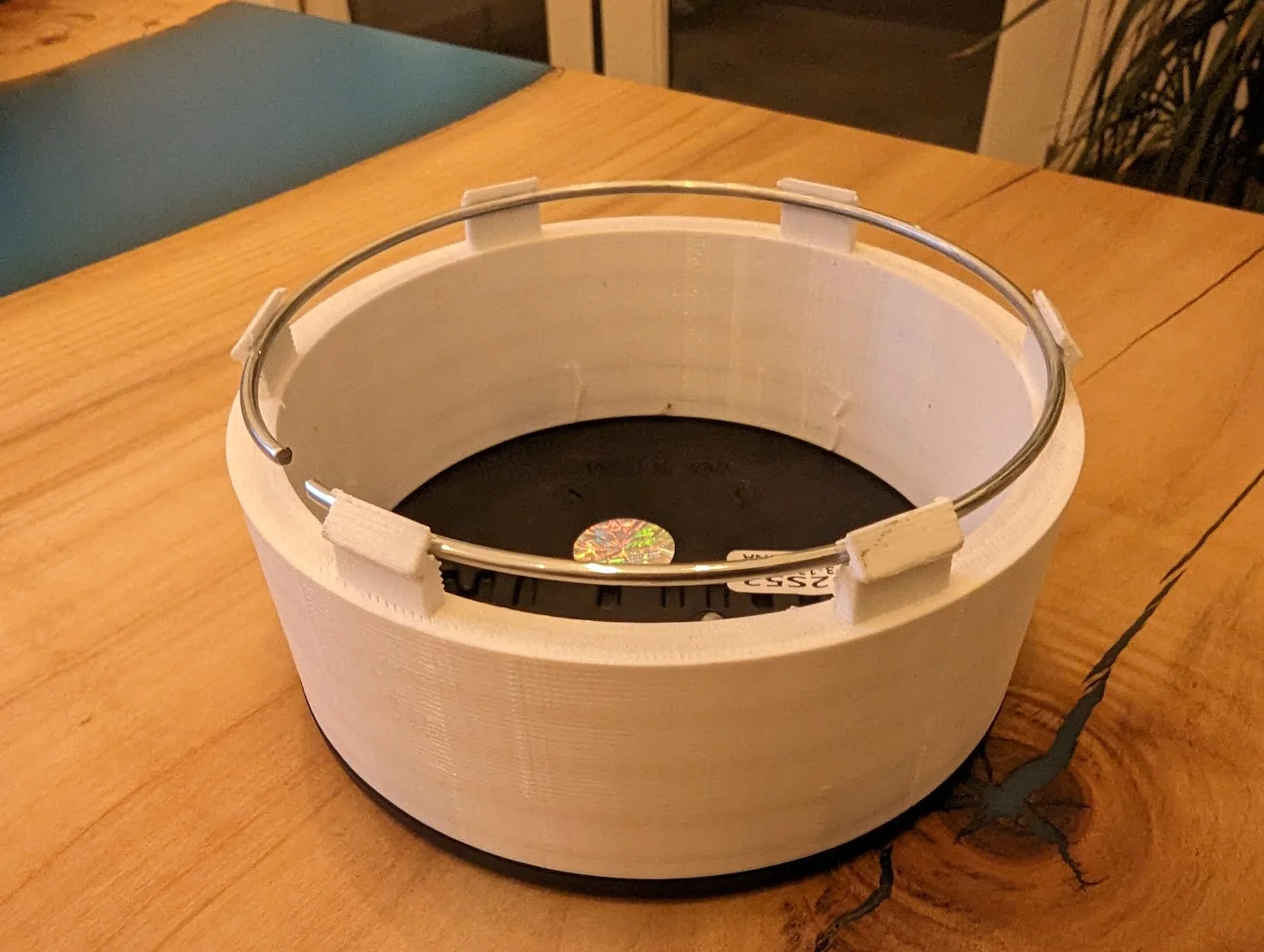

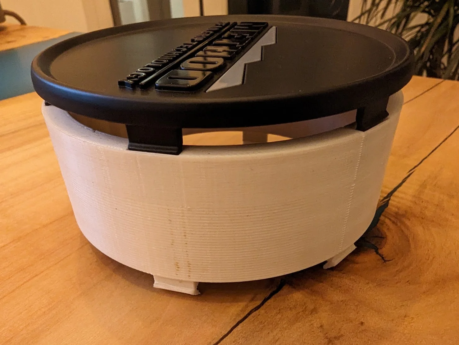

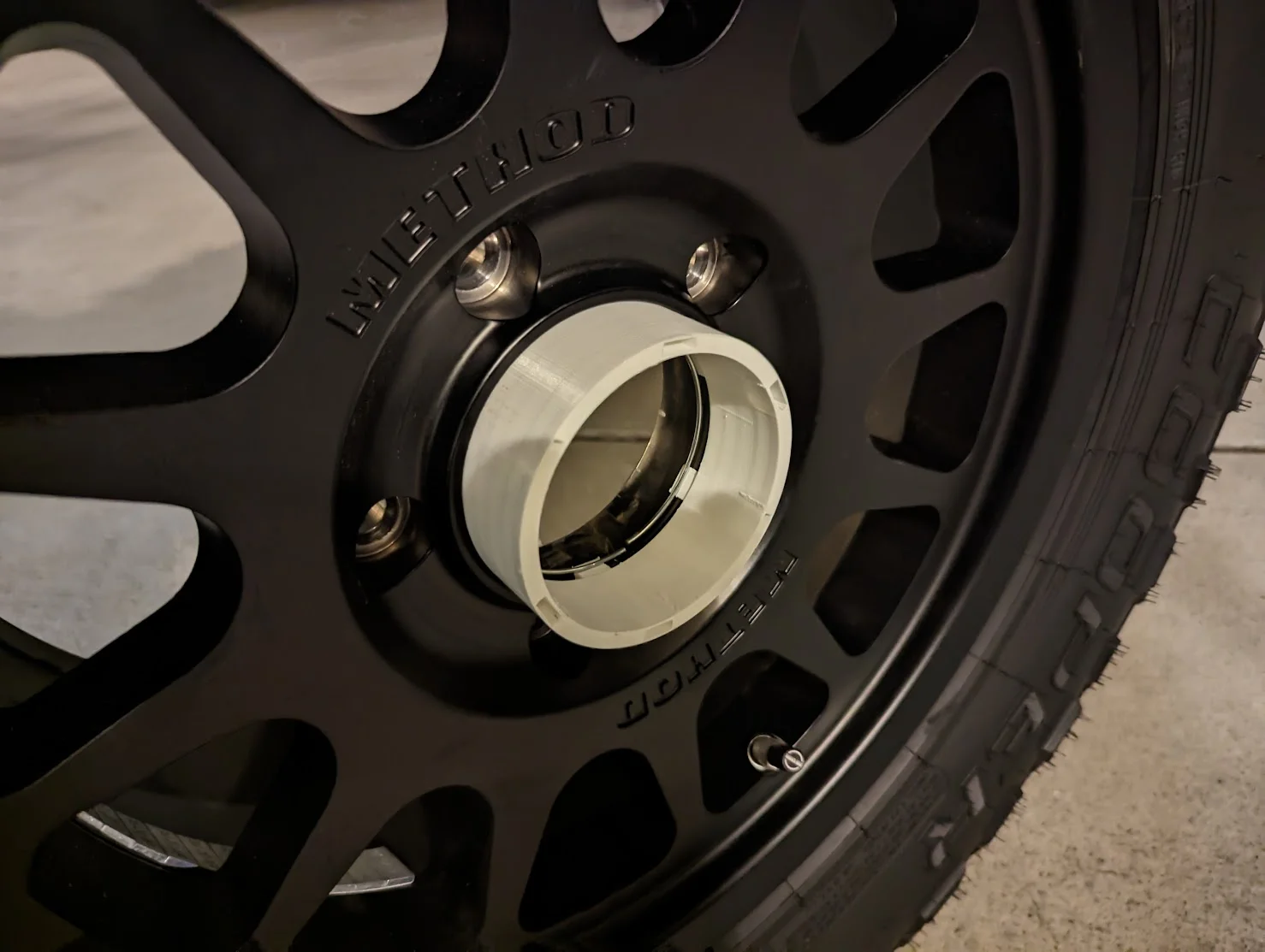

Just picked up a set of Method 703 Bead Grips. Love them, but the front hubs stick out past the wheel center caps. At first I thought of just painting the hubs black, but figured I would try to print something instead. Note that it's printed in white right now because that's the color I had loaded in the printer, but I'm going to print them in black next and run them for a while to make sure everything is solid.
Once everything is tested, I'll put the 3d files up so anyone can print them if they need them.

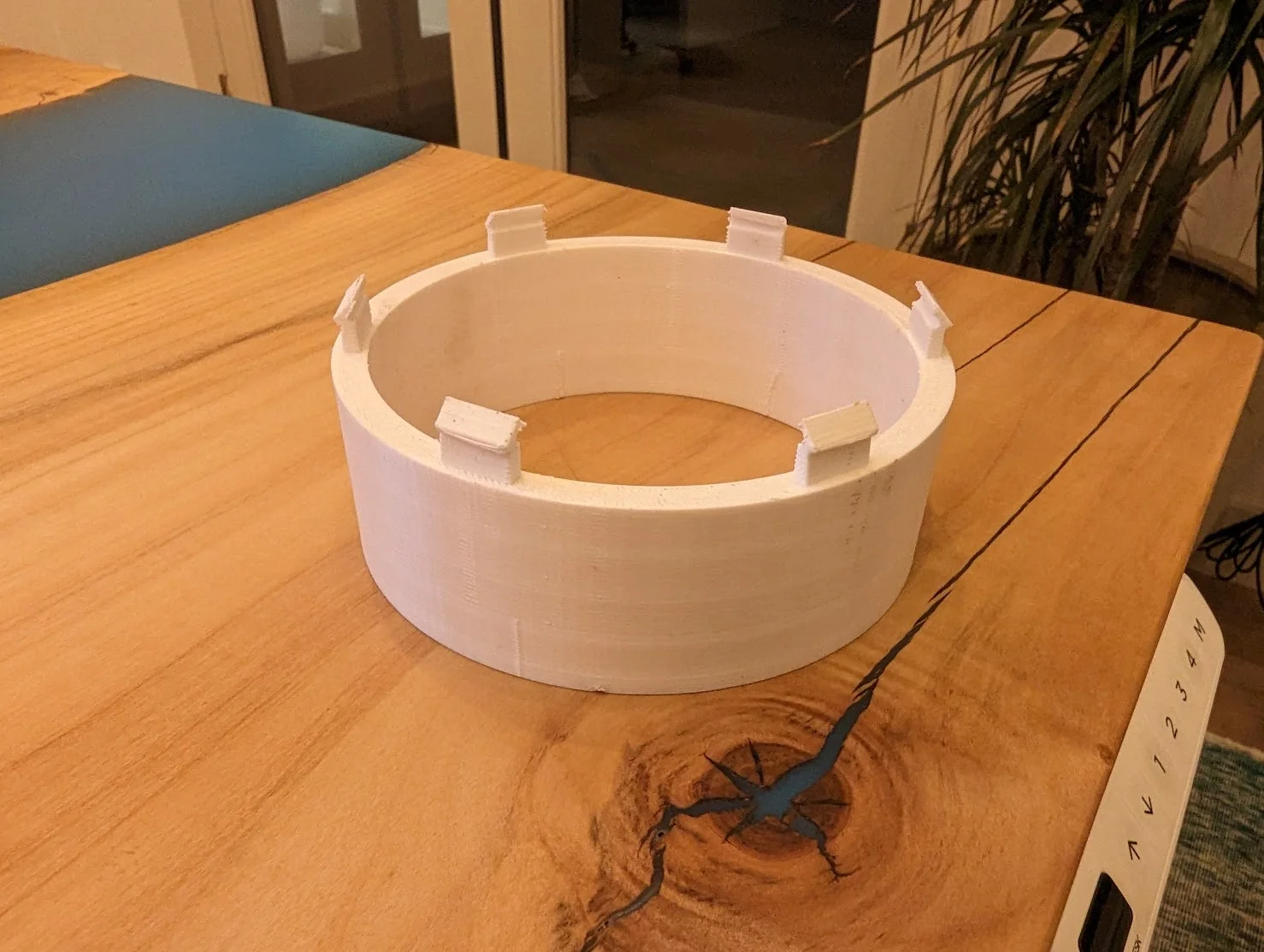

The original cap inserts into the slots in the printed extension

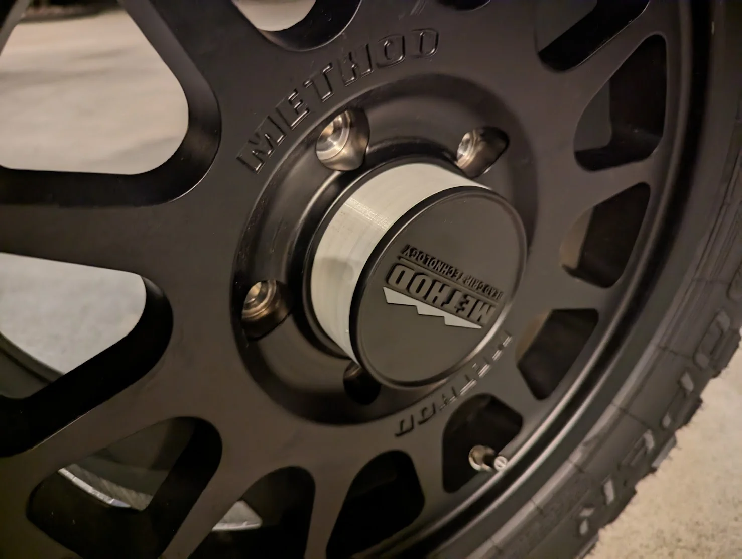

Fully assembled:

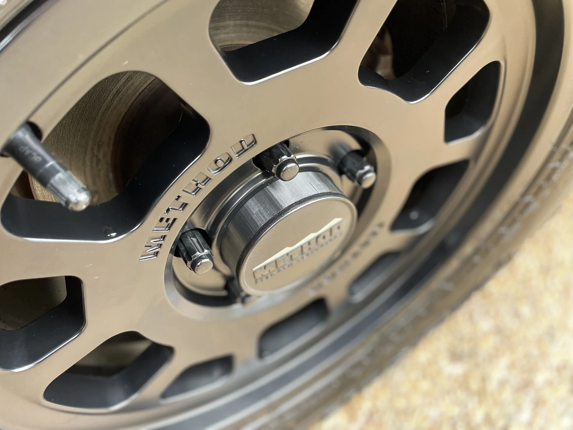

So, had family friend print me couple out and it worked out perfectly. He used black plastic. Not exactly sure which version/type but says it hold better at higher temp. No modification after printing. It just clicked together and fit the wheels perfectly. I didn’t sand anything down. Kinda liked the micro lines on it.
I think the depth is perfect. Not too long and it looks OEM (nobody will know it was 3D printed).
Thanks again

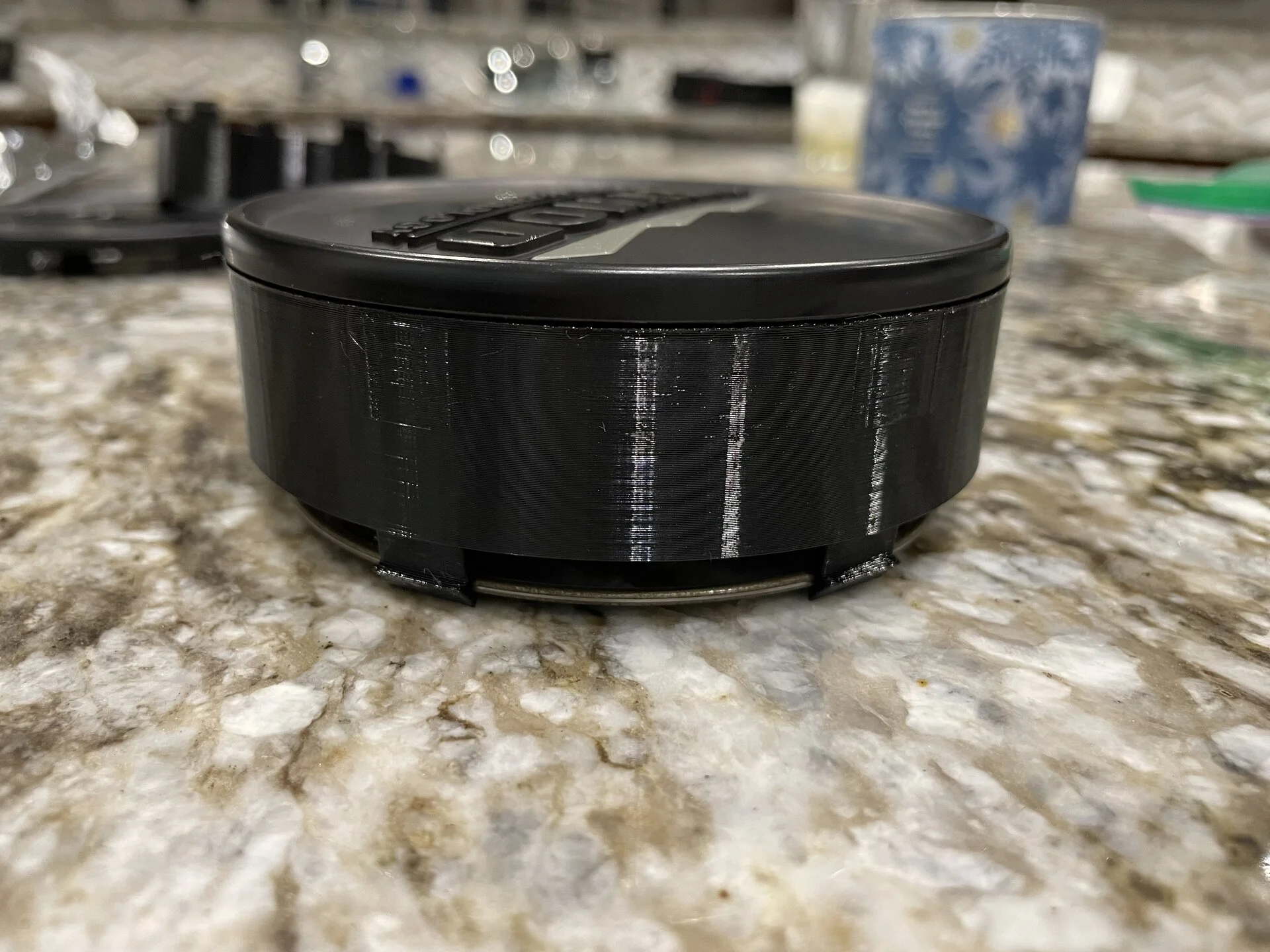

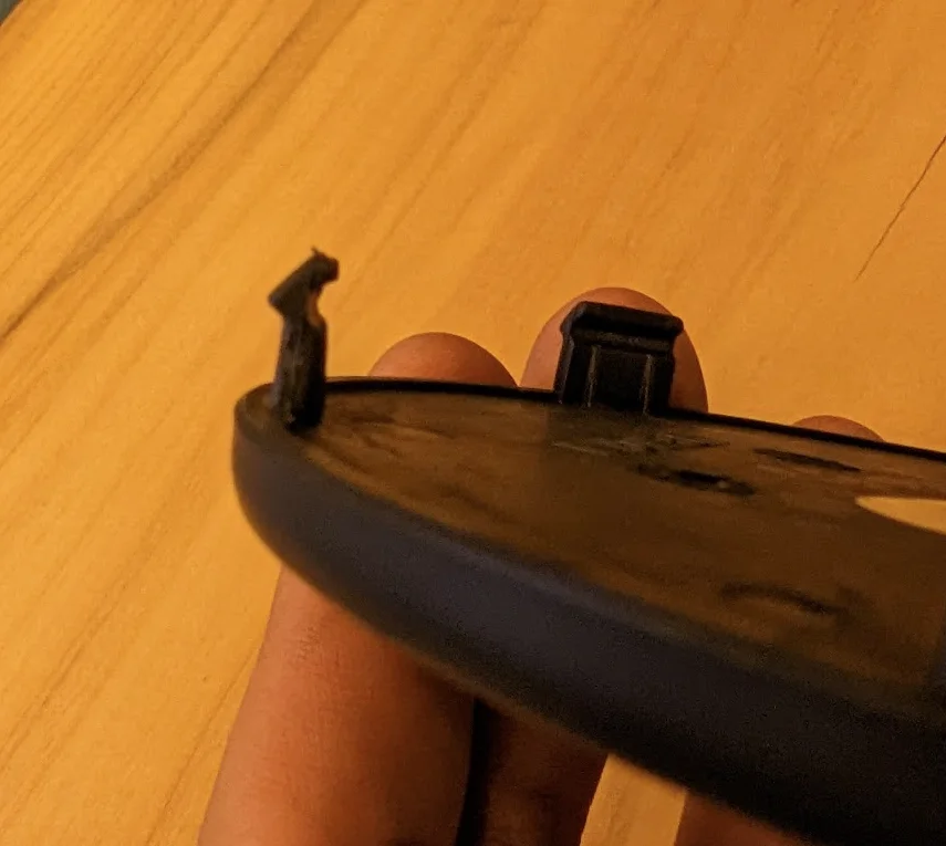

I reprinted the Method wheel cap extensions in NylonX with Carbon Fiber for some extra durability. They turned out much better than the previous PETG prints. Highly recommend if your printer can handle it!

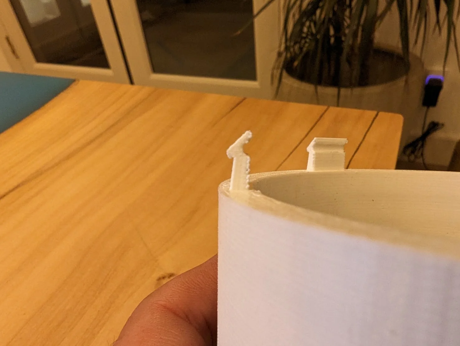

On the left are the previous PETG prints. Not bad, but a little glossy and you could see the layer lines. They also would snap tabs off if you weren't careful installing them. The new ones on the right are right out of the printer - no sanding or anything needed. Zero lines, nice matte textured finish, and the Nylon+CF is WAY tougher. It's also more resistant to heat and chemicals. They should last a lifetime.
