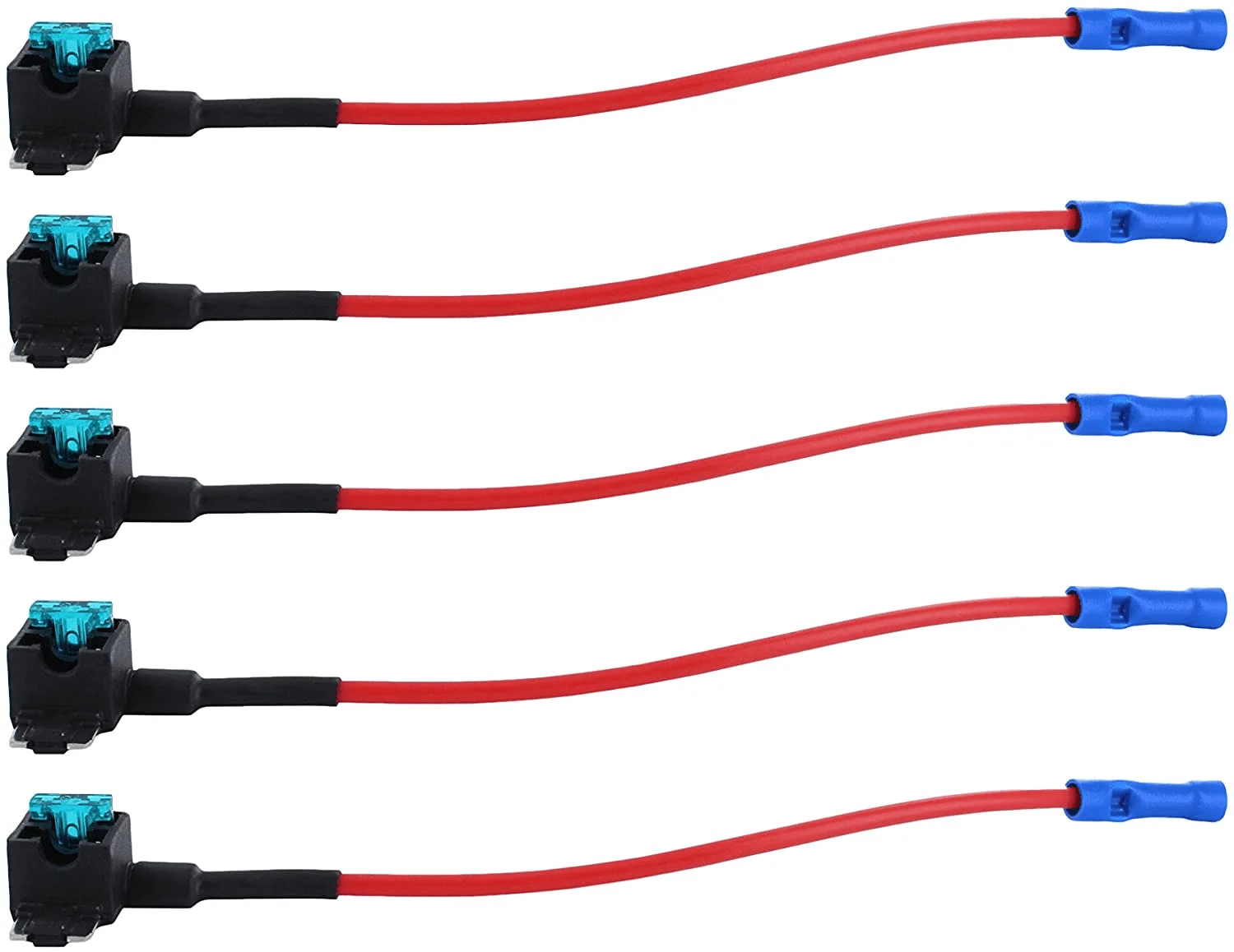

My friend showed me these fuse taps that let you add an electrical connection through your fuse block. It retains the original fuse, and allows you to add one for the new connection. I can use the fuse block in the driver's footwell. It seems simple enough, and I don't have to make another hole through the firewall.

I use the add-a-tap on the fuse box for other accessories, the only downside is you can't put the fuse cover back on. I believe there is a empty constant power circuit that you can plug into.
Fuse taps are quite common, I have been using them for years to fuse my switches when not using a switch panel like a Switch Pros. You do lose the ability to keep the fun box cover on but that's never been an issue.
