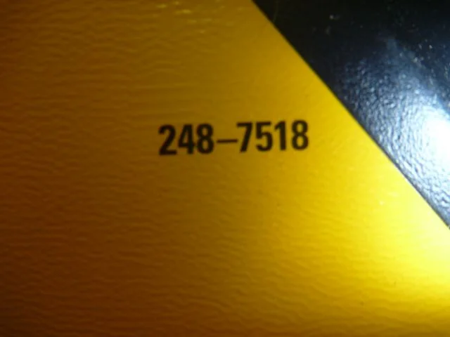

If you are a near a CAT equipment dealer, this oil meets all needs for flat tappet engines - diesel or gas, and is quite reasonable in price.
Thanks for reminding me about this oil. I need to look into finding some.
I'd like to try that also.

The CAT oil I posted is made for older Off Road equipment and truck engines, not their current engines. Make sure you get the correct oil, as they make a low emissions version also with much lower levels of the "Good" additives we need for flat tappet engines.
