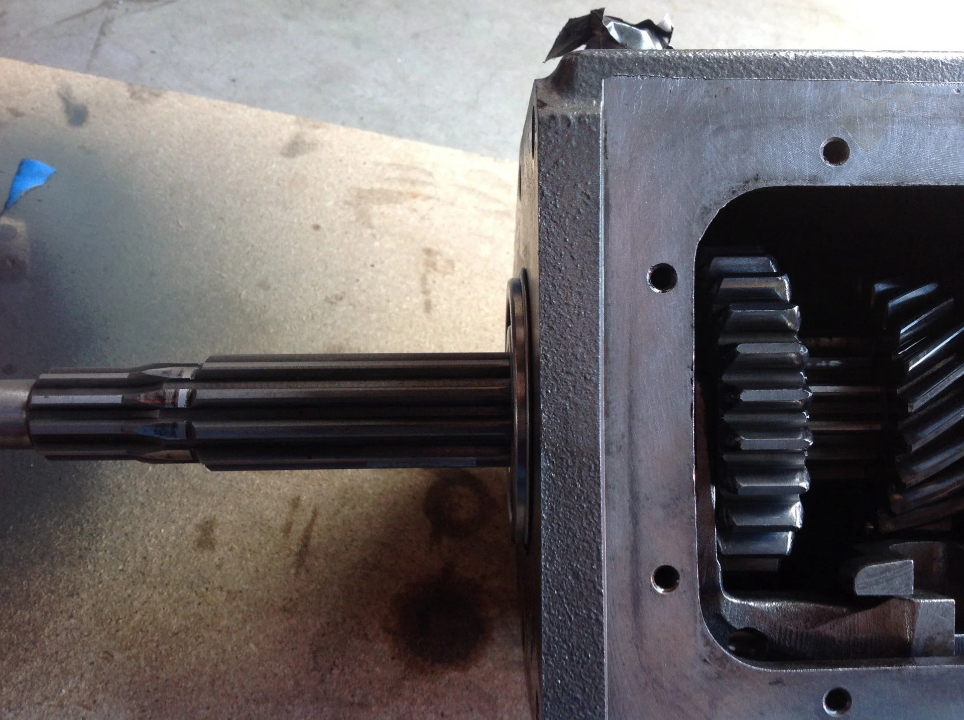

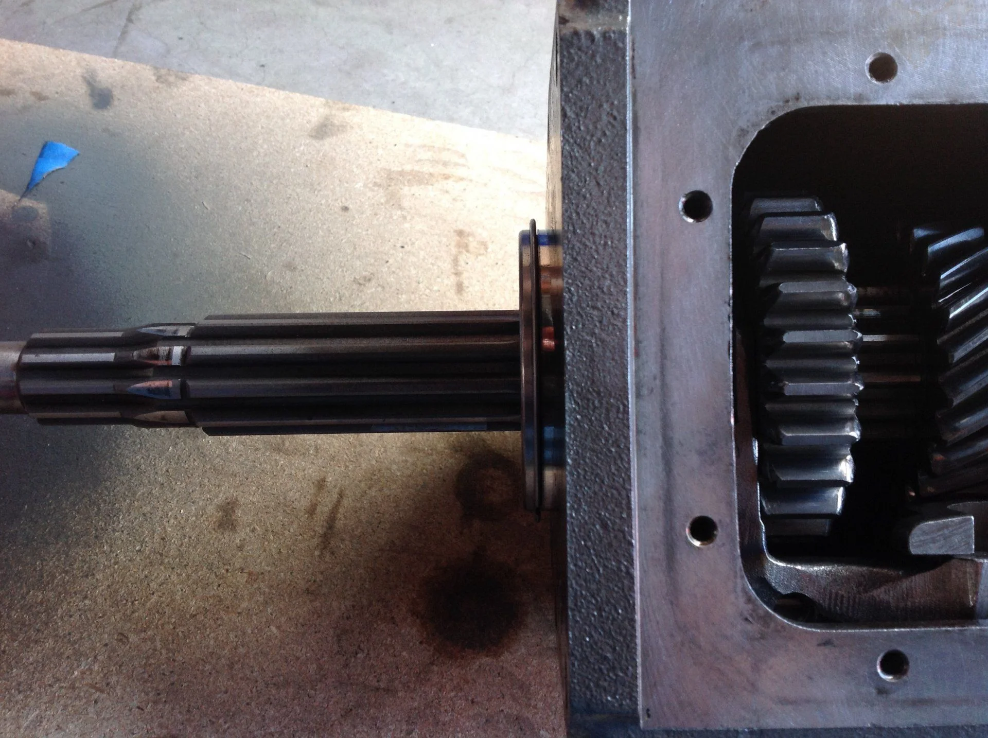

The item that concerns me is that the output shaft has about a half inch of play where it can be slid back and forth in the case. But it could have been this way previously, I just can't recall. With it pulled back, I can freely turn the input shaft without the rear engaging. With it pushed in, it moves with the input shaft. That bearing (?) and its c-clip ride up against the transfer case once they're bolted together anyway, so there's nowhere for it to move once installed, so I think that's how it was to begin with. I wanted to check with the masses if this was normal before I put it all back together though. Thanks!
