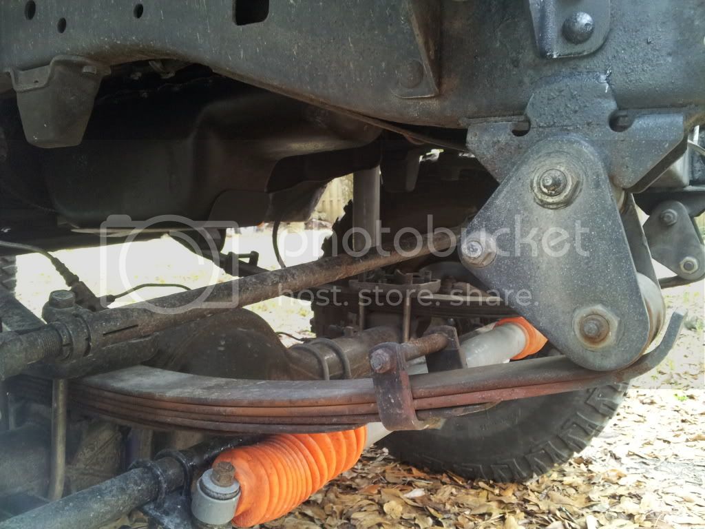

Show us a close up image of the rear shackles. In the one photo it sure looks like the angle is radically different (flatter) than the fronts. Doesn't look right to me. I think they're supposed to look like this. Of course, this one is extended with wheel drop, but...

shackles should typically be around 45 degrees depending on the arch of your springs.
his fronts are tolerable but should look more like his rears.
they should definitely not be inverted like the ones in your pic.
I've never seen a 45 degree angle with OME lift springs, and not sure it makes too much difference what the angle is, provided it isn't 90 degrees or more. But since the front and rears are different, it makes me wonder "why?", and also if this difference could be responsible for the added height in front. Perhaps the front springs have more arch. Any chance the rears aren't OME? But yeah, of course lowering the front is the best bet. Maybe you could ditch the OME fronts and use stock springs SOA. Good luck with your choice, OP, and keep us posted.

Shackle angle definitely matters, you want your shackle to flatten out right before your spring does. This provides maximum travel and a much better ride than a more vertical shackle. That said, you should do whatever makes you happy. I'm just trying to give the OP good advice, from experience.

It looks like there may be an add a leaf in the front. If they are OMEs, it should sit higher in the rear, not the front. Anyway, all OME leafs have plastic pads under the ends except the military wrap (second from the top) and the very bottom one on the front springs. If you have one in the pack that does not match that description, it would be a good place to start.
