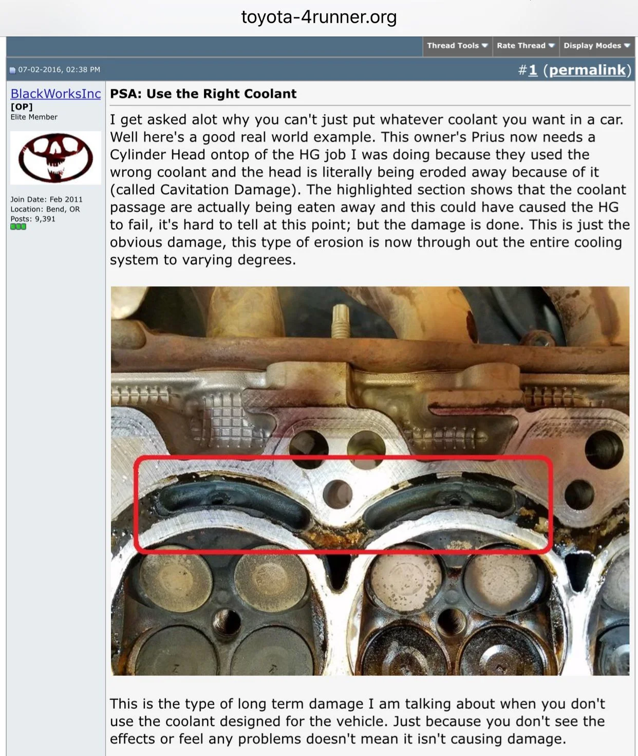

Lol. I want to avoid problems like this from the 4Runner forum. (I know it’s a Prius engine example)

Have never seen cavitation damage on a head, have no idea how that would happen or how antifreeze would prevent it, but have never worked on a Prius? Have seen plenty of examples of corrosion damage, from running antifreeze too long, aged out additives. Looks like this.
The only engines I've seen cavitation damage on, has been diesel engines. Here's a web site link that has info about what causes that damage, along with info on what are the correct coolants and additives to use to prevent that type of damage.
