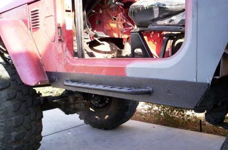

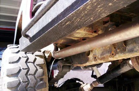

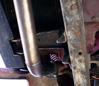

Panel protection, angle iron that ties to the frame underneath / behind...that what I did on my 40. Wrap the panel, with step, and have two / three weld on braces to reinforce the body.
This was before the two stancions came from the frame for / aft above the exhaust...let me find pics of that.

The body mount sliders look great on a 40 IMO, I personally wouldn't trust them the way I beat my stuff though unless they were tied into the frame. Plus, though we don't get rain or mud too often, between the rocker and angle iron is a great place for sand and water to do its job and create rust and bubbling paint. I will post pics of mine later, and if you want I can replicate them for a fraction of all the suppliers prices out there, also using .188 or .250 wall tubing, cause .120 has no place on a 40 or 60/62 for that matter other than for looks. .120 is just the route places like Trail or "China" Gear take to keep over head down and profit margins up.
