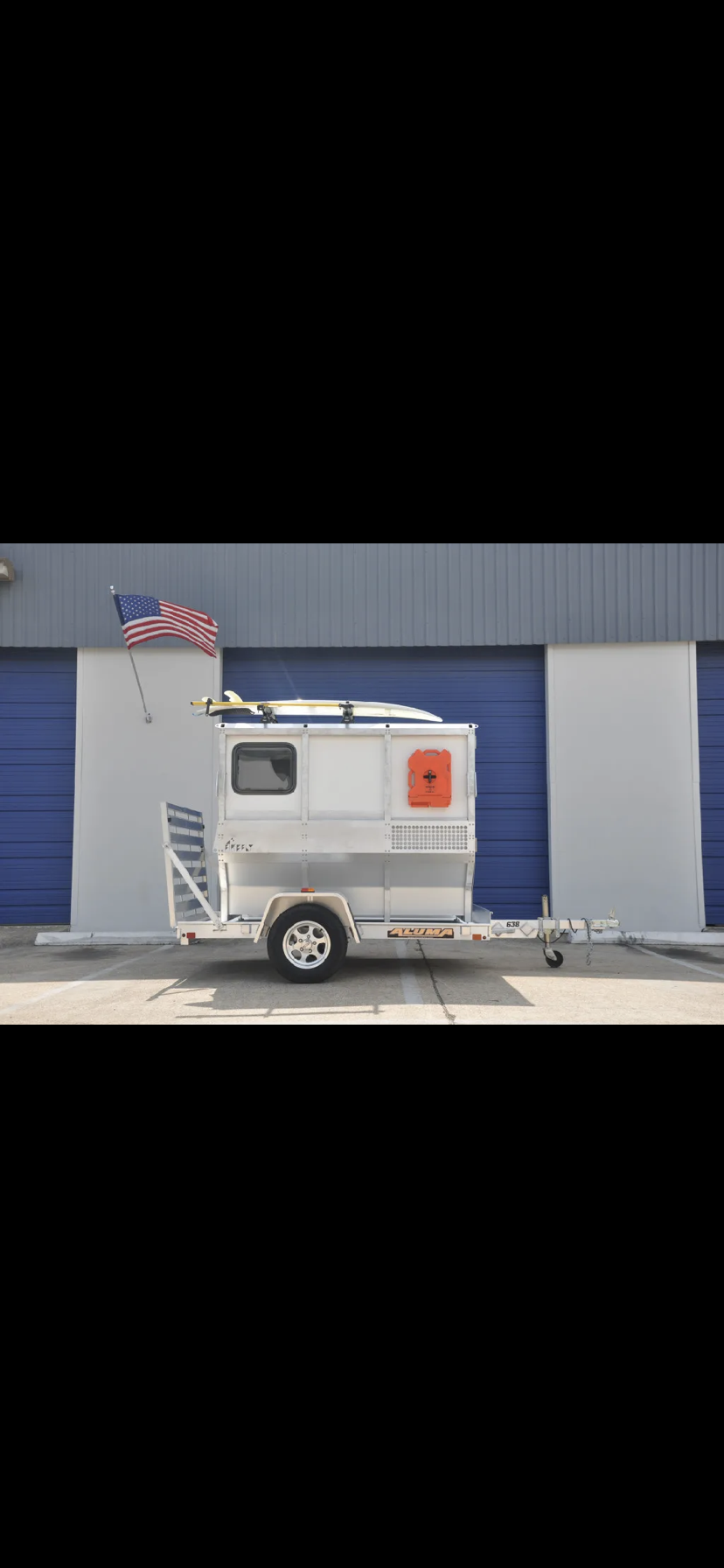

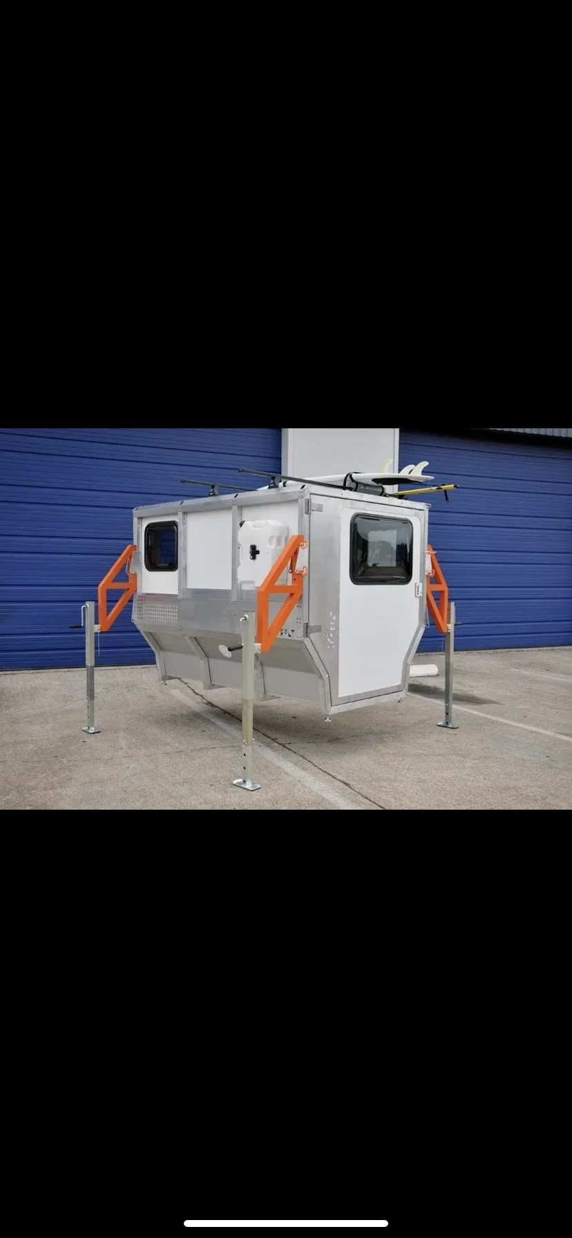

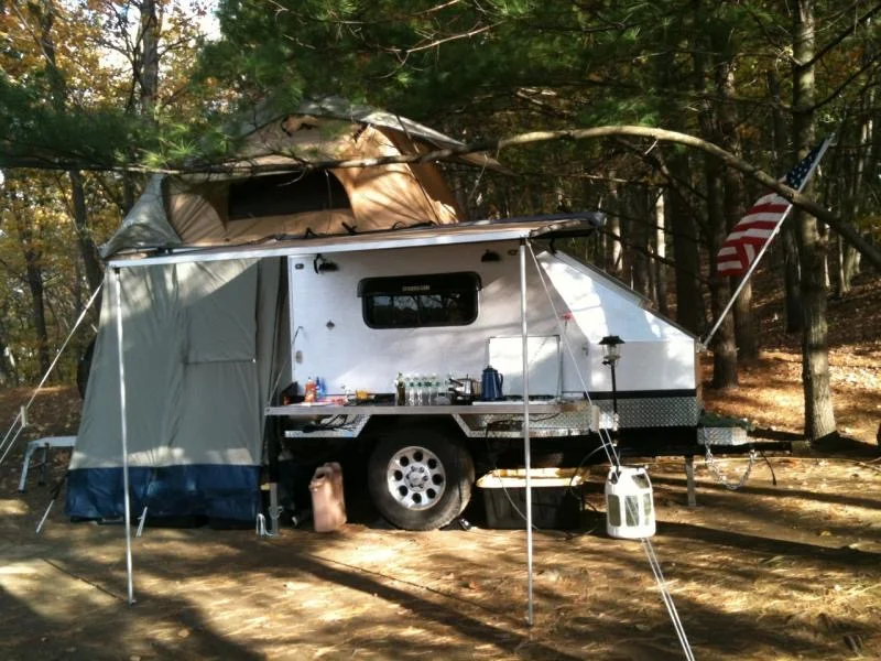

A couple photos of things I’ve come across
At the top of the economic pile, there are dozens of companies making slide ins now.
But this one has always been my favourite.

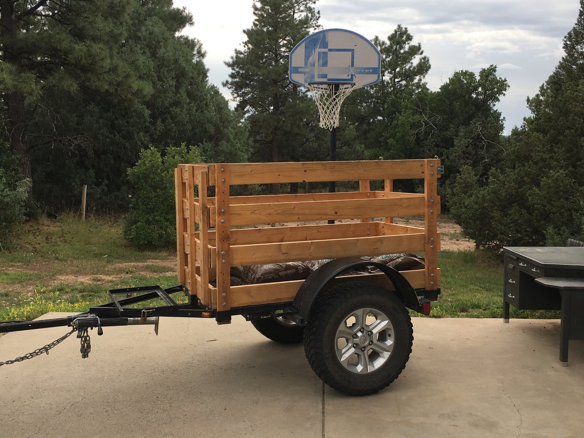

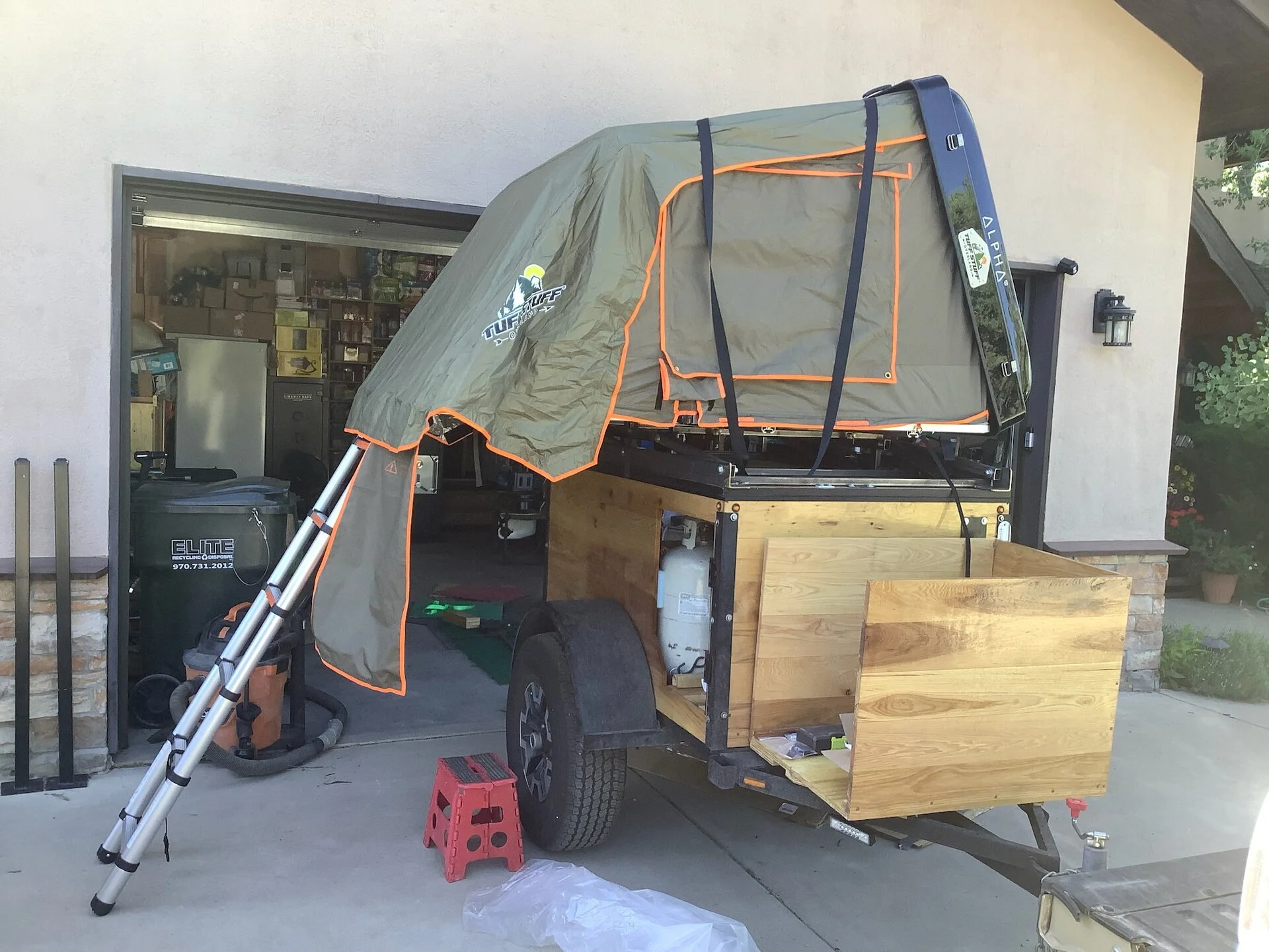

I kind of did that with my trailer and I would guess a lot cheaper than others.
I can use it as a flatbed, stake bed or put my camp box on it.

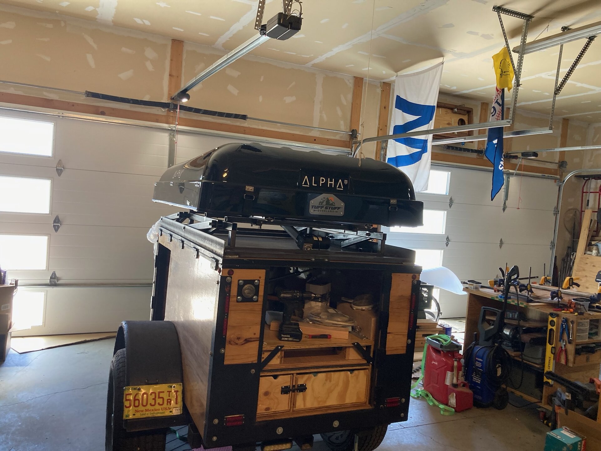

Would it be possible for you to briefly explain how you place this tent pod onto your trailer (and remove it)?

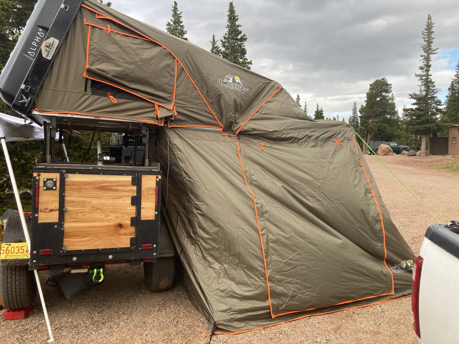

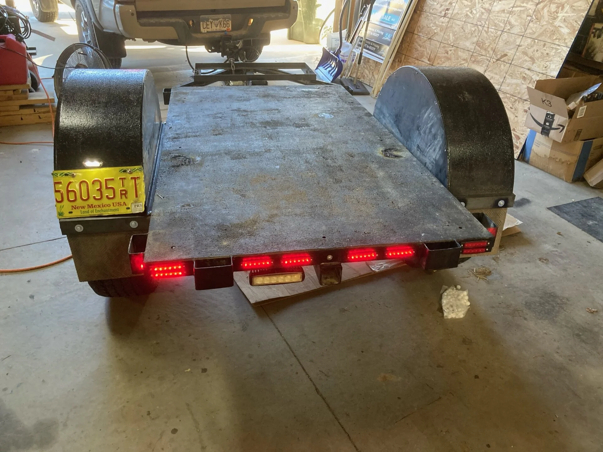

I hope this answers your questions.
The box is made from Hickory wood, tongue and grooved, I use TotalBoat penetrating sealant and a 2 parts apoxsee for the glue, covered with a TotalBoat spar varish and then bolted to the trailer via 4 bolts. I get 3 other guys and we lift the box off and the I put it on saw horses or something. It would be nice to have lift in the garage for this.
Then I have a metal frame a local welder built for me. It is based off a motorcycle lift, with a electric actuator to lift or lower the tent, I have a ECO battery pack in the trailer. This was done to keep it lower going down the road and raise to attach the tent annex.
The RTT is mounted to the metal frame lift. The frame cross bars where built for this based on what the manufacture recommended. The Tent is easy to lift off and on, 2 people. I store it on a couple of saw horses, again it would be great to have a lift inside a garage.
