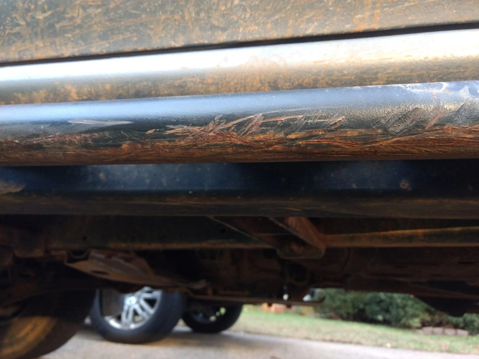

Quick history: Slee skid, step sliders and ARB installed in 2004 by @BROKEROB1 --Cruiser had ~100k on it and lived in York, PA. Rob used it as a family Wheeler with no lift and went to Paragon and Rausch Creek A LOT. I bought the 80 in 2009 with 165k on it and used it a half dozen times at Rausch Creek, a few times with the capital land cruiser club in the George washington National forest, and a couple times wheeling in the Fredericksburg area with @Skrewball and the guys from IPOR. In 2011 or so, I put on a set of medium TJM springs (also from slee) as I was tired of scraping over EVERYTHING at RC. Moved to California for 3 years and bashed in on the rocks out there a handful of times, but not a whole lot of use. Moved to Virginia beach in 2015 and have made the last two Logan's runs with ONSC, as well as a handful of back country, light wheeling trips. So, all that to say, the armor has seen plenty of use as I am not shy about using it as intended.

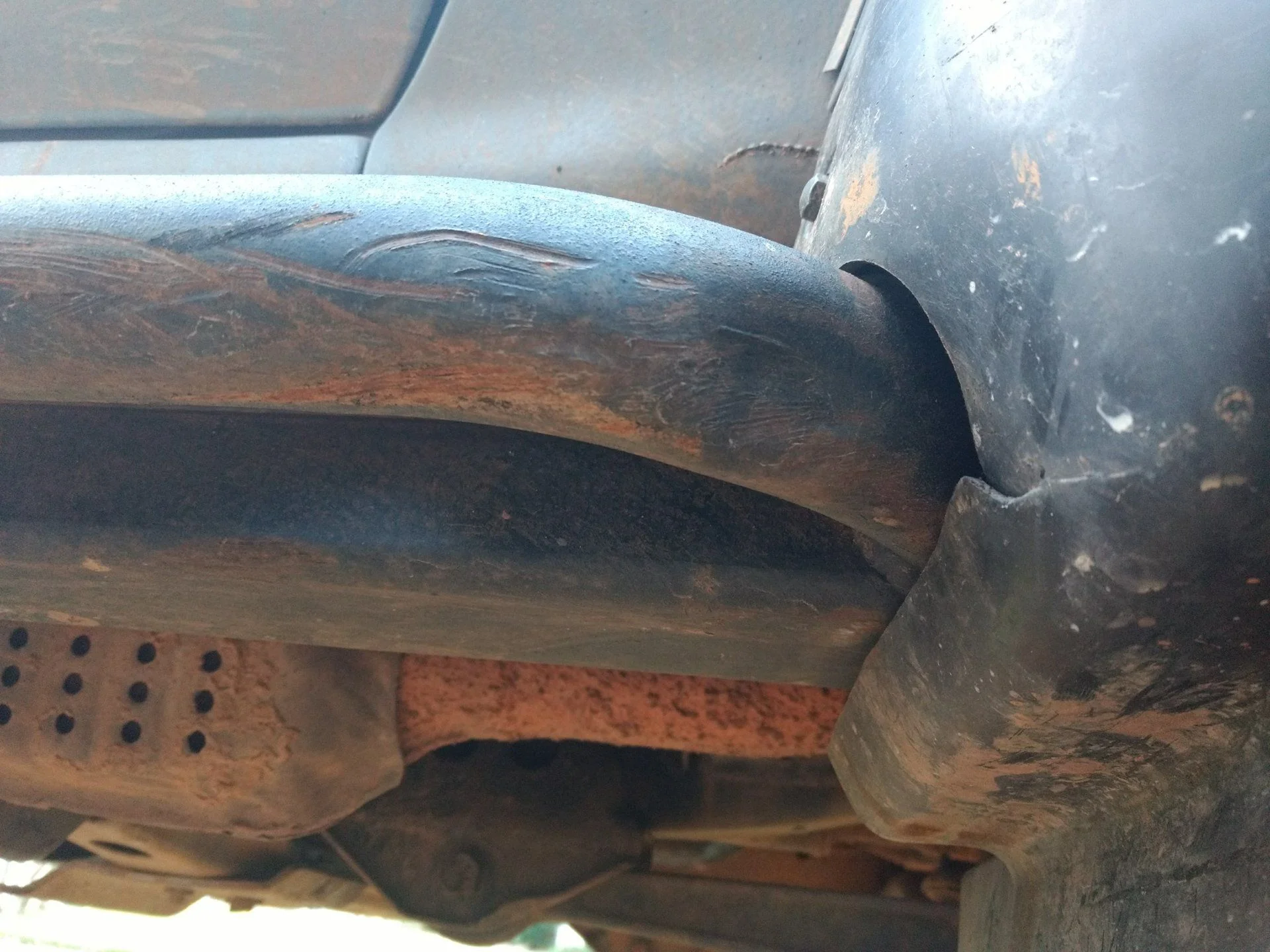

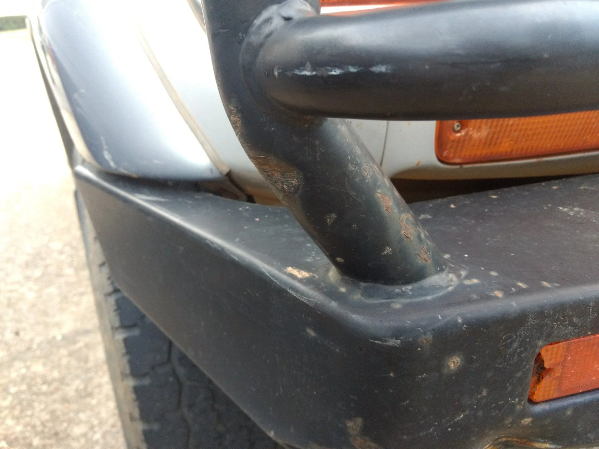

This is the passenger front corner--note the gouges and the silver dollar sized depression--that was courtesy of me misjudging a rock and turning into it too quickly while going faster than I should have been--I was amazed at how little it damaged the slider after the impact that I had felt.

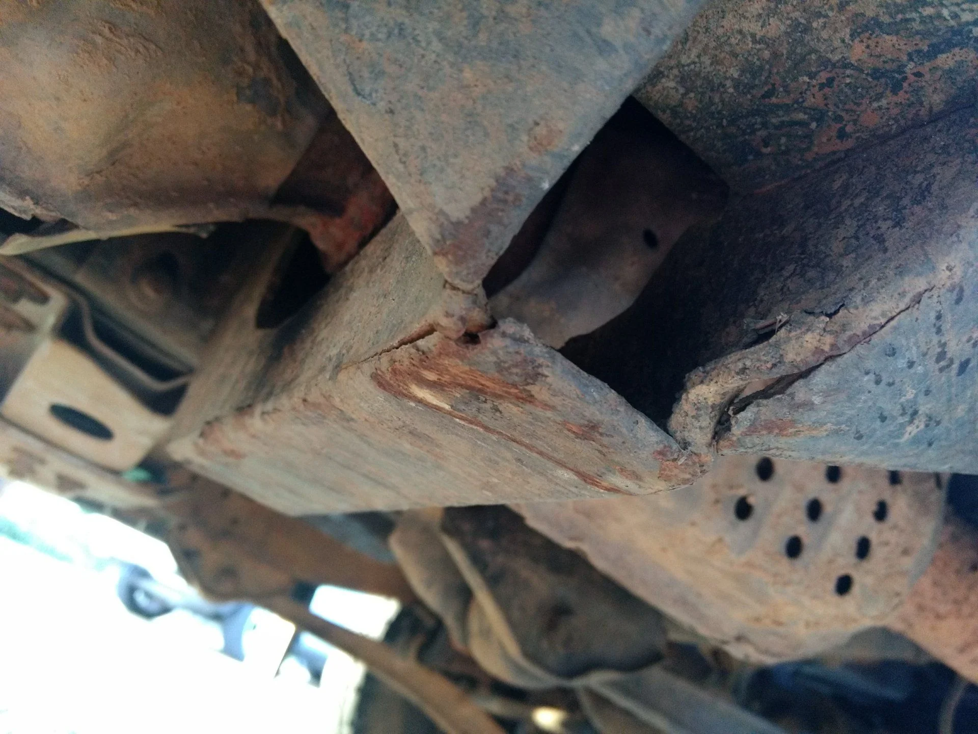

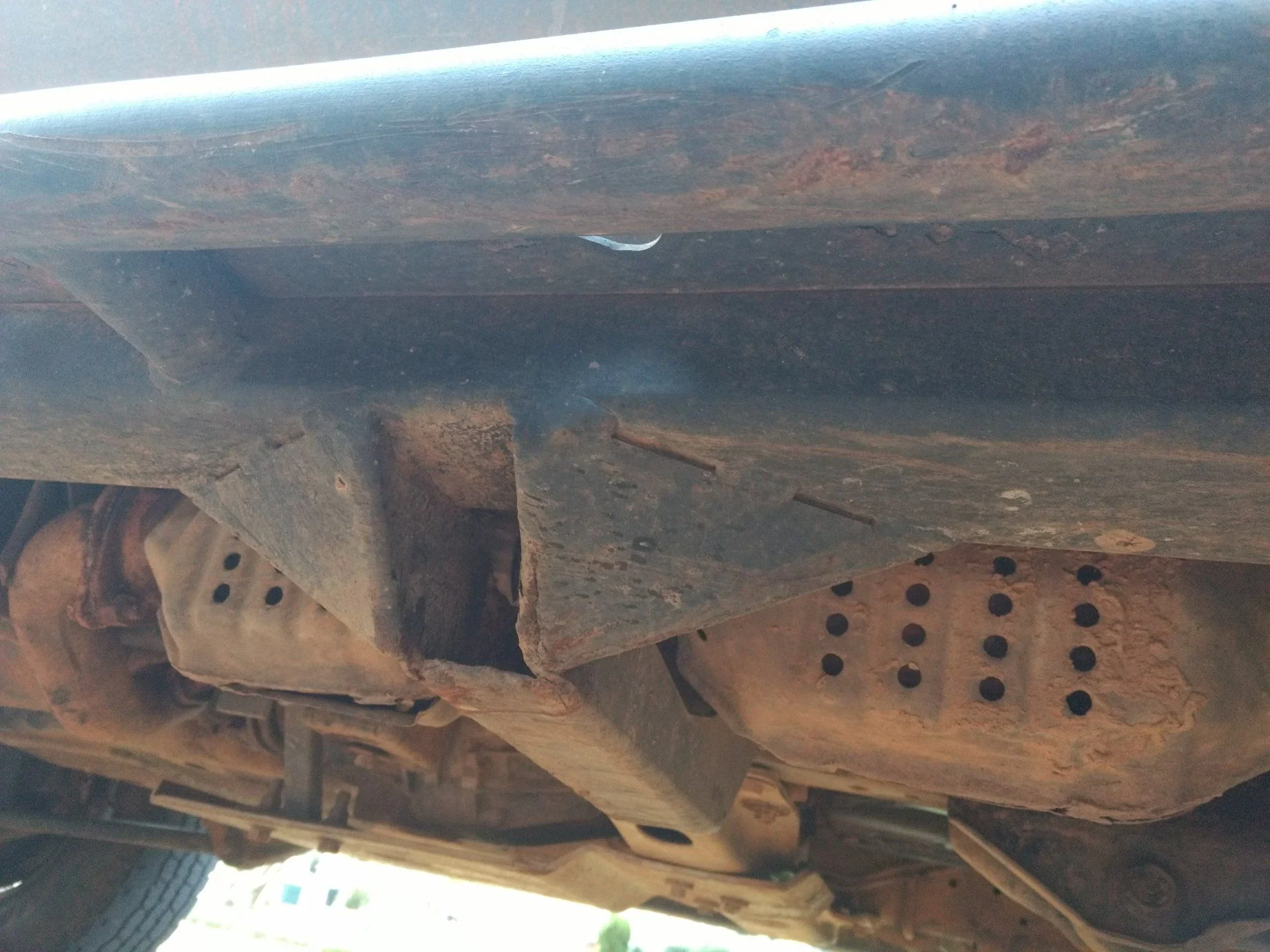

This is the support arm protecting the Cats--If I had one thing to change, I'd say that a plate here might be useful, but it would also keep the heat in and make the floor hotter so I have plans to add one. As you can see, I have done a bit of a number on those welds as I hit this spot pretty often. 30 mins with a wire brush and a welder will make this as good as new--there is plenty of metal left and it is still plenty strong. You can also see the old style slee transfer case skid in these photos--still as strong as ever and I have yet to be able to even bend it. I know the new design is different and better by all accounts. Also, take note of the front control arm mounts and the bent rear control arms--I tend to hit things on rocks sometimes:D

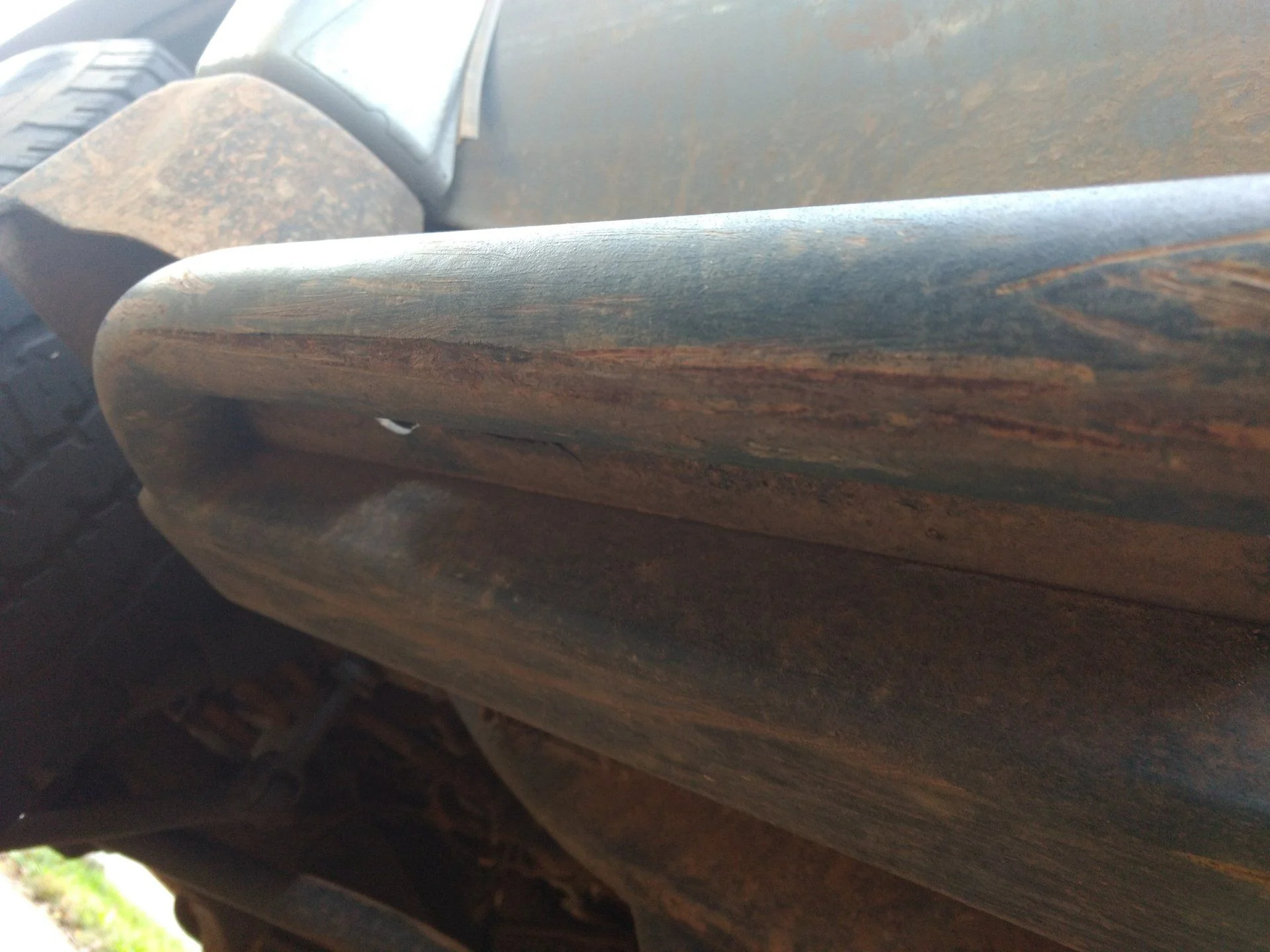

Passenger rear corner, nothing but a few gouges.

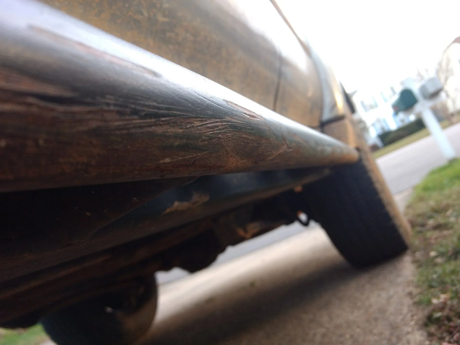

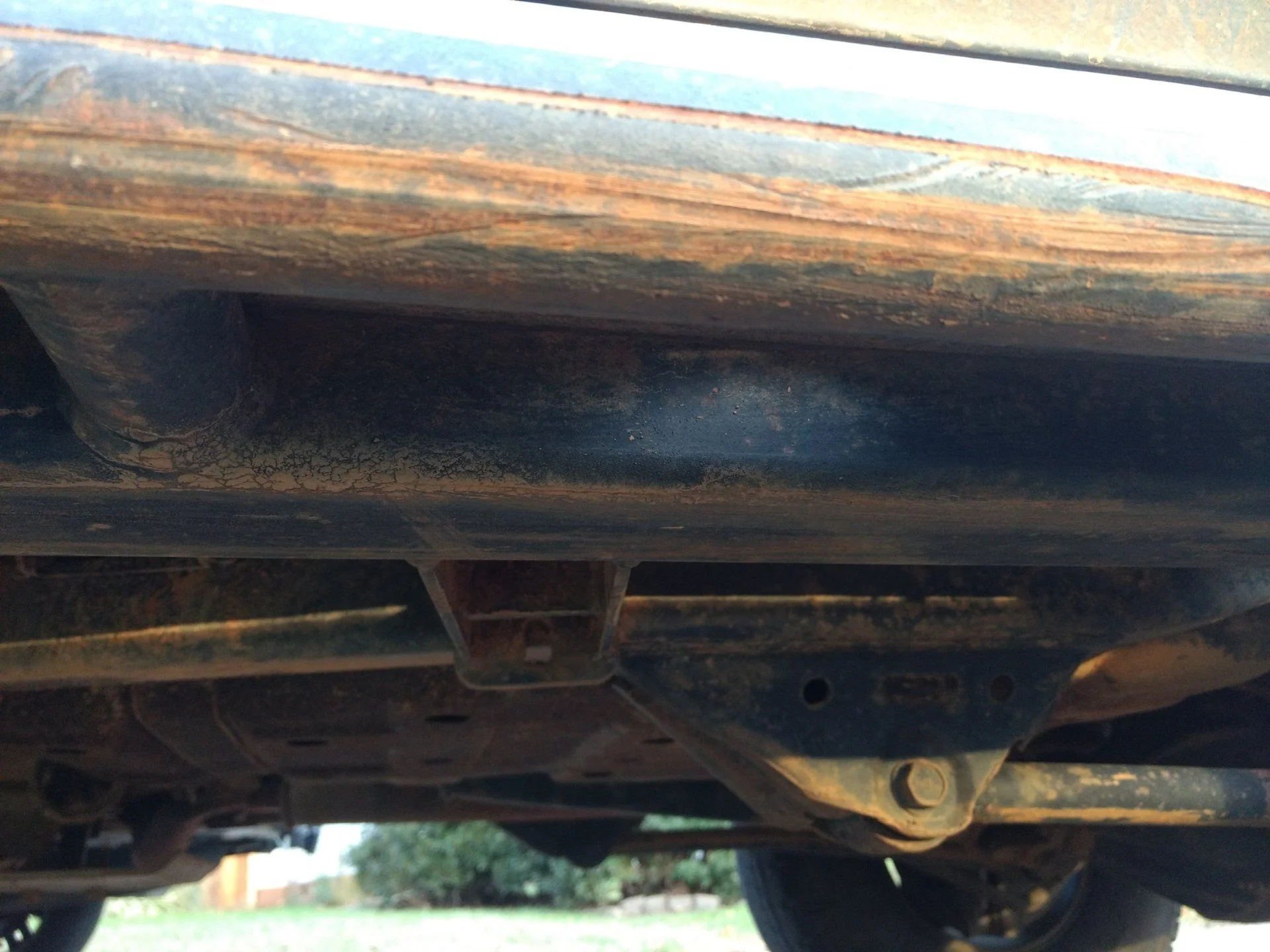

Driver side rear. Note the deeper gouges here as I am a bit more aggressive when I can see the rocks I am running into. Also note the missing mounting u-bolt--This mount is one of three on the driver side. It has been broken since 2010 or so after a just perfect hit up at RC. I jacked up the 80 via the rear part of that slider and it didn't deform, so I haven't bothered getting a replacement--I keep meaning to contact slee for a new one, but it just hasn't been a priority. i have taken 18-24 inch drops onto rocks on that side and the slider has never pushed up into the body.

More gouges and evidence of a rattle can touch up I did a few years back.
Still straight as an arrow with one dent from a particularly hard hit...
This was a hit from this year coming down Dickey Bell at Uwharrie--It was significant but not nearly as hard as the slider hits--you can see how much the ARB deformed comparatively.

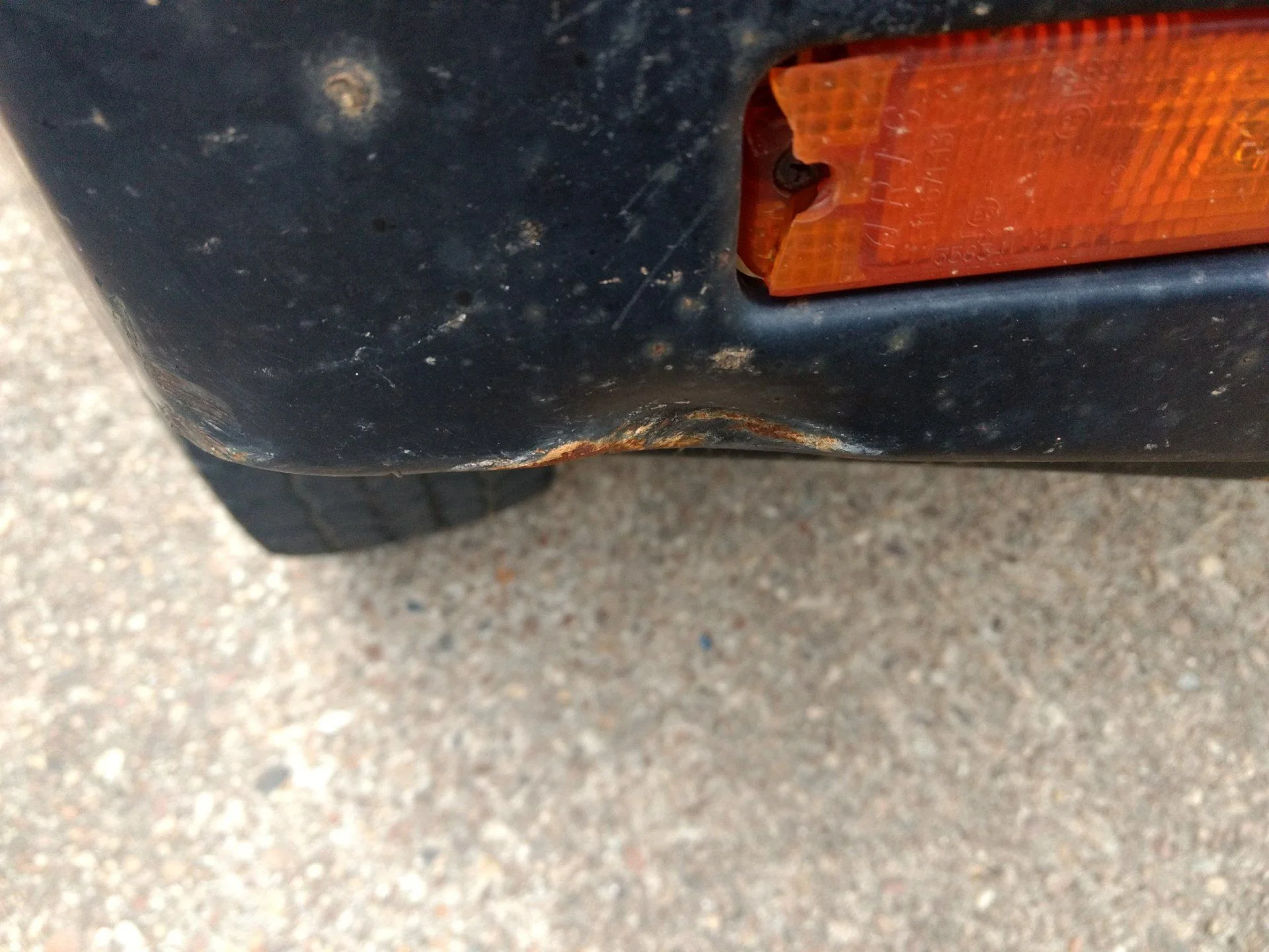

This was from a climb at RC--I was surprised how much this deformed as it didn't feel like that hard of a hit. The ARB was from Slee also, but not built by them obviously.
So then, you can see that the slee step sliders are in a completely different league compared to the ARB--A little wire brushing and paint and they will be serviceable for many years to come. Many thanks to Christo and his crew for outstanding products and service through the years!

That arm under the cats is a rock grabber and the failing welds show either improper welding, design, or both IMO. I imagine theyve considered revising it as even repeated hammering shouldnt fail like that.
The sliders from Crusin Off oad have a slick plate of flat steel covering the cats with the leading edges rolled up to slide over. That cat area looks like a rock grabber, not a slider.
Yep to rock grabber. I had Slee step-sliders & Hanna's - Hanna's FTW, has a cat guard w/o any spots that grab.

Right. White knuckle have the same slidey ramp plate thing too.
I don't think that you can make a weld that will hold up to 6,000 lbs hitting it 400+ times and not show some wear. That said, it does seem to attract rocks but I prefer that to a hotter passenger floorboard. For those who have a plate there, do you notice the passenger floorboard heating up more?

The white knuckle sliders are the only ones I've seen in person. Just put them on a few weeks ago. Not many miles yet. However, I didn't notice any extra heat and neither did the passengers. I also rode passenger for a couple hours. It's not that big of a plate. Oh and the front and back of it is ramped.
Sure you can. Its the peeling action thats a problem caused by that design
Got pics? I am considering adding a plate when I repair those welds
