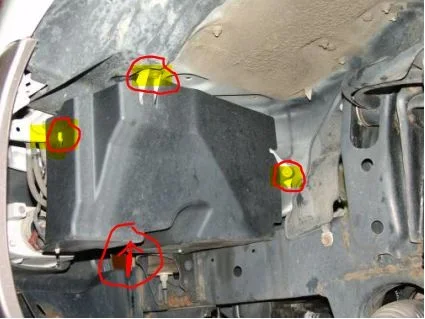

-Note the washer reservoir has 3 bolts (one hidden from sight unless you get under the truck AND a little plastic doo-hickey on the reservoir bottle that clips into the cover. If you remove the first two that are obvious in Slee's instructions and you curiously yank on the cover you will hear a sickening snapping sound (ask me how I know) of the third not so obvious bolt. And pry\release the little white plastic doo-hickey off carefully. Locations all shown here:

There are three bolts to remove the washer reservoir, and you can just tilt out of the way without removing any harnesses in order to secure the battery tray.
