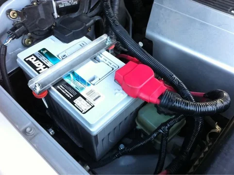

The new bracket takes a little work to add, but it really firms everything up nicely. It sits under the tray and connects to 2 additional holes at the bottom of the inner fender. Christo sent me a really nice pic to show how the new bracket is mounted. Plus a couple crappy pics of my setup from my IPad.
One other thing I forgot to add, I would pay $14 for this mount if I didn't have it yet. Before, if I grabbed the extended part where you can mount a fuse block and lifted up, there was movement. Now with the bracket installed, that has been reduced by 90%.
Looks like my setup with battery.

As the first one to encounter this issue, I am completely happy with how Slee has handled it. I expect mine was a very rare corner case, and Slee has addressed it.

Just out of curiosity is there room for 2 batteries in that location after the PS reservoir is moved? Can't wait to remove my AHC
They need to be very small I would think. Mine is a group 34.
