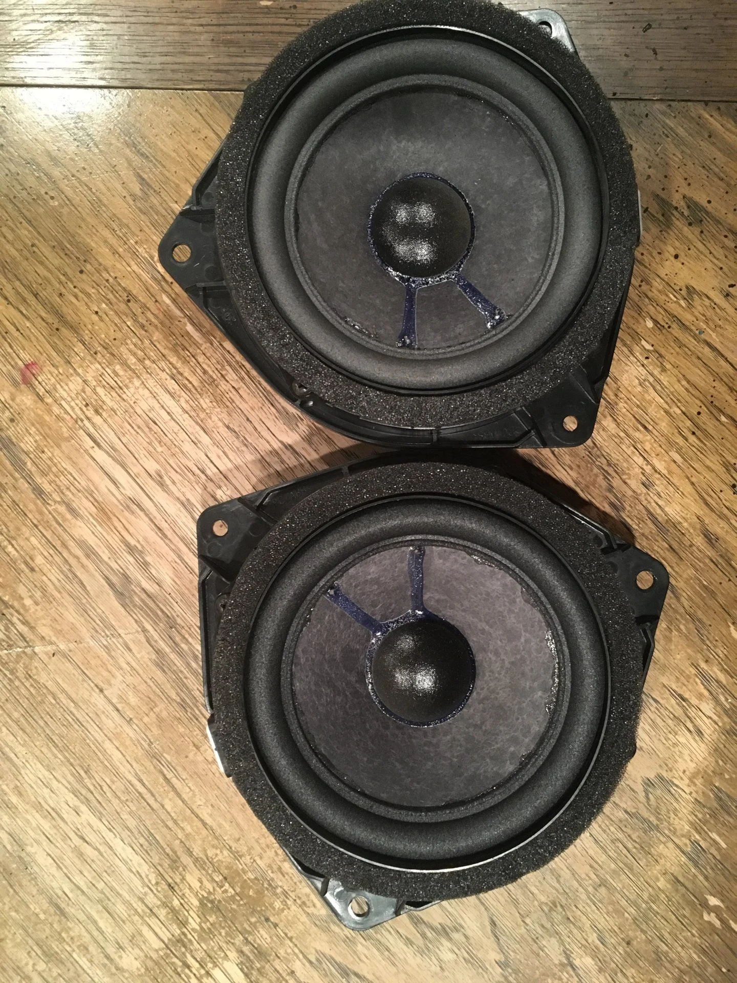

Passenger side looked as expected. Foam destroyed.
The drivers side was a different story. The foam was destroyed but the cone was also detached from the speaker cage. The speaker wires are still intact and the cone itself seems ok.
It all looks fine and I’m wondering if I can use the same glue that came in the speaker repair kit to glue the cone back to the basket, and whether that will even work. We’ll find out... it’s setting up now.
I also thought about running down to the junk yard and picking up a speaker and using the repair foam on that one. My repair may work fine, or I might destroy the new foam piece I just bought. I have to decide pretty quick. The junk yard closes in a few hours. Decisions, decisions...
I don’t know what the junk yard would charge me plus its not close. Looking for opinions...
Any thoughts on whether the same glue that is used to glue the foam will work for glueing the cone back to the cage?

That's what I got , but it's to replace the out foam. The adhesive that holds the cone to the cage had also given out. I used the same glue and reglued it
Does the speaker move? If it moves you might be okay gluing it. If not, the voice coil may be disconnected, if you push it while music is playing and it works while you hold it down, not sure if gluing it will work. You probably have nothing to lose trying.
It’s all put together and setting up. The speakers move the same as each other. I’m hoping everything is ok. We’ll see in about an hour.

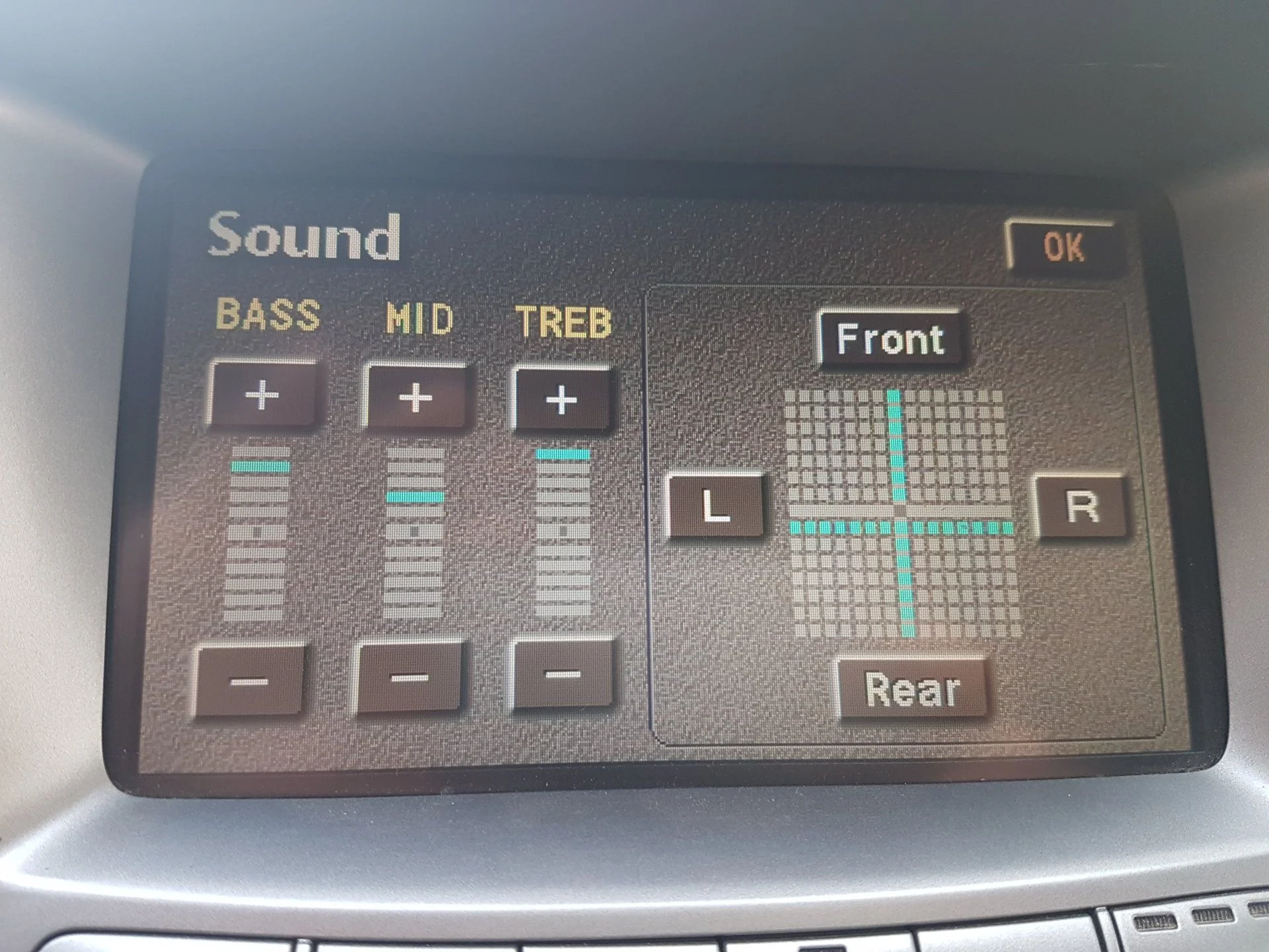

Buttoned up. I have to say that it does sound really good. I took some time to get the sound adjustments just right. I still think it needs some more bass and better frequency response in the mid range, but I'm more than happy.
Here's one more thing you can try. One of the first mistakes that beginning "sound guys" (sound reinforcement folks behind the mixing boards at concerts) make is to always boost whatever they think is missing, rather than cutting a specific frequency that is messing up the spectral balance. The more you boost a specific frequency or band, the more likely you are to run out of headroom on your preamp stage and introduce distortion. You electronics will be happier if you boost less, then just turn up the volume at your amp stage (your volume knob; the eq you're doing is at the preamp stage) to get the same overall level you have now. You'll have the same frequency response curve you like, but with less distortion and straining of your preamp stage.
In your graphic above, you have the bass band boosted four bars, the mids boosted two, and the treble boosted all five bars. That would make my ears bleed, but that's besides the point.. ;) . Instead of doing that, look at the relative differences between the three bands; the mids are two bars below the bass, and the treble is one bar above the bass. Soooo... put the bass back on the middle bar (flat), CUT the mids to two bars below flat, and boost the treble to one bar above flat. Same response curve, less strain. Turn up the volume if you wish. Most likely, you'll hear cleaner, better defined sound, but with the same tonal characteristics. Worth a shot, anyway. Let me know what you hear.. I'm curious.
