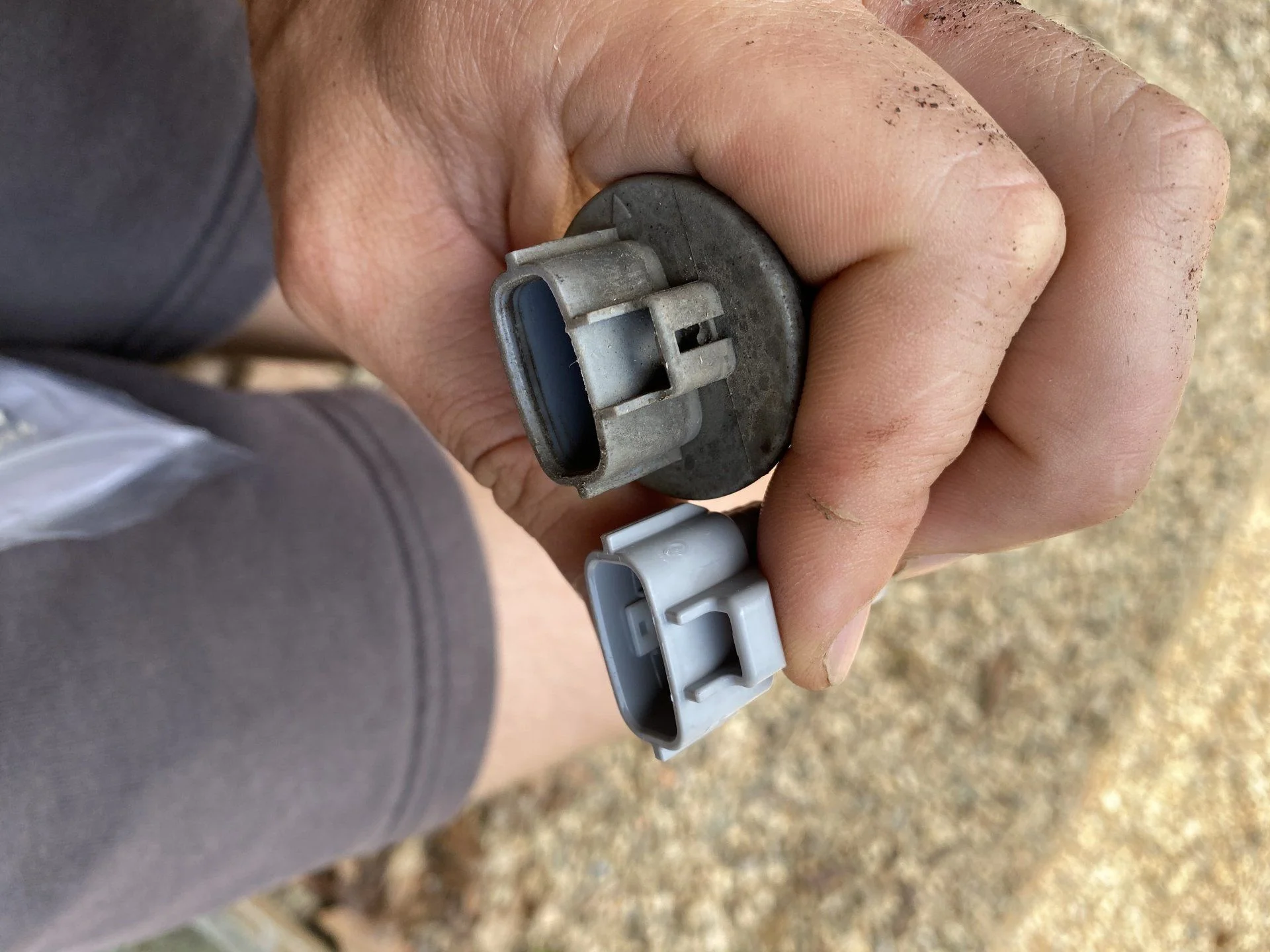

I hate cutting factory wiring so I bought plugs which plug into the factory turn signal plugs. Then I drilled holes into the corner markers and install these Dorman sockets and used a 921 bulb which is nice and bright and has enough resistance so you won’t get hyperblink. That’s it. Pictures below.
Here are the connectors I used to plug into the factory harness.

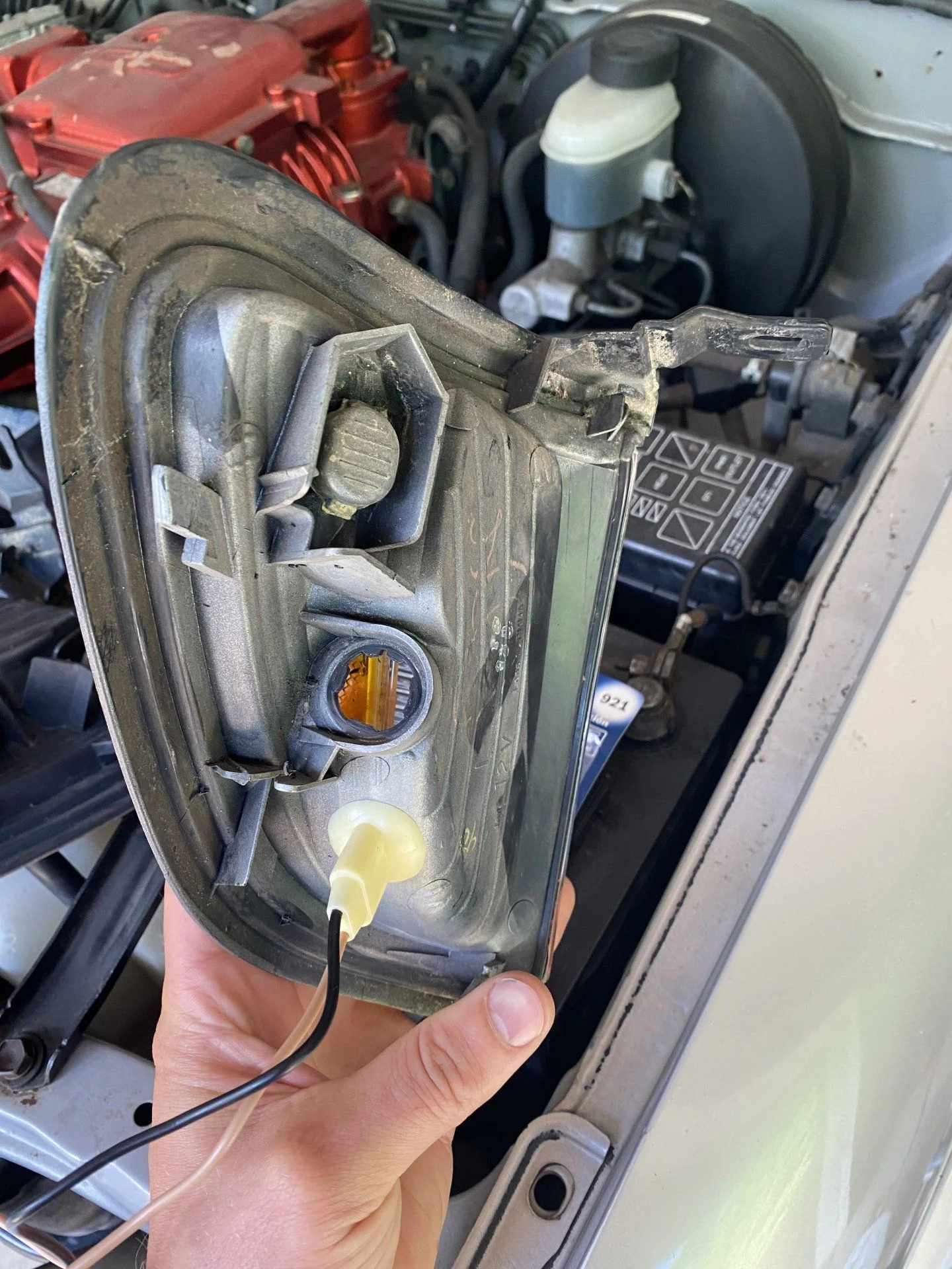

Remove the corner lights and drill a hole below the existing bulb. Insert dorman socket to ensure proper fit
Pin your new dorman sockets into the new plugs.
Factory bulb housing is the upper socket. Lower socket is the new connector.
Push the new Dorman socket into the hole you drilled in the corner light and fish the factory harness up to where you can plug everything together. All done.
