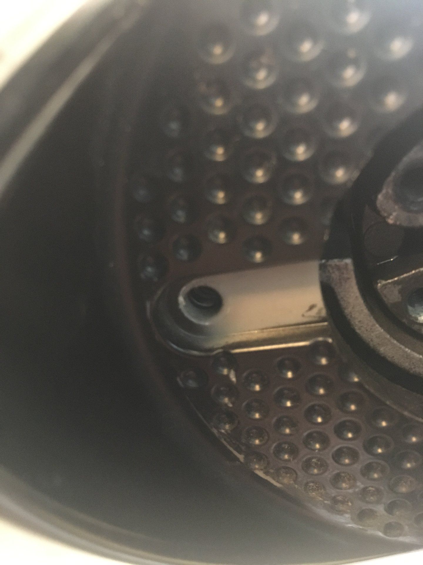

While I had the three bolts removed on driver’s side mirror, I pressed the mirror fold switch on the dash. I can faintly hear the motor inside the mirror click and hum briefly, but the cast aluminum base (where the three replace bolts thread into) inside the mirror does not budge:
My thought is that the mirror folding motor is kaput. The replacement assembly seems to be the only option I’ve found online ($$$), as I have not been able to locate the part number of the motor. I’m trying to avoid purchasing the whole unit.

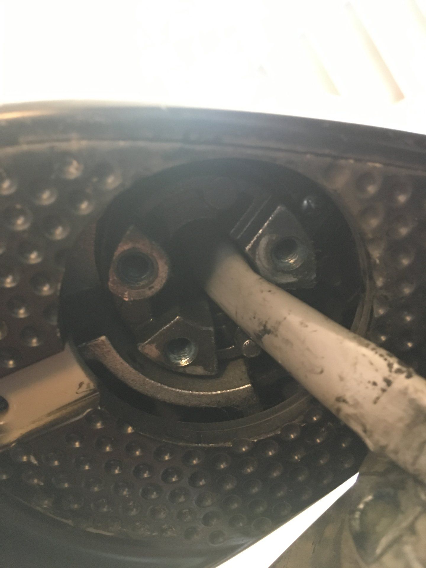

2) Has anyone disassembled a 200-series side mirror? I’d like to inspect the internals more thoroughly, but I cannot figure out how to separate the outside cover and lower portions from the assembly. I do not want to force it and break a fragile plastic tab, etc. I removed this screw and inserted a small, hooked pick in the hole (drainage hole?) to the left of the screw (on the lower part of the assembly) but wasn’t able to pry the two pieces apart:
Any help would be greatly appreciated.

While I had the three bolts removed on driver’s side mirror, I pressed the mirror fold switch on the dash. I can faintly hear the motor inside the mirror click and hum briefly, but the cast aluminum base (where the three replace bolts thread into) inside the mirror does not budge:View attachment 1795681
View attachment 1795679 View attachment 1795680
