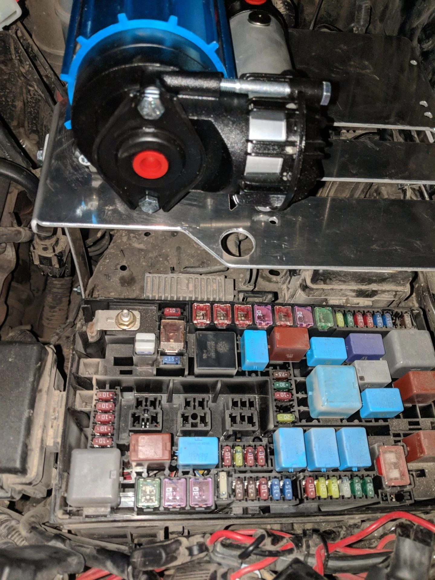

Hi All,
I accidently shorted this post in the fuse box trying to install this arb compressor. It's the post in the rear passenger corner of the fuse box. In the picture it's the upper left corner. At first I turned the ignition to on, to see if there was a CEL and heard a whirring noise then the noise stopped it was less than 2 seconds. The truck starts up, but the abs and center locking diff light stay lit. And I'm not able to shift out of park. Any ideas how to fix? Thanks
Sounds like a blown fuse or relay. Codes?
No CEL. OBII reader was recently stolen. Had to bring it in. $510 to replace the 140 amp alternator fuse from Longo Lexus. =(
