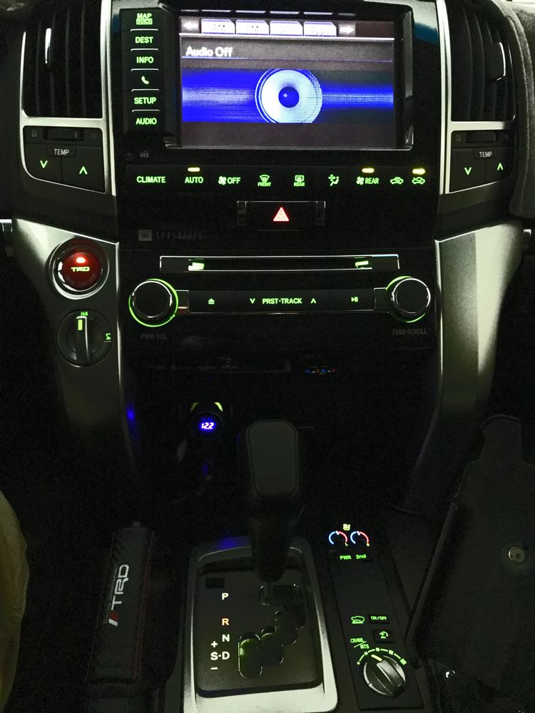

I'm surprised nobody chimed in with some pictures - so... here is what the console on my 2013 LC200 looks like when illuminated:
The entire shift gate plate is backlit so the letters P,R.N,D, etc. are clearly visible at night, but the lighting on the shift plate does not change when a gear position is selected - the lighting is the same no matter the position of the shifter.
HTH

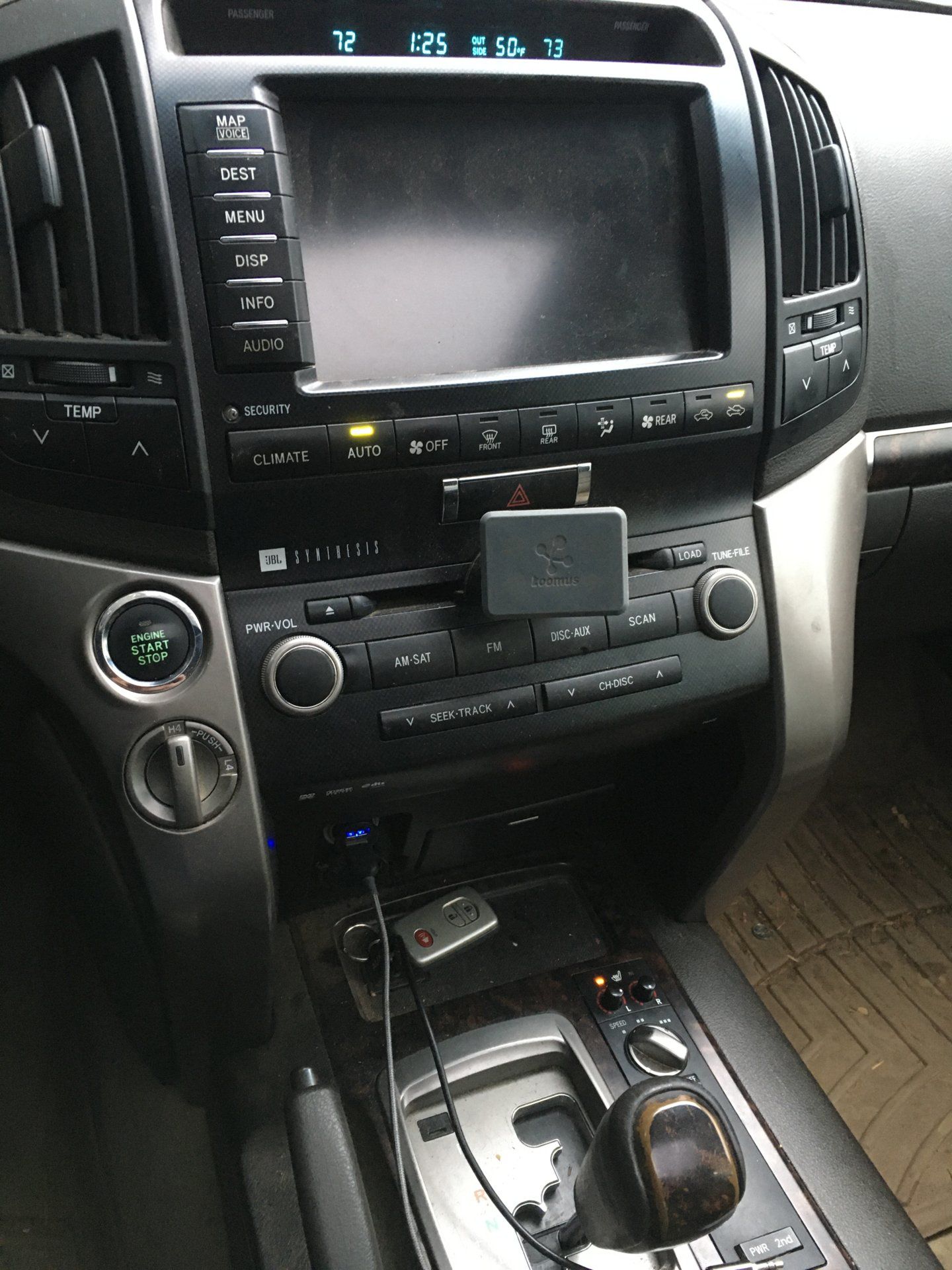

I was going to check my '08 for you yesterday, but forgot to drive it so I had an excuse to check.. hopefully tomorrow night

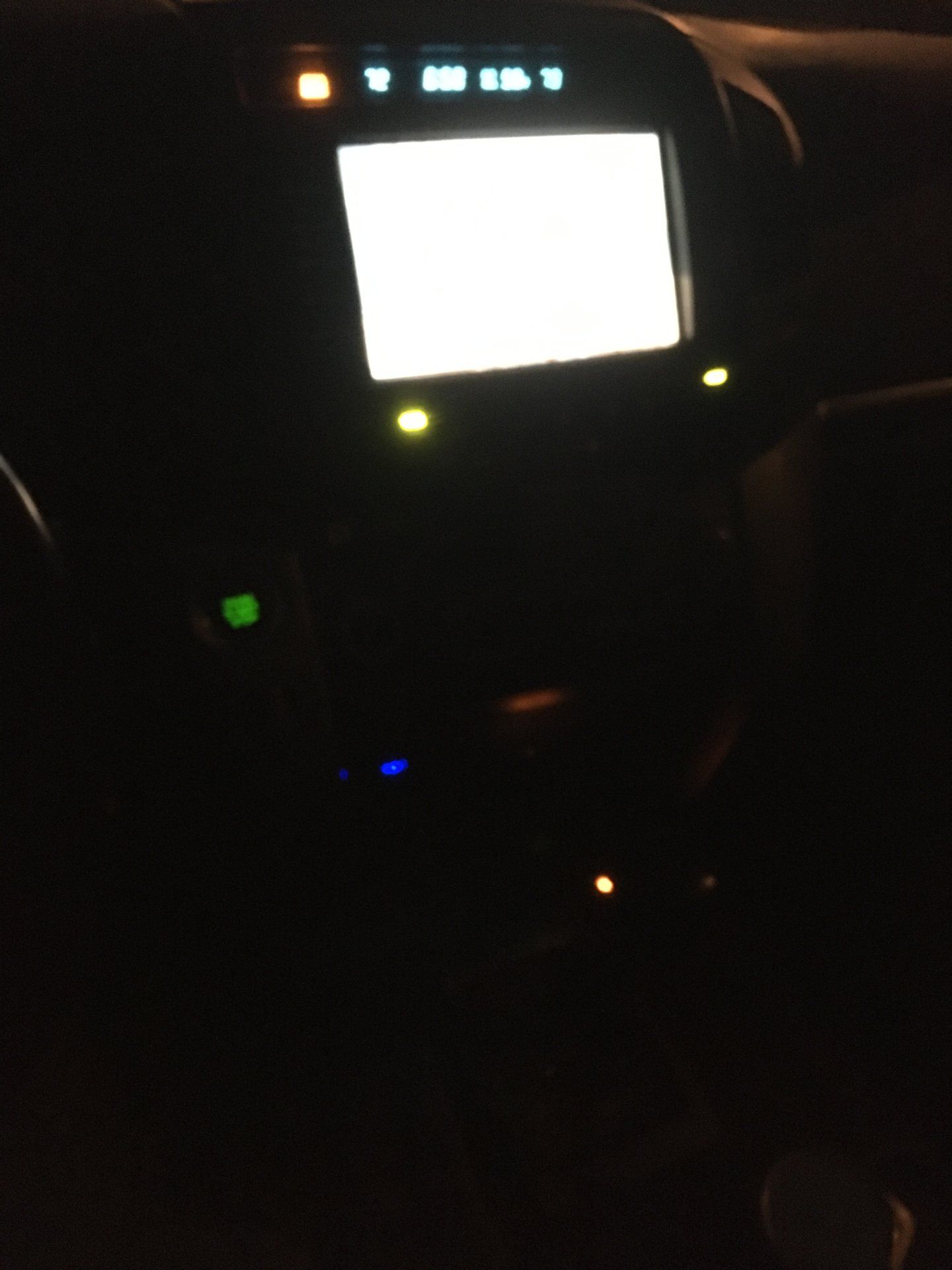

Nice I’ll have to take it apart and replace my bulb. How about the lights around the screen? Temp up and down, etc... all that is dark on mine too. Maybe I have a blown fuse or something.

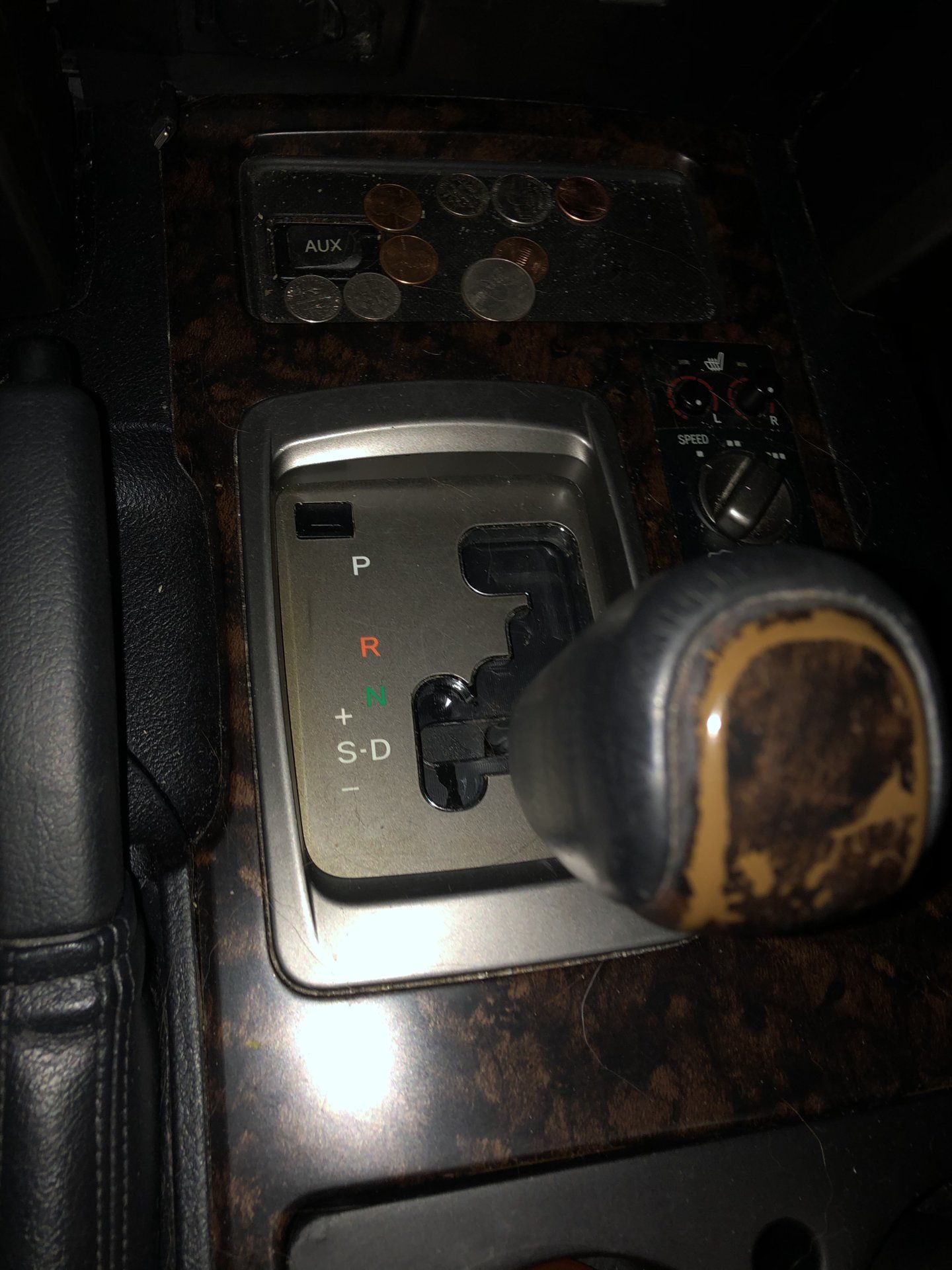

Here’s a night shot. I feel like maybe it’s a fuse since so much stuff isn’t illuminated? Anybody have any guess?
