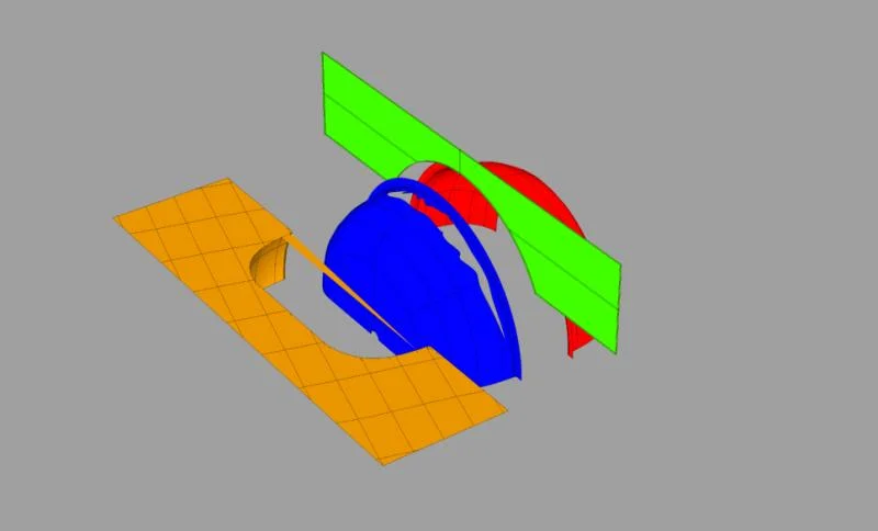

okay hope this shows up
I made a quick 3d what I think are the wheel well parts. The blue part is the inside wheel well. The whole in it represents the rot that has eatin though the wheel well. Can this part be cut out, length wise down the center line and a new piece of sheet metal put in its place? Would it be easier to locate rolled corner trim that is rolled 90 degrees and welt it on the edge of this piece of sheet metal?
