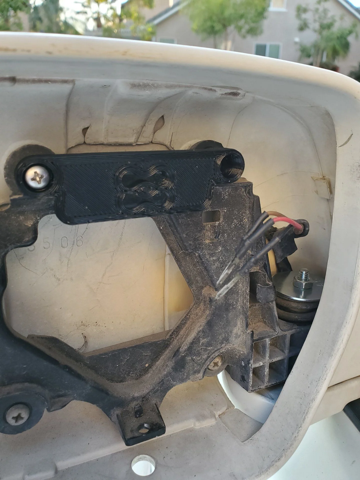

Just installed my drivers side. Nice job printing D and P for each side. The repair clip is pure genius. The mounting on the bottom actually tightens now! I had some issues wherein the upper right was still loose but it turned out the repair clip wasn't totally seated correctly. Once I fixed that, it works great, nice job @Outsane!

My mirror started flopping on me so I ordered the bracket and fixed the FMS and SMS in about 30 minutes.
Thank you so much!
Installed this weekend. :) I honestly had no clue what I was doing when I pulled the mirror out and had to scratch my head for a while to figure out what I was supposed to do. But I eventually got there. :hillbilly:

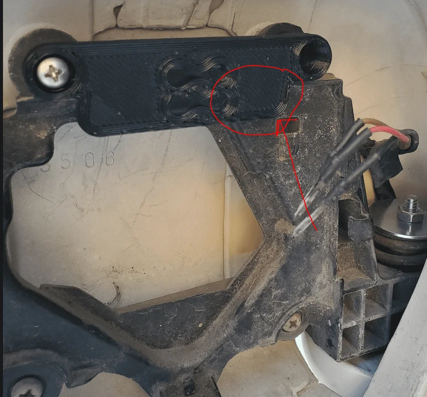

I discovered yesterday that mine's a bit loose on the driver's side. It appears that there's some play in the spot indicated on the pic (borrowed from @Poondoc :) )
Anyone else have a slight play on the right side of the bracket? I removed and reinstalled and it's just a bit loose on that side. Thinking about just wrapping some electrical tape on the mirror motor and jamming it back in to "fix it". :p
On the driver's mirror, right side. My motor housing has a slight extruded ridge (vertically in the middle) of the piece that goes up into your bracket. Not sure if it's just pivoting there or not. If I tap on the left side of the mirror, nothing moves, the right side has a smidge of play. I don't "see" it in the mirror unless I hit a good pothole or bump.
