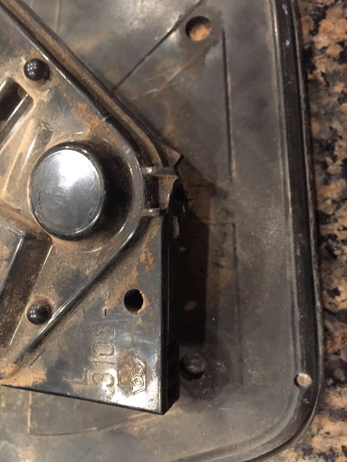

But seriously, five minutes and a couple squirts of Deoxit later and I have a stable, functioning power mirror. Brilliant!

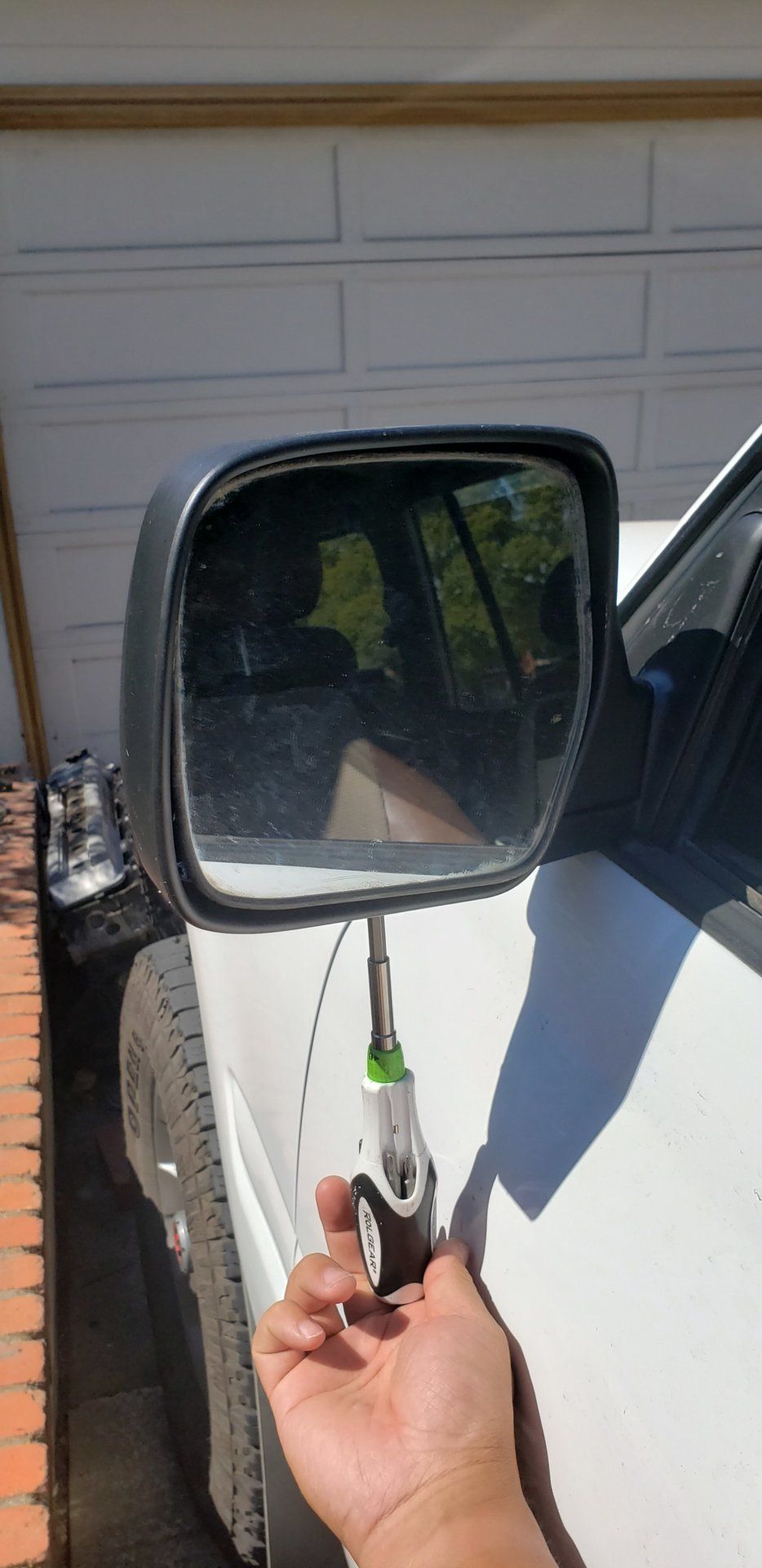

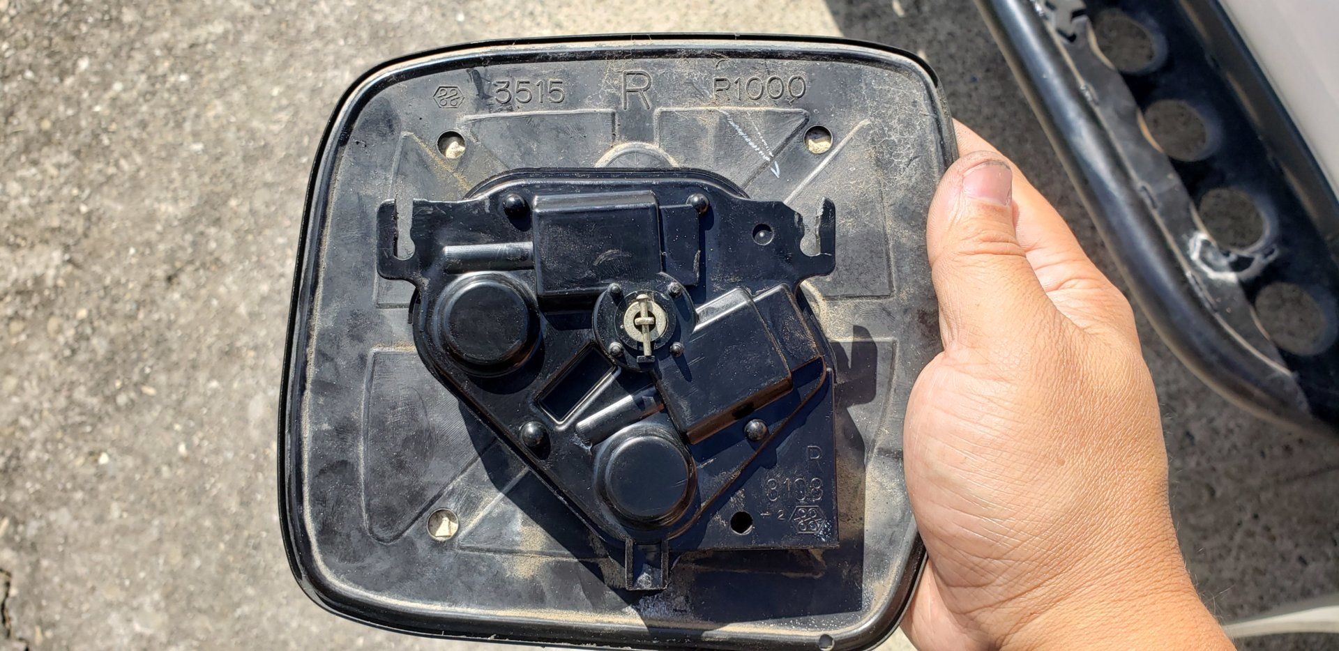

If the tabs are still in place you may need to slot them out.
Insert mirror back in, top first under the bracket
Re attach screw throu the access hole
Adjust mirror

What did you use to slot out the tabs? Just a file or did u cut them somehow?
