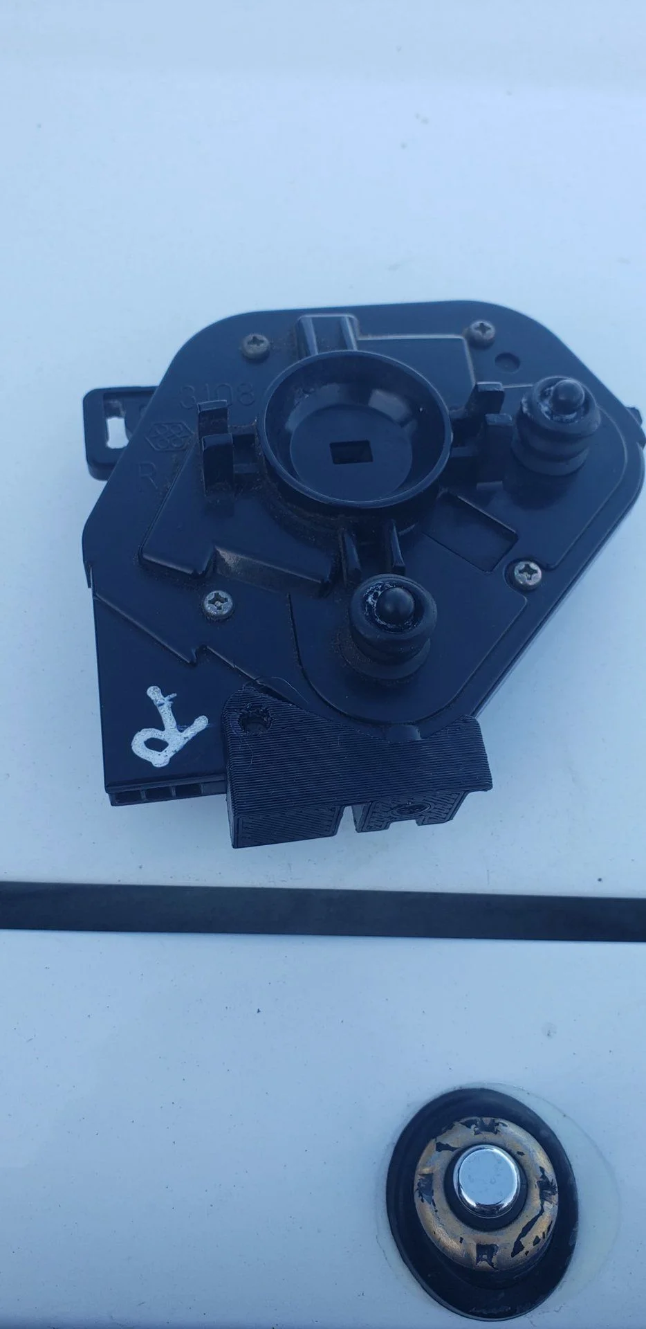

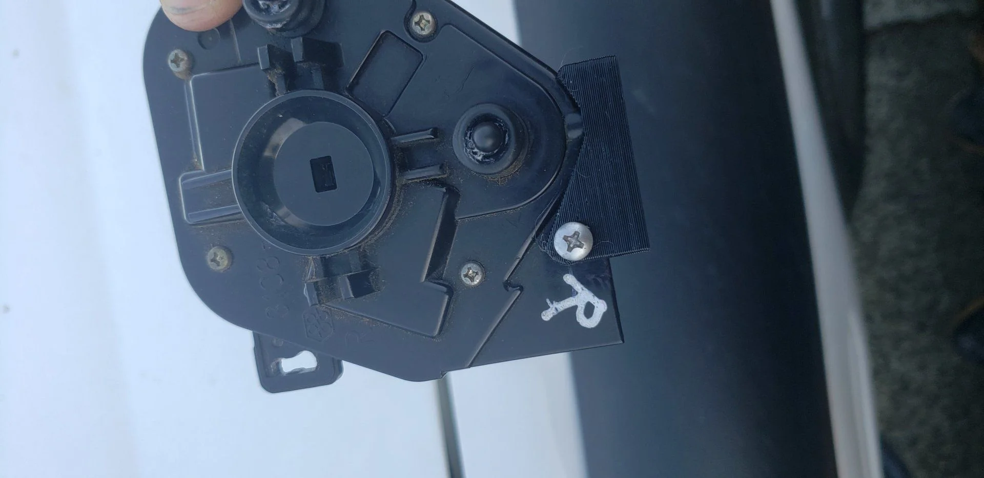

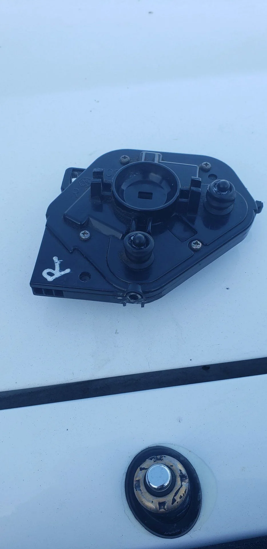

Installed the "drivers" side bracket on my passenger side of my HDJ81, so I can confirm these work on RHD trucks as well if anyone had that question in their minds. I did have to cut the unbroken tab which gave me a bit of pause, but otherwise install was very quick and smooth, 5min sounds about right. Great product!

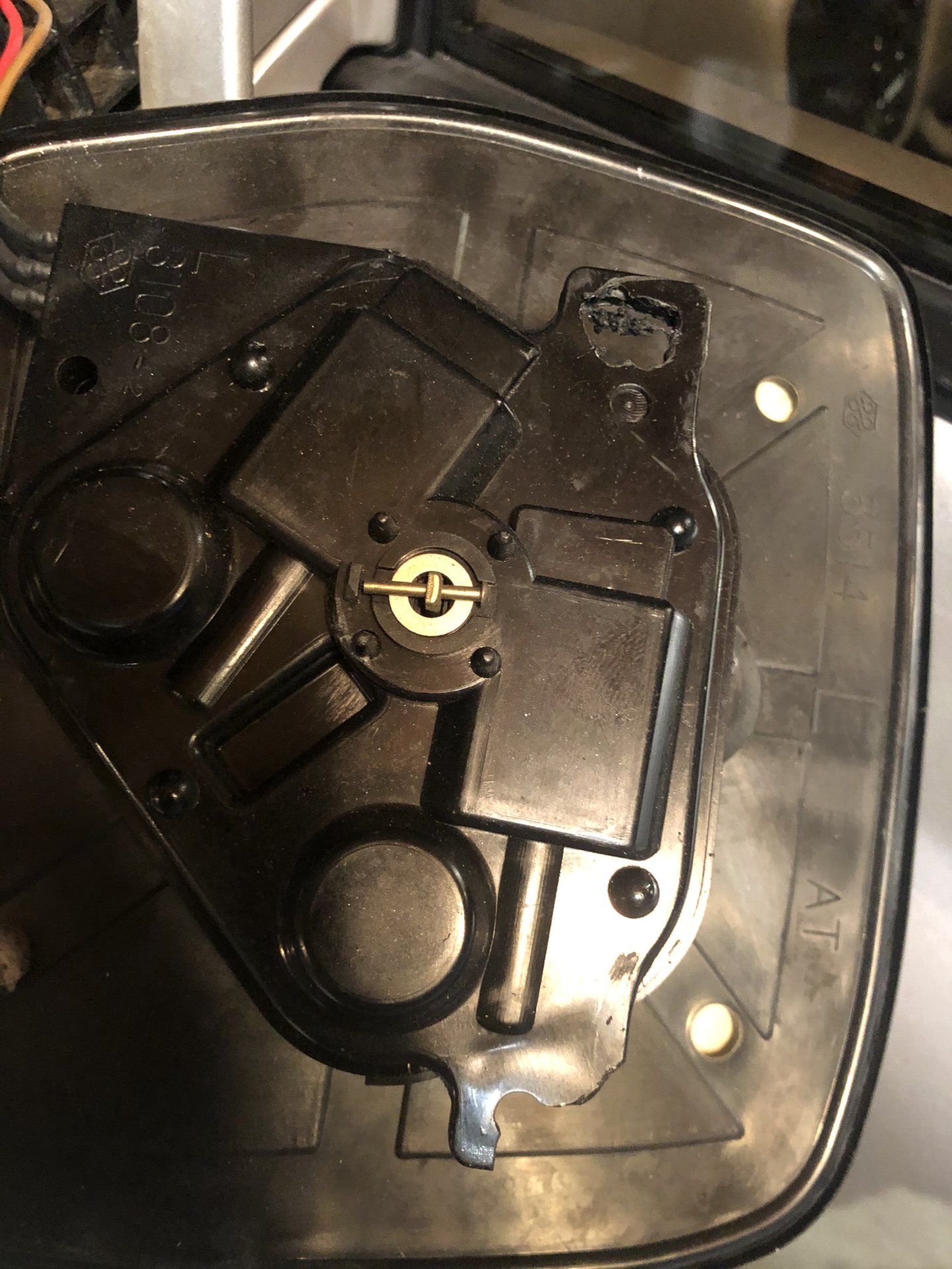

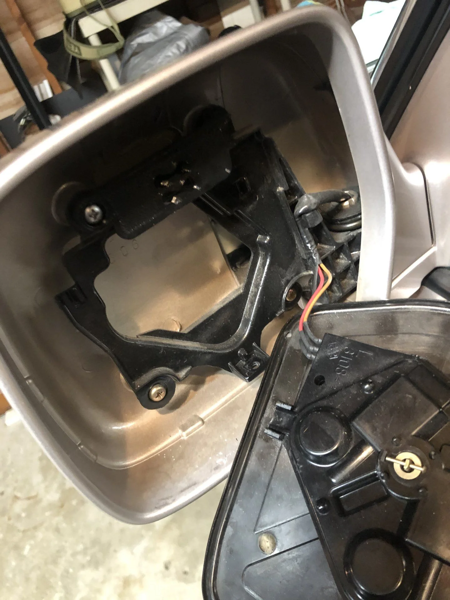

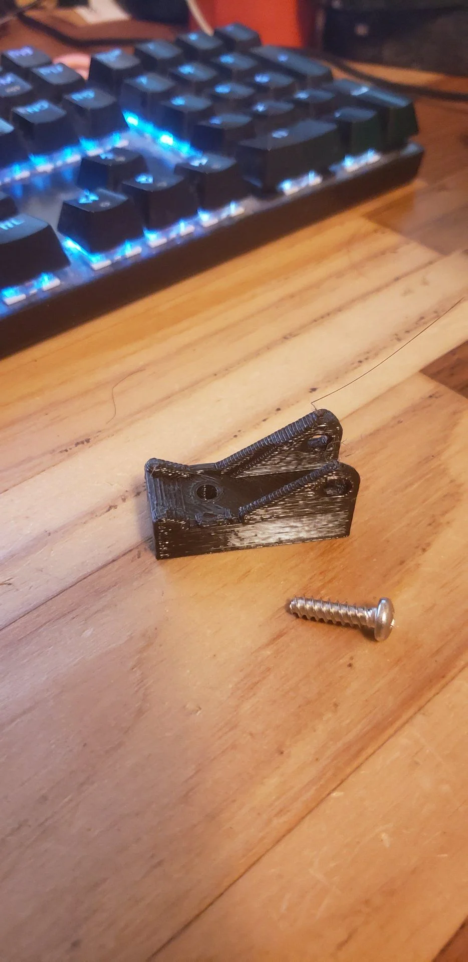

Hope I did it right! Cut tab completely off
If your bottom post is busted i now have a solution.
Sand off the bottom post, so its flush. Take your time.
Install the bracket
Screw in the provided stainless steel screw
Install as shown above in the video
There is a passenger and drivers side
Go wheeling

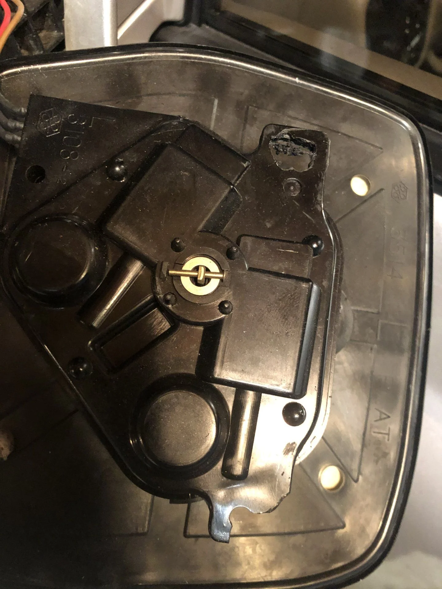

Great, I need this. After installing the first bracket, I noticed one bottom mount is cracked. I have been worried about losing the mirror one day.
