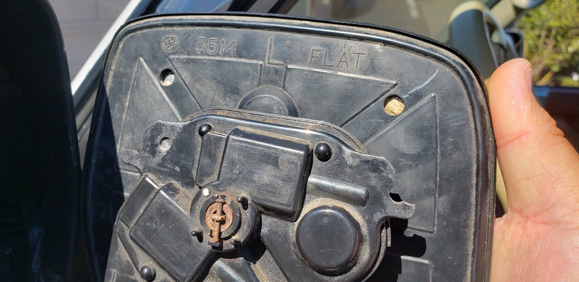

Common problem with the 80 is when the little tabs break on the outside rear view mirrors.
My fix is a 3d printed petg bracket
Here is a how to install.
Adjust mirror so it points all the way up, this will help with instalation.
Remove screw threw access hole ( #2 phillips)
Lift and pull mirror assembly.
Remove top two screws
Add bracket and supplied longer stainless steel screws to accommodate bracket.
If the tabs are still in place you may need to slot them out.
Insert mirror back in, top first under the bracket
Re attach screw throu the access hole
Adjust mirror

@Mr. Lawrence the bracket mounts to the existing screw locations.
Power adjustment works great.
I see where your bracket mounts to the inner part of the assembly.
The outer (mirror) half of the assembly is where the plastic hooks usually break off.
Does the mirror part just slide under your bracket to hold it in place?
Seems like all the weight of the mirror would rest on the pivot screw?
This looks like a great solution to a very common issue! I'm also interested in exactly how the bracket holds the mirror in place, I'm not clear how the extra support is provided either.
This is how it works!
Ordered a pair just now!
