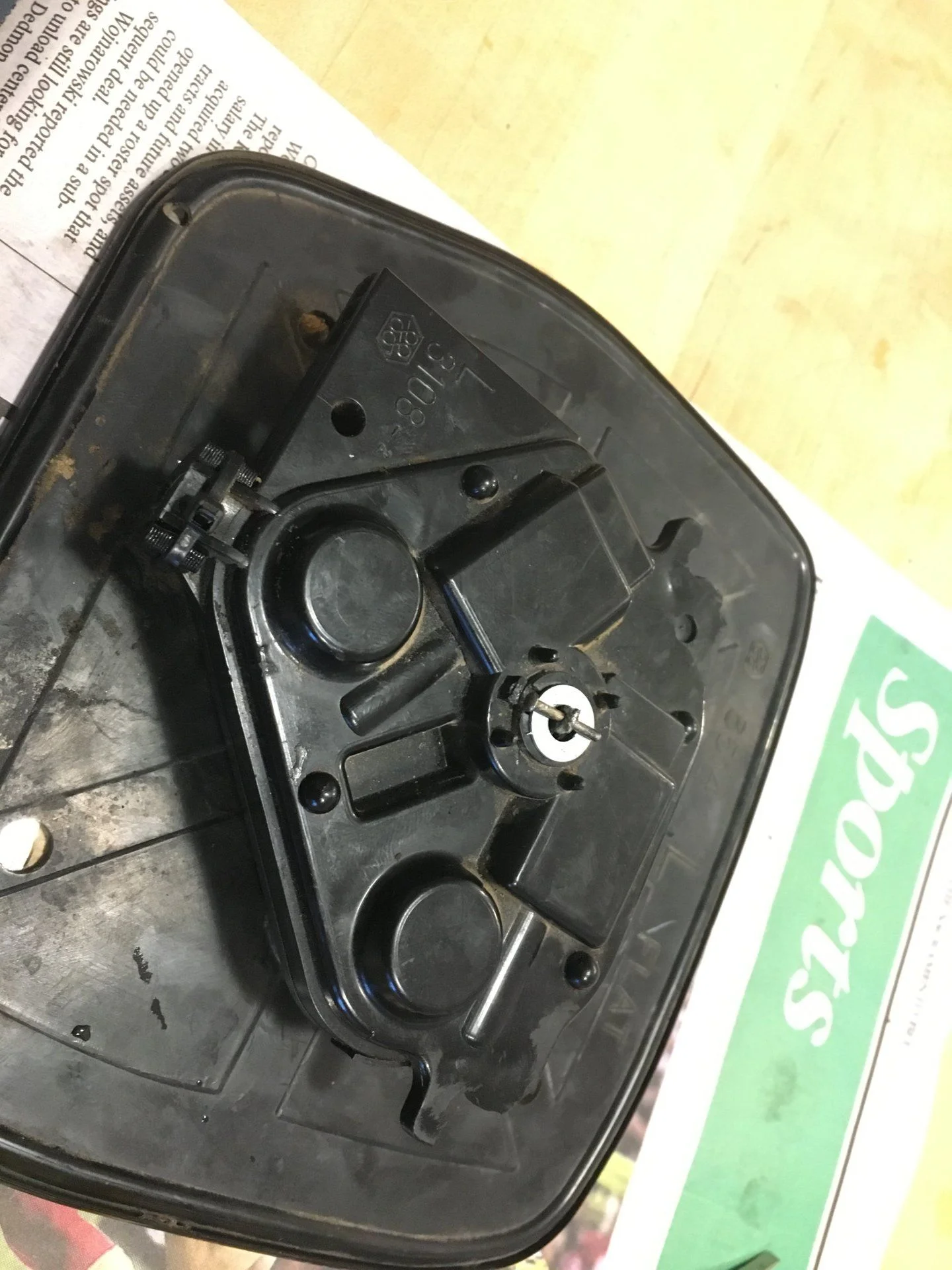

This didn’t work too well on my mirror (no dig on this solution whatsoever). I had done the zip-tie fix some years back, which worked OK for a while. After installing the bracket mine was still being a bit shaky...
I figured that maybe the connection to the mirror itself was a little weak, with the little tension spring thingie, so I added a washer here, to tighten up the connection. Everything works as it should , I need to drive it around a bit to see if there’s a difference. We’ll see.

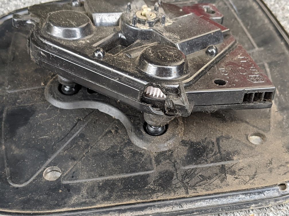

I took my passenger mirror off yesterday to get the shakey mirror brackets in place and found this:
I don't see how the post reinforcement gets installed. ;)
Fortunately I already had a replacement passenger side mirror assembly so just swapped them out. It turns out the screws that you sent replacements for work in the bottom post location. Both the original and the replacement assembly were missing the screws.
I got interrupted before doing the driver side, hopefully it'll go smoother when I do it today. I don't have a spare for it.

The bottom posts break often, as the unit is in tension when installed, so its either the top ears break or the bottom post..
The screws for the shakey mirror are the same I provide with the bottom post replacement, you can use this to fix the motor assembly you have.

All of the above in my case. One ear and the bottom post.
Is it usual for the gears to be visible when the bottom post breaks? I figured with them exposed like that it would be better to use a different assembly to start with since I had one. It if turns out my driver side is in the same condition I will end up getting the bracket replacement you have on Etsy and patching with something to keep it at least partly sealed from the elements.

One of mine broke pretty much like yours. No worries! It's still usable, IMHO. I trimmed off what wasn't necessary and epoxied the broke off piece back on, to cover and somewhat seal it. Continued with modification using the bottom post replacement, as @Outsane mentioned and it works like a charm.
