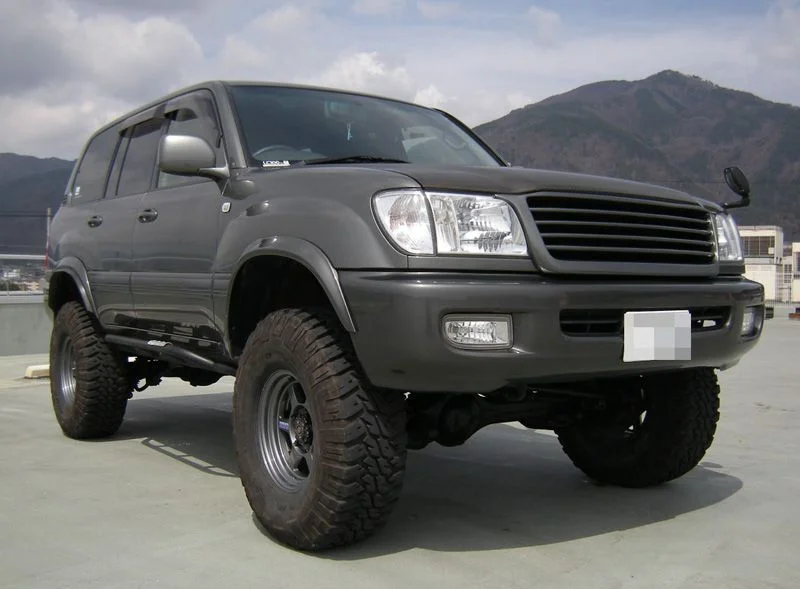

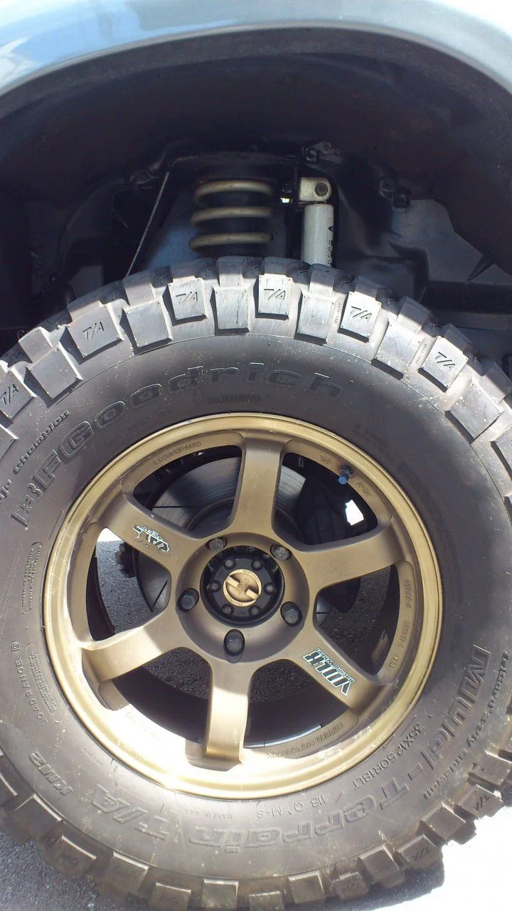

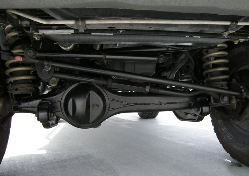

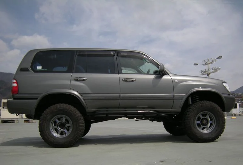

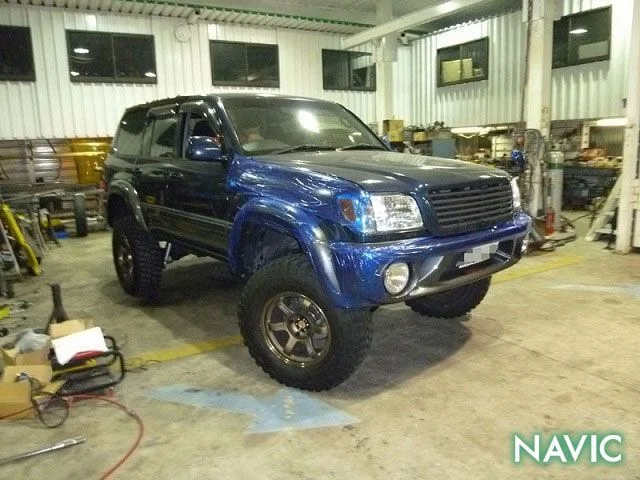

Eyed a few of these conversions available from Japan (15 year import restriction in Canada) with the HD-FTE, but RHD. Few pics below. Seemed like a common conversion using factory SERVICEABLE parts for owners who actually wheeled their 100's. Maybe easier with the FTE, dunno. Price was around 30k CAD with everything (6" suspension, 35's, exhaust, etc, etc). The grey one had 140,000 kms!
At the time I thought: that's why I have an 81 Series, and, when will I bash rocks with a 100 like that? Carbon fiber hood and all. I mean, c'mon who has that money? When a built 81 is half that?
