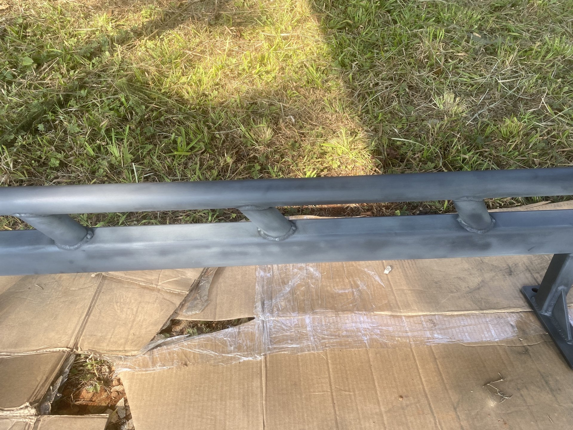

Hey y’all - really appreciate all the advice. I think it may be the paint and not the primer. The below picture is after taking a green scotch pad and going over the primed, painted, and dried slider.
the black paint came off like it was dust or dirt, but the primer is on there and only seems to come off with sand paper (like I’d expect).
is the best path forward doing a light sanding of the primer (400 grit or so), a wipe down, and then some of that 2k epoxy primer, then paint? Or would I be good to paint right over the primer layer since it looks like it’s adhering to the metal?
Wipe it down real good to make sure there is no dust left. You want it smooth to the touch. Rattle can primer is always dusty, and I rarely ever use it. The key to rattle can adhesion is how it's applied. And how long you allow it to cure. Here are my steps regardless of what color or what I'm painting.
-Prep it thoroughly. Sand, wipe, and repeat until it's the subsurface you want. Whatever you can feel you will see when painted.
-Degrease thoroughly. Since I don't use primer anymore this stage is done with brake clean. Wash it off, both sides and let it dry thoroughly! If you have to handle it put on fresh nitrile gloves. Those gloves will only last a few mins. So handle minimally. For primer you could use mineral spirits or denatured alcohol I think. But test to ensure it won't dissolve the primer.
-Once degreased and dry you are ready to paint. The first coats are very important to get it to adhere. Go in knowing you are probably going to spray it 4 to 5 times. The first coat is literally a dusting. You should barely see a color change. Wait 5-10 minutes and repeat, another wait and another light coat. By now (3 dustings) you are seeing some ok coverage and at this stage are ready to put on a wet coat.
-The wet coats are just barely wet. Spray it until you see the surface shine and move on. Don't overdo it. You don't want runs. Wat 5-10 again and another wet coat. You should have solid coverage now. Keep spraying until you have the coverage you want. Don't wait for more than about 20 mins between coats.
-Now the big one, once you stop you are done painting on it for a week. Unlike 2K paints, rattle can is an emulsion paint. It will flash and feel dry but there is still a lot of solvents in the paint. If you spray it again before they have cured you will end up with the original coats wrinkling up as the new paints solvents start to loosen the original coats.
This is the method I use when painting anything I want to look good. I've painted lots of stuff with rattle can and the finish is good and has decent chemical resistance. Once cured it's very durable. But any strong solvent could damage the finish. I have several sets of wheels I sprayed with silver aluminum color and they still look great years later. Engine bays with satin black, valve covers, motorcycle frames, etc.
Remember, the base coats are what allow the paint to adhere. Less is more.
Damn, thank you! Bookmarked this post. Really appreciate your detailed instructions and insights. I seriously underestimated my prep and apparently rushed a lot of the painting process. The knowledge on this site never ceases to impress.
appreciate you taking the time to write all this up. Looks like I’ve got my work cut out for me to get these painted right.
