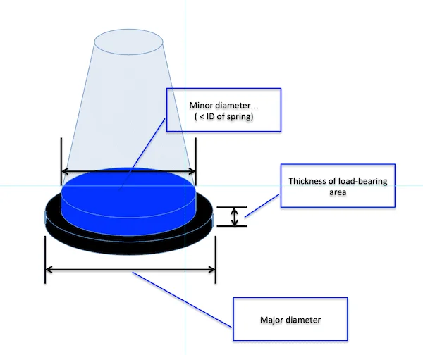

As I do not have a shock isolator to measure, I'm asking anyone here who might have one laying around who can make three quick measurements if I could impose on you to do so. If someone could measure these things for me, I would appreciate it:
Since I have a bunch of delrin in my stock pile, I'm considering turning the isolators out of that, though I won't be adding the pyramidal section... it appears hollow and unstructural on the web, and with little or no function, so I'll just do a 2-step ring. Anyone have any thoughts on the suitability of delrin? It's self-lubricating and tough and seems like a decent candidate for an isolator. If I get the time, I'll also fab something out of rubber too... I'll need to get some dry ice Monday to freeze/harden the rubber to turn on the lathe. Or cast them out of flexseal?? LOL
- The outer diameter of the isolator end (top)
- The thickness of the load-bearing section of the isolator
- The inner diameter of the "boss" that entraps the spring ID
