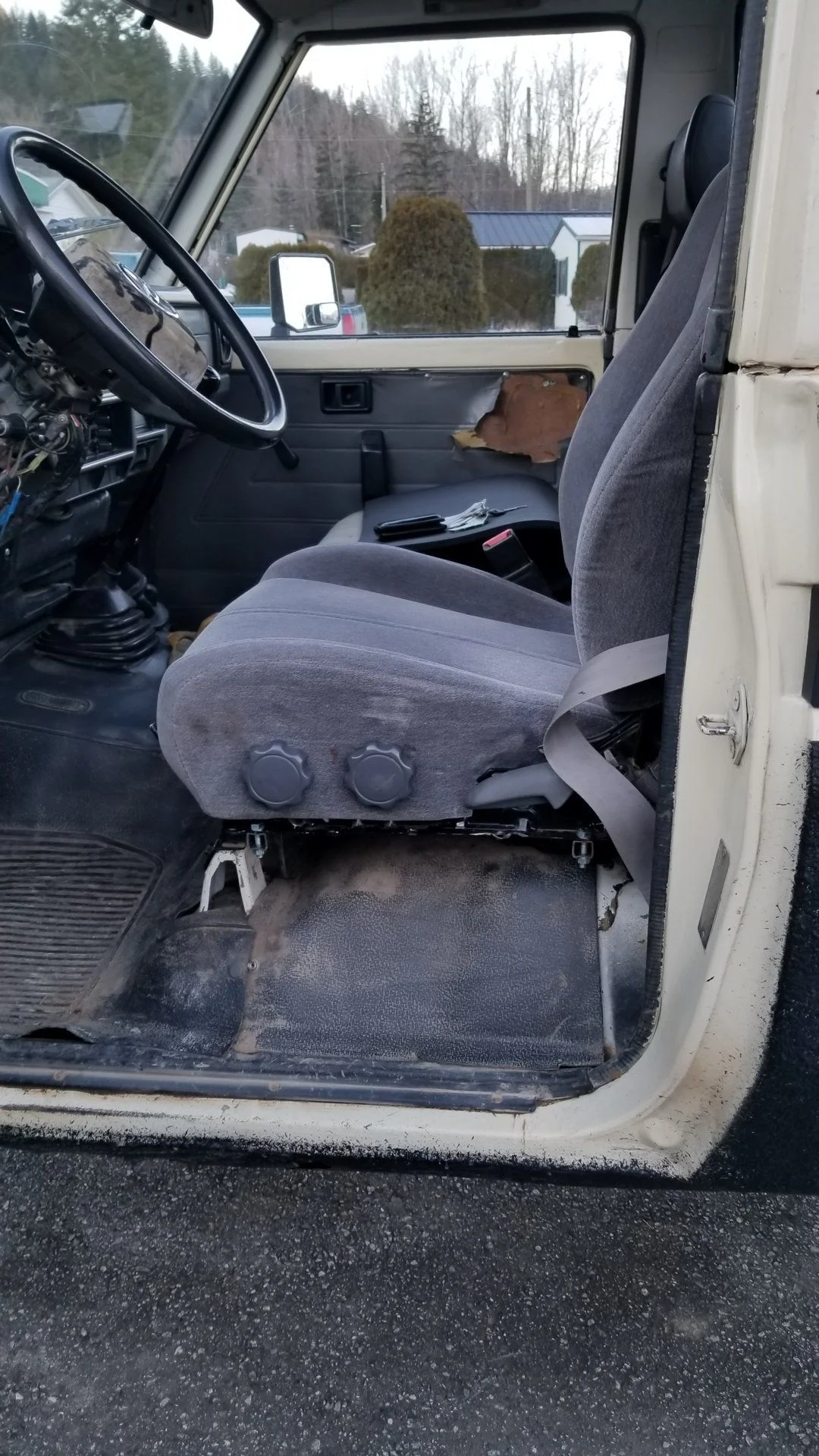

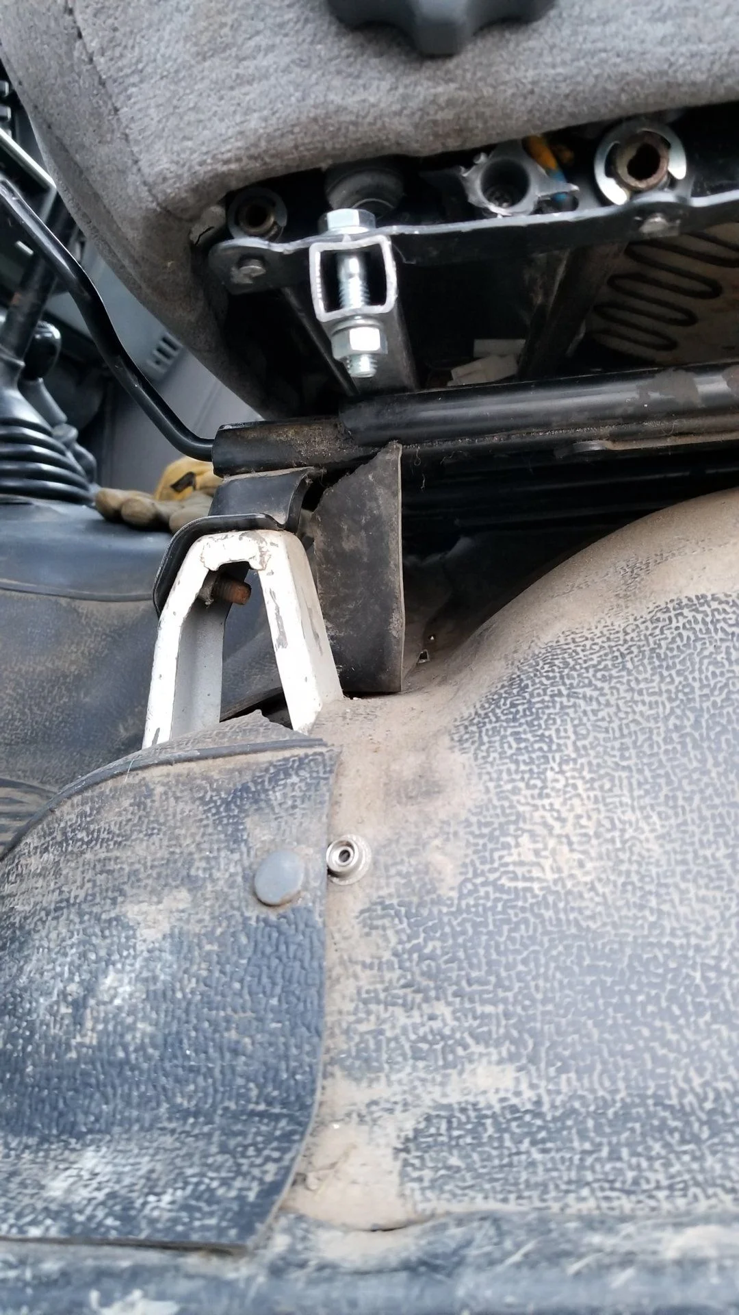

I ended up with a set of manual adjusting Camry seats that were recommended above. $50 for the pair. I have already fitted the driver's seat and I'm very happy so far!
Pictures?
Looking good!
