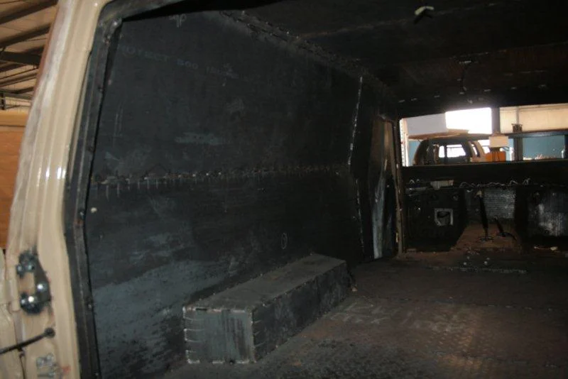

Not sure if this will help or not - but I have armored a number of TLC 76/78 over the last couple years. I for one can assure you that I end up covering the vents (with ballistic steel). I have had no issues with "air compression" issues.
I am over in Iraq all the time checking on them where these trucks now have 2+ yrs on them and 60K+ miles.
