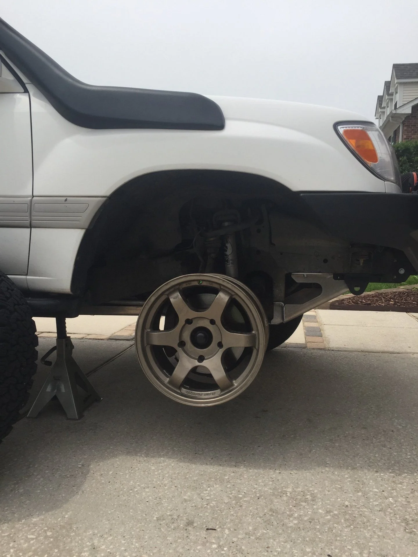

Do not buy wheels from SCS! They are a scam on the way they fit.
There are several different shapes and sizes of scs wheels. Are you sure you bought the correct size? I know vin well he is a solid guy and super helpful for our Toyota crew...

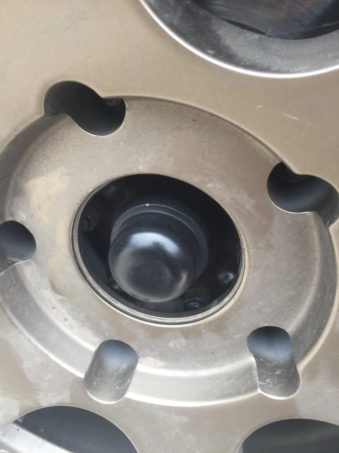

To my knowledge, only the F5 from scs fits the 100 series. All others will not clear the hub flange nuts. I will say several fn wheels will fit the 100 series hub flange.

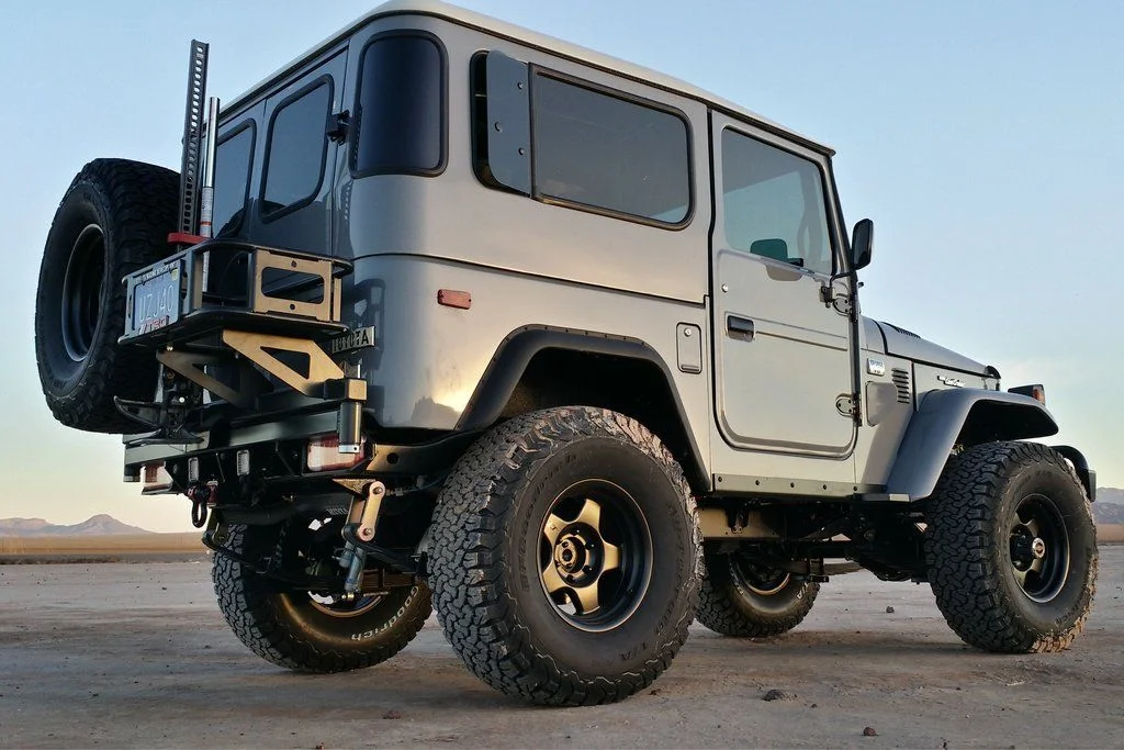

2 - FJ40 with scs f5’s these are the 16” wheel with 3.5” backspacing- i just bought them for my truck too.

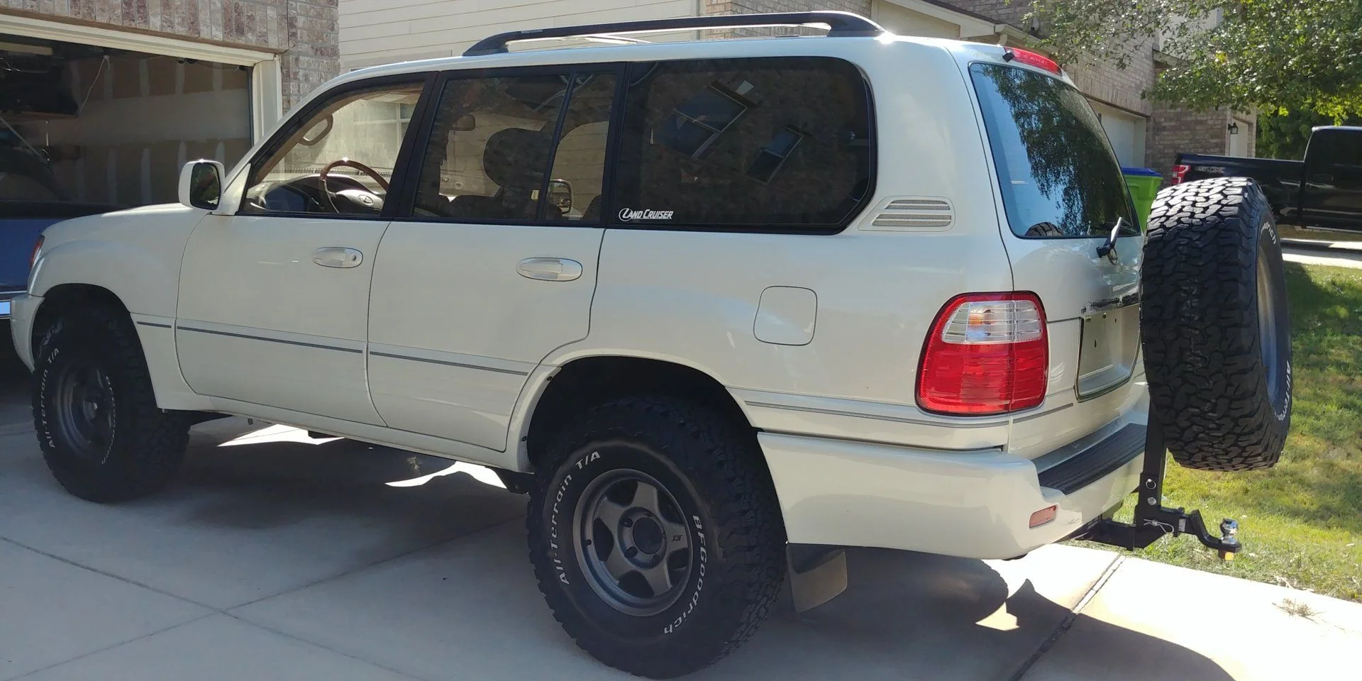

I picked up a set a few months ago ...
They fit :meh: ( 98 LX )
