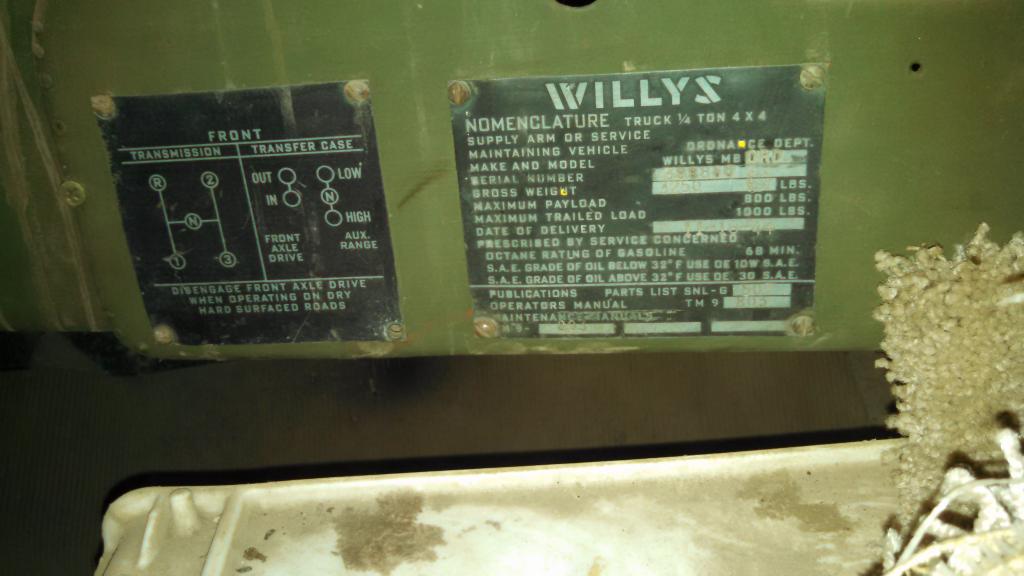

An update on this: Stareing at semi built flat fenders and in my endless quest to drive my wife further into insanity has caused this project to be resurrected. I went over to where the heep was stored with my FSM in hand determined to make a parts list that i need to get this running. So me and my buddy were standing around staring at it comparing the engine to diagrams like some dumbasses when his 75yr old neighbor who used to own one of these wanderd into the barn and was asking about the jeep. "you fellas need to get that started" and the proceeded to talk old man s*** to us for the next 4 hrs while we asked stupid questions like "what are points and where does the laptop plug in. Condenser?!?! its a WW2 military jeep there's no AC..." Needless to say we got the 60yr old flat-head to fire up on a concoction of ether and watery 8yr old gas we found in a can in the barn. Only 40 dollers in parts from NAPA and it was running... We tried to get video but the starter seized up which is apparently normal for these. So we know the oil pump works since it spewed oil out of one of the disconnected oil filter lines, it actually runs pretty good with very little smoke, the jeep is already wired up for 12 volt (SWEET) and 90% of the parts are there to get it driveable with all the stock parts. The plan is to get it road worthy and registered and go from there. I decided F it, I'm fighting the man at the DMV and plowing through red tape and see what happens when i go to get plates for it.

I think a set of 40axles with some 34X9.5 Swampers would look quite nice under this.....
That is just stupid cool....love it
Is that in Ron's shop?
So is it all original? Restored to original or did someone just make it look like an army jeep?
Either way it is cool !
Yup for the past 12yrs when we brought it home from mn.
The frame, axles and most the body are original from 1944, they did some bone head s*** like skin the tub with newish panels and cut a tailgate in the back as there is not supposed to be one. The engine, trans and tcase is from a cj2 which is a slight upgrade from the army jeep parts. It supposedly had a v8 at some point in its life so the firewalls all hacked up. The paint is brushed on and I looks like it used to be a hideous gold flake color. Not a resto worthy heep which is why i would not mind putting some yota parts in it and wheeling it.
Nice, it sure looked like it in the pics.
What gave it away, the piles of scrap metal, the overloaded mezzanine full of old semi parts, or the random gas powered stuff surrounding it in the pics?
