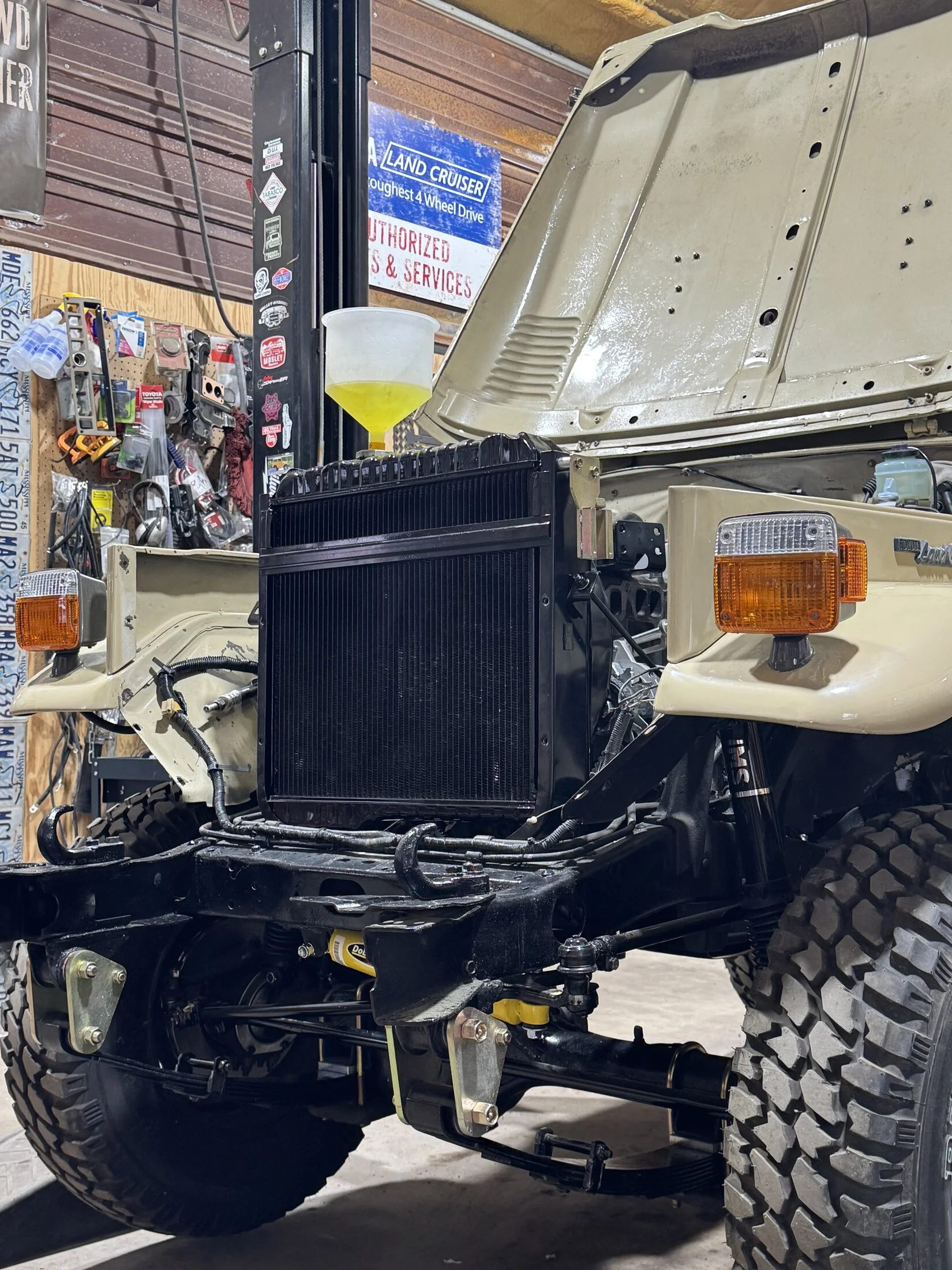

I prefer to use distilled water for a few days heat/cool cycles because its cheap as in a couple of bucks. It also helps leach mineral deposits out of the system when you dump it to put in coolant.
Never done that. Time is money too

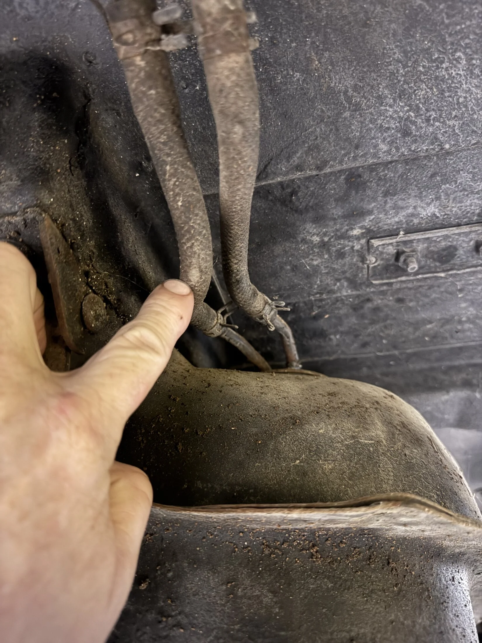

Aight. No leaks. Now I'm starting to put things back in place. Before the tear down I had not done anything as far as setting up the fuel system. I added 10 gallons of no corn to the tank and blew some air in to figure out which hose was the pickup. Hint...if you get bubbles it's the pickup.
The hose to the inside is it.

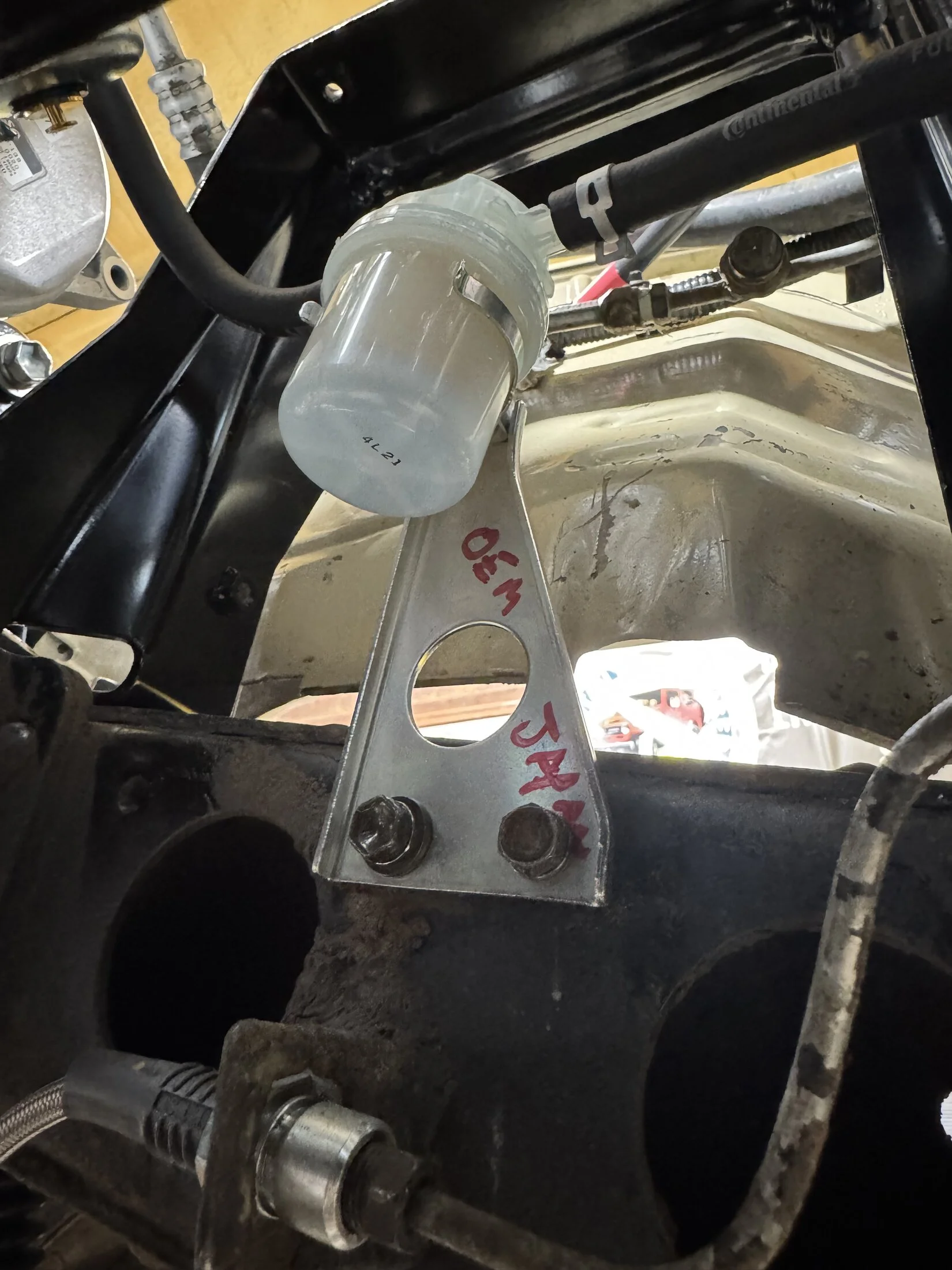

Got this trick bracket from Toyota Matt for the OEM filter

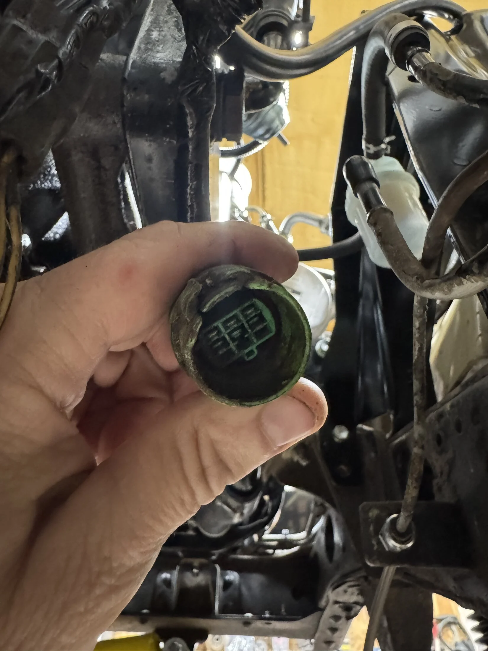

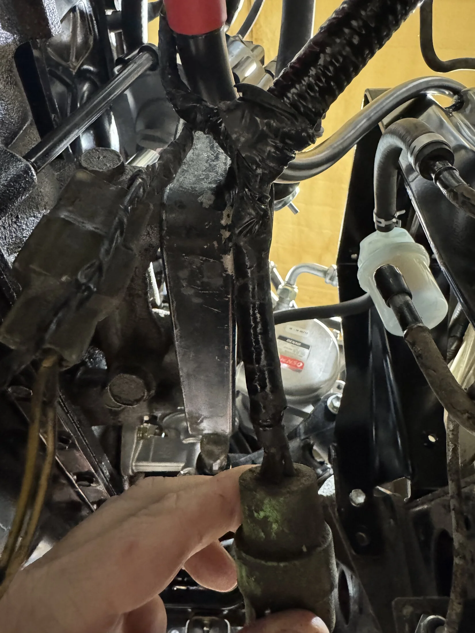

I hooked up the starter wire and discovered this big green plug woven into the harness way down by the starter. This thing does not show up on the wiring diagram. This kinda creeps me out for what I have in store. I've been ignoring the weird wires until now
I think that green plug puts your phone on DO NOT DISTURB, for when you got hoes in the rig.
I may need a better explanation....

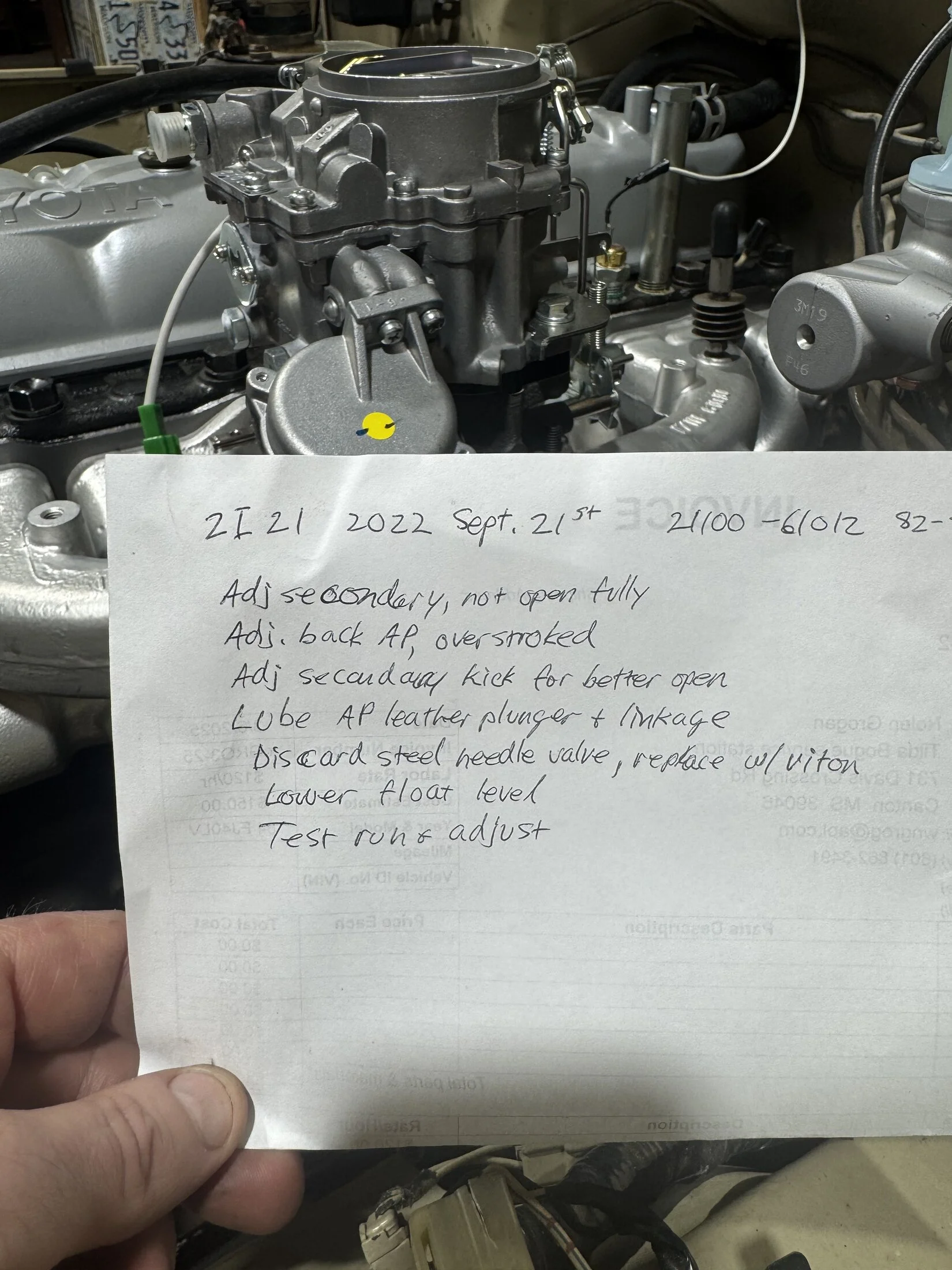

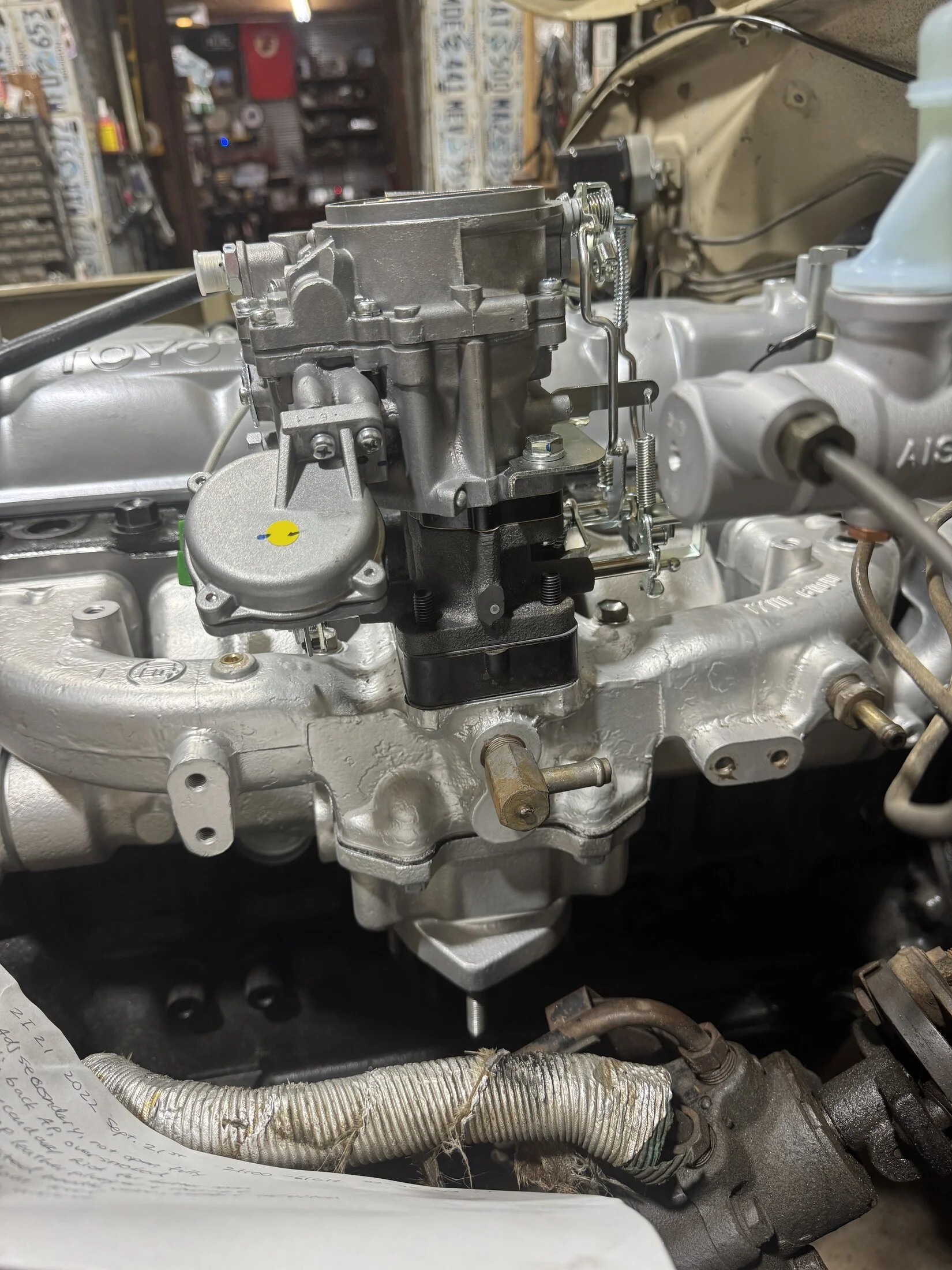

While we had this down time with me off in Arizona for 2 weeks I took the opportunity to send this New In Box Asian 21100-61012 carburetor off to the man that was born on December 25th with the initials JC
Looks like he did quite a bit to it looking at his notes and of course he ran it on his stand. That's a big relief to me.

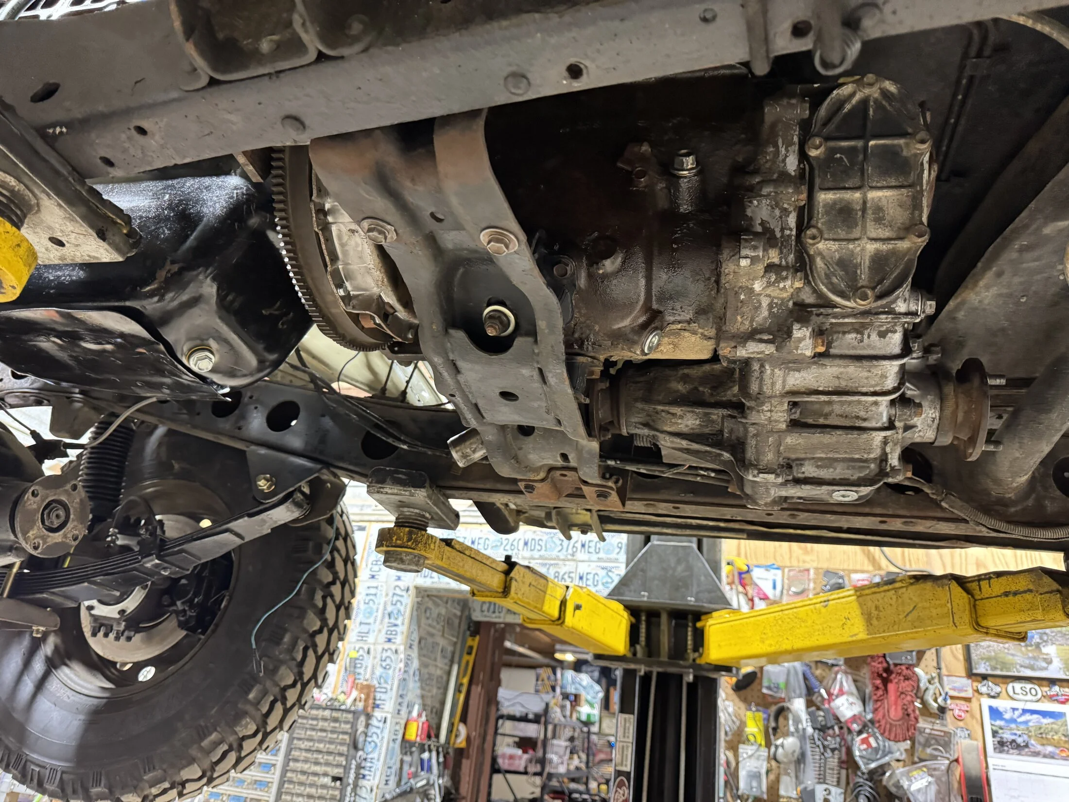

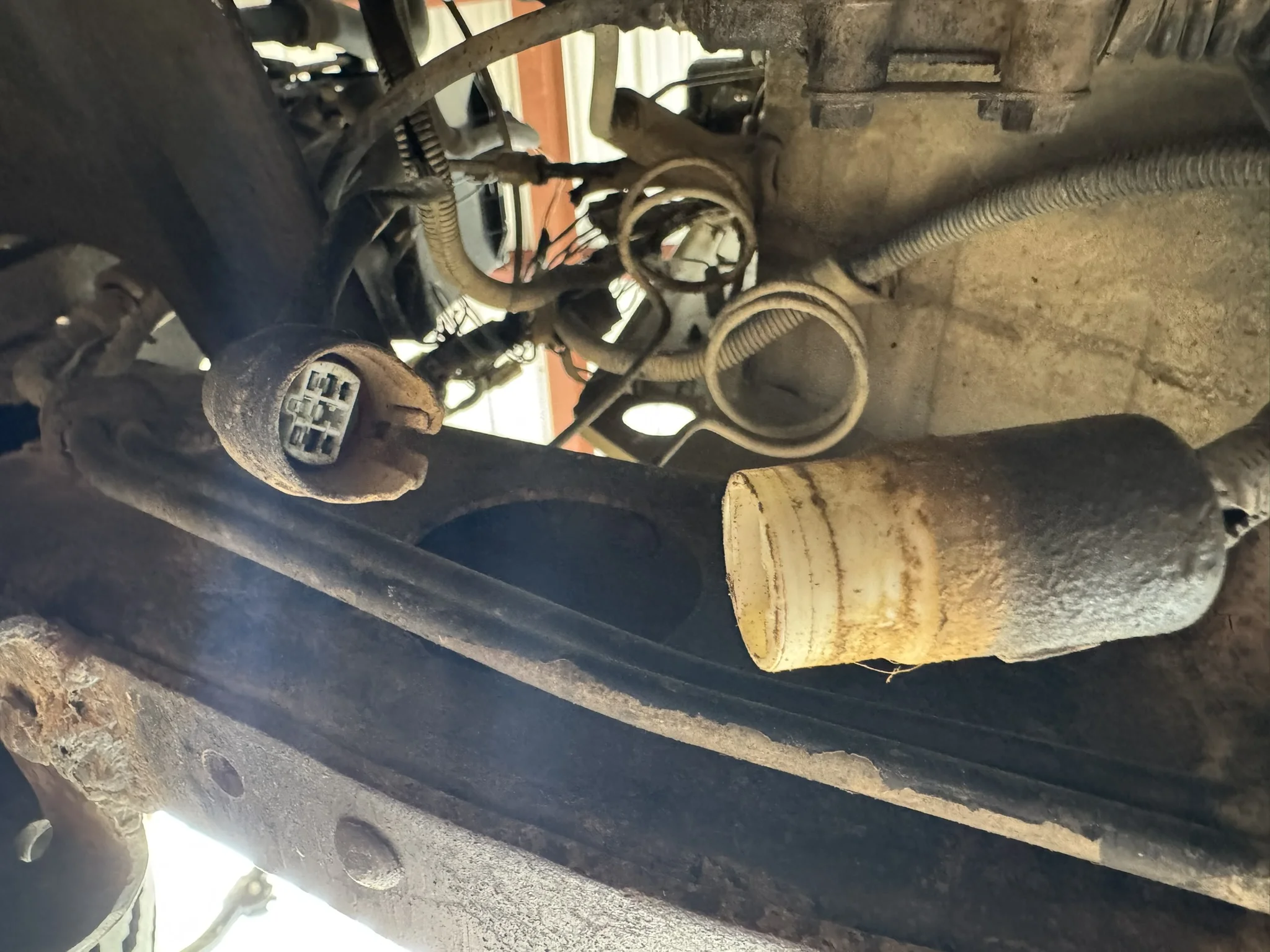

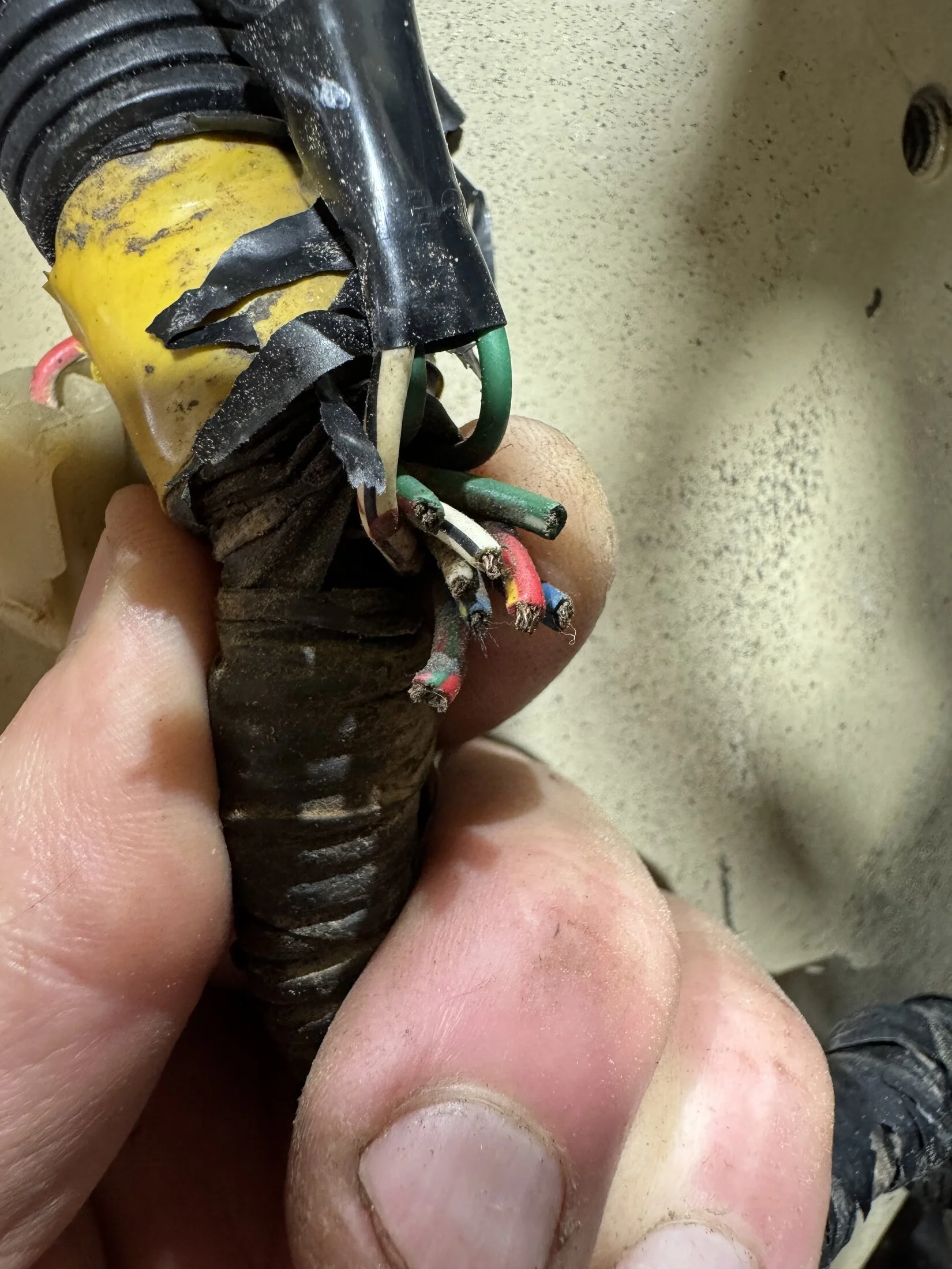

I hooked up the starter wire and discovered this big green plug woven into the harness way down by the starter. This thing does not show up on the wiring diagram. This kinda creeps me out for what I have in store. I've been ignoring the weird wires until nowView attachment 3871794
Not green but this looks like the same connector on my '83 Troopy. It's maybe just behind the starter but over near the frame rail. I unplugged the connection to take the photo. As far as I can tell, two of the wires go to the transfer case and two go to the transmission. Not sure about the other two although there is a small two wire connector that isn't connected to anything along the frame rail that could be the other two wires.
Educated guess that the two to the transmission are for the reverse lights and the two for the transfer are for the 4WD indicator light.
I didn't use a meter or dig overly deep so take my assumptions with a grain of salt.
Just looked. I think that portion of the harness is a goner. Both the plugs on the trans and transfer wires are snipped off

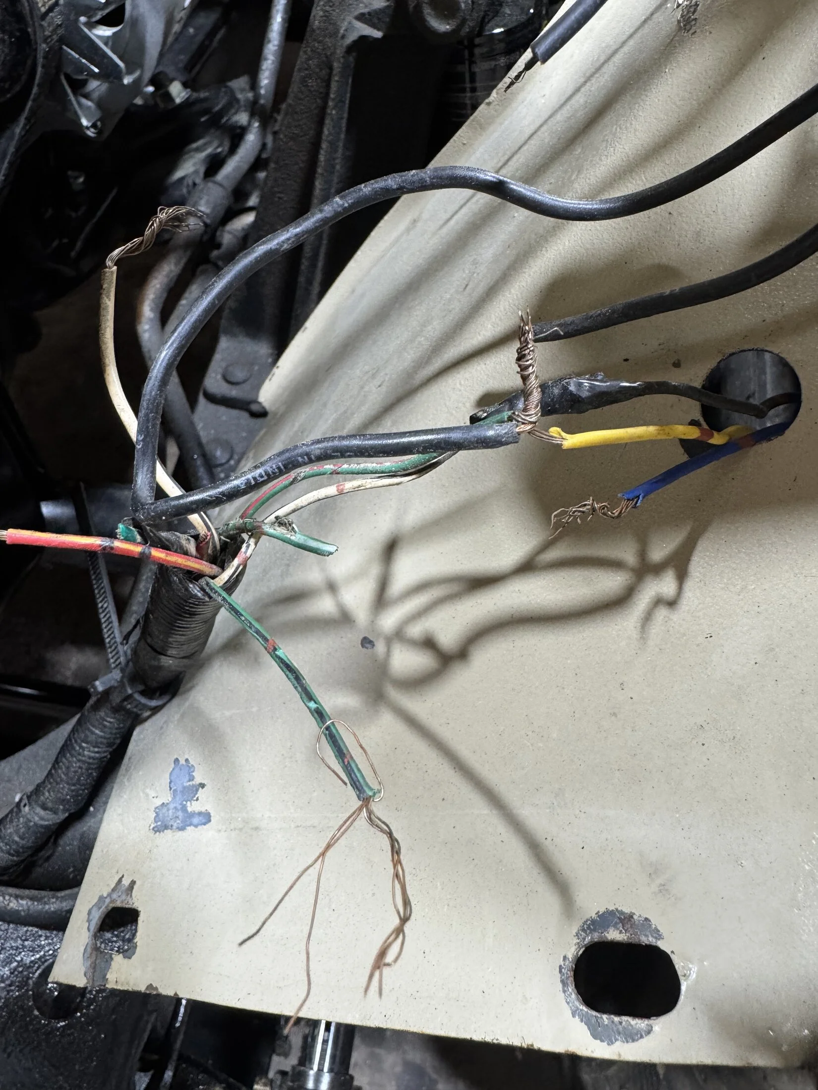

Been trying to fire this thing off.
Got fuel.
Got spark.

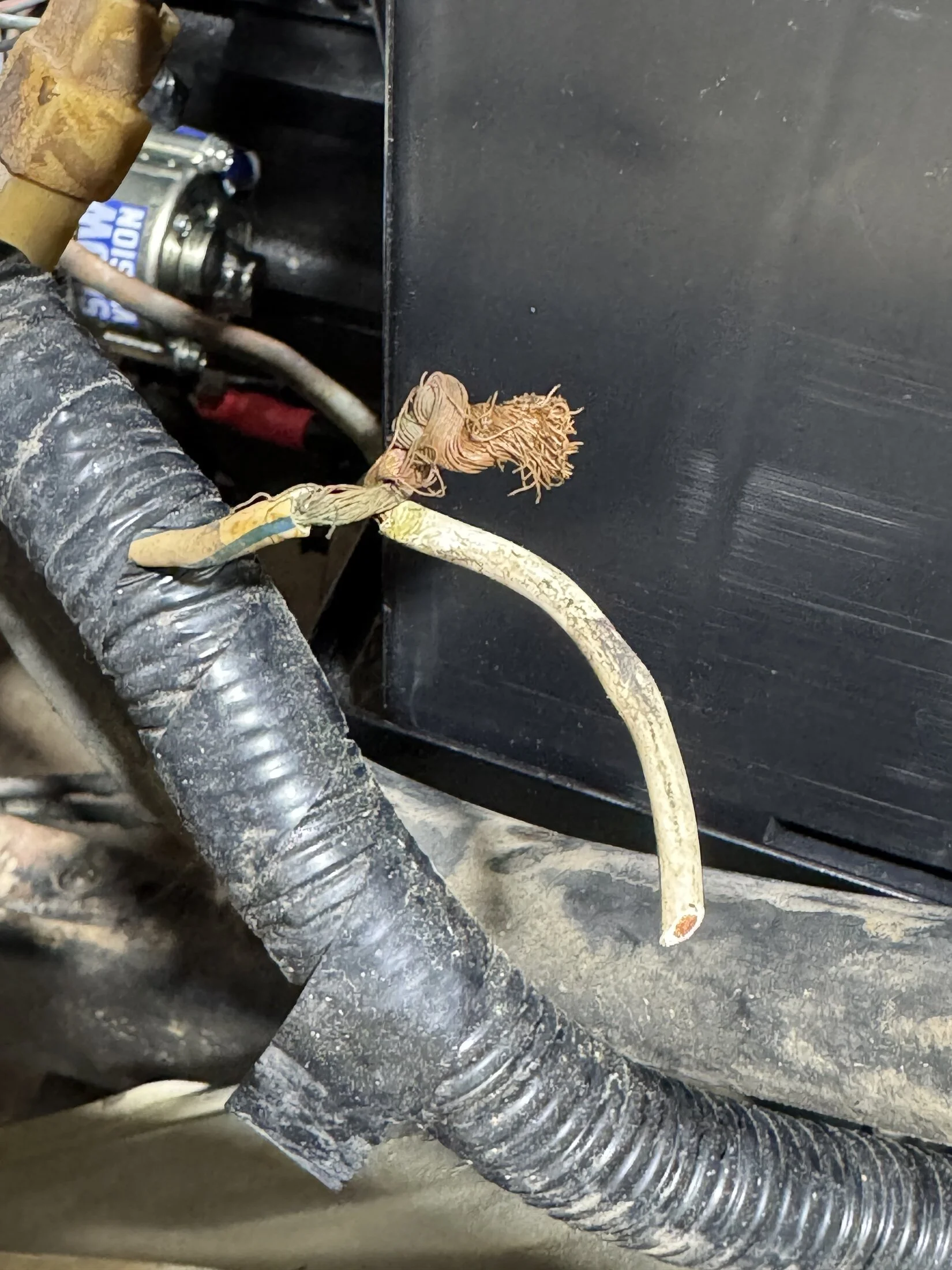

The ENGINE fuse has a hard short somewhere. I'm popping that fuse on every cycle.
The problem with these things is the question of why they were done in the first place?
I'm trying to find that short and keep finding stuff I was hoping not to find.
sheeeut!!! Sorry man… hate tracking down electrical issues
So here's proof the distributor is doing its job.
I have the DUI wired into the large Black/Yellow that was power for the coil.
I have it tapped as well for the switched 12v for the carburator since I can't find the stock wire.
Amazingly the main coil wire is hot without the "engine" fuse in the truck.
Looking at the wiring diagram this should not be the case.
