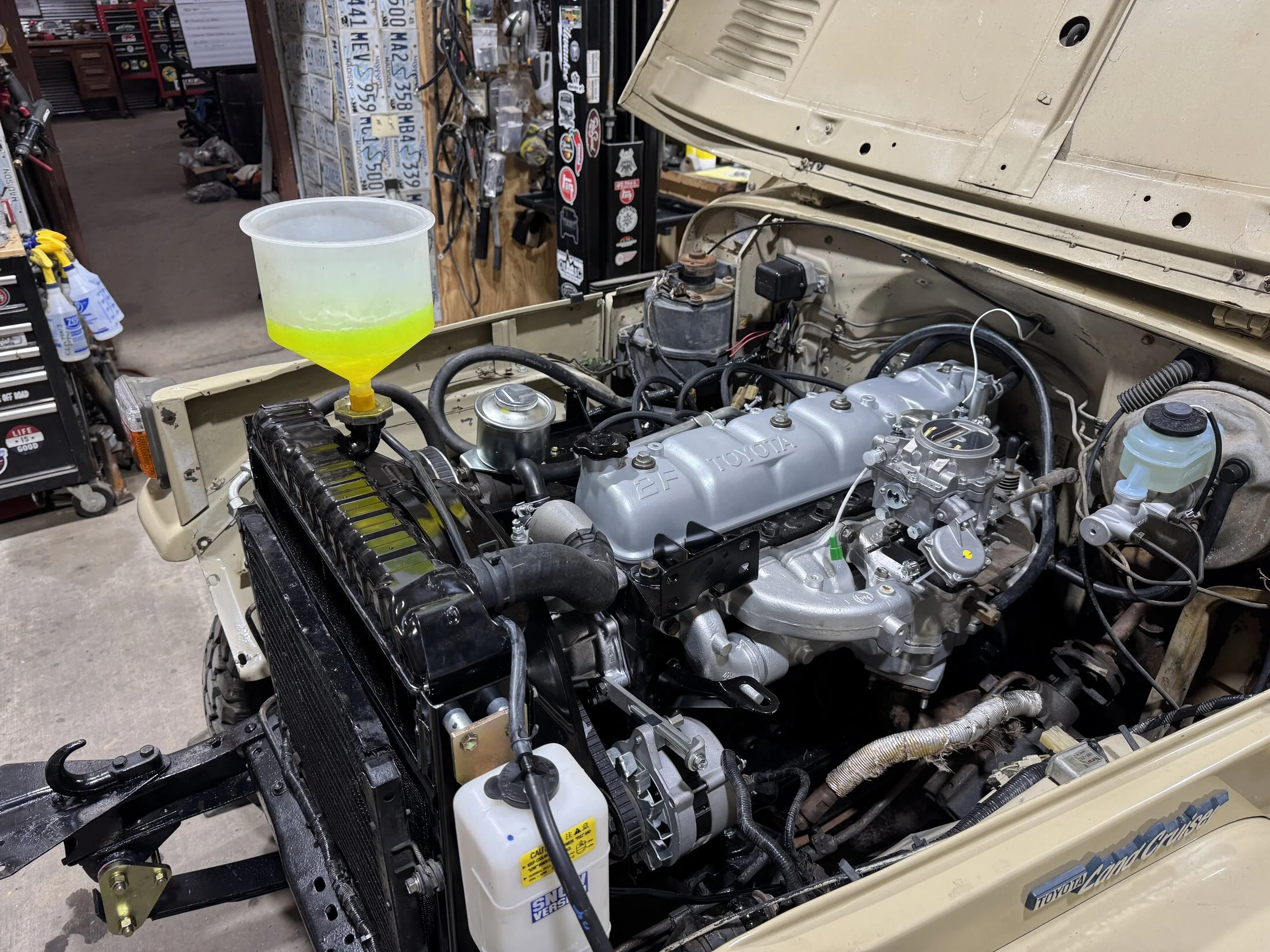

I dragged this thing out to drain the gas tank. Turns out it was already empty.

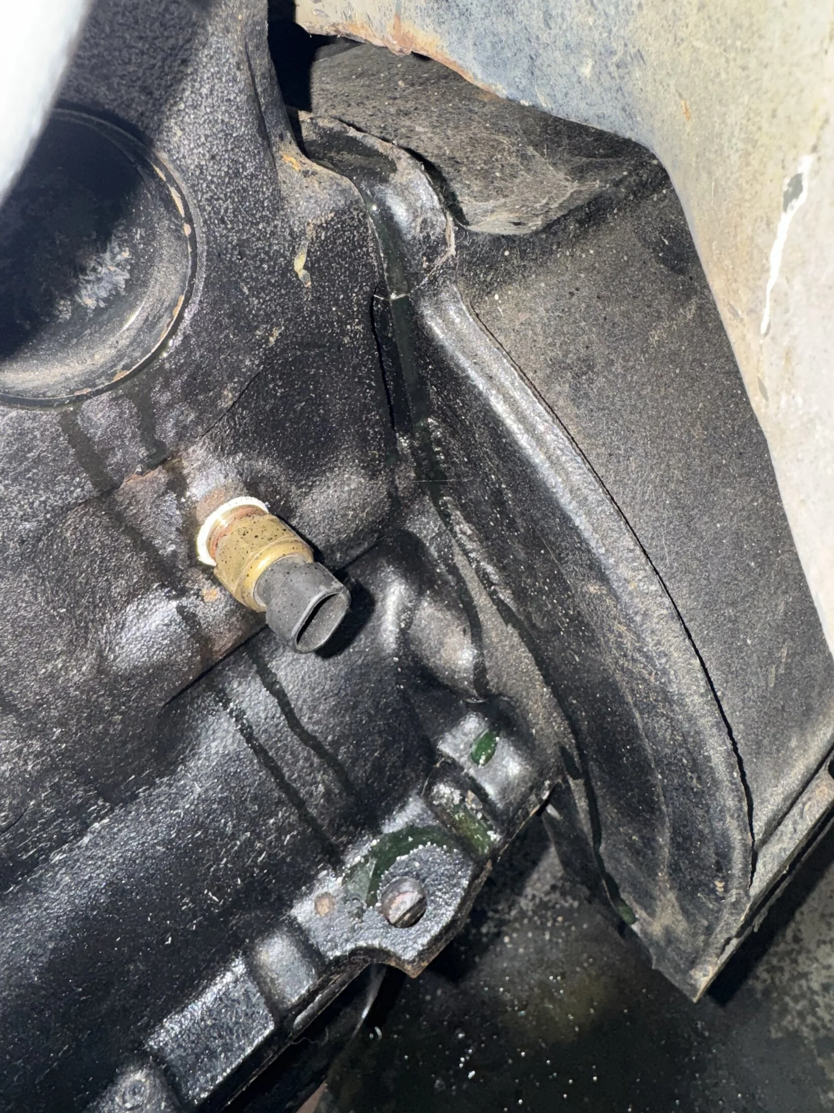

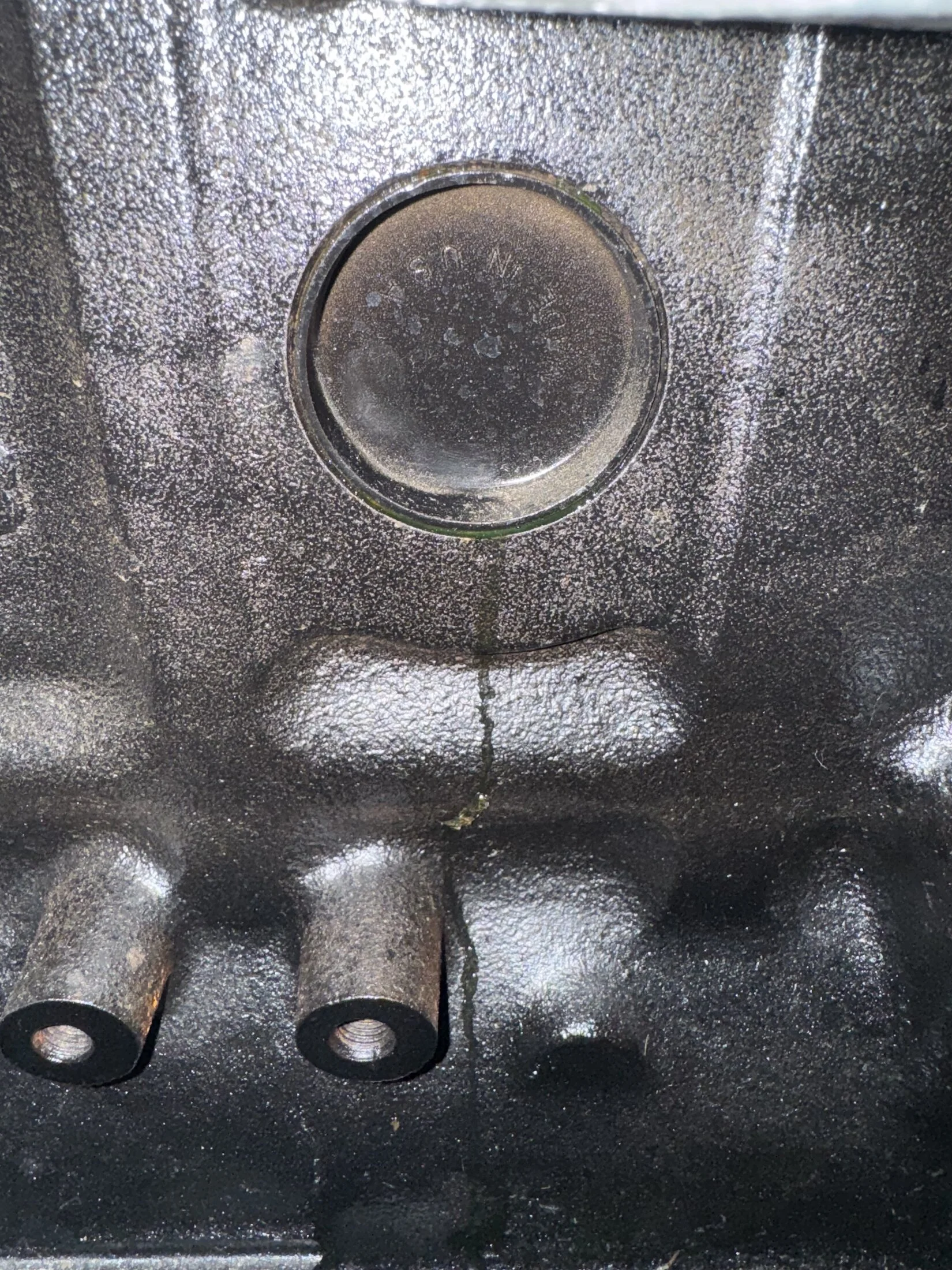

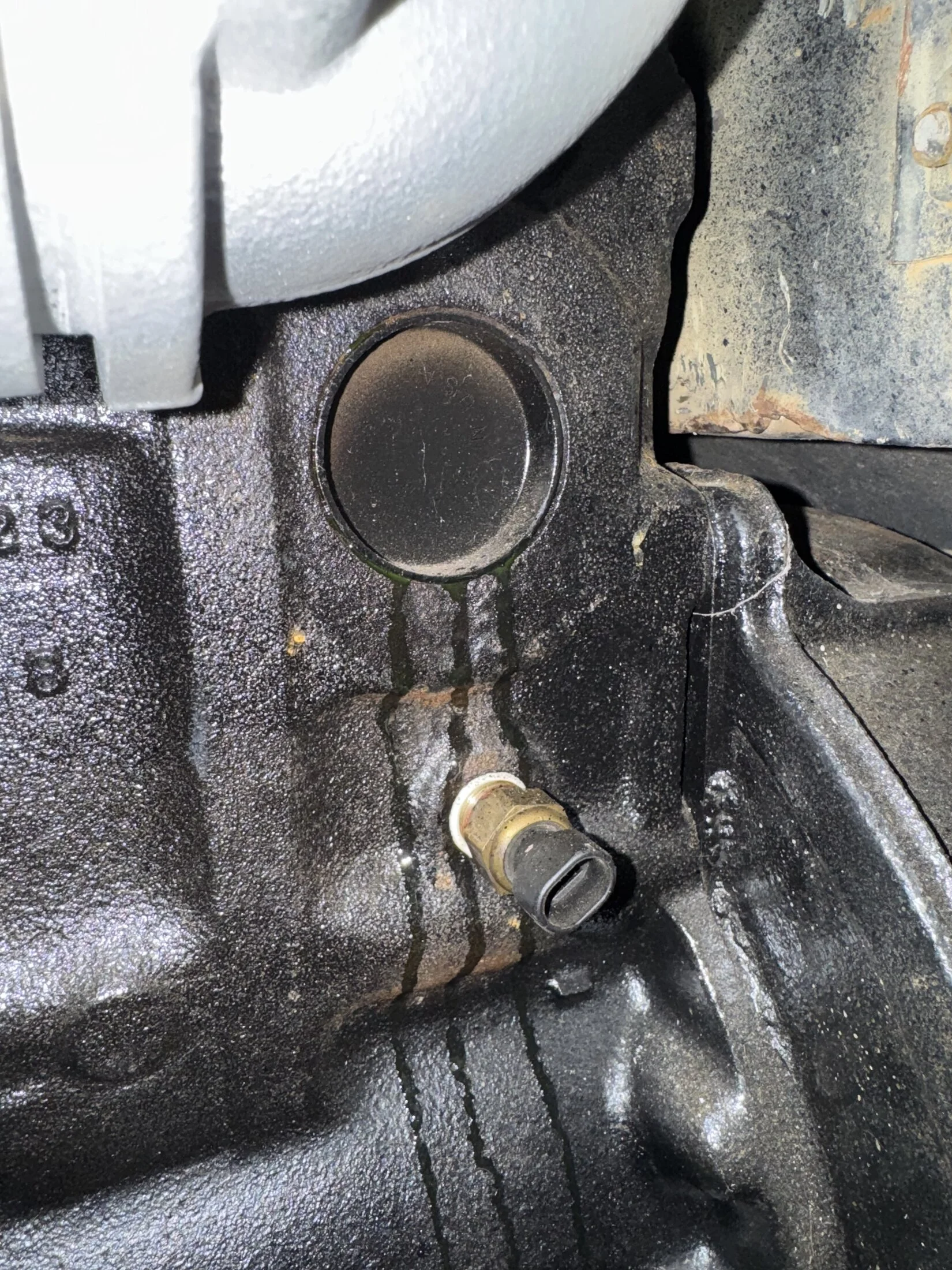

Well s***. I added fluid and all 4 drivers side freeze plugs are leaking.
New motor build by a local shop. LS type guys. Made in USA stamped on them.
I'm going to try to smack them in the center and see if they stop. (Edit, that did not work)
Open to ideas here.

The one above the bellhousing is leaking too. Any chance of repairing in the truck went out the window.

I'm going to bet they put standard plugs in. They are just a hair smaller than metric.
I'll reapply the metric ones and use FIGP.
