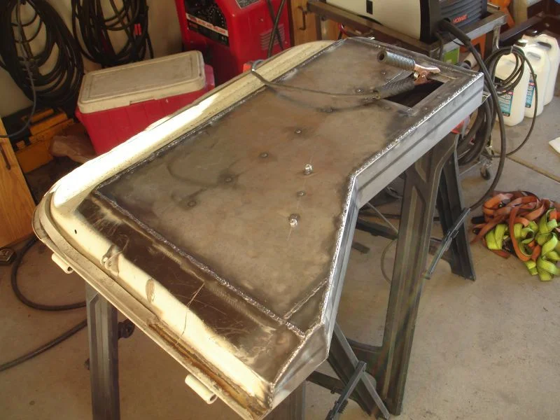

For those interested...1x3 in square tube fits PERFECTLY for the cap of the upper door chop. Give a more finished look, and the shape allows for straighter and more level lines. I cut it in half with the plasma.
Keith

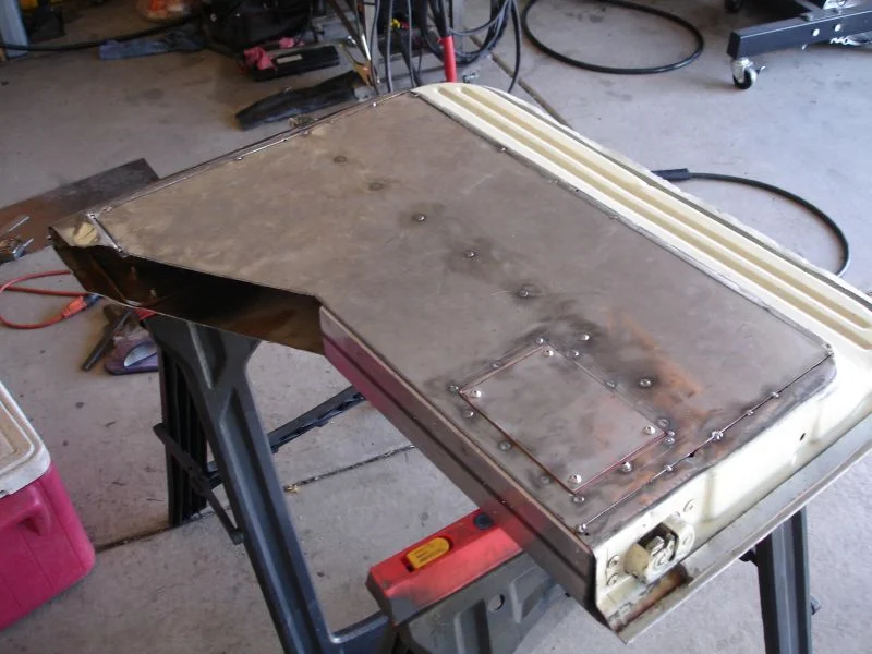

Fgured out how I wanted to run the handles, made a bracket, got the bolts, welded in stay nuts...will weld em in tonight.
Then the capping process starts. That actually should be pretty easy.

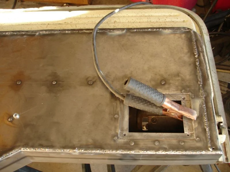

Door handle is welded in, and got the cap pieces cut to fit in the top of the door. HOWEVER, Im gonna have to do some fancy fitment work at the very TOP of the slope at the leading edge of the door. The way that the door is shaped, the nice straight caps wont work, soooo....Must consider how to make it jive. Had to excise some extra steel from there off one side at least.

caps are in and the PAINFUL spot welding process has begun!
Got one little section toward the back of the door to figure out the best way to run, but the hard stuff is done. Now its just HOURS of THOUSANDS of spot welds and grinding.

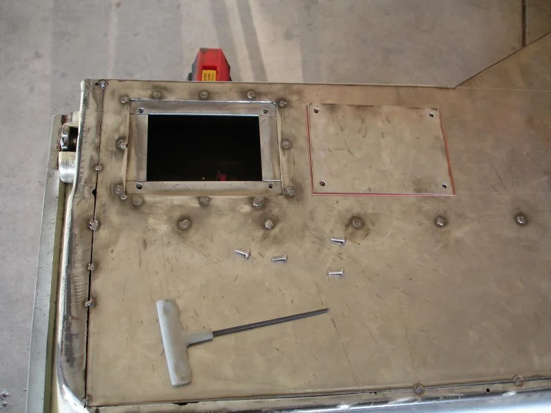

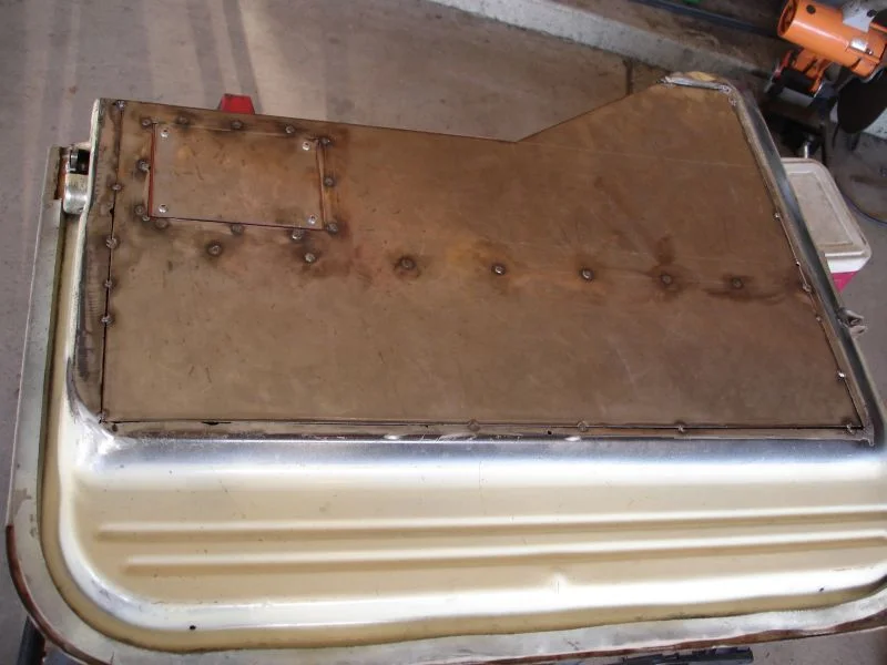

The BIG side is almost welded in...
Here are some pics. The two bolts you all see are where the door handle goes. Just gotta seal in the OUTSIDE of the cap, and finish up the fore and aft ends, then Ill start grinding.
Mark...BY NO MEANS do I want you to feel bad! Im just NOT a big fan of sheet metal work...Primarily because its not something that Im inherently good at. Im honored to do this for you, and grateful that you thought highly enough of my craft to allow me to do it. I just HATE welding the sheet metal. That is the only reason that I bitch.
