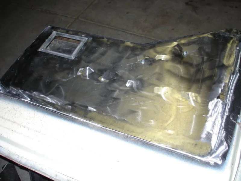

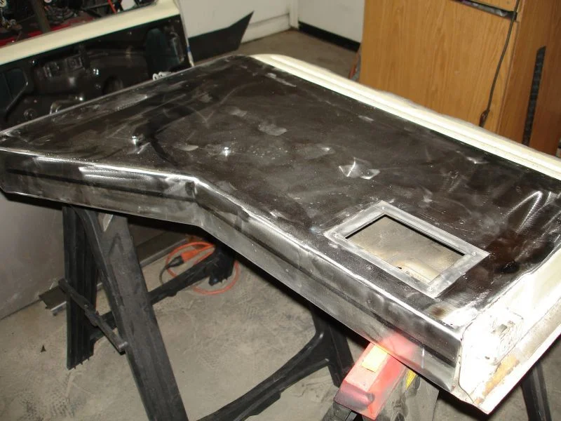

Few pics of the finish...
It was much easier than I was bracing myself for. That 1x3 cap made a HUGE difference in how the welds came out. There was more backing to weld to that way, and thus virtually no burn through. PLUS, it made for a nice rounded/ beveled finish which was what I was after.
There are still those low spots where the weld bead is/ was. That is the stuff that the body work guy is gonna have to fill with some bondo to make it a really nice finished product.
You just cant work that too much with the grinder, or youll screw yourself.
