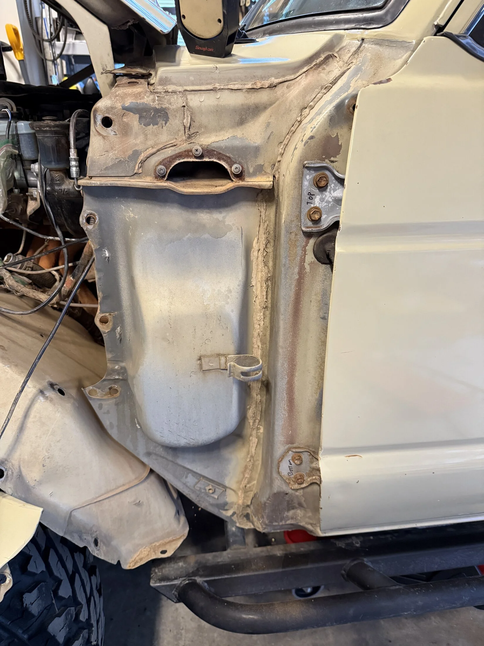

Did you have the fenders off? The factory seam sealer is notoriously bad/missing at the cowl seam behind the fenders. It tends to leak through there. It's easy enough to clean up and re-seal once the fenders are off.
I didn’t have the fenders off yet but plan to take them off when I’m looking into this. Thanks for the info. Will report back when I get around to it tackling this.

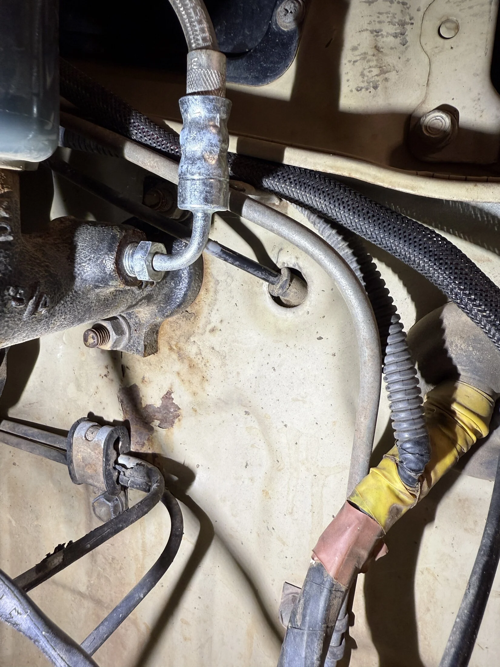

Started looking into the water leak on the driver floorboard. Tracing the water it seems to be coming down the firewall but also down the door side of the footwell. Much worse when washing the truck vs. just being in the rain. I found 2 culprits. First was a dislodged grommet on the firewall which I simply reinstalled correctly. Second was the seam sealer behind the fender and on the cowl was a mess. I bought some 3M epoxy and some wide tips for the cartridge to lay down a nicer seam. Now I'm just waiting on the epoxy cartridge gun to arrive so I can get this fixed. Meanwhile I removed all of the old seam sealer which I'll re-do and then see if the leak persists.

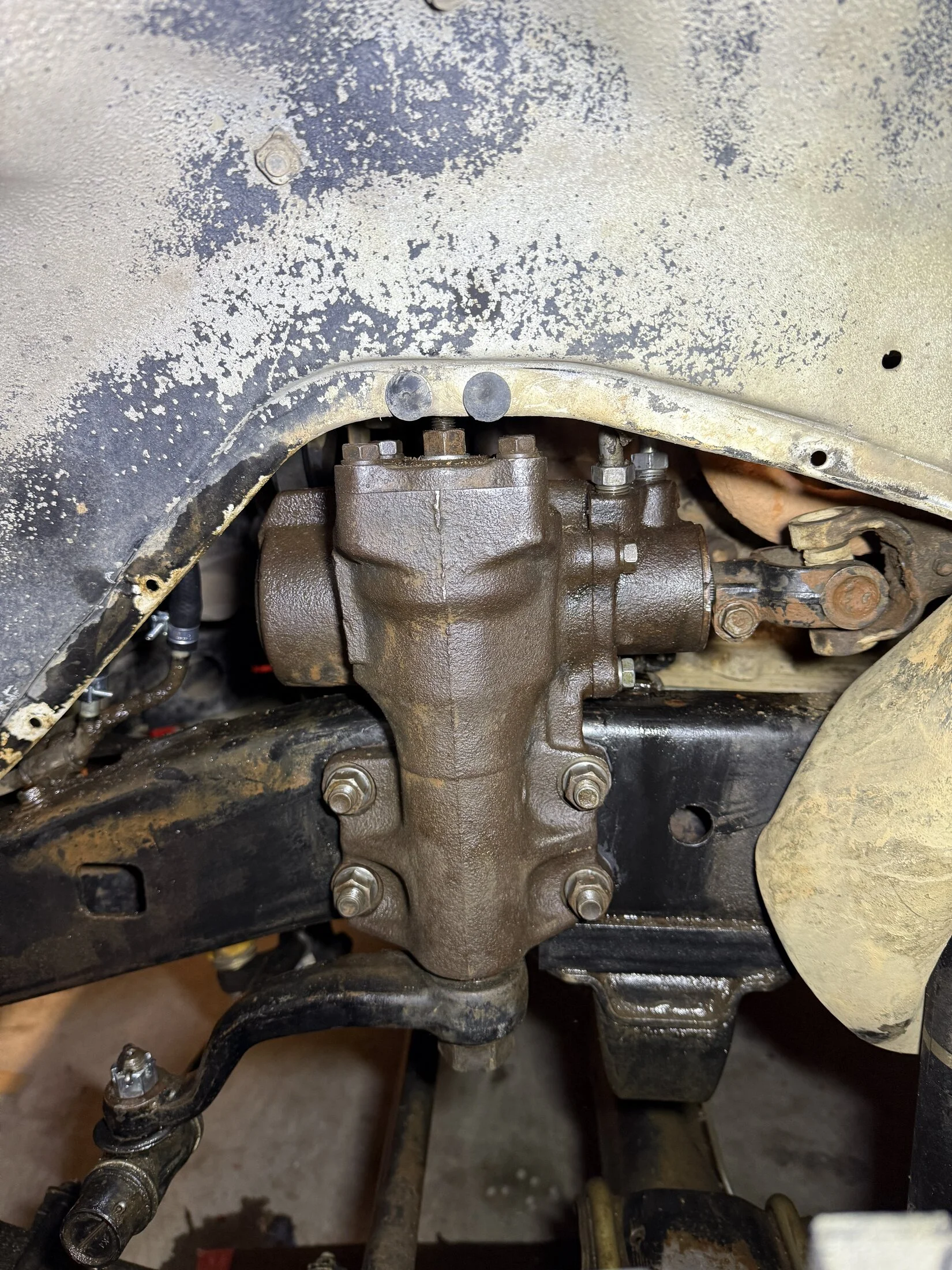

One of the items that reared its head during my Colorado trip was the steering box. This was a box that @Rockymtnreaper sent me off of chop top after my RockAuto seal kit didn't have what I needed to fix my stock steering box and I didn't have time to redo it before leaving for CO. After the trip, this new box was leaking worse than mine so both needed to be rebuilt.

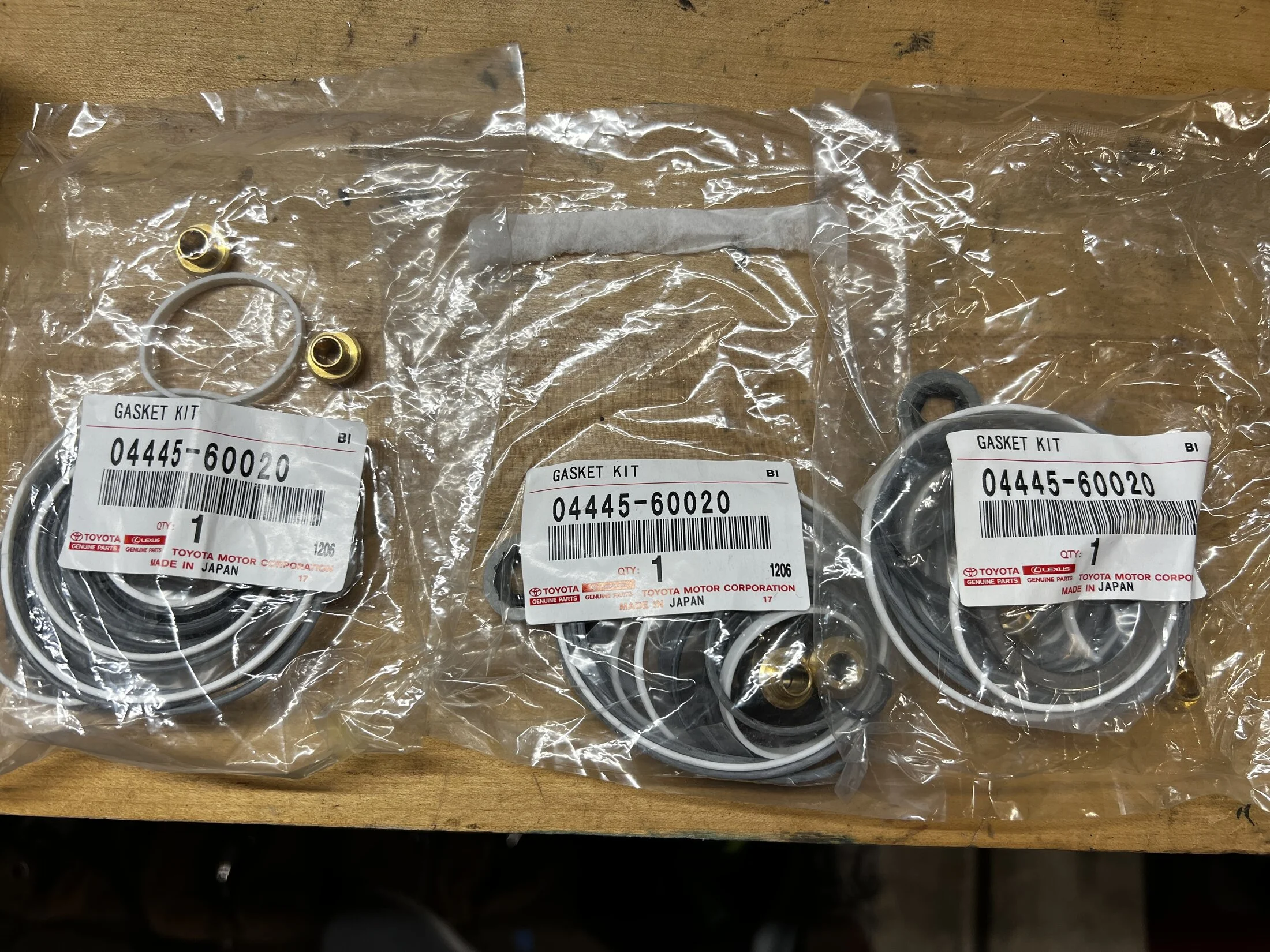

I spent yesterday rebuilding one of them. The OEM Toyota seal kit is SO MUCH BETTER than the other one I tried. The tolerances on the teflon seals were spot on and everything went together smoothly. One change I made was to replace the o-ring, teflon seal, and metal spacer on the sector shaft with a FKM double lip seal which should work nicely. It also made installation much easier.

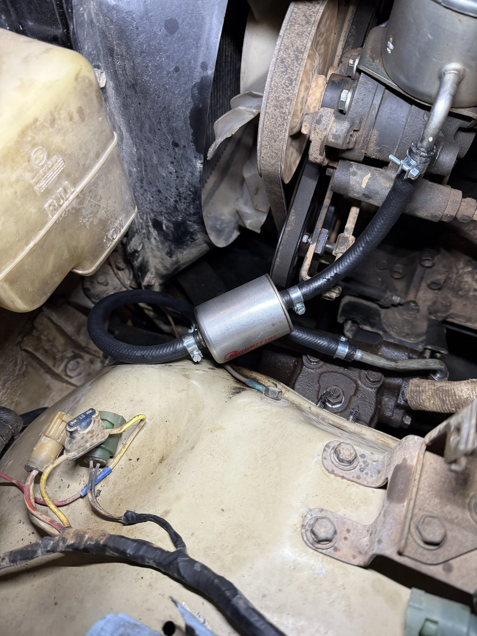

Got the box installed today along with new soft lines using some 3/8" transmission cooler line and some fuel injection clamps. Going to get it bled out tomorrow hopefully. Truck hasn't been driven since I got back from SAS in August so she's needing some miles put on her!

Chris, this is great to know. I’ve done a few box’s in the past and all eventually leaked. Just looked up that kit # and all three overseas vendors I usually buy from are out of stock. The prices I saw were $150-175 per kit. Seems steep but I’m curious where you sourced your kit from. Thanks.
I was lucky and when I saw a post about these early 60 rebuild kits going EOL on Mud I quickly ordered any I could from Amayama, Megazip, Impex, and Partsouq. Ended up getting 3 total ranging from $48-$65 per kit. Two of them are going towards rebuilding the box yesterday and my spare box. Then the 3rd kit will be a spare.
@CenTXFJ60 when Chris got those I think there was discussion that they might be some of the last kits in the world! FWIW some of the seals are still (or were) available individually from Toyota.

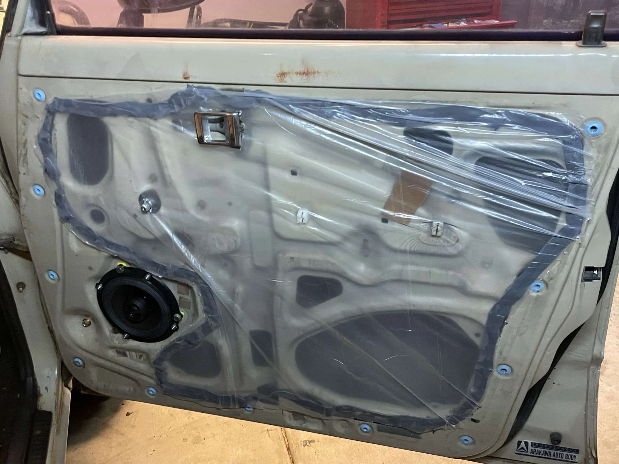

Not sure if James will chime in again or not but I used plastic drop cloth for mine. I don’t remember what thickness but it wasn’t super thin. Just cut to shape and buy some butyl rope to install. Quick and easy.
Exactly what I did, I think mine was 3mm thick. Just regular plastic sheeting from Ace Hardware and butyl rope. Pretty simple job.

So this will sound like sacrilege but I learned it from a buddy of mine doing it on his bmw.
The biggest PITA is usually stretching the plastic over the butyl tape. It never goes where you want and it’s seldom as tight as you want.
At any Home Depot or Lowe’s, they sell floor protectant the form of a heavy duty plastic roll. It’s basically what you lay down over hardwood floors when you’re have a renovation done at your house…one side has adhesive
It also turns out a roll is the width of our doors.
So after you make a perimeter out of butyl, you unroll the plastic from one edge of the door to another. Working your way across as you unroll it the mild adhesive keeps the plastic in place and keeps everything super tight.
It’s thick and easy to cut with a razor once rolled out, so making holes for speakers and window cranks is super easy. it’s also super easy to remove because it’s designed to be removed.

That is a good trick!
Yep, did the same with some heavy mil sheeting, was just curious if there was some secret voodoo trick I hadn't heard about.
Best thing I did was ditch the sticky butyl stuff, cleaned all of it off the doors with solvent and replaced with 3M double sided mounting tape. The sheets peel right off and stick back on like a breeze now.
6 mil vapor barrier for house walls, easier to work with
