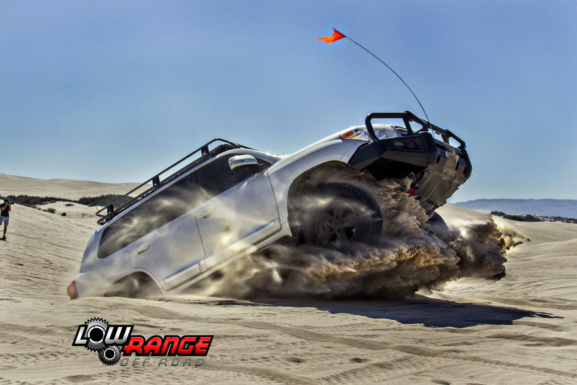

Yup, its a lot of fun. St Anthony ID sand dunes is were our local 404cruisers.com goes to play in a sand box. My 17 year old taught me how to drive in the sand. Did you guys know that the gas pedal can go all the way to the floor? We had one rule, don't roll it. He also learned to listen to the other guy in the front seat (navigator). We would be going up and over a dune with some speed trying to keep moving with nothing but blue sky in the windshield and a right turn at the top....he forgot the right turn and I reminded him in a normal fathers voice sitting in the other seat. We didn't roll but the next 80 series behind us also forgot but was traveling at half our speed and ended up at a 45 deg angle on a steep slope on the other side. Did not roll but not a good place to be.
Sorry about that, I was having fun at the dunes again.
