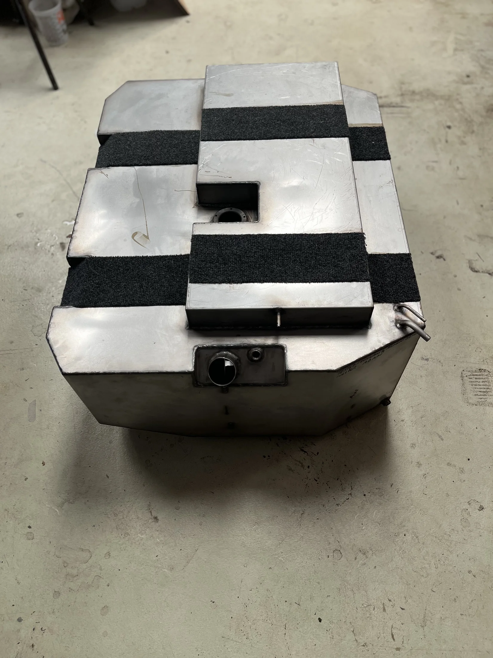

140 L tank, new, never used. I have the straps but no other hardware. High quality tank made in South Africa.
$800 plus freight.

I have no idea. Here are the dimensions: L: 27" W: 33" H: 15"

We tried to fit one under a 1993 Troopy. No go as the top of the tank does not match the floor it bolts to.
Still have that tank sitting here because of that.

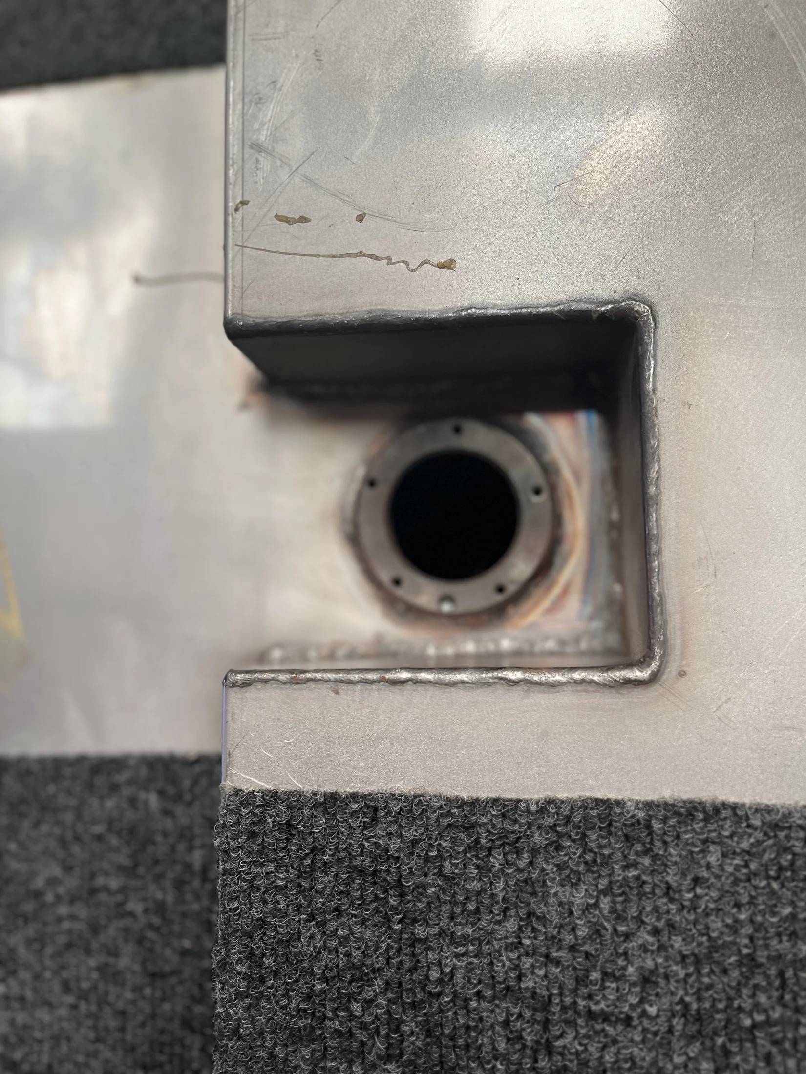

It has a specific section that pops up at the top, its not flat all the way across, which is probably what makes it difficult to use in different 70 series application. It would not be too difficult to have that part modified, any welding shop should be able to do it. You would still be money ahead with the cost of the tank.
The important dimensions, height and width are correct to fit in the 70 series frame.
The overall quality is very good, I think that added effort/cost is worth it to make this tank work.
Thanks for the detailed write up. I see the conundrum around the raised section on top of the tank. I appears to me that there might be a chance a guy could cut that area and carefully weld in a patch.
It could be done, yes; I've already checked with a local shop that works on this kind of thing. The question is whether or not that raised area is actually a problem. The stock tank has a similar feature, but it may not be a similar proportion...so we may not know until we try.
