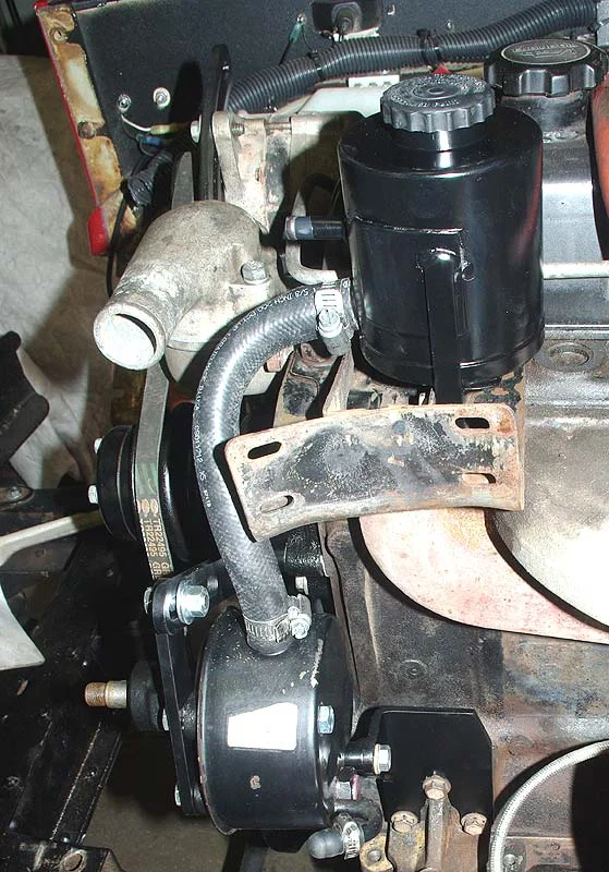

If I read you right Cliff, you're looking for a tank you can run a remote reservoir with.. That would be a chevy van. Something like a '92 G-30. It should have a 3/4" return coming from a remote tank that you'll need to build. We ran a one gallon reservoir on the rock crawler to stop the boiling over of fluid.

We have found them easy to find at pick & pulls, even Astro ones work? The pain is pulling the pump to get the soup can off. The reservoir is easy, 2 bolts, hanging right on the firewall, most of the ones without motors still have them. Looks like this:
